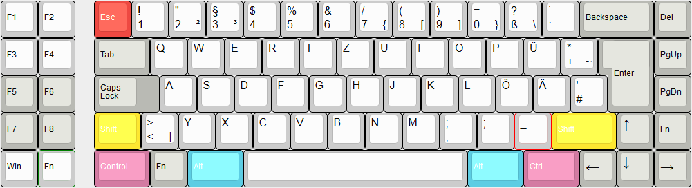

A layout like this would be awesome, it's like a KMAC mini and the home row is perfectly centered.
Custom 75 small.png (25.65 KiB) Viewed 5694 times
-[°_°]-
22 Apr 2014, 17:15
yes, that layout is definitely between the candidates for the final run. Unfortunately the PCB is wider than 30cm. I've found 50cm PCBs but they are of course more expensive. Might be better to just make a main PCB+small daughter board.

Only thing with that layout is the bottom row, the 6u spacebar is not that easy to get a hold of, what I did last year was to make the right shift 1.25 instead of 1.5 and then increase the spacebar to 6.25. I works well but I'd actually wish for a small gab between it and the arrow keys.
The idea about the daughter board is however a good idea.

Ok. I'll have a wooden test run of 2 samples. The layout will be this:
1 ISO, 1 ANSI.
I really don't know how it will turn out but If someone is interested please ping me and I'll put you in a not-binding list of interested parties. The final cost should be half of a full aluminum layered keyboard. I can also full assemble it for you if you want.

Yeah, the 6u spacebar could be a problem, but I played around with the layout for quite some time, and it looks the best to me this way, because you have the size of the mod the same on both sides.
You could shrink the right Ctrl to 1u and have a 6.25u spacebar, so that you get gap between mods and arrow keys. This way the size of the Ctrl wouldn't look completely wrong to me. But then there is a 0.25u gap between them and a 0.5u gap to the F-keys. Without the 0.5u gap to the F-keys the keyboard wouldn't be centered on the home row.
Or you could get rid of the Fn/Win key and have a 7u spacebar, but that way the Alt position is bad for me.

You can get 6u spacebars from the later G80-1800s, where there are 1u modifiers.
