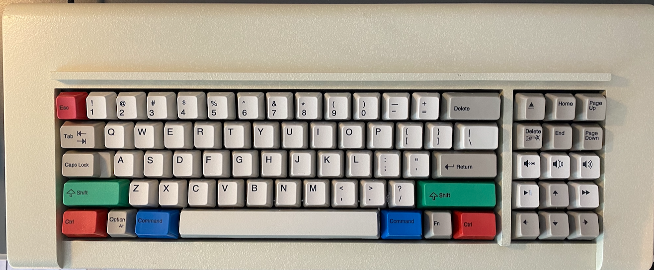

Spacesaver
- Main keyboard: Unicomp Model M
- Main mouse: Mac Magic Mouse
My new F77 with Unicomp keys for Mac. Spot the location of the media buttons.
It's convinced me to put my Model M in the drawer for now. I think my typing is benefitting from the more precise action.
This one works perfectly at the 122 voltage threshold. The fact that my other one works only between 110 and 97, with several keys still not working, suggests that it has a mechanical problem.
- F77 unicomps.png (1.12 MiB) Viewed 15212 times
