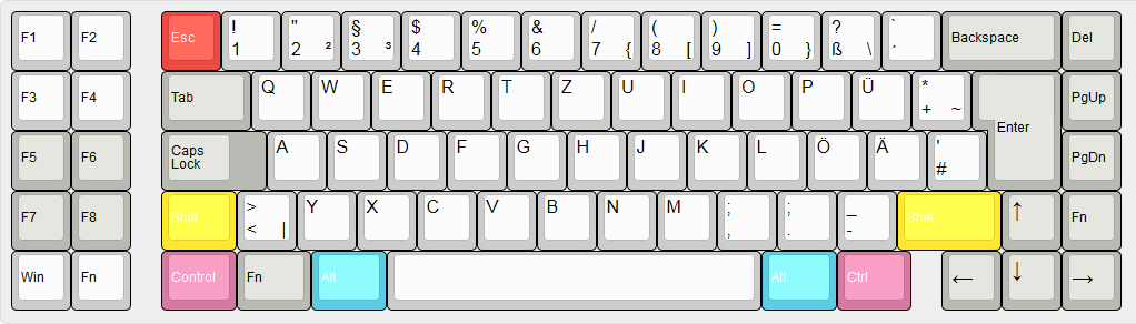

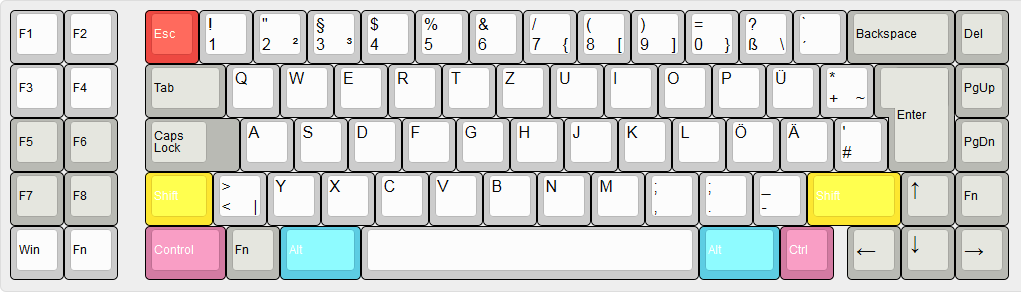

Two variants of the layout I posted some days ago, with standard 6.25u spacebar:

pexon
27 Apr 2014, 13:37
I really like that layout. Similar to one of the custom Korean boards except ISO?
bazh
27 Apr 2014, 13:44
similar to KMAC Mini except ISO and the bottom row layout
pexon
27 Apr 2014, 13:53
Something about it I really like, I'm not an ISO user, but I'd be 100% interested in a board like that (without the Fn key)
bazh
27 Apr 2014, 14:09
I don't like the side F-keys layout, somehow I prefer 75% :p
pexon
27 Apr 2014, 14:16
I meant the single Fn key in between the Ctrl + Alt keys ;)
Eszett
27 Apr 2014, 14:25
I would prefer either F1-F12, or no F key at all, else it is neither fish nor fowl. Another question is, when you aim for a minimalistic layout, which I approve, how does this go with a Fn key three times on the board? But I took some inspiration from your sketch. You arranged the positions of RShift, Arrow keys, and this extra column to the right quite well.
bazh
27 Apr 2014, 14:34
I use 2 on both my HHKB and 38GT, don't know what an additional one can do since 2 is enough for both sides :lol:
27 Apr 2014, 14:41
Multiple Fn keys can be useful for accessing different layers. And those are always handy on compact layouts.
I like Nuum's left function column. But of course I would!
pexon
27 Apr 2014, 14:49
The single Fn on my HHKB suits me perfectly, I personally feel that aesthetically, the Fn key on the left ruins it
27 Apr 2014, 14:50
This is the beauty of custom builds: just put another cap there and change it in Hasu's firmware!
bazh
27 Apr 2014, 14:58
I found it easier to use the arrow cluster with 2 hands so I use left Command as Fn key, the left Command on the other hand doesn't mean much to me
Nuum
27 Apr 2014, 15:18
scottc wrote:This is the beauty of custom builds: just put another cap there and change it in Hasu's firmware!
Yeah, keep in mind that you could allways change the function of the keys to whatever you like. This is all about key placement, not layout.
And now that some of you say it, there really are too much Fn keys. The F keys might not be necessary, but I like them aestheticwise.
Yeah, inspiration comes from the KMAC mini, but I couldn't live with Ctrl and Alt being so close together. In fact their positioning on a winkeyless keyboard is perfect for me.

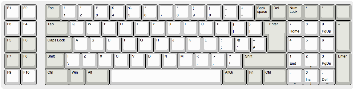

@Murium: Yeah, I quite like the layout of the IBM AT/XT model F's, too. Only problem for me is the bottom row, I need more modifiers. And perhaps arrow keys inside the numpad. Something like this.
Edit: And don't mind the colors, I just wanted to try CMYW next to the Cherry BoW color scheme.

Nuum wrote:@Murium: Yeah, I quite like the layout of the IBM AT/XT model F's, too. Only problem for me is the bottom row, I need more modifiers. And perhaps arrow keys inside the numpad. Something like this.
Nuum XT.png (46.89 KiB) Viewed 6322 times
XT fans unite!
I'd do one thing to your XT-based layout: shorten right shift and put an HHKB style Fn key there, because I'm crazy for those. Would you have the arrow cluster be on the default layer (0) or are they behind Fn (layer 1)? The XT's bottom row is its greatest weakness and I think you've made several nice improvements. Although I find my arrow keys (right on layer zero) in the numpad to be very useable and quite roomy.
Just think of the PBT Granite options on such a board. The Multimedia kit is waiting!
