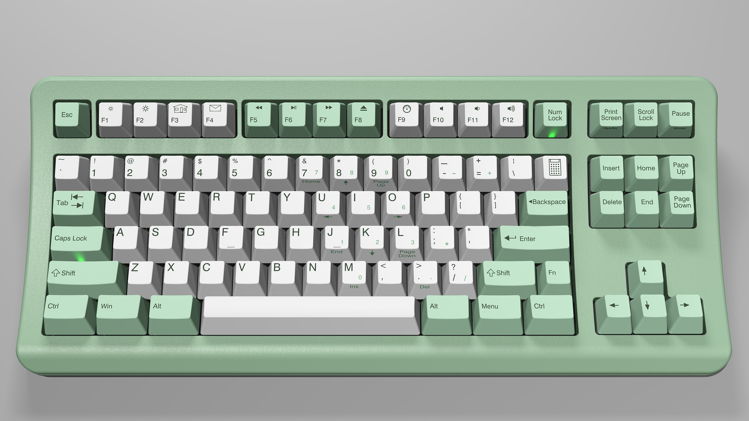

- LightGreen-WhiteSSK9.jpg (918.55 KiB) Viewed 11193 times
- LightGreen-WhiteSSK8.jpg (916.97 KiB) Viewed 11193 times
- LightGreen-WhiteSSK7.jpg (918.57 KiB) Viewed 11193 times

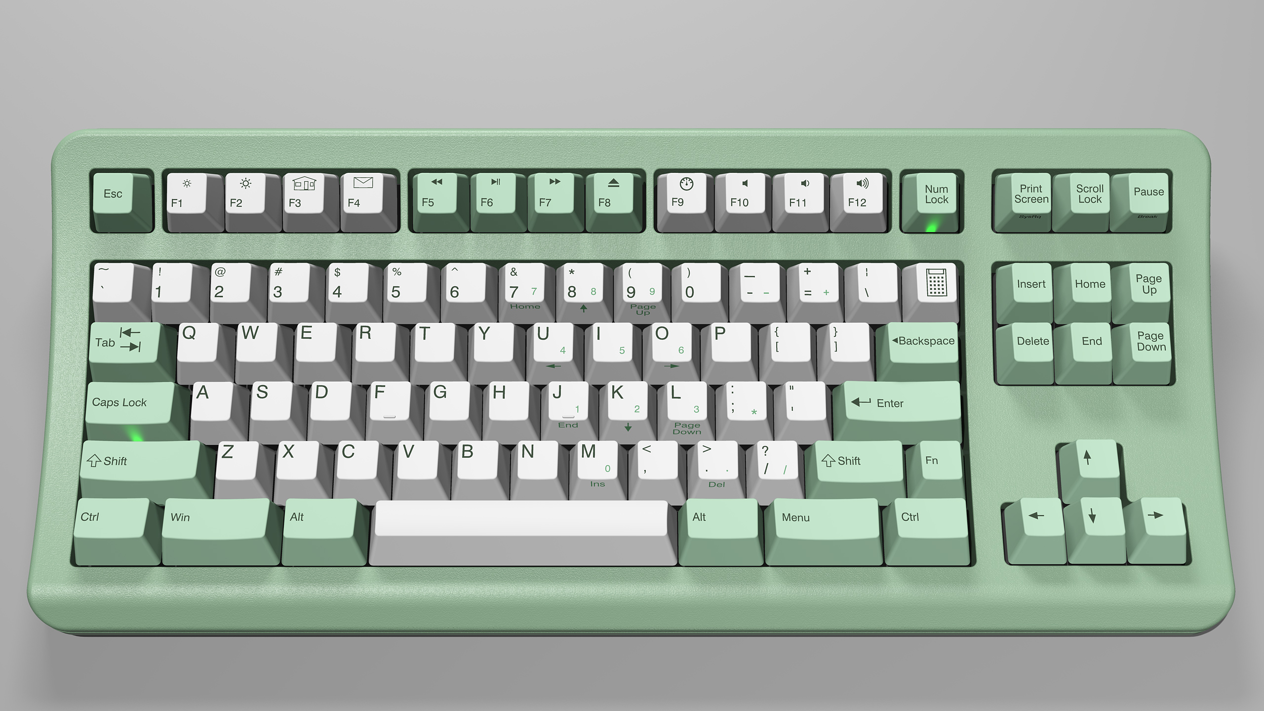

- LightGreen-WhiteSSK10.jpg (918.53 KiB) Viewed 11117 times

[Vomits a bit into mouth] Larger OS keys are the last thing anyone sane would want.

Unless you are a Mac user... but then you would also want to swap Alt and GUI and let the key on the right side be the right GUI key.Daemon Raccoon wrote:[Vomits a bit into mouth] Larger OS keys are the last thing anyone sane would want.

Indeed. I use Command constantly, so it's my most important mod and gets pride of place beside the space bar on both sides. Even with my 2+2 mod IBMs. I don't need it to be larger though. The position is what matters in fact I much prefer the elegance of the previous arrangement with equally sized mods. We can always switch caps.

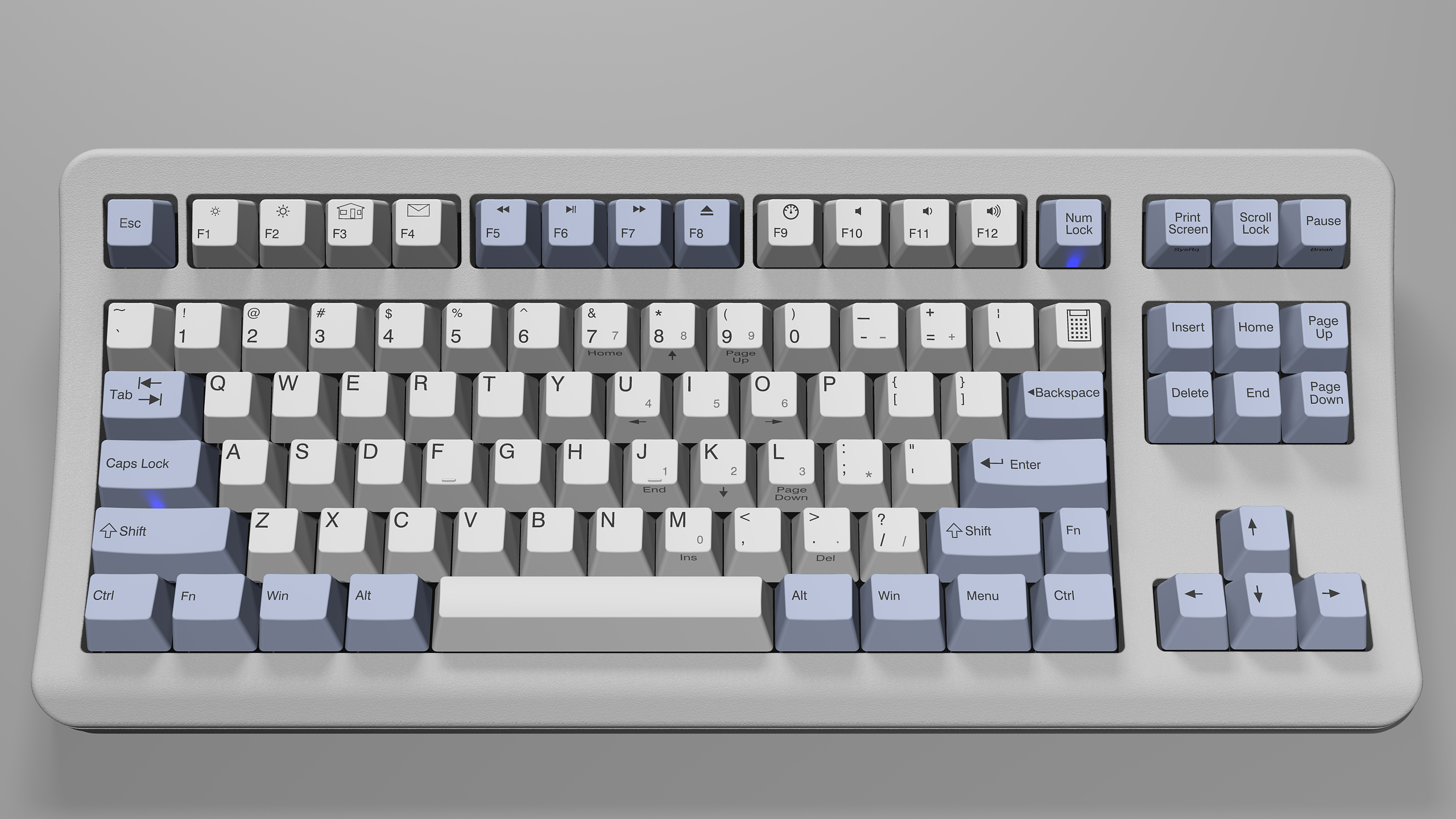

It's a great colour scheme, and the familiar function row is still appealing. The space bar's a bit big for my liking though, because I have to cramp my thumbs to hold either Command; and I prefer uniformly sized mods anyway. And then there's the awkward function key up where Apple put it on their desktop boards, which I've never heard anyone say they like.
But other than the bottom row, this physical layout would be an excellent baseline that further customisation can still fall back to. Long right shift isn't for me, but I don't need it to be if it can be either full size or reduced by a unit thanks to the excellent barrel frame. Ditto 2 unit backspace.
- LightBlue-WhiteSSK12.jpg (811.21 KiB) Viewed 11017 times

The last render shows up fine (and fast).

Reminds me of Apple's M0116. Love it.
