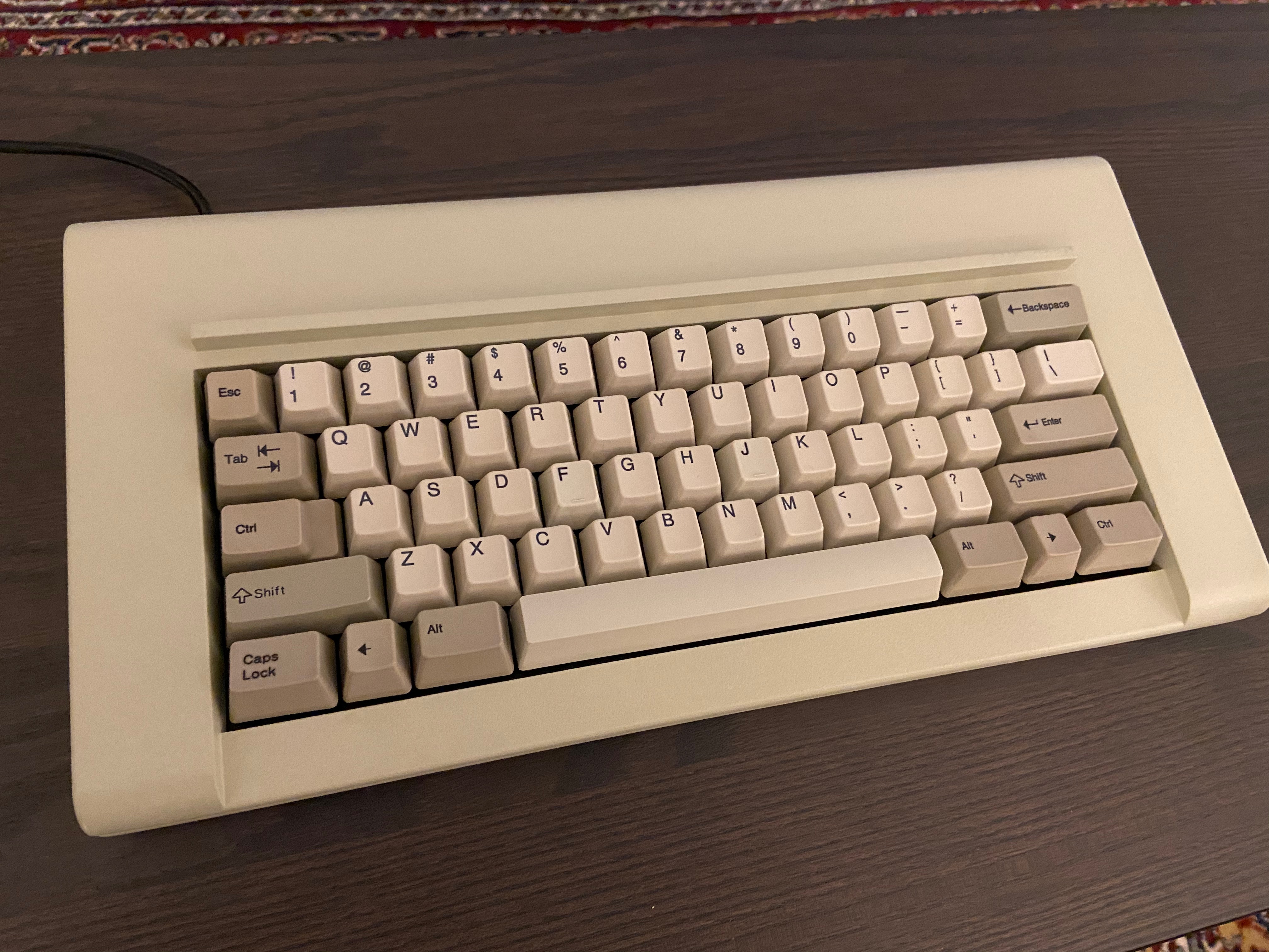

My F62 and F77 Compact arrived this week, and wow... these things are awesome! The key feel and sound are very close to my F122. Both the classic and compact cases have quite a nice heft to them, and I was pleasantly surprised to see that the F77 used USB-C instead of MicroUSB.
I have a Unicomp keycap set on my F62, aside from left shift as my Unicomp left shift was getting stuck when pressed. The F77 has mostly Wheelwriter caps, with some various others to fill in the gaps. I'm looking forward to the completion of dye sublimation for the new caps, I think these would be even better with keys that are higher quality or more consistent than these placeholders.
- IMG_0365.jpeg (2.43 MiB) Viewed 8829 times
- IMG_0358.jpeg (2.77 MiB) Viewed 8829 times
The space bar on my F62 did often get stuck when pressing at first, but I was able to fix that by carefully adjusting the stabilizer tabs. Now it's operating flawlessly! Only other thing I changed was adding a macro to make Shift + Esc print a ~.
The F77 appears to work great at first glace, but if I type quickly on it I find I'm getting phantom key presses with one of my computers. It doesn't seem like adjusting the voltage threshold is helping much... below 124 and keys start showing up as constantly pressed, around 140 I get random key presses when not pressing anything, and thresholds in between seems to have the original issue. Maybe it's just me, but it seems to be at its worst when using keys on the bottom row. I'll have to keep playing around with the configuration, I'm sure it's a software issue and nothing wrong with the keyboard itself.
Aside from that issue, I'm very impressed with these keyboards. I never thought I'd be able to own my favorite switch in something with this sort of size and layout. Ellipse, thank you so much for making the dream real and for pursuing such a high quality result in the process!
