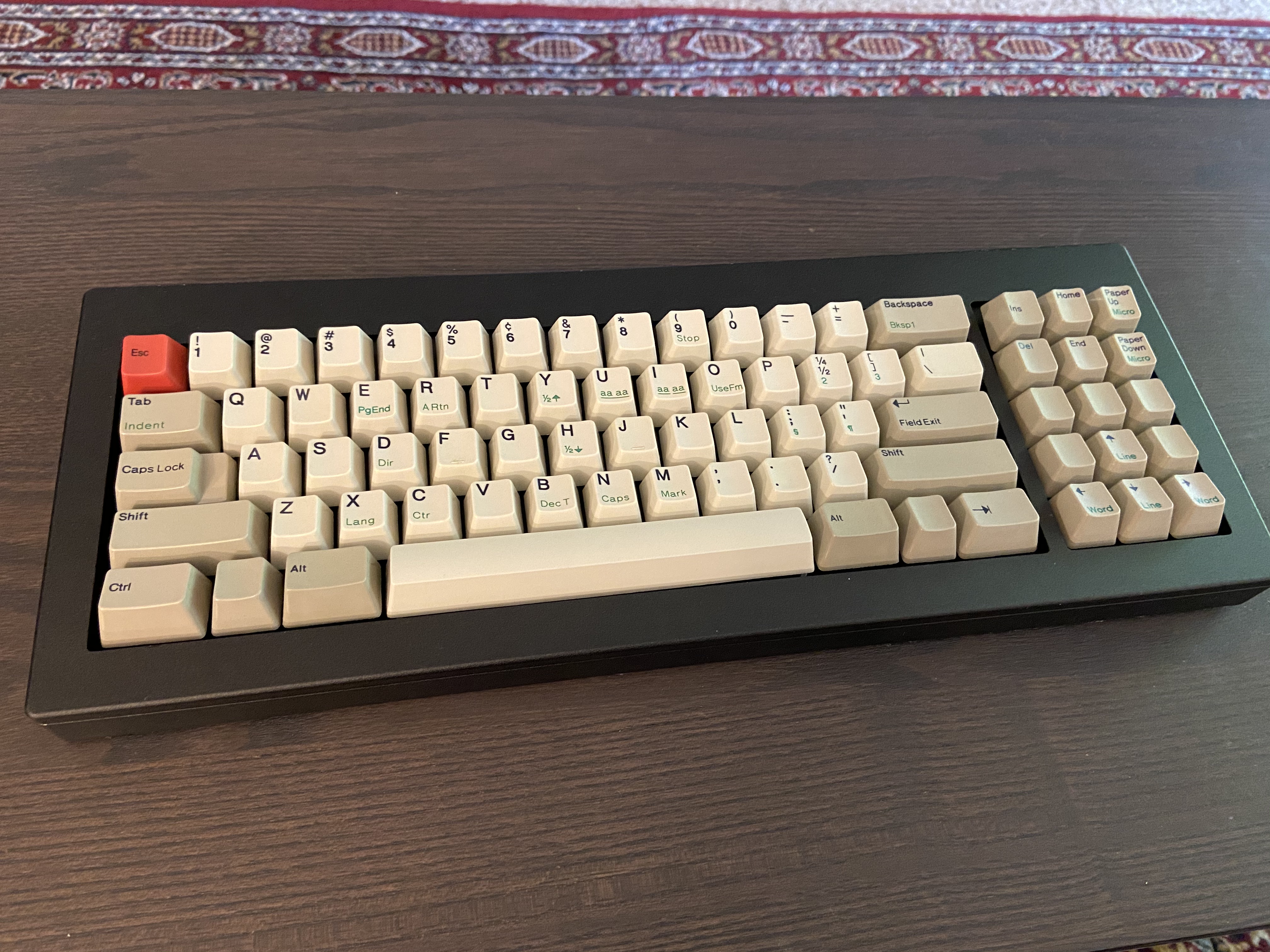

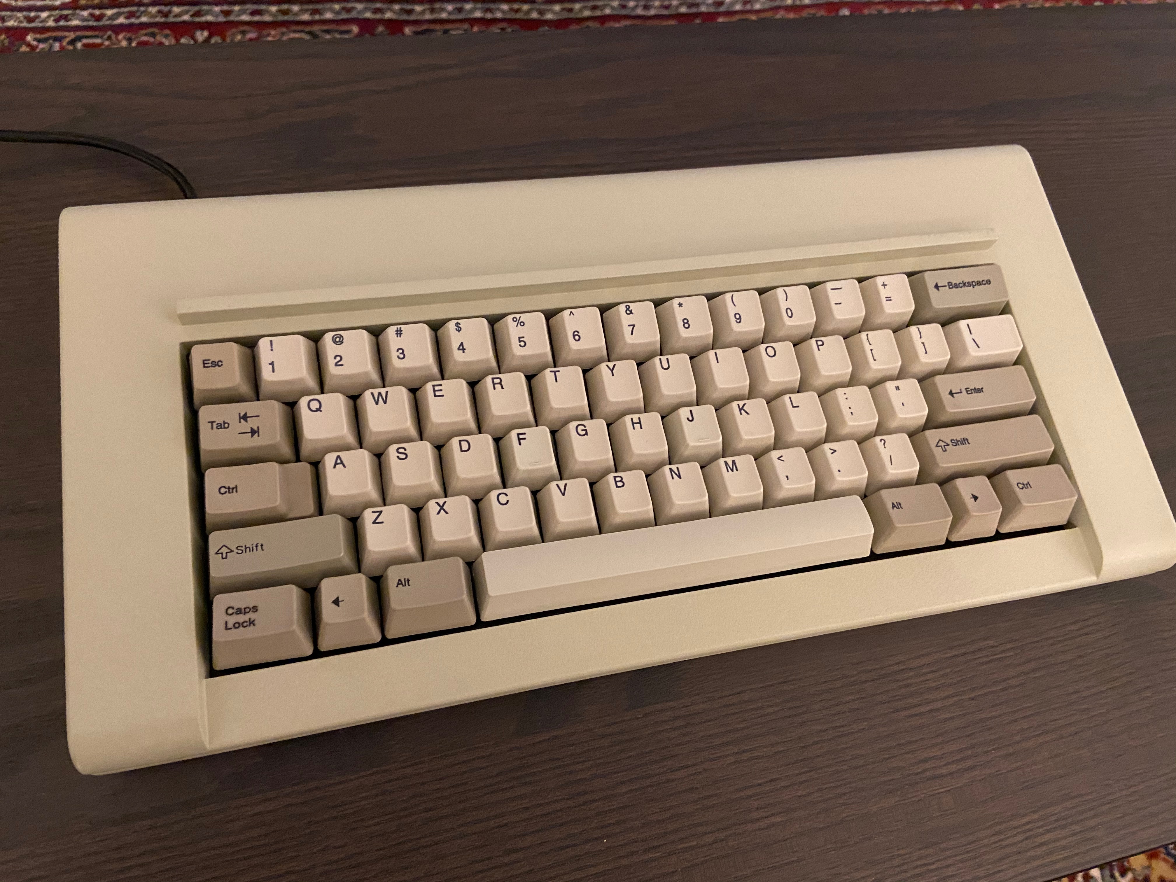

I just got my Classic F62 and Compact F62 and holy crap these are amazing! I don't have keycaps to test them out yet except the spacebar.
I noticed on my Classic the spacebar won't depress, and I am not sure if I am putting enough pressure on it or if it stuck somehow. I don't want to risk breaking anything. I have a small scratch on my compact but it's barely noticeable, and have the same noticeable line near the "pencil holder" on my Classic. Otherwise everything looks great and sounds amazing from what I can hear.
I noticed some barrels don't have springs in them. Are these for if you want to switch to the HHKB layout?
And wow. I didn't realise how hefty the classic is compared to the compact. It is amazingly hefty I can't help but laugh at the pure awesomeness of these keyboards. Can't wait to get the solenoids, drivers, and keys to test these out. Maybe I will have to order blank keycaps as backups.
Thanks Ellipse again for everything, and thanks for providing me with my first mechanical keyboards. It's too bad these have to be a limited run and no one really makes keyboards like these. I really appreciate the work that has gone into this.
