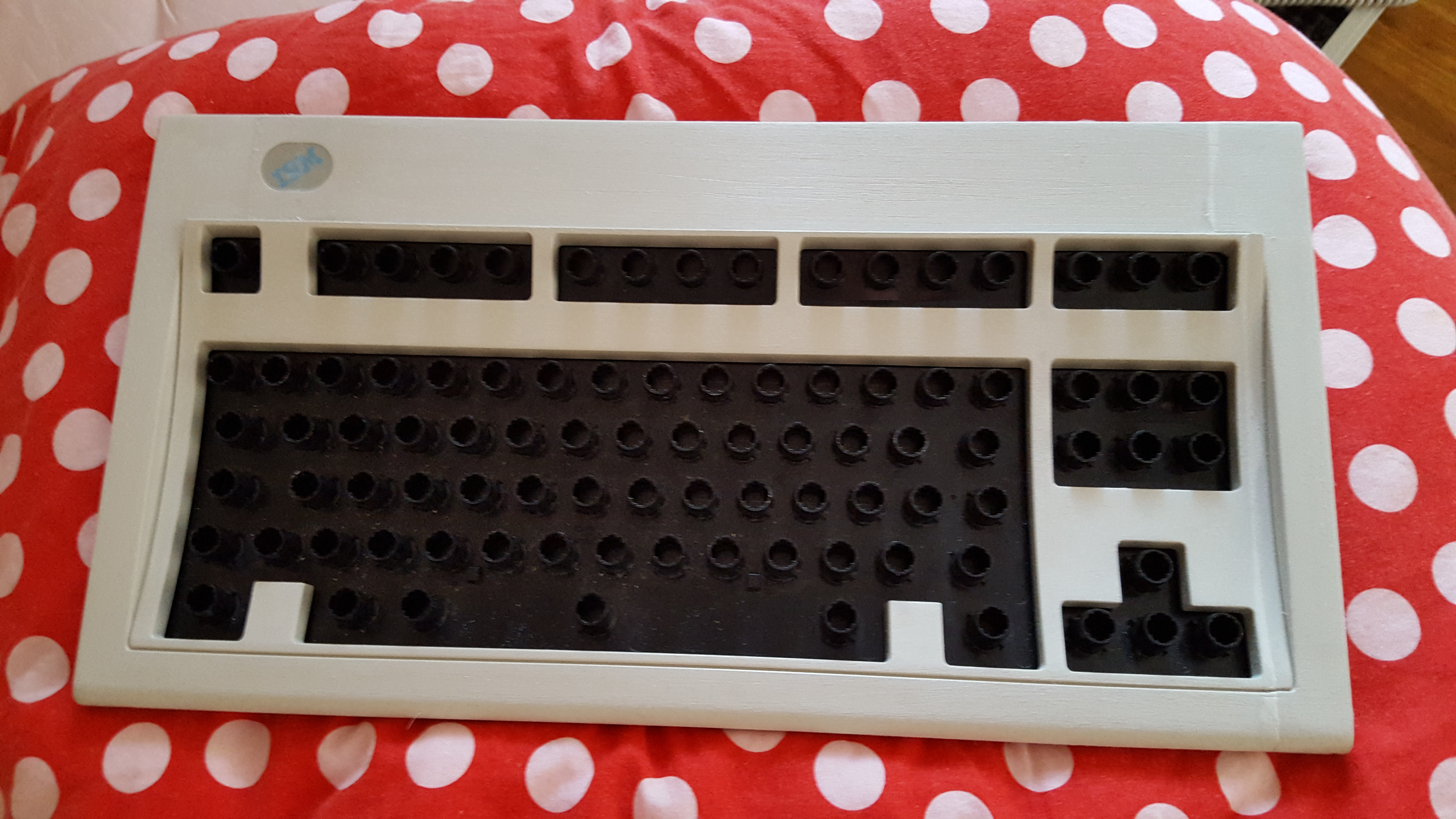

I have the end result (which I still need to drill the barrel assembly for, that's tomorrow hopefully, as well as a beige/white plastidip, which I still need to get).

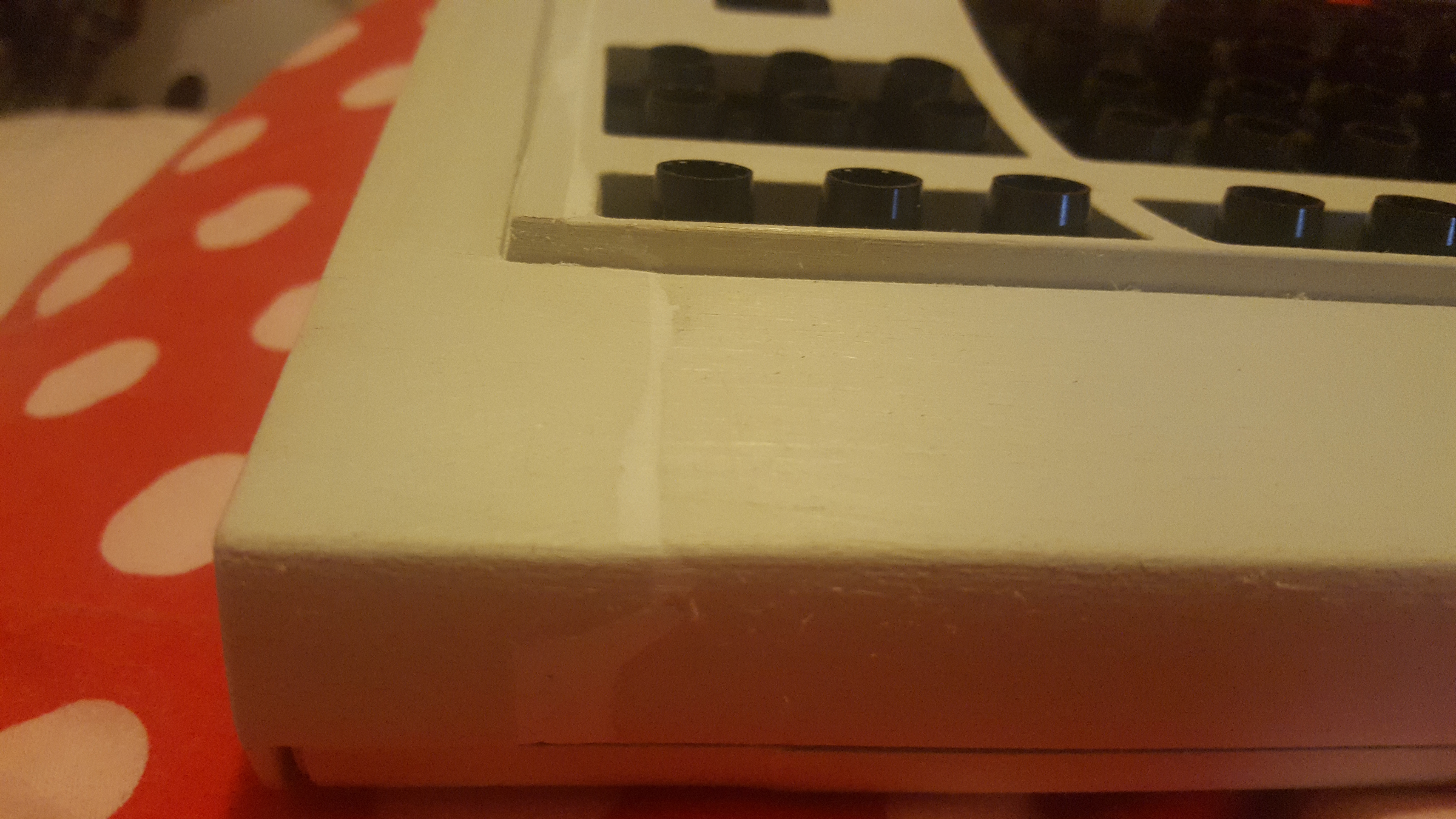

"Finished"
"Finished"

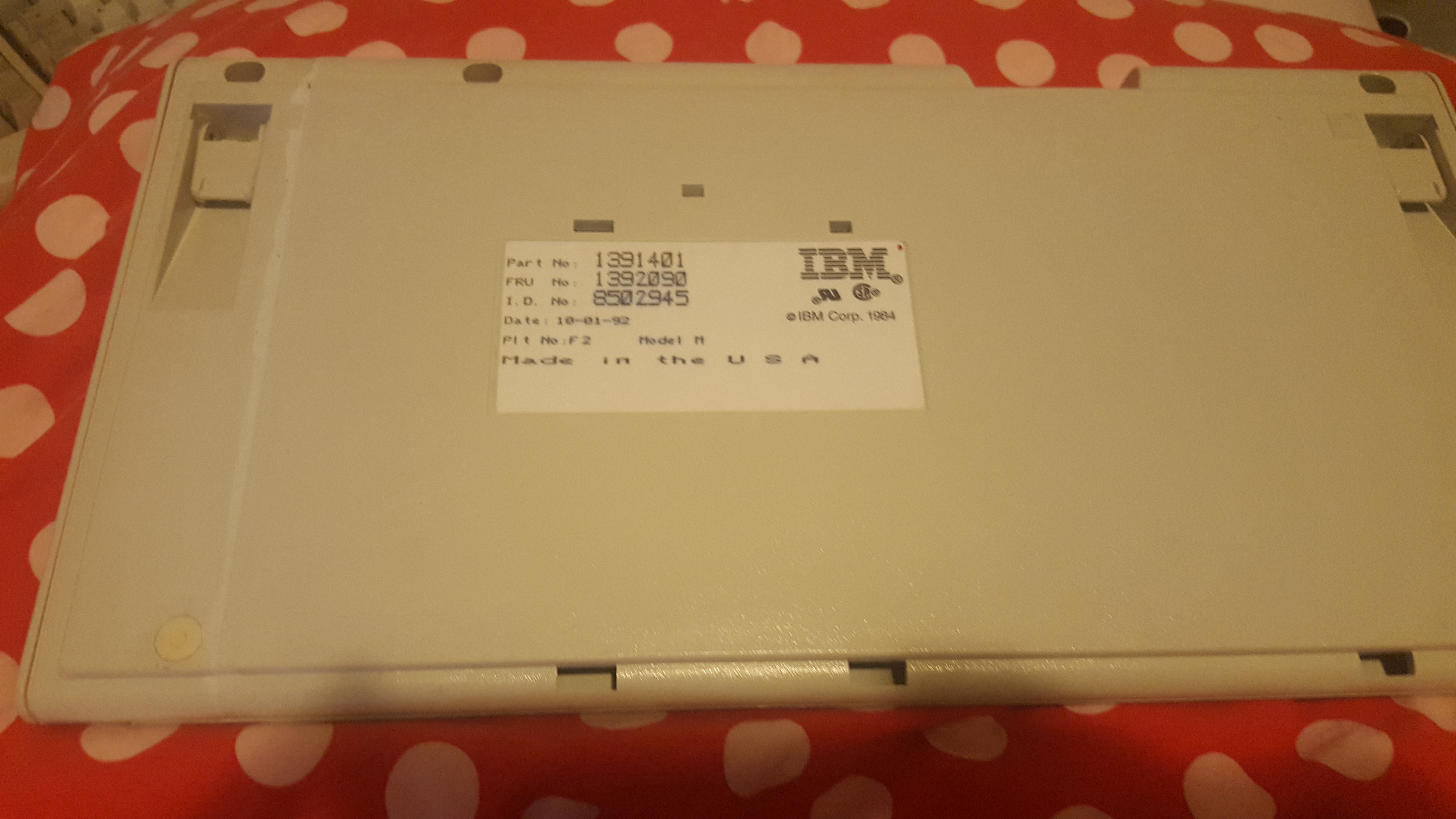

Bottom
Bottom

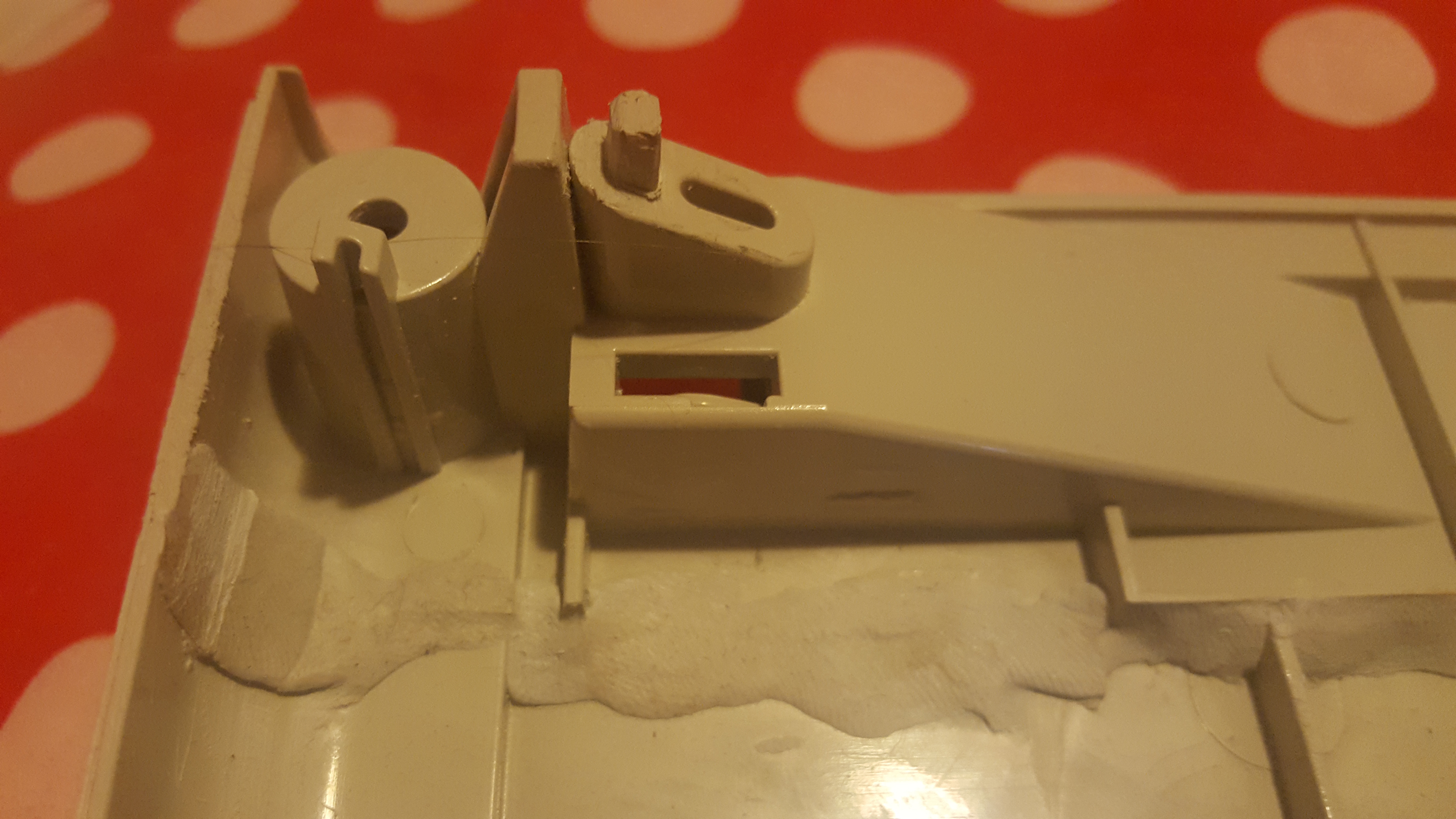

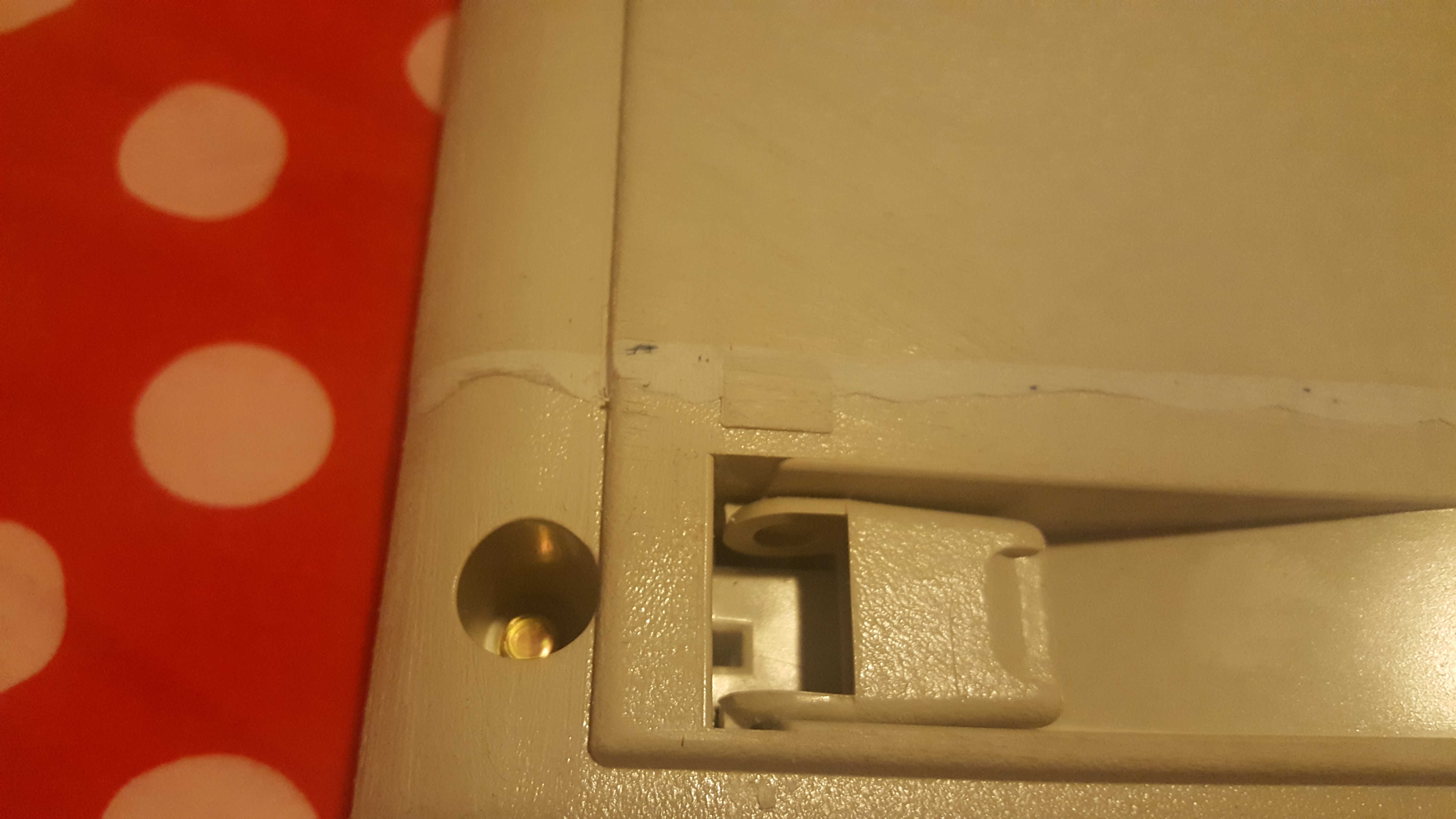

Basically, I bought a 1390401, opened it up, and stripped out the plastic rivets (basic bolt modding).
I then measured out on the bottom exactly where I needed to cut in order to save the feet, while also saving the internal support structure. I mapped this on to the top, and found where I needed to cut to look as presentable as possible.
The M I actually bought had a hole in the case (where it had been attached to a desk with a lock). So I had to cut around the hole, while still looking pretty. I ended up making a cut on the upper ridge of the M, diagonally, so that I could maximize the surface area for the putty to actually put it together.
Top, showing the diagonal cut, and the putty patch job, to cover up my mistakes

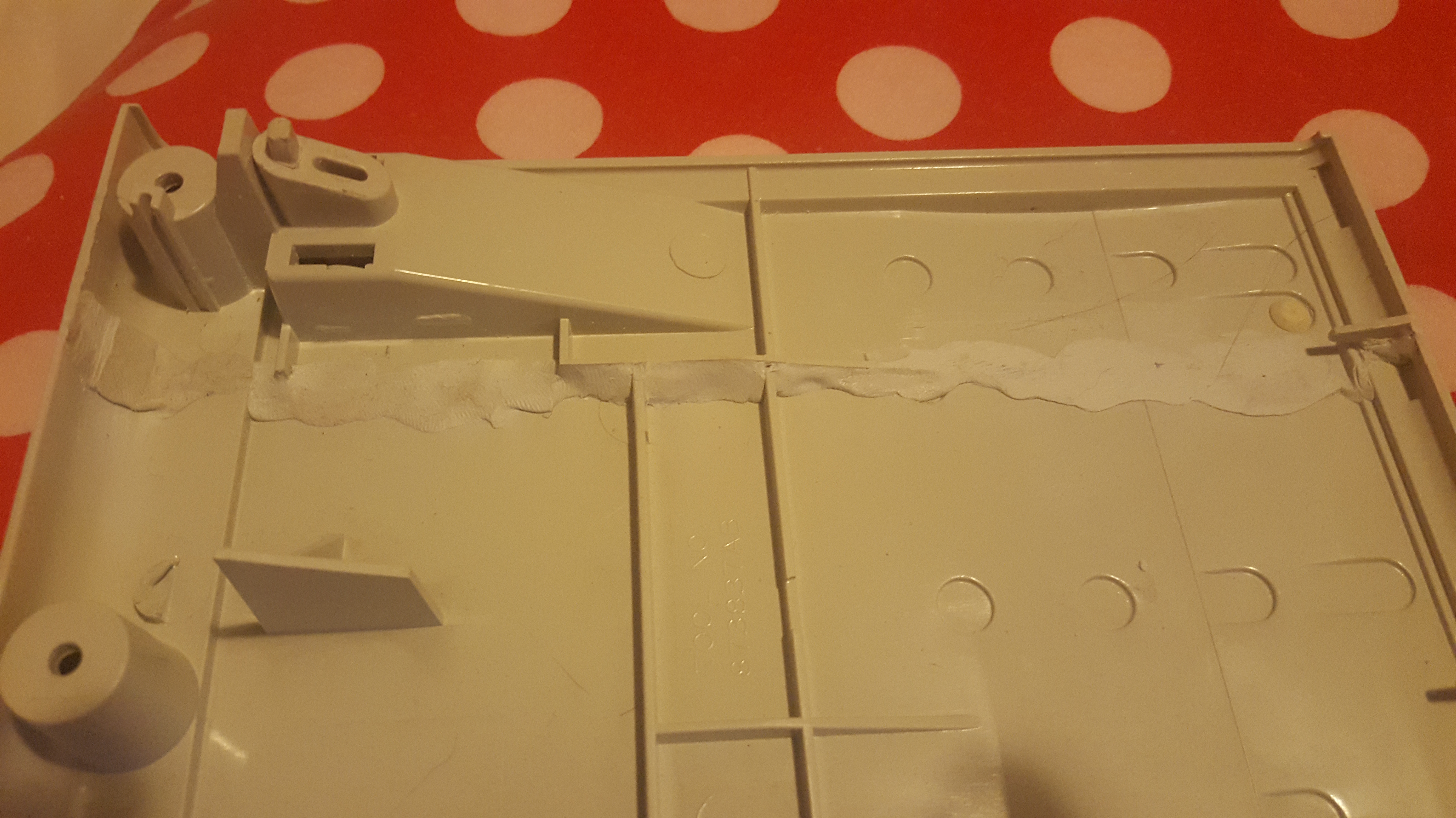

In the top I also tried to save the support ridge to the right the nav cluster, so that it could act, again, as more surface area to be bonded to.
Inside bottom
Inside bottom
When I cut everything, I sort of did it all at once, and thought that I should give myself a bunch of breathing room, so that I could sand/file down to the mark. This is a great idea, usually, but man, it took a hell of a lot of sanding and filing to actually get down to the mark. And, when I was there, getting the parts to sit flush was impossible. I ended up just settling with a bit of inaccuracy, for the sake of sanity. I actually ended up sawing it after my initial cut, getting these slivers of case and assembly, just so I wouldn't have to file almost an inch of the rock solid plastic of the M. Built like a tank, it really it.
The putty I used was called called J-B Weld PlasticWeld that I got from Rona (hardware store in Canada). On my first application, I happily cut off a blob, mixed it between my fingers (as the instructions say), and packing it in. On further reading of the label, I jumped directly into the shower- while the instructions say to mix between your fingers, the fine-fine print says that it is not to be gotten on skin, and to avoid inhaling the dust, or getting it in your eyes.
I got a particle mask and a pack of gloves before I did any sanding or doing the top.
I had bought a couple clamps, so that I could get in and fix my XT, so I used those in order to actually hold them together while the putty set. I had 1 2ft, and 2 1ft clamps- the type that looks sort of like a rifle.
When I actually did the puttying, the surface I had was a cardboard box, which I figured would be fine. Mostly, it was, but when I did the bottom, the joint was influenced by the small "flat" feet, for when the feet aren't extended. The issue is that the bond is a bit uneven. I should have used a more narrow surface, so that it would level to the flat of the case, not the feet. Oh well.
The Foot- note the little bump is a bit off

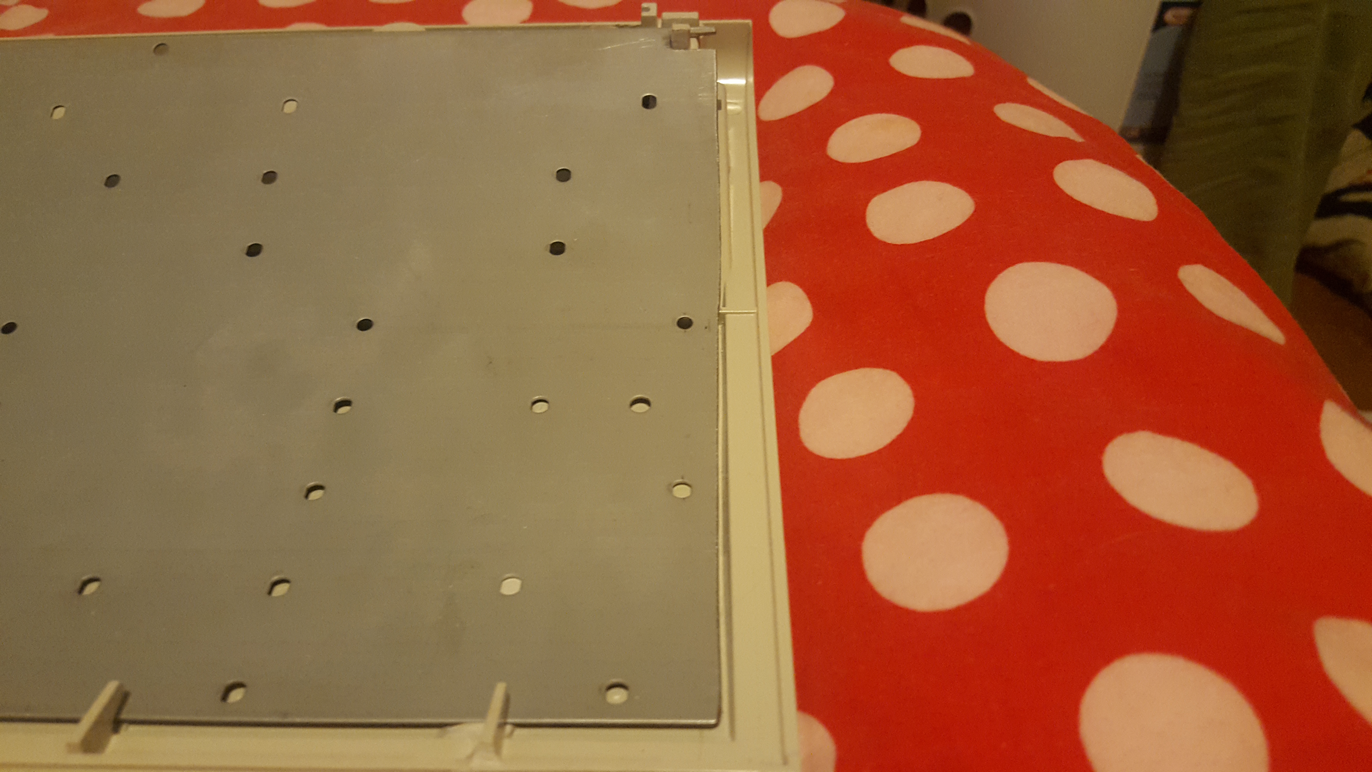

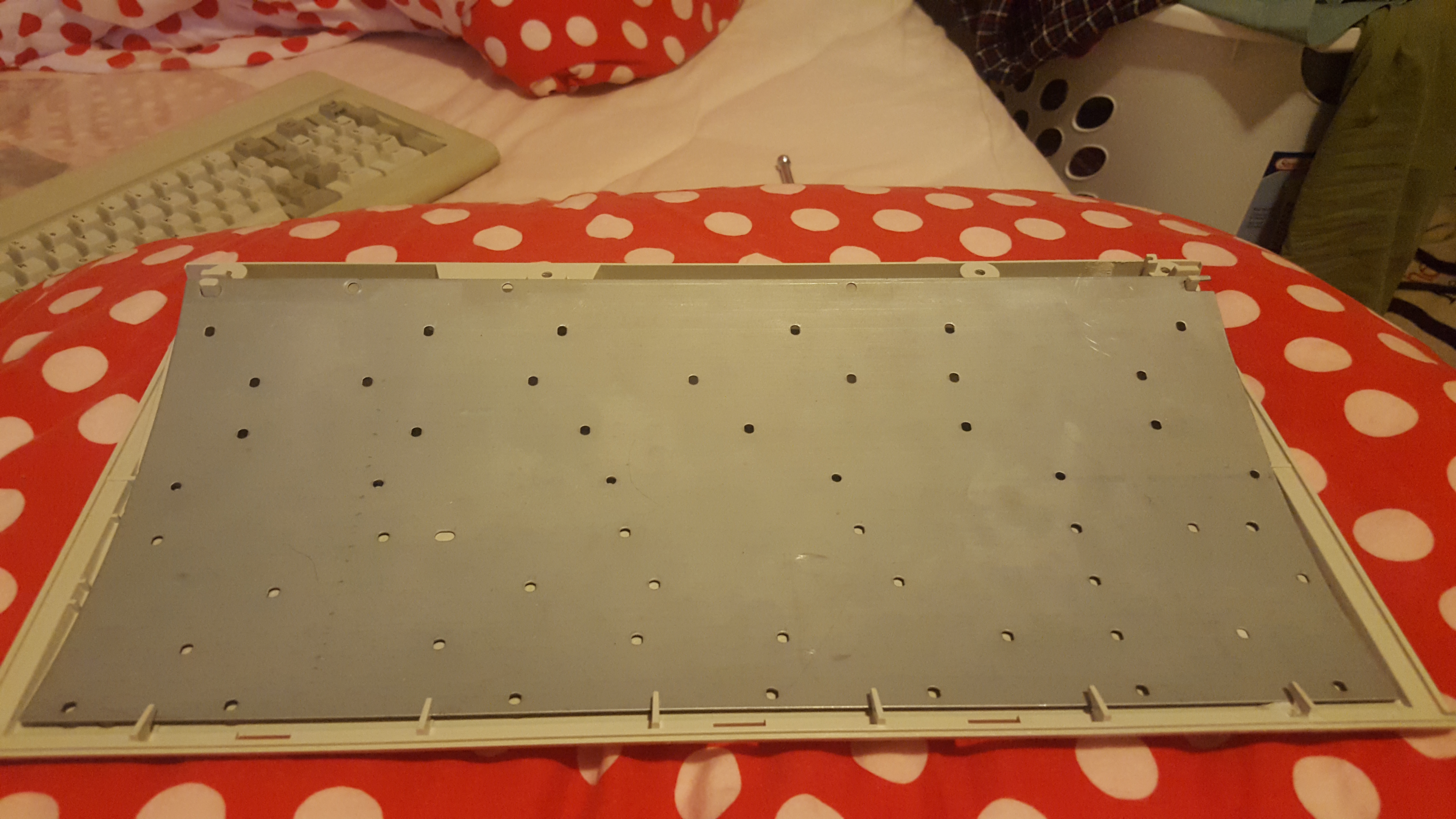

To get the plate on, I had the choice: either drill a hole to slide onto the peg, or do something else. I did something else, as I had nothing to drill with. However, I did have something to cut with! So I cut a notch in the plate at the top so it could slide horizontally into the peg, which I filed down a bit to make the sanding of the metal bit less awful (it still was awful).
Close Up of the damned peg, and the putty job along the edge
The entire plate, and its fit
Something that bothered me when I was actually doing the mod is that very few people actually gave measurements. I now know why- it is entirely a bunch of guesswork once doing it. I used a square and ruler, but mostly I eyeballed where the plate would fit, and then cut it. I have below a few shots of what I assume the inside fit is supposed to look like, but I dunno :\
Showing the plate in the peg
The whole process has taken about a month, waiting for shipping etc. I just hope that it all works in the end! The top isn't as secure as the bottom is, and I messed up a bit in removing a clip that I thought I needed to. On the lower end of the top, the joint is coming apart, so I most likely will need to re-apply the putty, or use super glue.

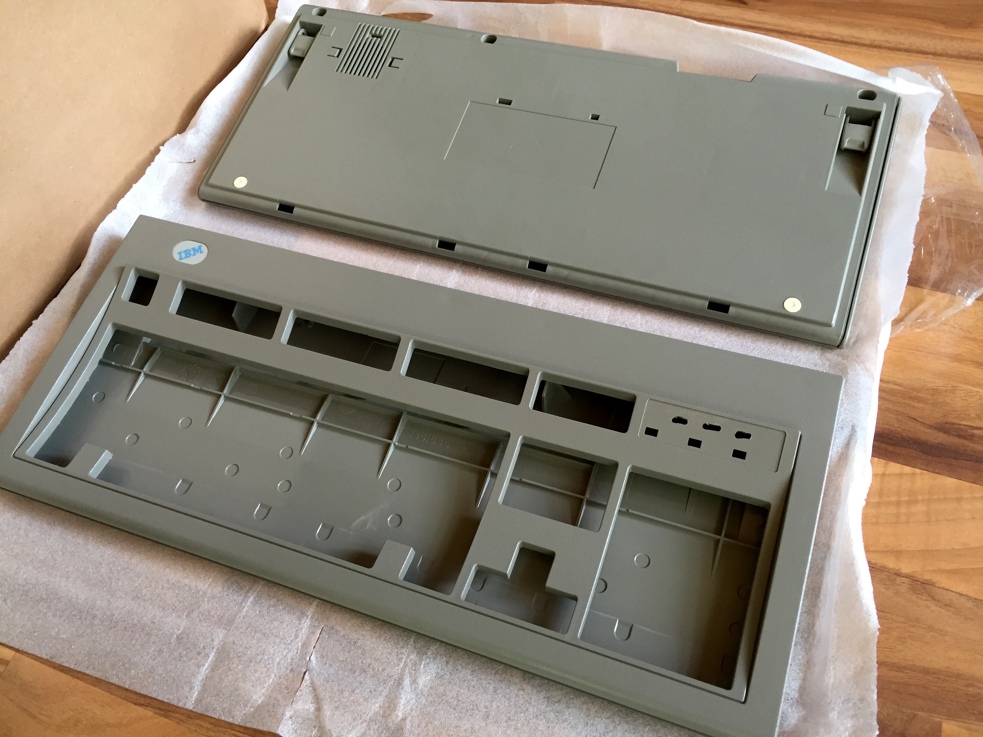

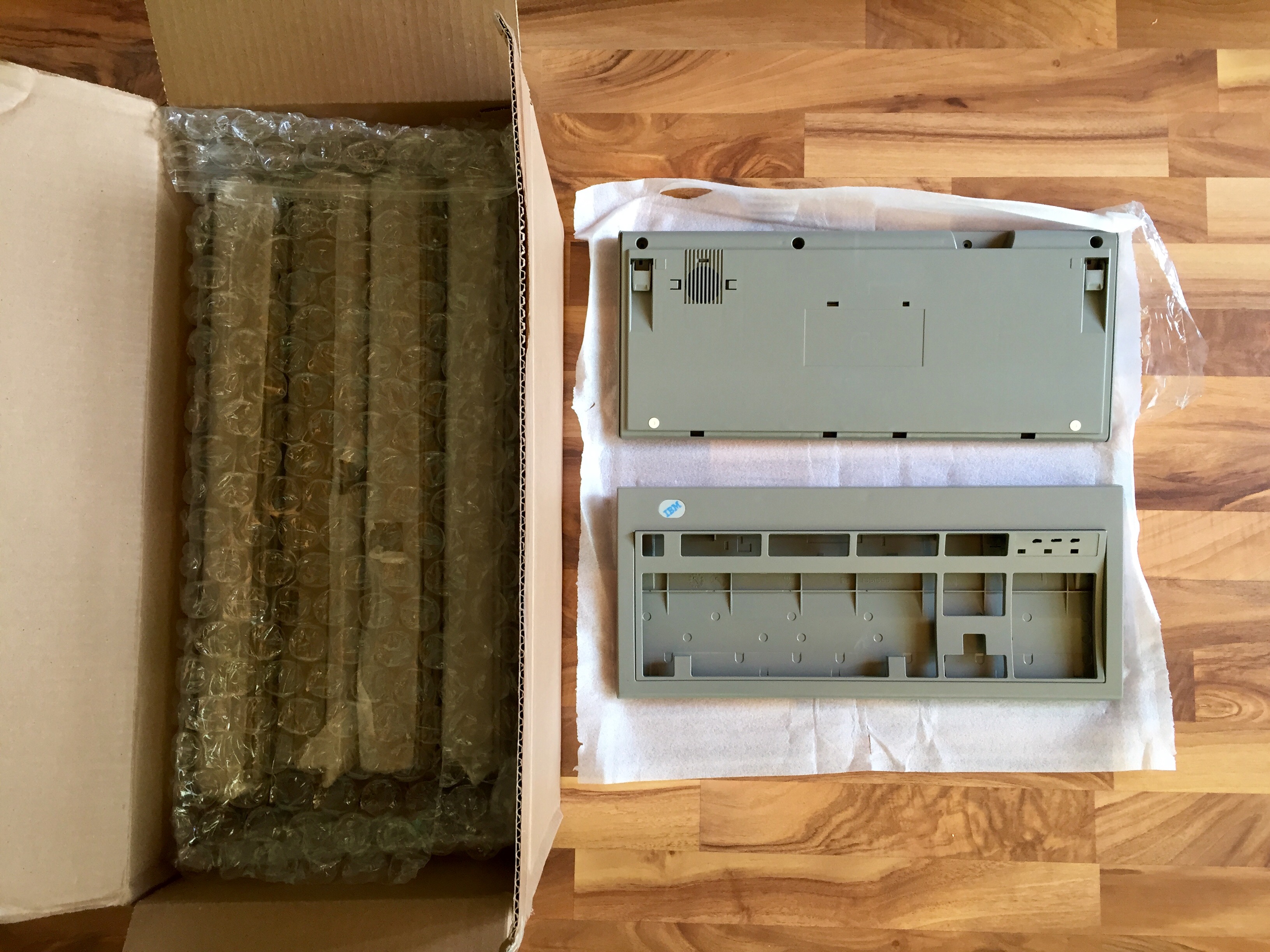

I just had a nice little delivery from Unicomp. These are definitely originals that were left over from their initial purchase, and not something they have reproduced (no question). We are down to 2 available now because I'm deciding to keep one :). If anyone is interested, let me know.
Also... If a side-by-side comparison with the original is interesting, let me know. If they still have some available, I would recommend cleaning them out.

Just got my industrial case in the mail. Looks good except for the weird holes that they drilled for the LEDs. Also seems like the LED cover that I thought I ordered was never added to my shopping cart before I paid and forgot about it. So looks like I need one of those. :lol:
Otherwise very happy with the case. Never thought I would ever have an industrial at a reasonable price, let alone an Industrial MF, so I guess today is going pretty okay.

They look great- I was a bit worried that they grey of the cases wouldn't be as deep.
