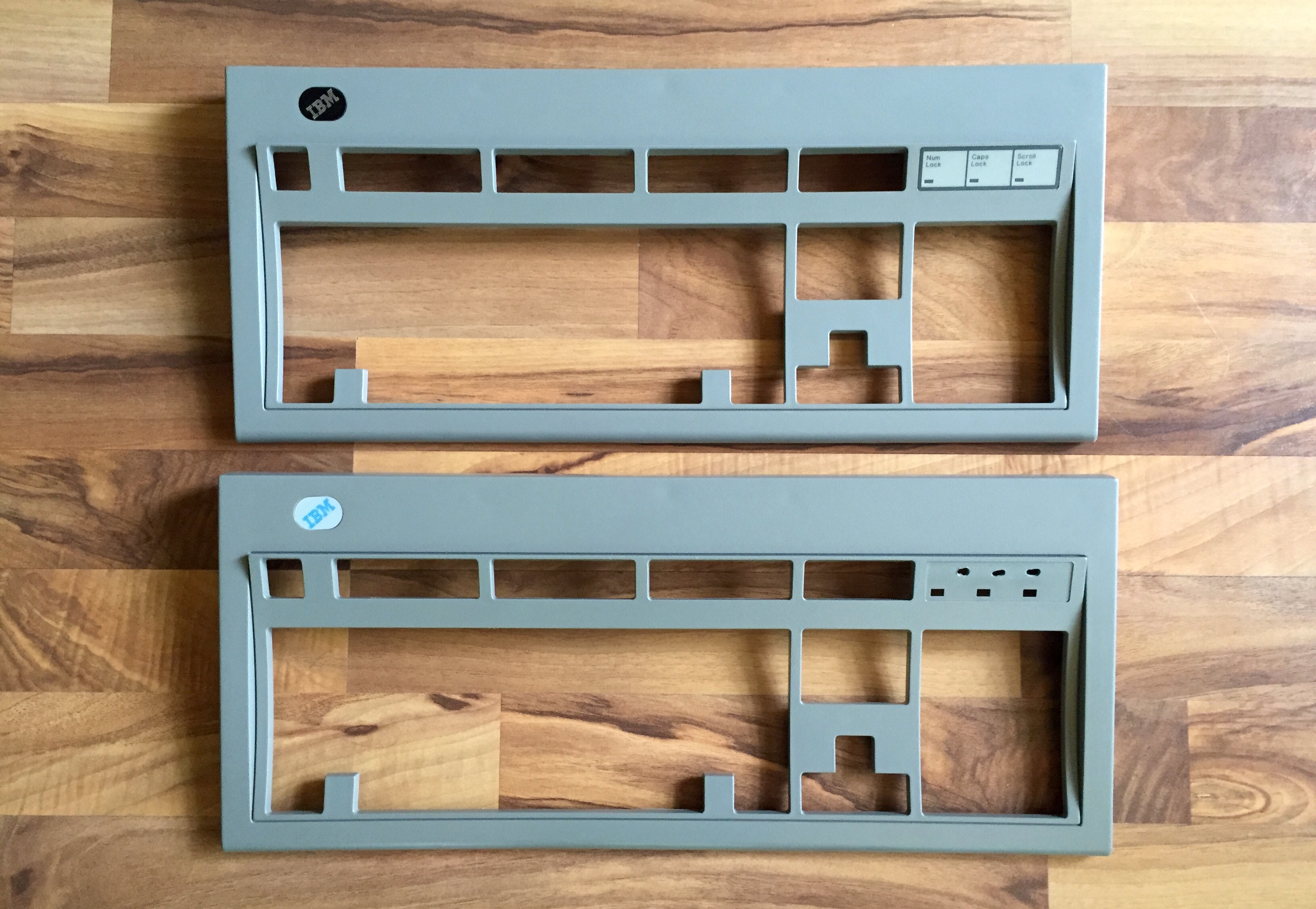

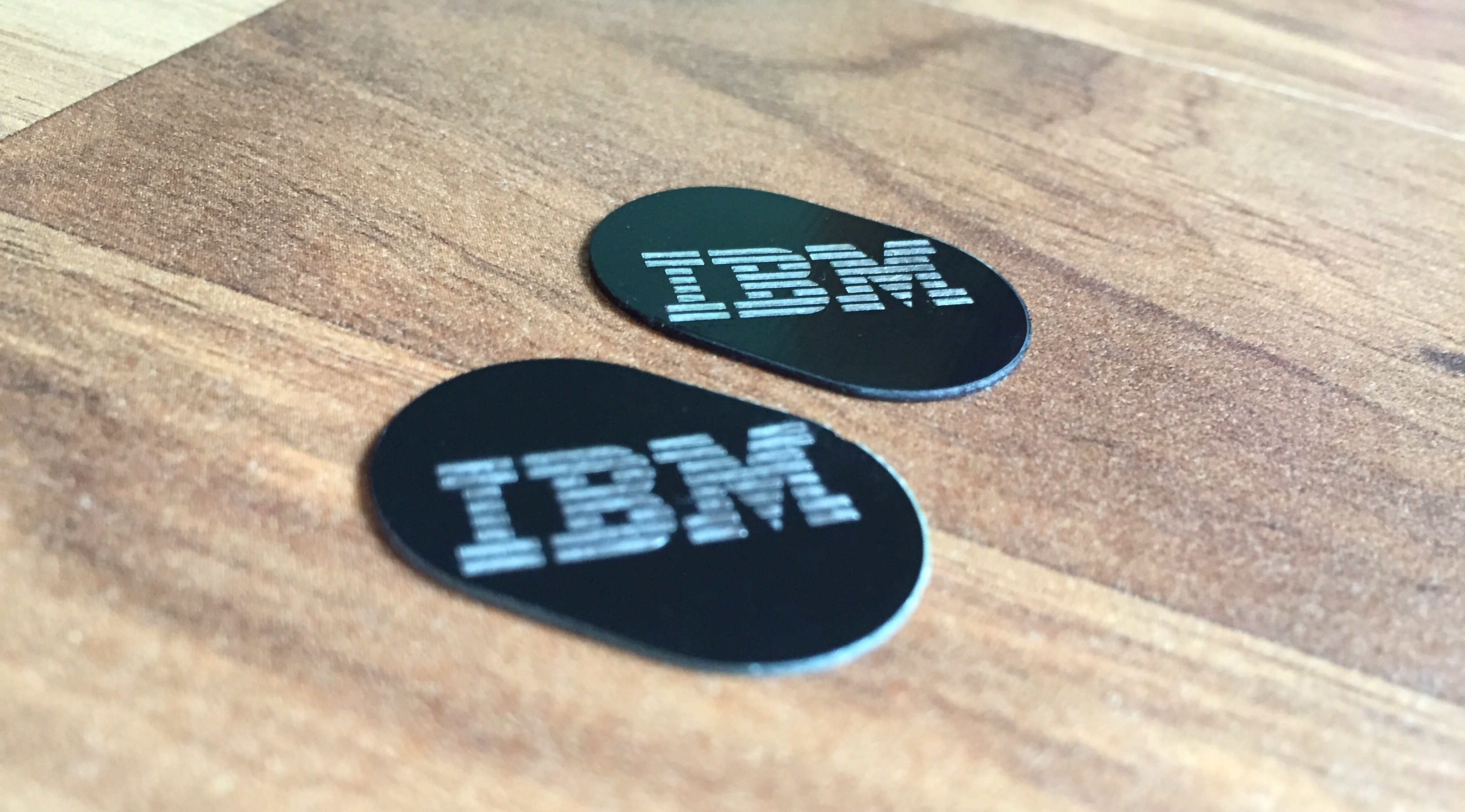

Thought those receiving them would appreciate the before and after shots below. I had a couple of extra WCass/Seebart badges, so added with industrial double sided tape (not Scotch tape).
@emdude, I tried the LED's in a dark room and didn't notice any bleed from the Unicomp monkey holes.
Two things I did that others might overlook:
  • When Unicomp added the holes to the LED, they used some sort of rotary tool (think Rotozip) pressed from the back side. This causes ridges on the front around the perimeter of the hole. You will want to debur them (lightly sand, run with a knife, etc) if you want the LED overlay to be perfectly flat
  • Our reproduced badges are made of PCB. The edges will have tooling evidence regardless of how good of a job you do. I took a simple permanent black marker and carefully ran around the side edge. Looks much better now (see last picture)

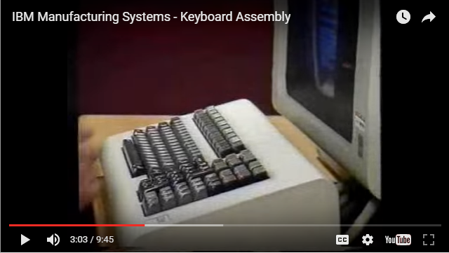

I absolutely love how the robotic arms and the rest of the equipment have the same kind of badges as the stuff they are making. Black badges are there on the robotic arms, but I guess it was too early for industrial cases.
And did anyone catch what the keyboards manufactured where? Those looked like XT PCBs, but the keys being pushed into mylar earlier didn't look to me like they were in XT layout, with those 2+3 columns on the right side. Or am I looking at everything wrong?
29 Jul 2016, 20:45
That one PCB right at the beginning looks like an XT to me but I can't tell for sure, the footage is like a back to the future trip. I probably shouldn't spam lot_lizard's thread with stuff like that.

That was a great video. I like how they're promoting the robot assembly, but we care more about the keyboards they are producing.
I found it interesting that since they were manufacturing XT keyboards (the narrator said "keyboards for the IBM Personal Computer"), the keys would have been one piece construction. But they are unlabeled when put in the mylar sheet. So there must have been a step when the entire set of keys were due sub labeled at once. I wish we could have seen that!
