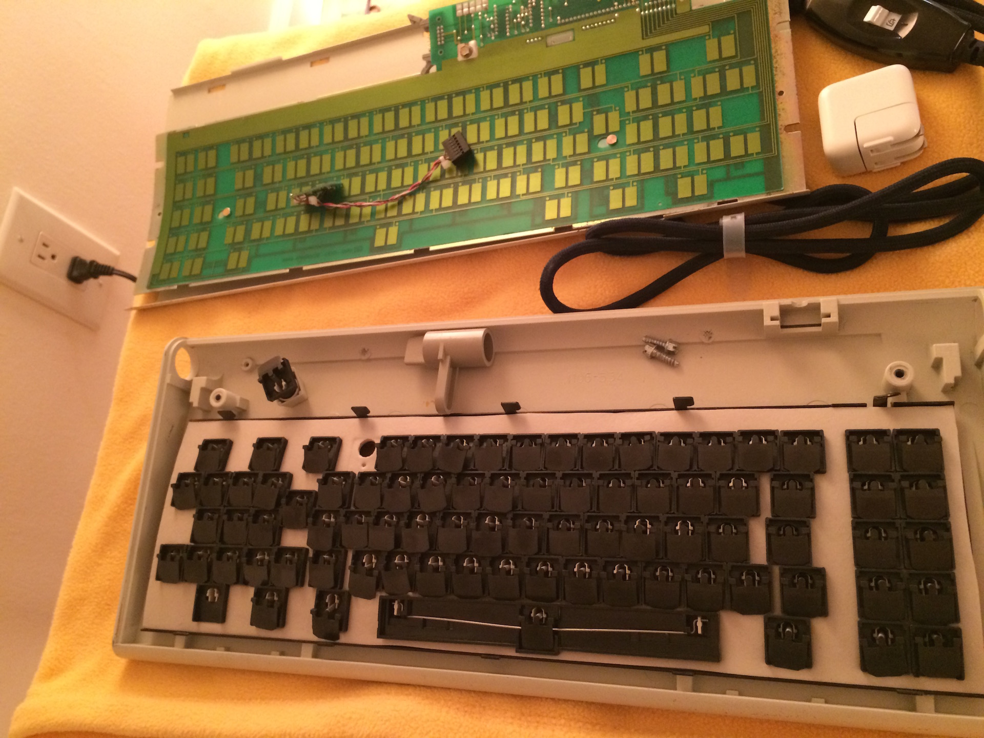

Opened up for debugging

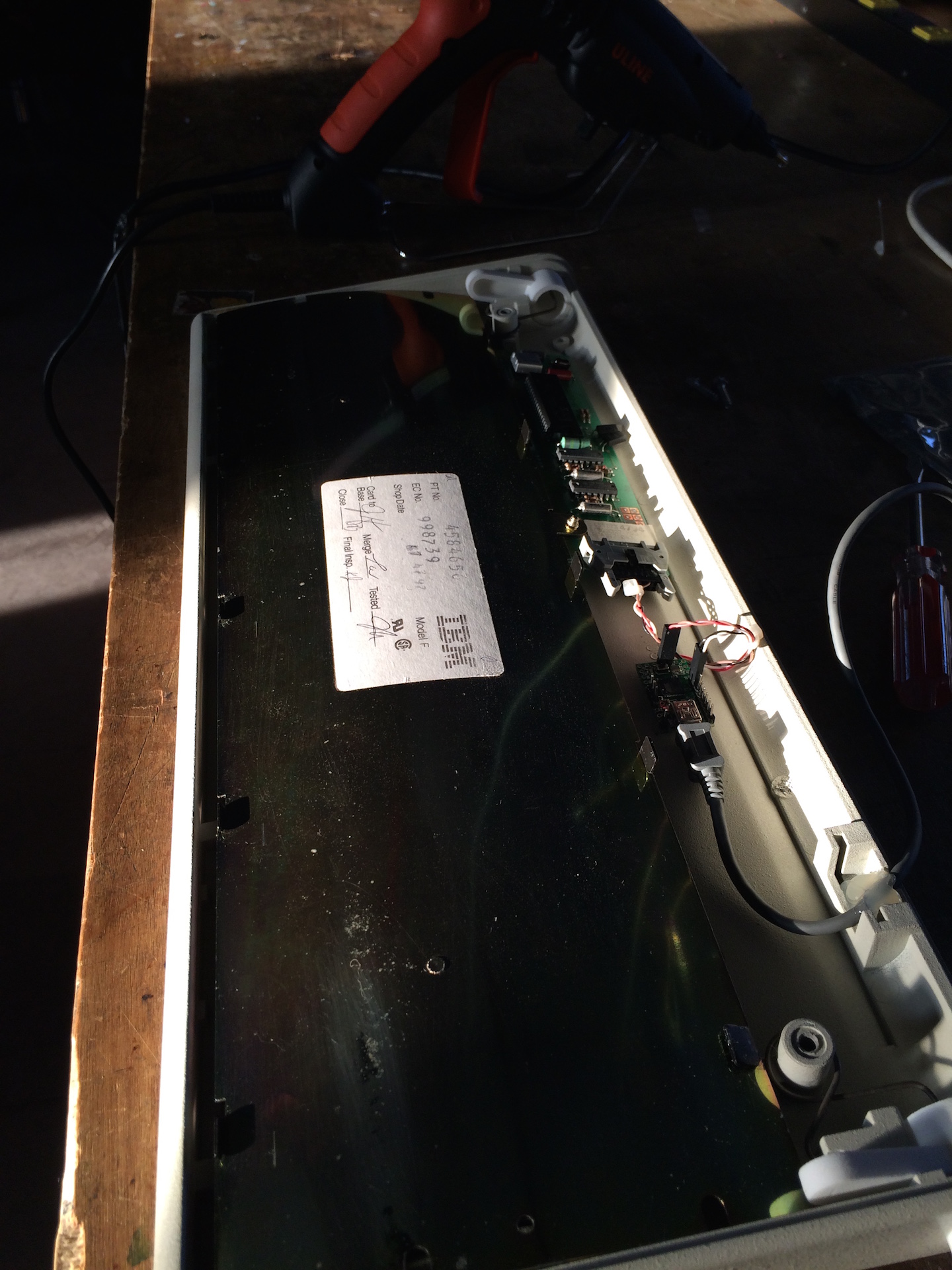

Hot glue and sunshine - and yea I've reworked the teensy and the cable connector

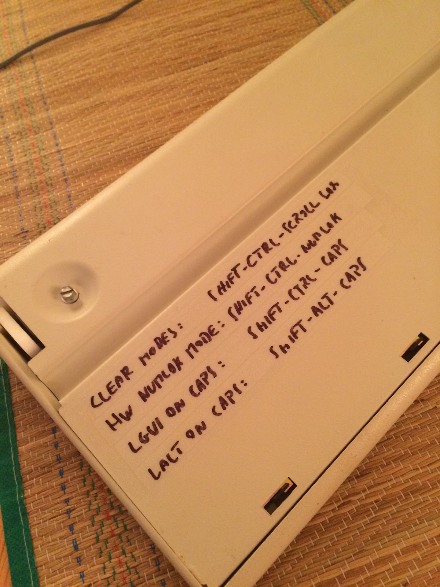

Documentation :)
Documentation :)

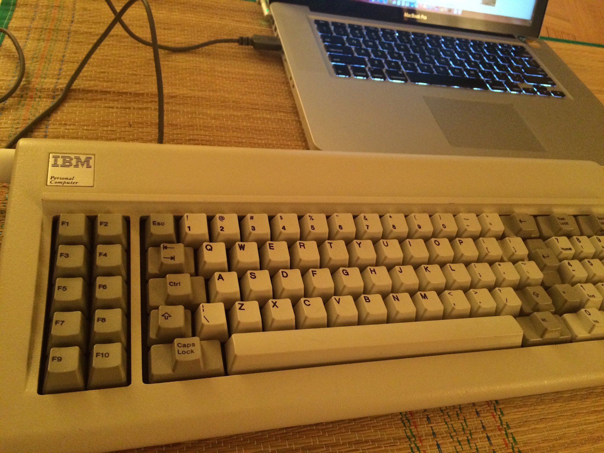

All done
All done
And here's my Soarer config for posterity:
ifkeyboard 0000
ifselect any
remapblock
	CAPS_LOCK					RALT
	LALT						CAPS_LOCK
endblock
macroblock
	# Clear modes
	macro SCROLL_LOCK SHIFT CTRL
		PRESS SELECT_0
	endmacro
	# Switch to hardware Num Lock mode
	macro NUM_LOCK SHIFT CTRL
		PRESS SELECT_1
	endmacro
	# LAlt on Caps Lock
	macro CAPS_LOCK SHIFT ALT
		PRESS SELECT_3
	endmacro
	# LCmd on Caps Lock
	macro CAPS_LOCK SHIFT CTRL
		PRESS SELECT_4
	endmacro
endblock
# Hardware Num lock
ifselect 1
remapblock
	NUM_LOCK	SELECT_2
endblock
ifselect 2
remapblock
	PAD_1		END
	PAD_2		DOWN
	PAD_3		PAGE_DOWN
	PAD_4		LEFT
	PAD_5		PAD_ENTER
	PAD_6		RIGHT
	PAD_7		HOME
	PAD_8		UP
	PAD_9		PAGE_UP
	PAD_0		INSERT
	PAD_PERIOD	DELETE
endblock
# Caps lock remapping
ifselect 3
remapblock
	LALT	LALT
endblock
ifselect 4
remapblock
	LALT	LGUI
endblock

Man I really have to start using pins for a teensy...
vivalarevolución
formerly prdlm2009
08 May 2015, 14:10
Redmaus wrote: Man I really have to start using pins for a teensy...
Pins can me bulky. I actually found it difficult to use a Teensy with pins inside an XT, but maybe I was doing it wrong.
Khers
08 May 2015, 14:34
I did my Bigfoot with pins and it was very convenient to do so for testing. I do plan to change the Teensy to one where I solder in the wires instead - I just haven't gotten around to it yet... In the Bigfoot, perhaps unsurprisingly, there were no space issues with the pins whatsoever! :p
08 May 2015, 15:02
If you have the space for pins, they make it a lot easier. I did my early work on a small breadboard and it was very convenient.
But pins double the thickness of the unit, and the way connections are made makes it even more bulky.
Sigmoid
08 May 2015, 16:11
prdlm2009 wrote: Pins can me bulky. I actually found it difficult to use a Teensy with pins inside an XT, but maybe I was doing it wrong.
In that area you see it installed, there is actually ample clearance for it. :)
BTW if you start using pins, I heavily recommend getting a crimper for the connectors. It's really indispensable. Think 5 minutes of fun vs. 30 minutes of frustration. ;)
