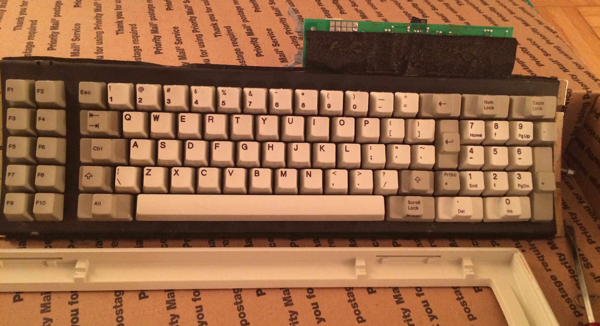

Here's the keyboard with the cover off:
Cover off
Cover off

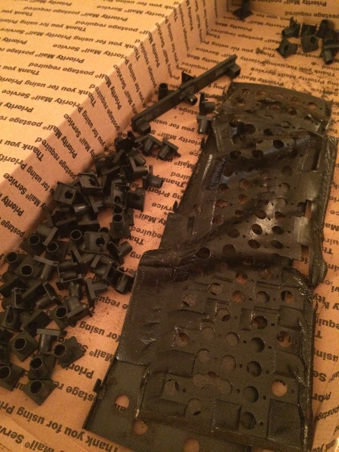

As you can see, not much remains of the foam:
Remains of the foam
Remains of the foam

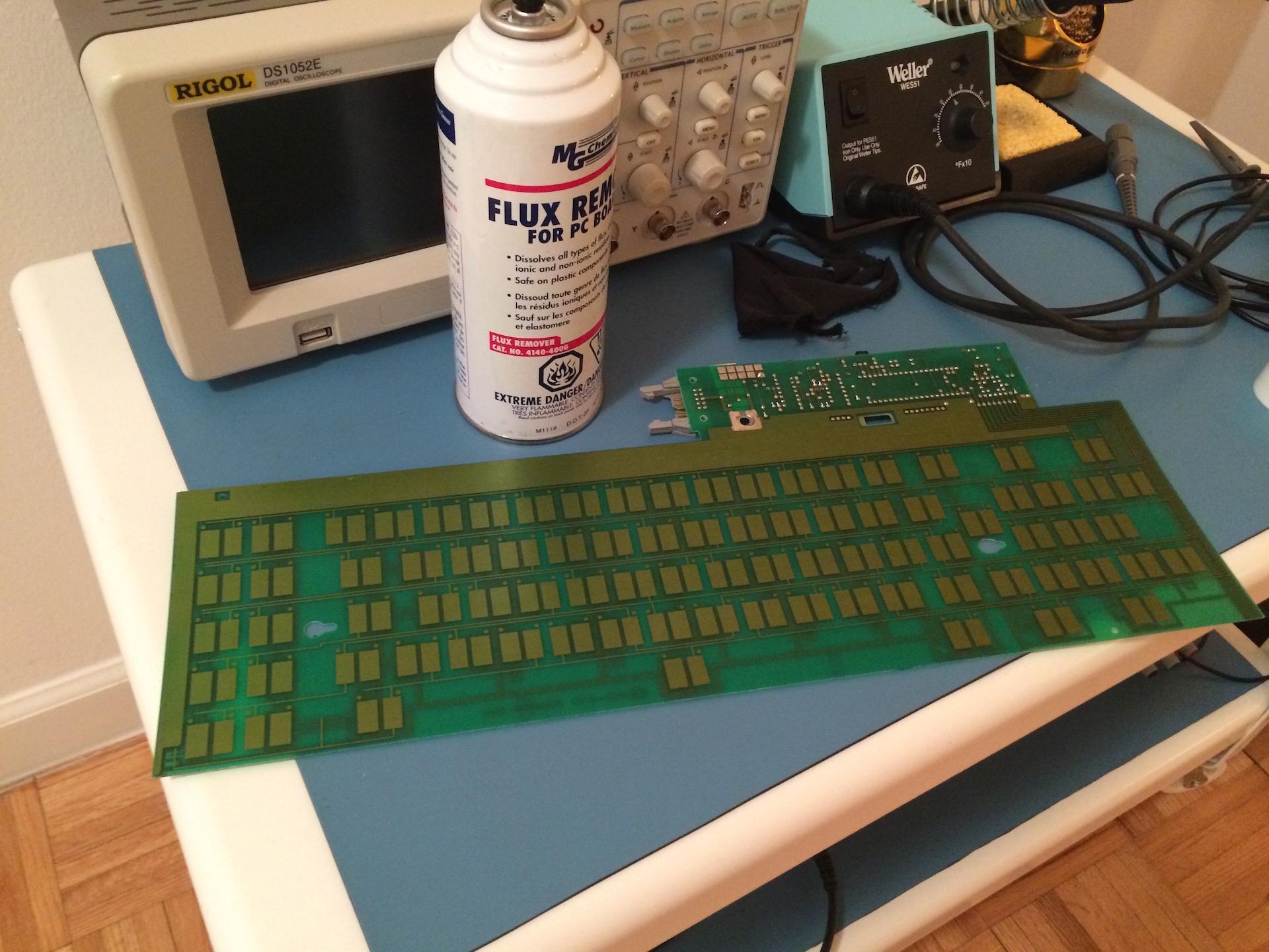

I could get all the gunk off the PCB with PCB cleaner:
PCB
PCB

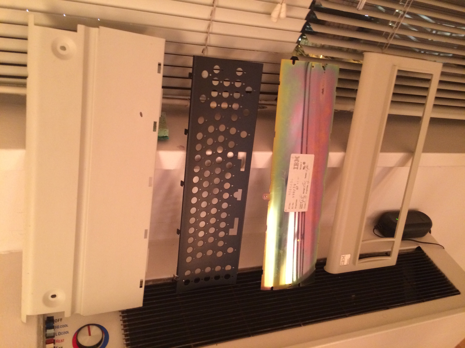

These got the oldschool dishwashing liquid and sponge treatment. I dabbed them off and dried them with a hairdryer set to cool:
Nice and clean
Nice and clean

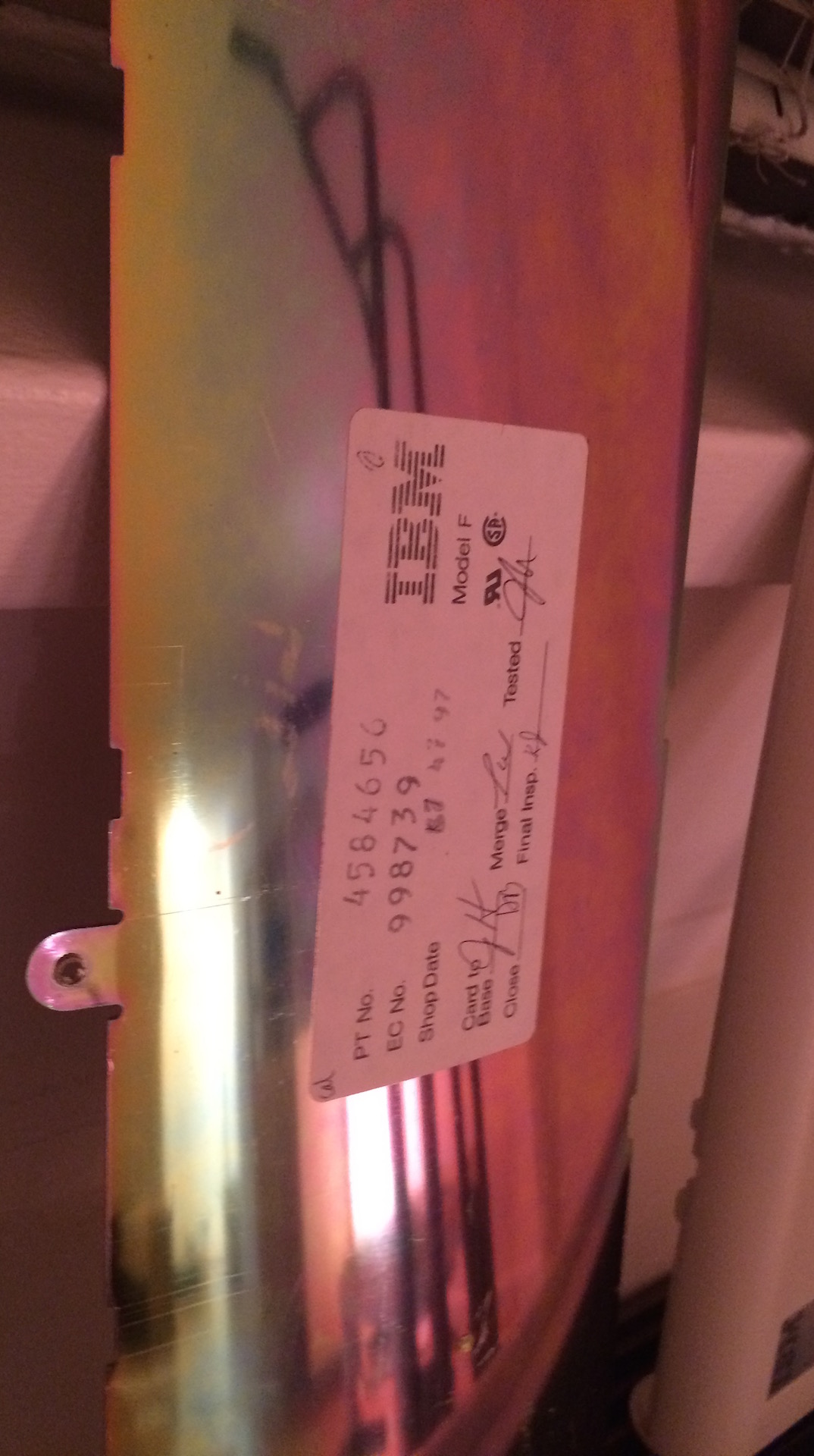

Here's the factory label. Nice! I took care not to damage it while cleaning the plate:
Factory label :)
Factory label :)

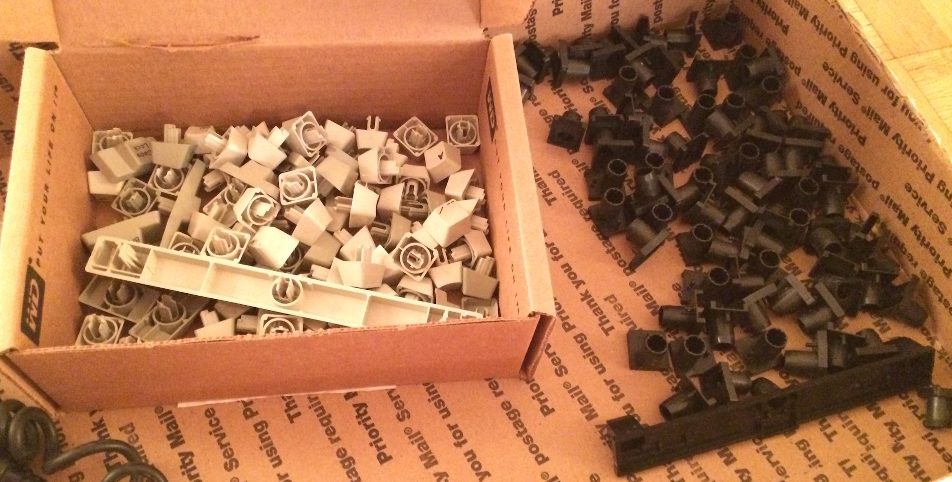

I need to get these clean... Those black switch housings still have a lot of that foam gunk on them. The keycaps are reasonably clean, but I'd still like to give them a quick rinse. What kind of method / detergent should I use?
These are still dirty

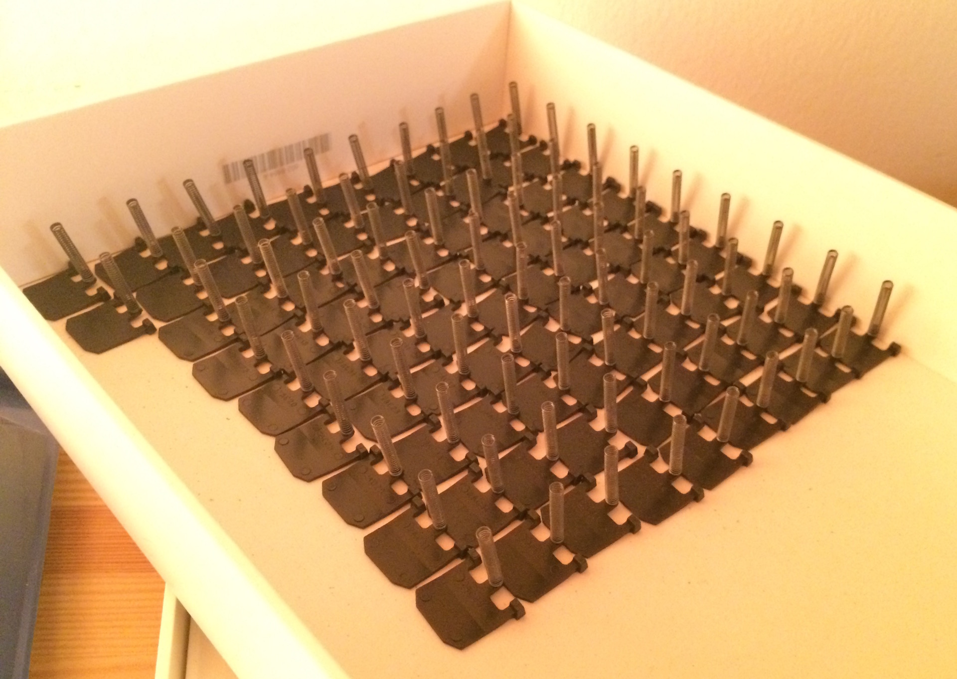

Alright, some update on the project... I thoroughly cleaned the keycaps and the barrels in a salad spinner, the conductive plastic plates by hand, and set the springs to soak in bicycle chain lubricant.
I'm currently waiting for the new silicone foam sheet to arrive from McMaster, and I'll get around to re-assembling.
