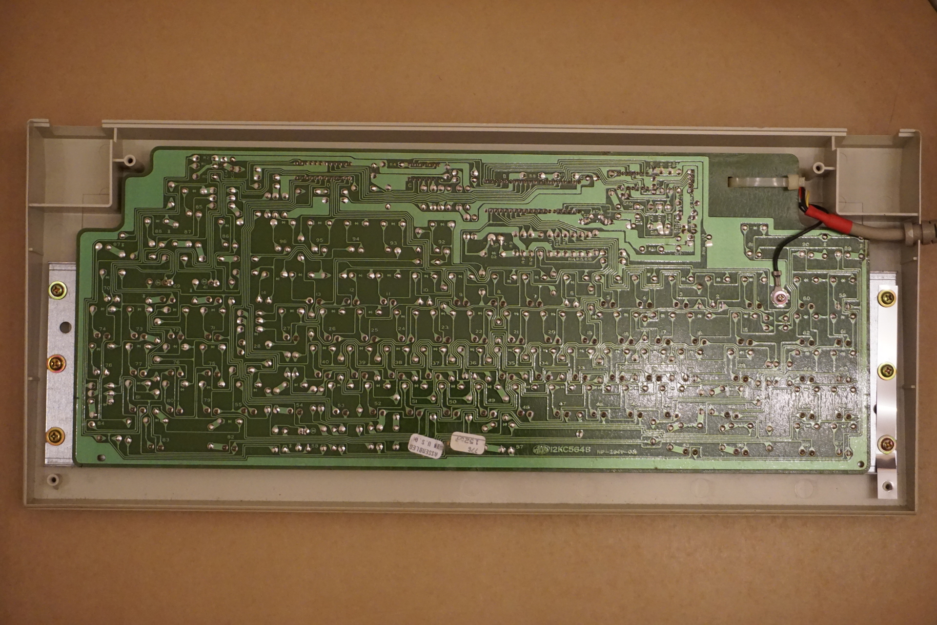

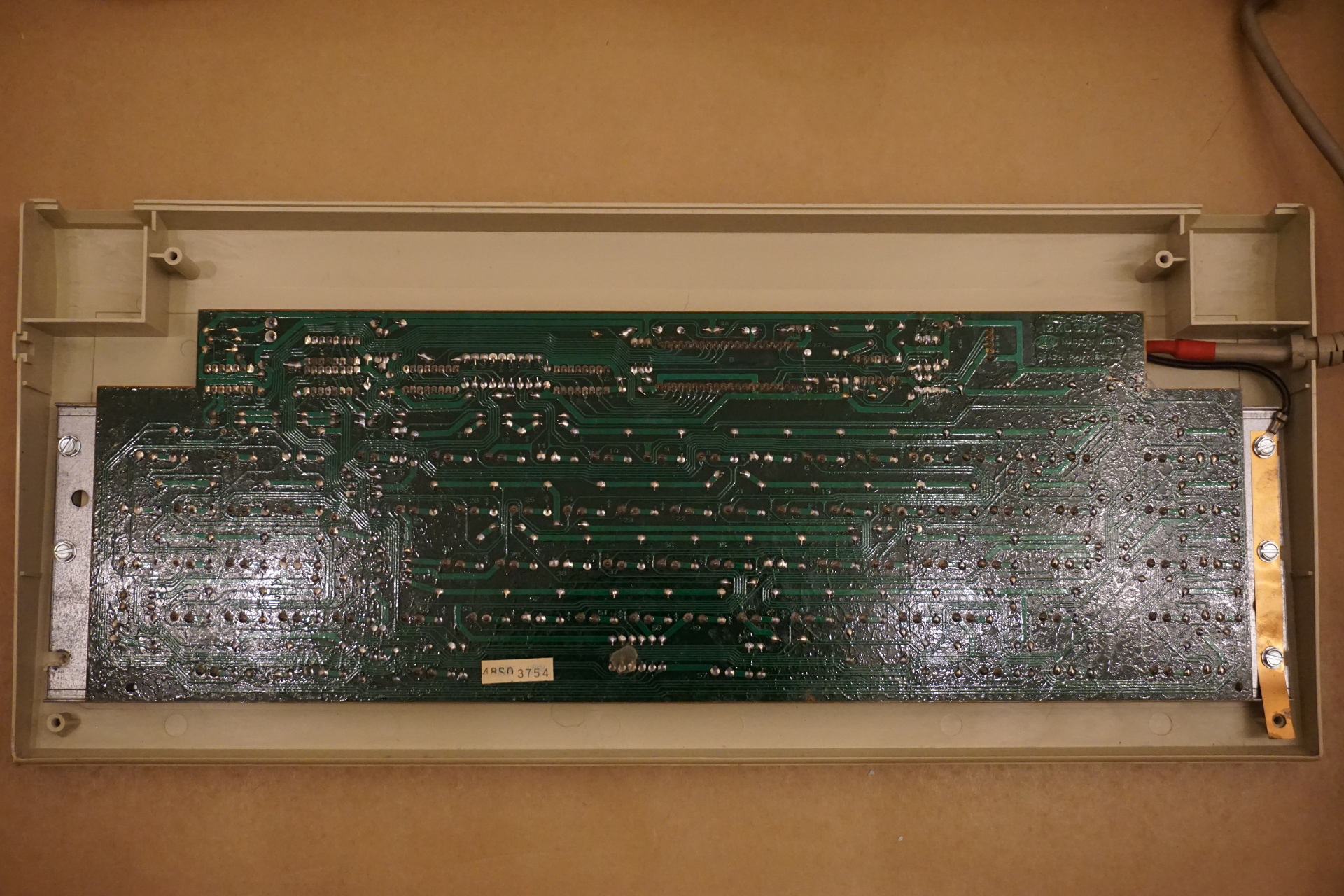

I always wondered about this whole "rounded edge" thing, so today I opened up my boards ...
rounded
angled
//gainsborough
ALPSの日常
23 Feb 2018, 01:38
Is the top one a beige label and the bottom one a black label?
Slom
23 Feb 2018, 06:31
//gainsborough wrote: Is the top one a beige label and the bottom one a black label?
Yes, exactly.
