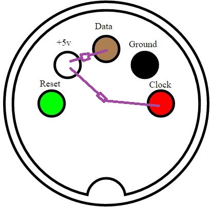

Try making your own Soarer's Converter using a Pro Micro or similar, and try these two things:
1. Use a pull-up resistor on the data and clock lines. I don't know if orihalcon's converter does this.
2. Wire in the reset line. Orihalcon's converter certainly does not do this.
These two things will "fix" Soarer's Converter on many ornery boards (IIRC the Leading Edge DC-2014 is one of them).
If that doesn't work then it will take some protocol reverse engineering.
ohaimark
Kingpin
29 Feb 2016, 17:24
So you need to bridge a resistor from the +5v line to the data and clock lines?
Edit: I have the requisite 1/2 watt 1K Ohm resistor.
Edit 2: image.
Edits 3+: fixed image.
Edit: This is a view from the MALE side of the connector.

You'll want to use two separate 1K Ohm to 10K Ohm resistors on the data and clock lines, not one like I had before.
The TMK firmware recommends 1K Ohm, so that's what I'm using.
Just remember not to actually put the resistors inside the DIN connector -- the image is meant to show what lines need to be connected in an easy way.

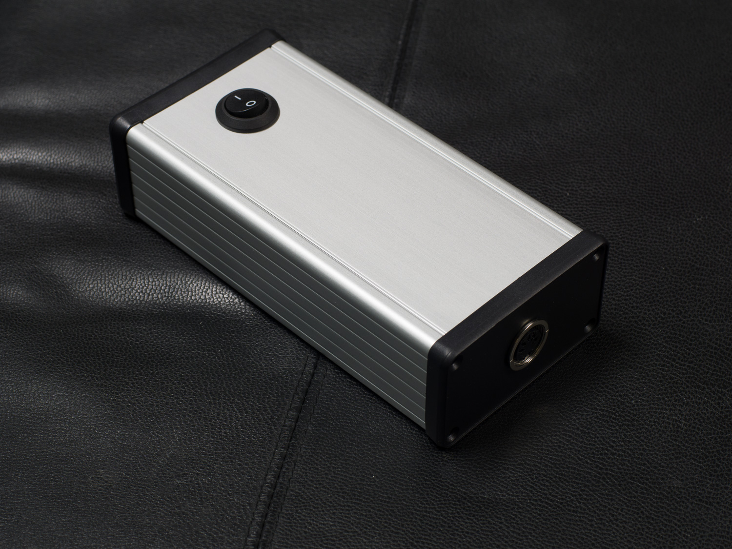

Here's the enclosure... It's huge, but that just leaves room for a switch and more ports later. 8-)
I want that Teensy here NOW.

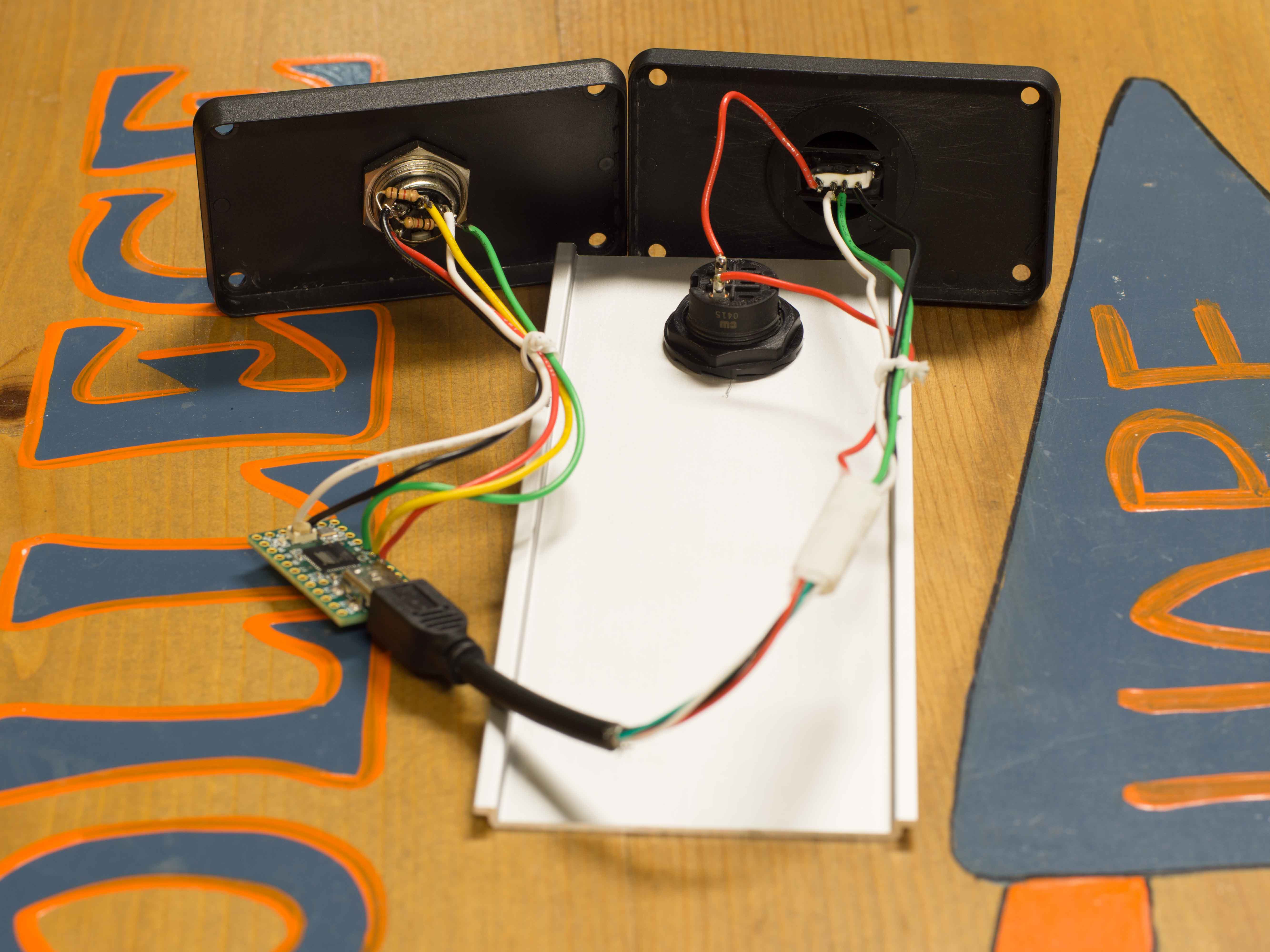

After a finger of fine Scotch Whiskey (celebrated my 21st birthday today -- I'm legal to drink), some soldering, and a few tests I reached two unexpected conclusions:
1) With the reset cable and pull-up resistors wired, both of the "Black Label" Zenith 100-1886s work
2) Both of the "White Label" Zenith 100-1860s DON'T work
Elaborating on point two:
I tested the 100-1860s using a Blue Cube, Orihalcon's converter, and my converter. None of the three work. With my converter, the keyboards reach a point where the speaker inside can make clicking noises when keys are pressed for a few seconds. After that, however, the keyboard fails to respond in any way. During the few seconds when it can make clicking noises the computer doesn't register any keypresses. The fact that it can play clicks on its speaker tells me that power is probably not the issue, though it could be.
The fact that 1860s work with different controllers, as itzme mentioned, makes the following options likely:
1) The keyboards have a slightly different protocol that "dumber" or "less strict" converters can still use
2) The cords are still so stupidly long that it messes up the voltage/data
3) The keyboards have a part that has a high failure rate
4) Something else is going on (speculate, please -- I'd value some... input [dad joke] from other members)
Note the two pull-up resistors wired to the back of the DIN connector.
