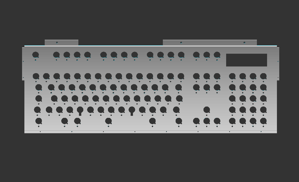

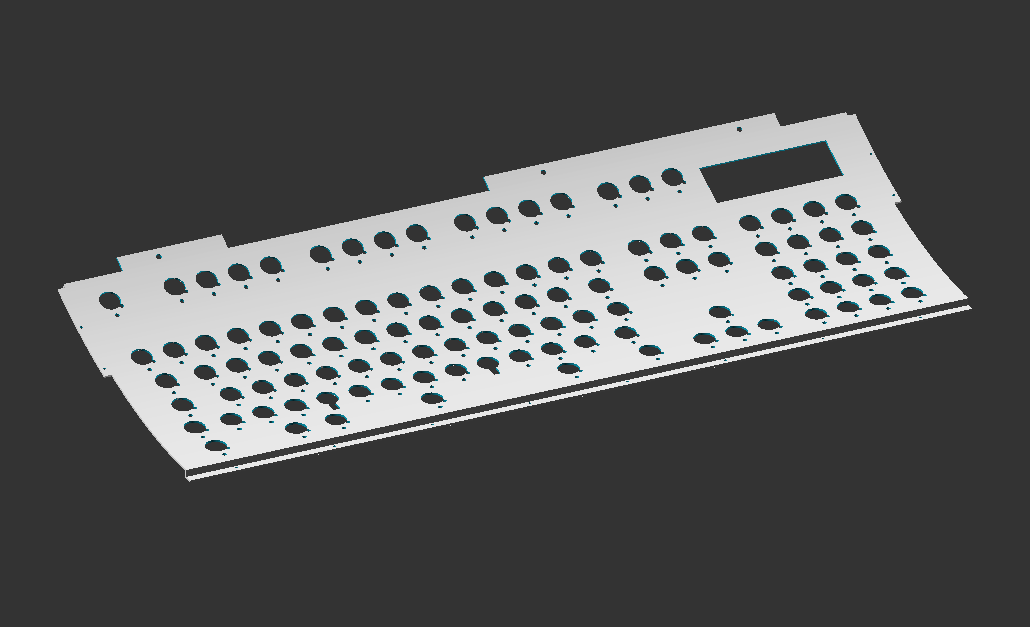

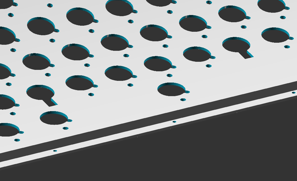

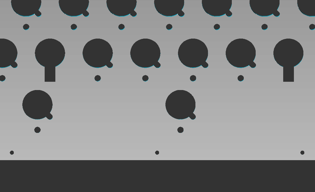

lot_lizard
01 Jun 2016, 21:02
Khers wrote: Why not add support for both barrel types?
The top plates for the 84 and 101 key layouts have updated cutouts to support both types of F barrels. This hybrid cutout won't be on the functional metal prototypes I am putting together in the coming weeks, but will be available going forward after that. So this opens up the opportunity to use 4704, F122, and Ellipse barrels until we can get the barrel production bit sorted out. Attaching renders of the 101-key only below, but will eventually update the OP's. Also, the Big Blue Saw order for the 101-key top plate was just shipped. Should have some progress there early next week.
Additional renders (close-ups, etc.)
101-key top plate
101-key top plate
Top plate for the 101-key viewed from above
Close up directly above, with the spacebar stabilizer barrel cutouts as well
emdude
Model M Apologist
01 Jun 2016, 21:34
The thought did not occur to me until now, but I think you will need additional stabilizer cutouts for the '+' and the 'Enter' keys on the numpad to support the early Model Ms (1390131s, 1390120s, and early 1391401s) which used wire stabilizers for those keys.
lot_lizard
01 Jun 2016, 21:41
emdude wrote: The thought did not occur to me until now, but I think you will need additional stabilizer cutouts for the '+' and the 'Enter' keys on the numpad to support the early Model Ms (1390131s, 1390120s, and early 1391401s) which used wire stabilizers for those keys.
Awesome catch. It should be easy enough to have the inverted version of the current stabilizer barrel (those were likely going to be Acrylate prints anyway because of the cost of another mold). My prints for them deliver this week, and will know for sure. Again... great catch
