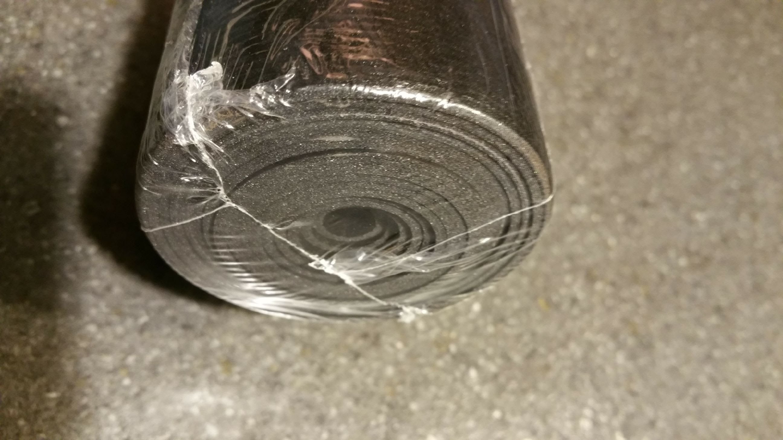

Btw, I forget if I mentioned this in a thread somewhere or just in a PM to you, but I did pick up some of that Harbor Freight shelf liner I had mentioned seeing a while back.
I tried it out on a couple of F122s and found it to work very well. It's very tough stuff, so I would expect it to hold up well, yet it's easy to cut smoothly with a sharp punch. Both keyboards I've used it on so far feel really nice. It's quite cheap and easy to get (providing you have a HF store near you), so I can recommend it to anyone looking for something a little better than the standard art foam that many folks use. The thickness is approximately 1.5mm uncompressed according to my cheapo mechanical calipers.
I have other materials here as well, but I'm planning on using this HF shelf liner on a couple more F122s and some ATs too because I really like how it performs. I think there's enough in each roll to do at least 8 keyboards, or maybe more if you do smaller boards. I believe I can get four F122 foams and four AT foams out of this one roll, and it only cost $6.99, if I remember correctly.
Here is the HF foam in case anyone wants to try it:

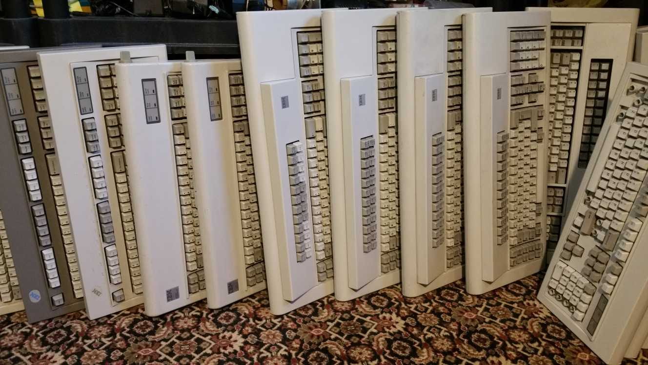

...And here are a few keyboards waiting to be cleaned up and refurbished. The two ATs and four F122s in the pile will get foam:
Waiting for Refurbishment.jpg (139.77 KiB) Viewed 4975 times
I have a bit of work ahead of me, but eventually I'll get most of these fixed up and back under folks' fingers. ;)
What would be better about this material?
Art foam at Michael's is made for scrapbooking and is acid-free, and you can do a 122 or 2 XT/ATs out of a $1 sheet.
Personally, I like the firmness and texture of the closed-cell foam, even though IBM used open-cell foam originally. Admittedly, the firm closed-cell foam may marginally dampen the sound, but I think that it also tightens and firms up the feel.
ekeppel
03 Jun 2017, 00:01
fohat wrote: What would be better about this material?
Perhaps I shouldn't have said 'better than', since foam preferences vary so widely. I know that many have had great success with art foam, so I don't mean to imply that it's bad stuff or anything. I just happen to prefer this material myself.
The HF shelf liner is strong, squishy, and rubbery, which I happen to really like. It springs back slowly when compressed, rather than simply crushing, so I get the impression that it 'hugs' the barrels in similar fashion to IBM's original material.
When I open up a Model F for the first time, I often see the original foam has formed itself around the barrels and almost become one with the board. I like the fit and feel that this foam provides because it is somewhat sticky/grippy much like the IBM original. It's almost memory-foam-like in its qualities. That may not be everyone's cup of tea, but it has been working well for me.
