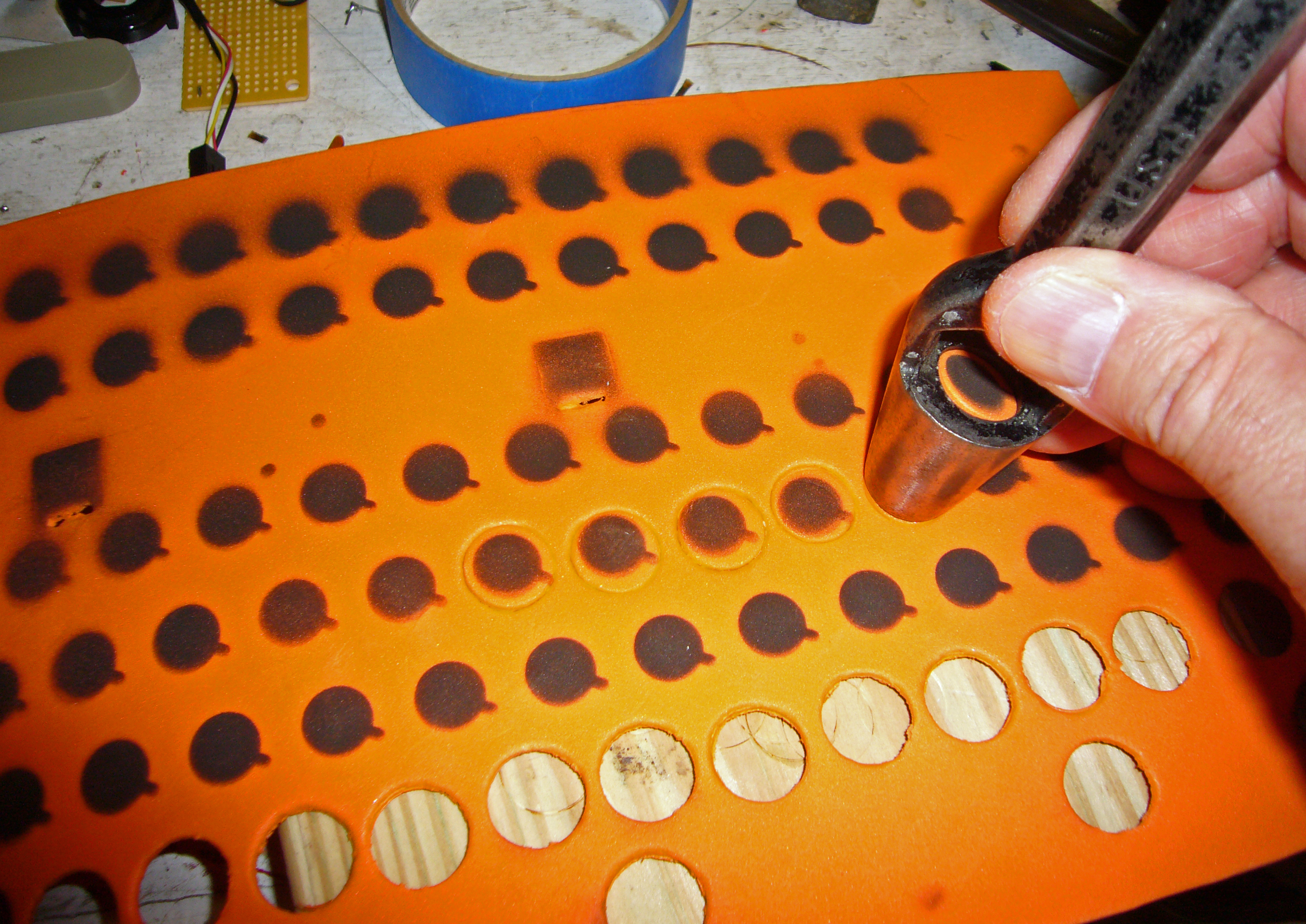

26 Feb 2017, 16:14
Using sharpened hole punches can give very neat results. Sharpening is necessary, stock cutters expect to be whacked with a sledgehammer, which is overkill for foam! The post shows me gently cutting polyethylene foam with a twist of the fingers only. I discarded polyethylene in favour of neoprene foam and that also cuts very neatly. Neoprene foam sheets so far have proven to be perfect.

The hole punches are suitable. You need to search for neoprene foam (or sponge) sheet, 1/16th inch thick, without adhesive. I tried to search for it on eBay in America, but it seems the only available 1/16th inch thick sheets available are all covered in adhesive, which I suggest you avoid. This is the type I bought in the UK, 1.5mm x 300mm x 500mm. The solid neoprene rubber sheet is too hard and will not compress near enough to be a suitable replacement.

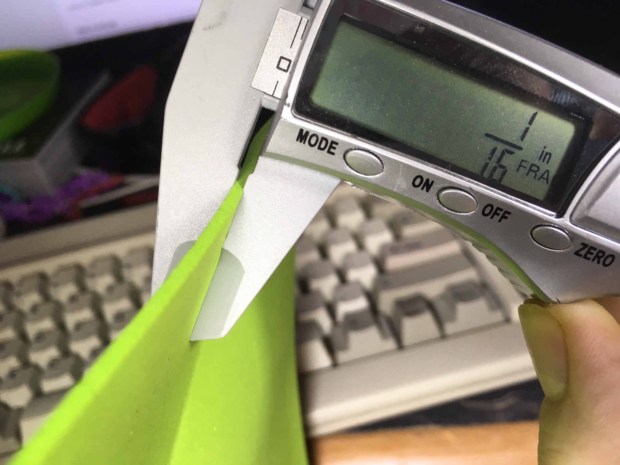

just_add_coffee
27 Feb 2017, 02:45
fohat wrote: McMaster-Carr is the go-to place for all your weird hardware needs.
If 1/8" will work, then I can do either McMaster-Carr or Ebay. I can't seem to find 1/16" neoprene-foam-sheets from a US supplier.
__red__
27 Feb 2017, 04:36
My money would be on "No" unless neoprene will compress 50%.
