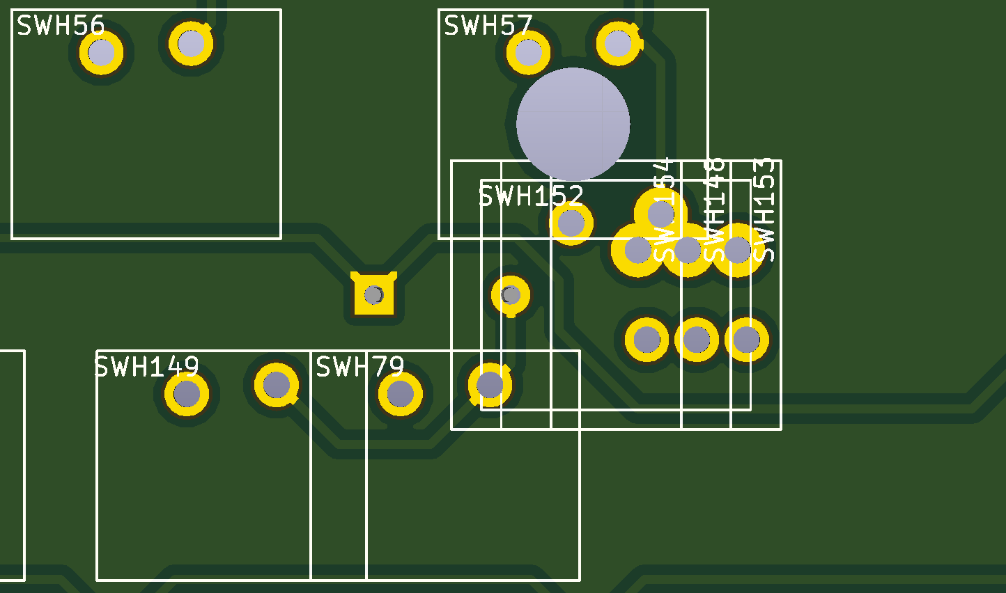

If anyone can please give me feedback on if I should put a reset switch on the topside of the board alongside the one already on the Teensy++(which will be mounted on the bottom of the PCB). I don't know if it would be useful as the PCB is shorter than the originals, so the models with the doors won't have any PCB below it, and I won't be extending the board as that increases cost by quite a bit as I pay for the max dimensions, even if it is cut off.
Also I wanted to say that the plan is to have a black PCB with ENIG(gold), personally hate green PCBs so I will not be doing that.
Tomorrow I will wrap up the switch plate layout and do the final look over on the PCB to make sure everything is placed properly and to make sure I didn't forget anything. And if no one wants the switch, then I will go ahead and launch the GB on Thursday(3/8) at noon central time, and keep it open until 3/14 at midnight.
As I mentioned early on, the quantity is very important, if I only get 11 orders, I will either have to order 10 or 15 boards, which is hard on me as I don't want to kick people out of the GB, but I also can't afford to have extras and unless people are willing to buy the empty slots before I place the order, I will have to make a hard choice. I will have a live list here with the current number of orders, and the empty slots until the next price drop.
If anyone has any feedback before the GB is opened about a design change, please let me know, but also make sure to check back for my response so as to not delay the GB if I have an important question.
Thank you all for the interest!!!
BlindAssassin111
07 Mar 2018, 07:41
Also need to mention that this GB will have plate files ready so you can make a custom omnikey Ultra or smaller 100% alps board using this PCB and the plate files.
All omnikey variants supported, even added ANSI and ISO support to further customizability(360+ possible layouts)

I went ahead and posted the GB page on GH as it was easier to have it seperate from this IC to write it all up. It hasn't been approved yet, I have update the OP of this thread to include the information. Tomorrow marks the start of the GB, so good luck everyone!!!
BlindAssassin111
08 Mar 2018, 19:01
GB is Live, You can begin placing orders. Hope we get a lot of interest on this because it was quite a bit of work, really want this to reach a lot of people.

Though since I'm not super technically inclined, I suppose I still do have one: is this PCB mainly in case we need to replace anything/want to configure different layouts?
So I guess its no fuss with the 102. :) Also you can have a preview of the board ;)
BlindAssassin111
08 Mar 2018, 22:48
idlethock wrote: Was gonna respond with a follow up question, as I swear it said something else. :lol:
Yes, that was the goal. My omnikey pcb was messed up (corrosion under the silkscreen and pads broken off) and I thought that others may want one, and then it evolved into supporting other layouts as people asked if I could. There is no fuss at all with the 102, the board was designed initially for my Ultra T, and made to work with everything else from there.
