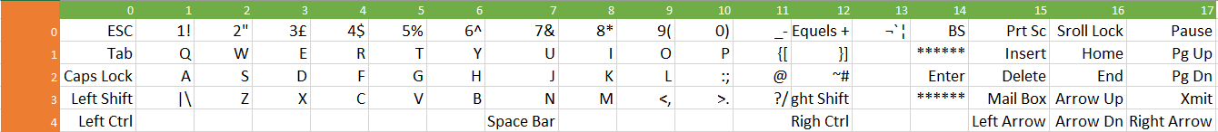

OK so here's a Neater version of my matrix and layout that I want let me know what you think guys.
Also had a look at the links you posted and i don't think there is a keyboard template that matches mine
Anakey
- Location: UK
- Main keyboard: Planck
- Main mouse: Cyborg Rat 7
- Favorite switch: Alps skcm white
you would need to take the layout of something like a full size and then move, delete and adjust the keys to fit what you want. click the key you want to change and there box below allows you to change it. move keys with arrows when you have them selected either individually or drag box around the keys.Fkazim wrote: 27 Sep 2019, 11:20 Also had a look at the links you posted and i don't think there is a keyboard template that matches mine![]()

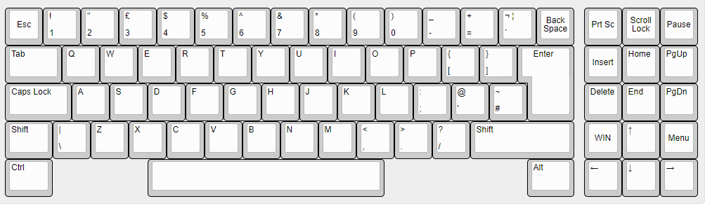

Thanks will do tonight btw I have now got all the raw data for the layout of my keyboard by using one of the websites you guys linked. so tonight I should solder wires to the matrix pins?

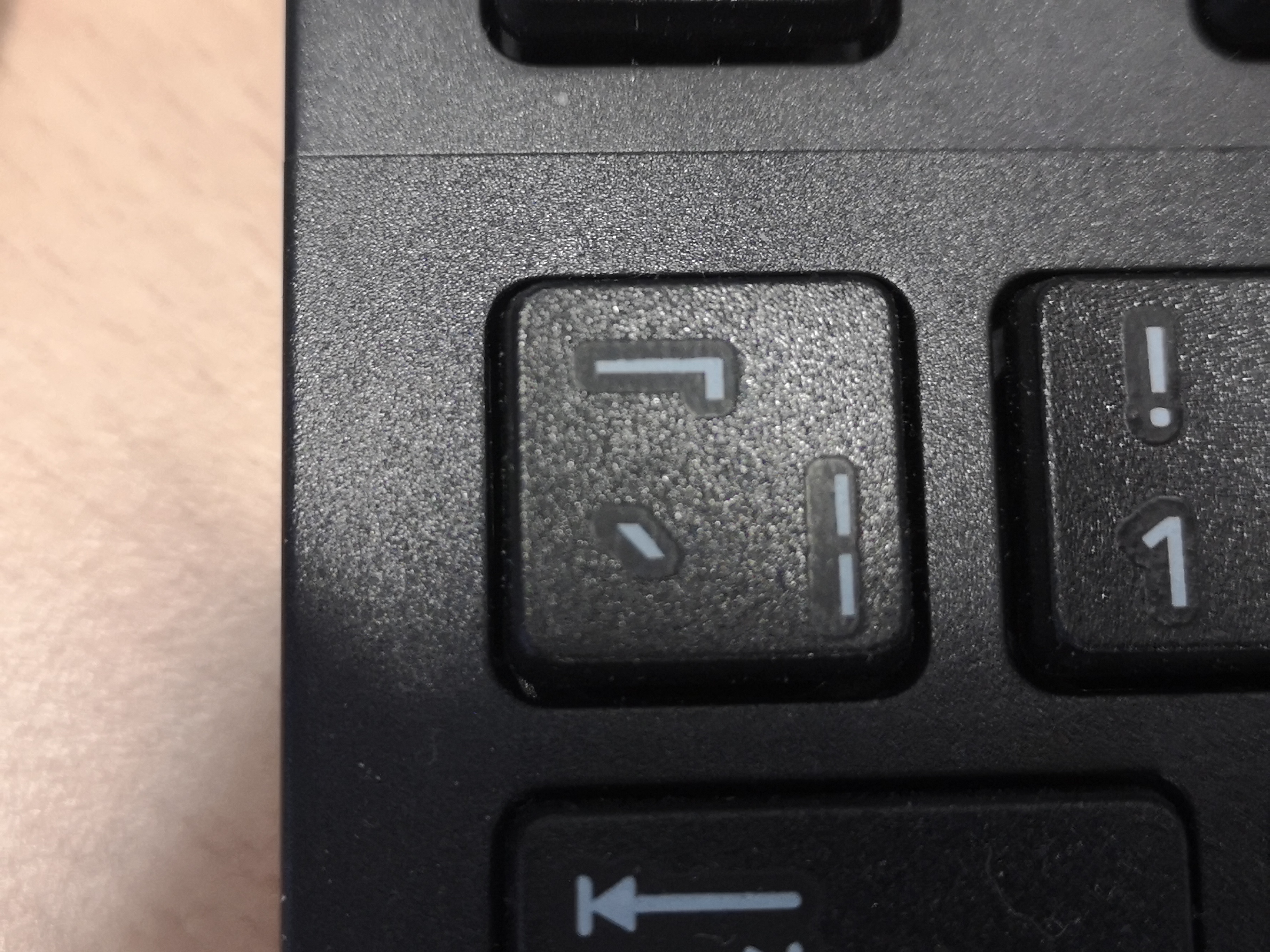

Also how do I make this key look like that in the layout creator website? The key in question is the one on the left side of Backspace.
Thanks.
Thanks.
Anakey
- Location: UK
I guess you would put the | key in the bottom right, though it will not matter for generating the keymap as that key itself is just seen as KC_GRAVE where the `~ key would be if on a US board. Windows would then translate that key into the regional graph.

I had a look at that but how would that code be incorporated into what I want and how would i add it to the code generated from the website which is this.
[{y:0.5},"Esc","!\n1","\"\n2","£\n3","$\n4","%\n5","^\n6","&\n7","*\n8","(\n9",")\n0","_\n-","+\n=","¬ ¦\n`","Back Space",{x:0.25},"Prt Sc","Scroll Lock","Pause"],

imo you should get it working with a basic keymap first, then go back and do your extra layers. Otherwise if it has problems you might not know if it's the firmware or the board.
Anakey
- Location: UK
that code from the keyboard layout editor site is then input into the kbfirmware.com site in order to then make the files that would be needed. the code i linked would need to be added to one of the files that is generated by kbfirmware.com
