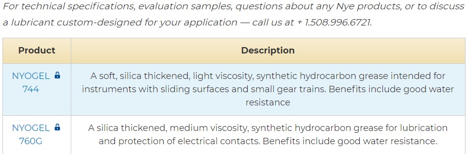

From the description from the manufacturer perhaps 744 would be more suitable for this application?
https://www.nyelubricants.com/nyogel
NeK
11 Oct 2020, 22:57
JP! wrote: 11 Oct 2020, 15:34
joebeazelman wrote: 11 Oct 2020, 09:39 After a series of emails with the representative, and sending her the Threebond 2583G datasheet, she suggested trying their 760G formulation. She claims it's nearly identical to it and provided me with a summary along with a detailed datasheet. I figure others who are more knowledgeable might be able to determine if this maybe a suitable alternative as it is widely available and reasonably priced. At the end of the day, it's all about the feel.
I don't think so. The 744 says it is a *light* viscocity silica, whereas the 760 is a *thick* viscosity silica. I am certain that the viscocity of the original lube is thick viscocity as anything light does nothing. And this is reflected in the sliding feel, you can feel that viscous wax-like smooth sliding.

I may be the one who brought up 1855 in a PM conversation. Its TB description sounds, to me, well suited to this kind of use. The intent here is to lubricate sliding plastic, not metal electrical pieces.
I don't know if the "discoveries or utterly alone" comment was meant as a dig, but that is exactly what I would like. To either find out if these work well, or if they do not work at all for this use case. What better way exists to find out.. than to be the first to get some and try it? If we find out they do not work that is still a discovery.
NeK
02 Nov 2020, 19:19
Oh that makes sense. I had the same scepticism about the TB2583G and in fact I did mentioned my concerns here just some posts back. However, despite the official applications list of TB, the 2583G specs are very well suited for plastic to plastic lubrication, especially for the 1st gen switches that the stem was not slippery at all. Also they used it on the contact points of the stem with the metallic leafs as well. So it makes sense that they used the same for both points.
And I agree about the "not working" result it is indeed just as valuable. Because we can rule out one by one some possible "theories" until we find the one that does work. This is how keyboard science works hehe
Oh and about my remarks for the Google search, well I assure you that it was not meant as a "dig" at all or anything insulting, I was just being sarcastic and made a bit fun of our research.
My money is on the TB2583G and Nyogel 760G, but the funny thing is that probably a lot of dielectric silicone oil greases would be just as good if not better, so the journey does not end when we find the one that works, it only begins as we can try to find better or different ones that also work good.
PS. What I think is the important part of this grease type, that makes it work, is the oil (PAO) that is contained and its heavy viscosity in general.
