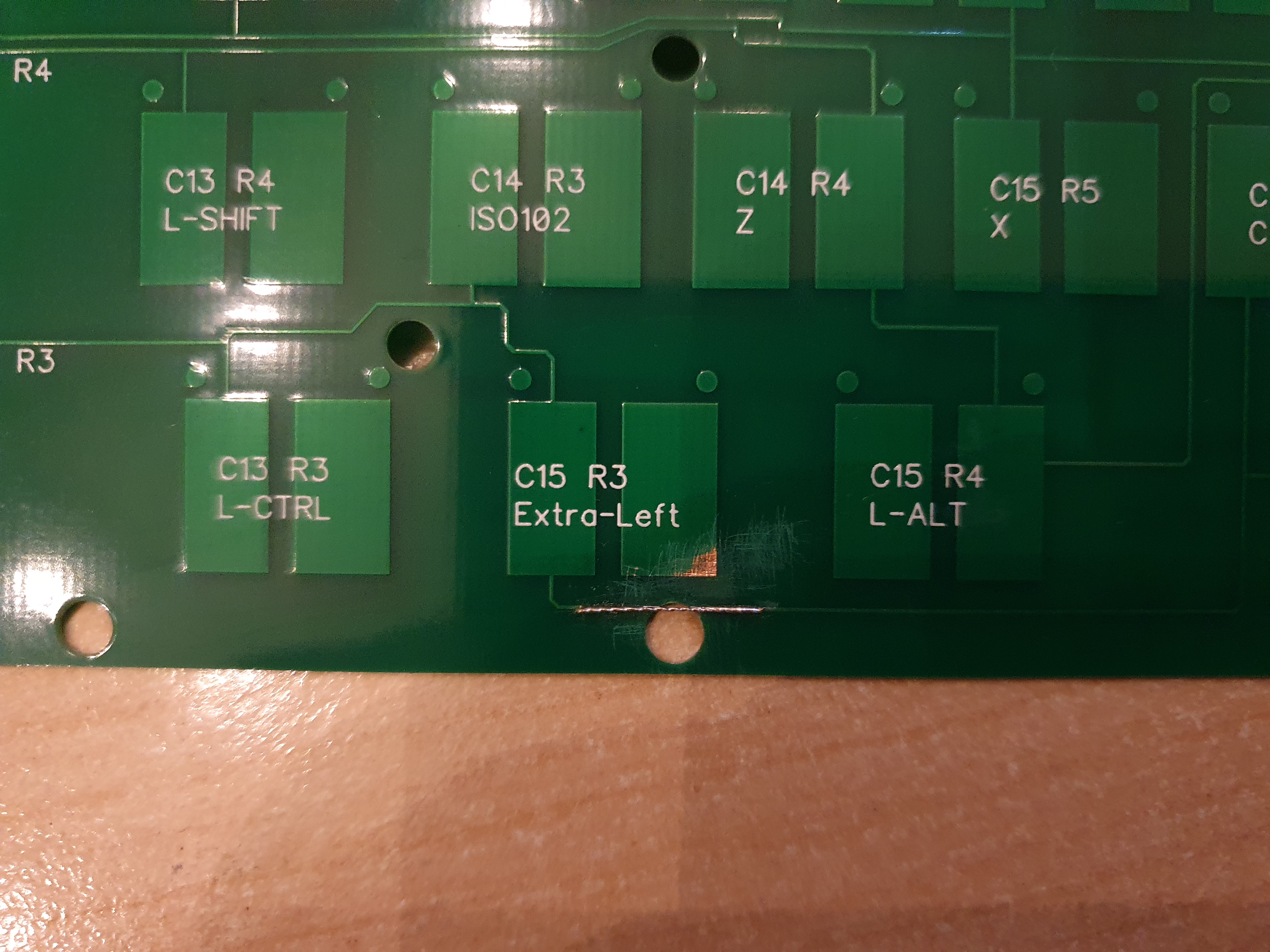

..oh, and next time do not silkscreen in the bottom 10mm of the pads - yes, it affects signal strength, and yes it affects signal strength negatively.
dcopellino
21 Jan 2023, 22:44
That's what happen if you don't apply a patch as I did
Here the solution I found as work around
22 Jan 2023, 13:26
Ouch! At least we know what to fix if this bites us. Tolerances are real; just a pity gig manufacturers don’t sanity check incoming orders against their known capability before shipping them out with predictable flaws.

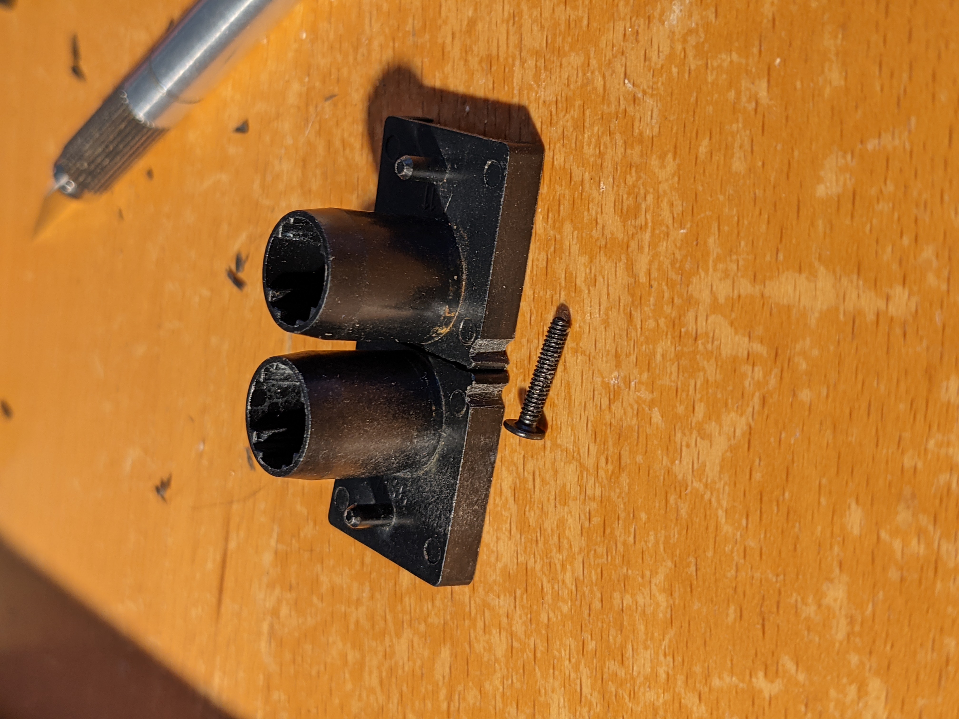

5. Insert barrels - If you want to use the screw hole in the middle of the alpha cluster, you will need to trim one upper corner of two barrels. You can place these barrels in the plate to visualize where you need to trim them. This screw is not required for functionality, but I recommend using it as it makes the assembly feel much tighter in the middle of the alpha cluster.
Here is a diagram showing an EXAMPLE of the cuts necessary in RED, with the alpha cluster screw hole in BLUE. The reason the screw is an M2 is to minimize the size of the cuts. I recommend you remove small amounts of material until the screws fit. It should not affect the functionality of the barrels in any way.
Here is a picture of how DMA trimmed the barrels:

dcopellino wrote: 21 Jan 2023, 10:40 My 2 cents advice, regarding my previous experience with jlcpcb, is this: pay attention to the circuit path highlighted here in the attached pic.
Mine was interrupted by the hole, and I had to patch it up
Thanks for pointing this out. I am visually checking each PCB before I pack it to make sure the holes are positioned correctly.
DMA wrote: 21 Jan 2023, 20:53 ..oh, and next time do not silkscreen in the bottom 10mm of the pads - yes, it affects signal strength, and yes it affects signal strength negatively.
Noted. I will alter the silk screening the next time I order capacitive PCBs.

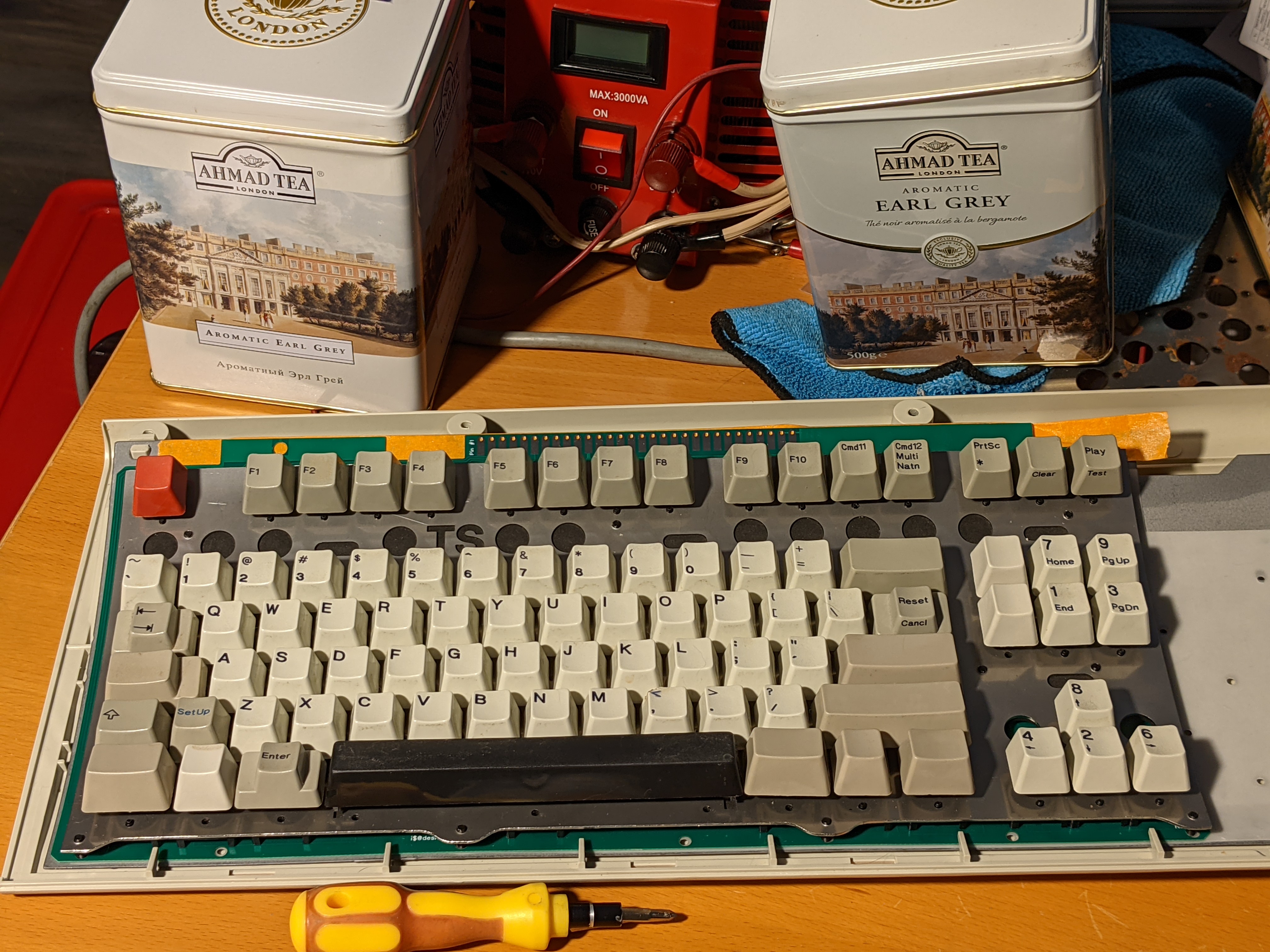

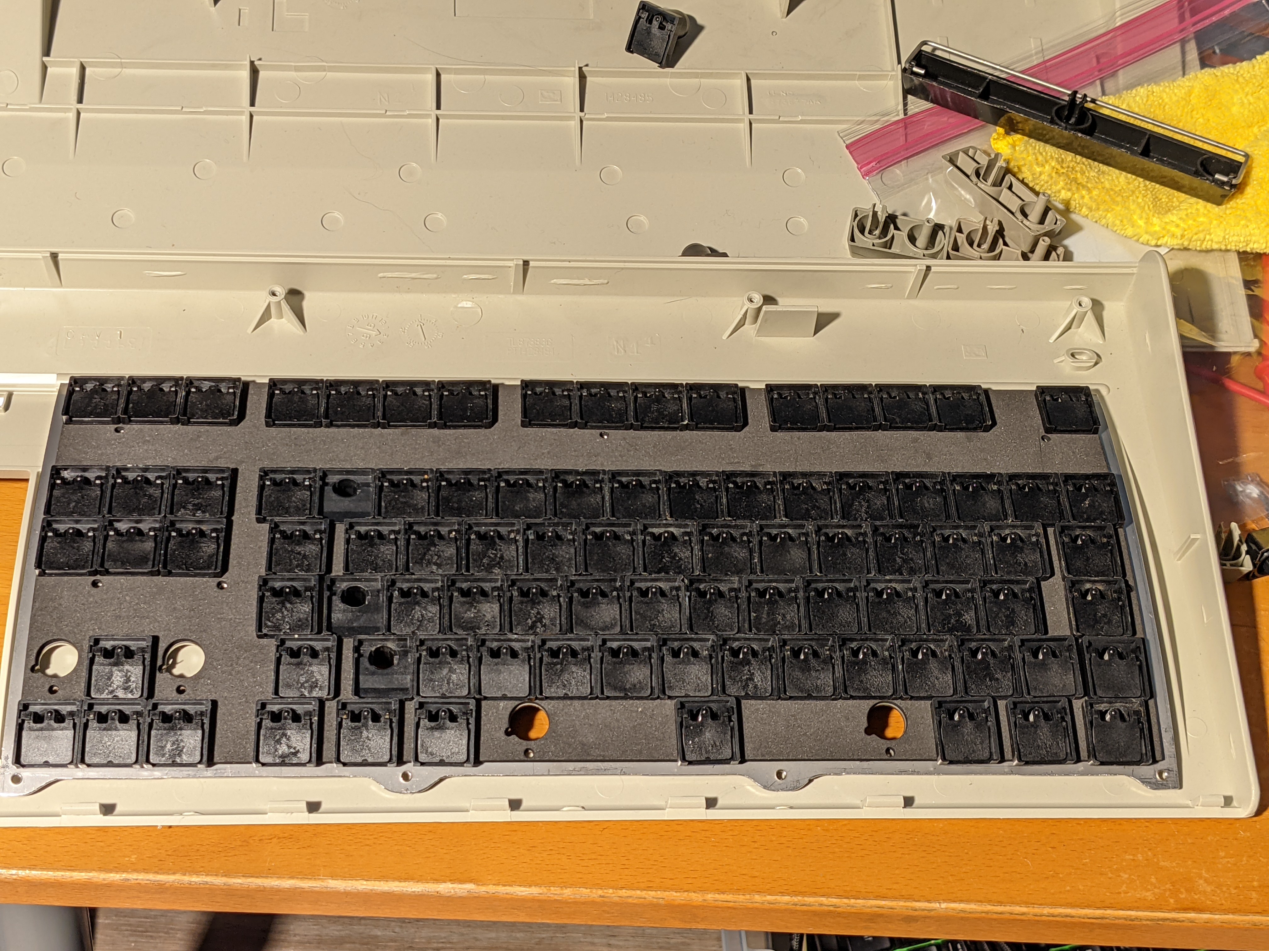

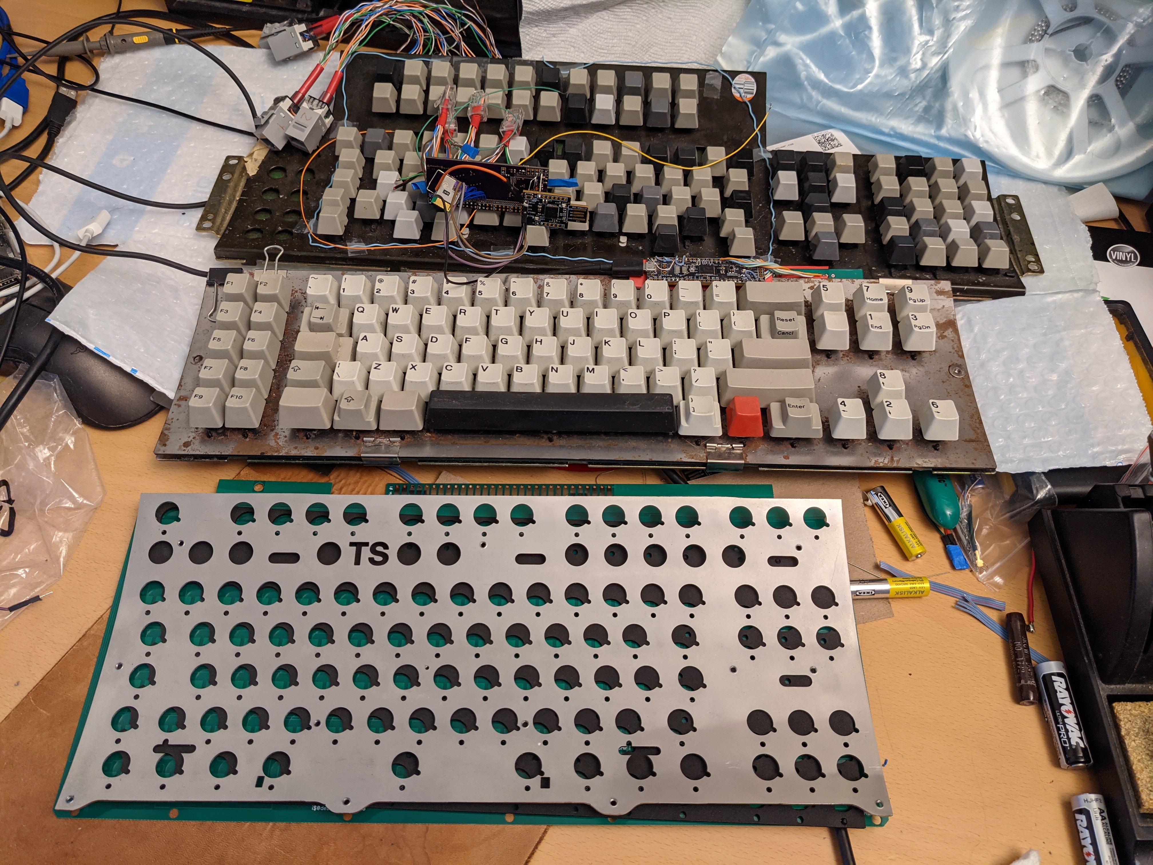

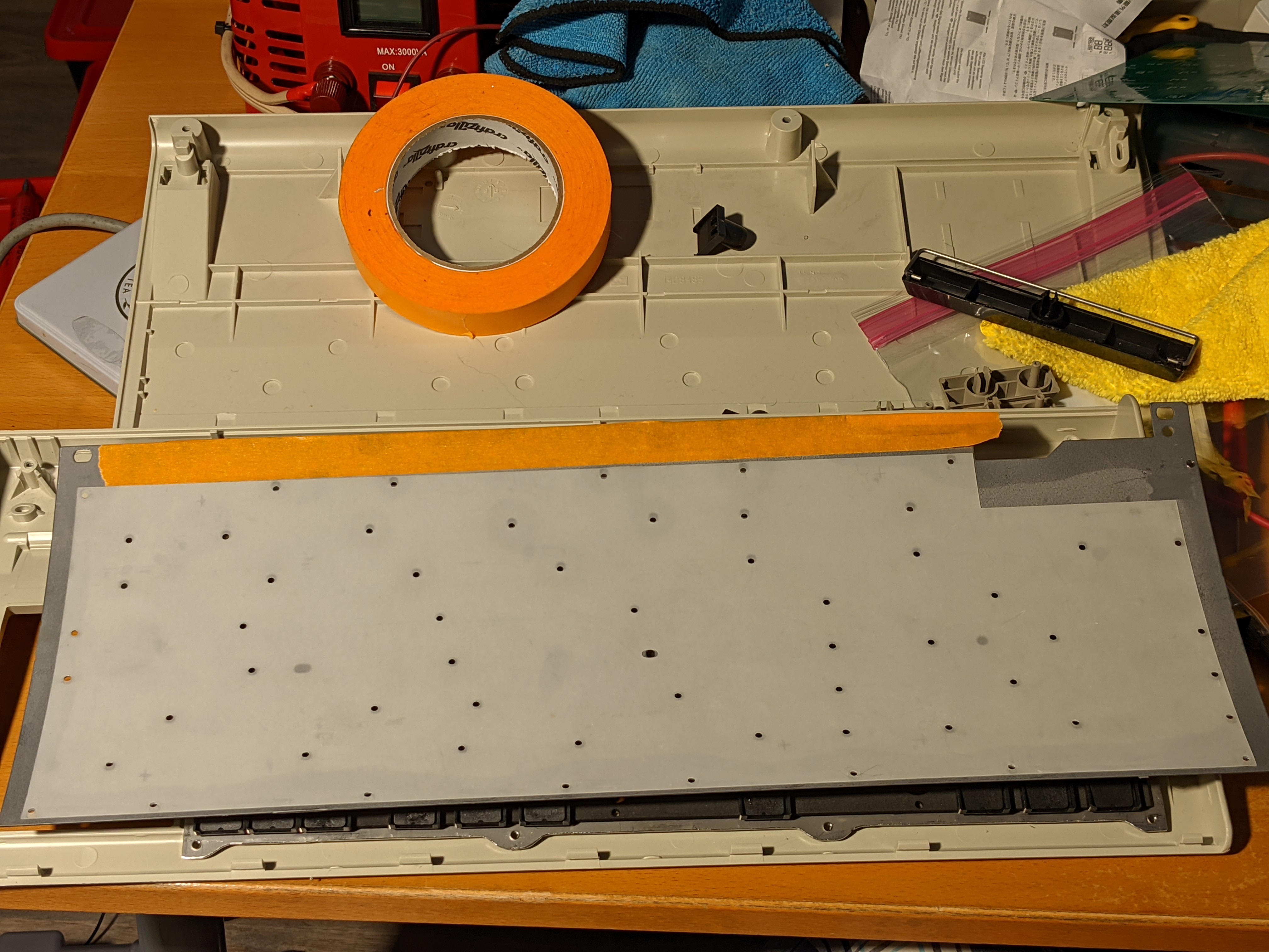

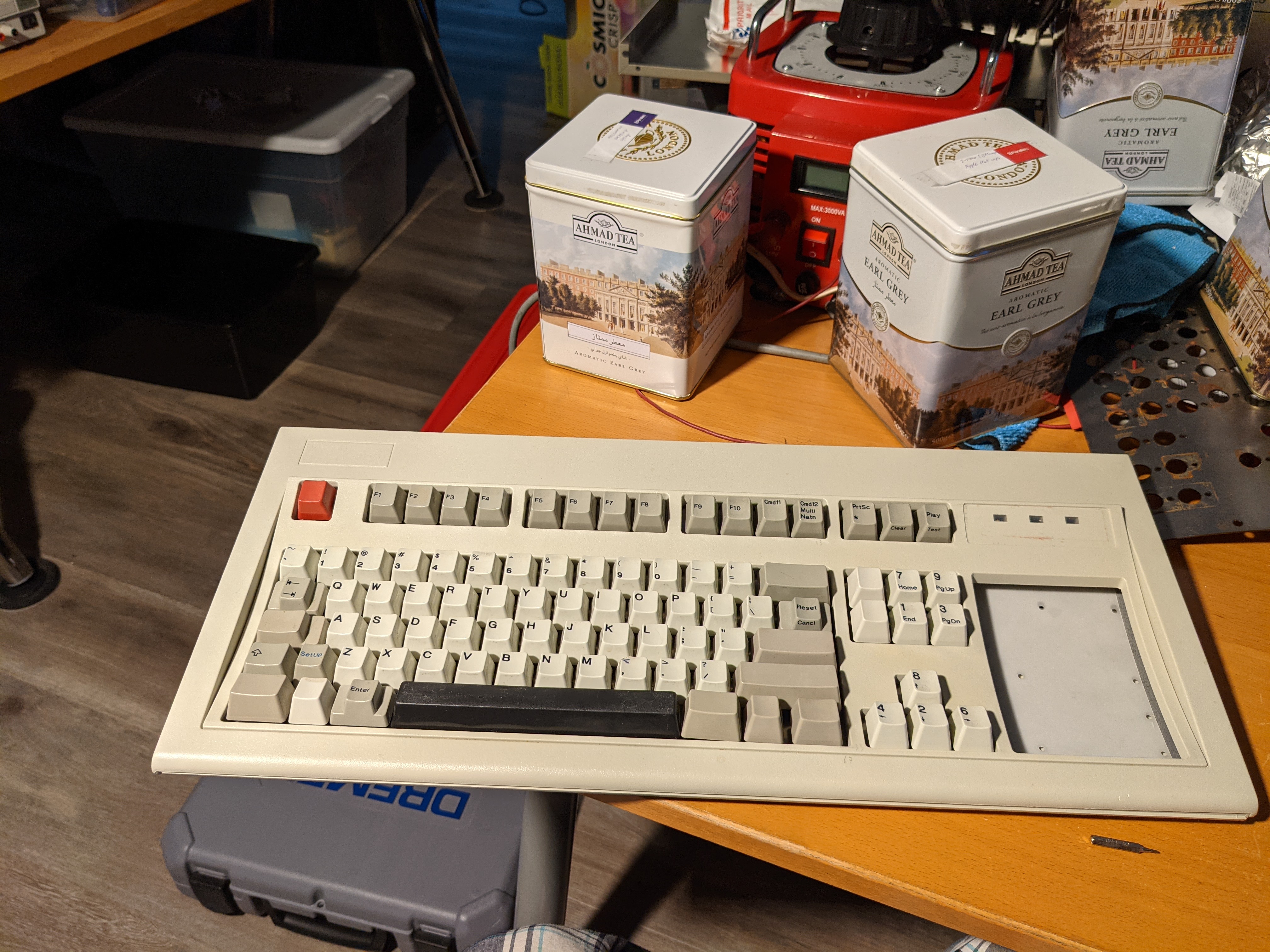

DMA
13 Mar 2023, 01:29
Aand it's done!
(yeah, it's an unicomp case. I don't have an SSK, too expensive)
Well, almost. Can't decide between soldering an USB controller and using right now vs soldering the BLE controller and constantly updating firmware on the primary keyboard..
Top-left foam hole is a bit offset relative to the plate hole, but nothing critical.
Stabilizers were clasping the stab wire a bit too strongly - five-second fix.
One can use top half of the keyboard case as a pedestal for the initial assembly:
The cuts for the M2 screw can be really small - no need to chop the whole corner of the barrel, just cut with xacto knife:
Insulation between PCB and backplate is crucial. I'm using the rubber-ish underlayment the unicomp had, plus some craft tape where it doesn't reach.
