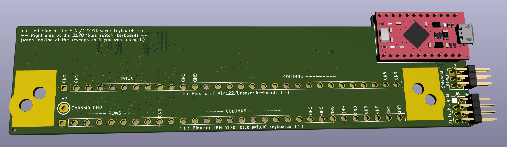

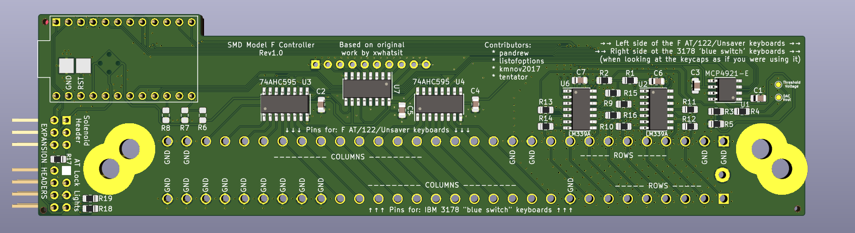

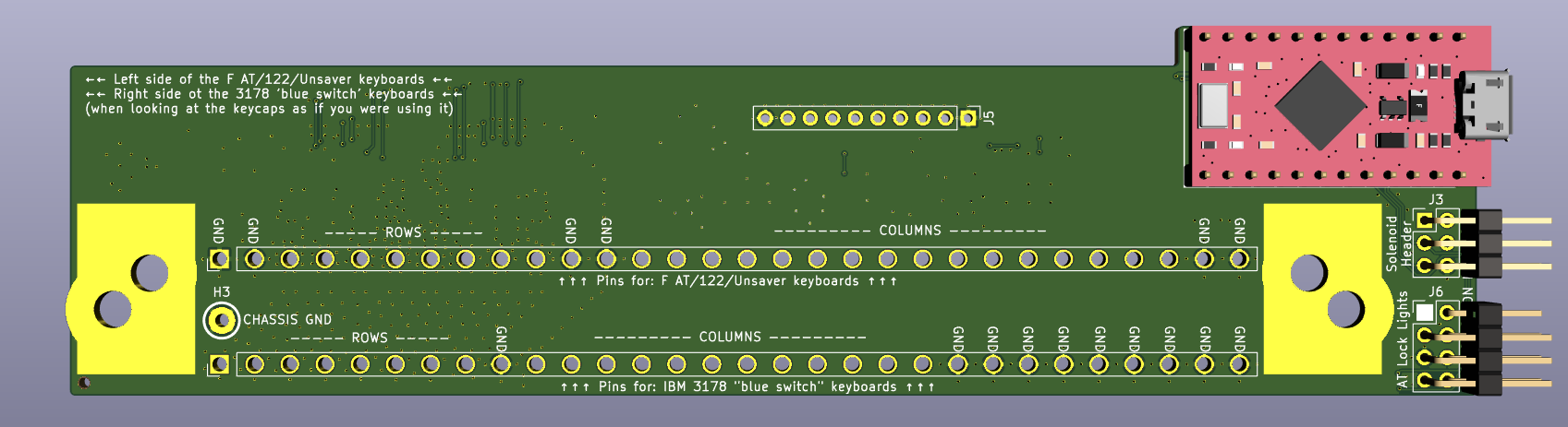

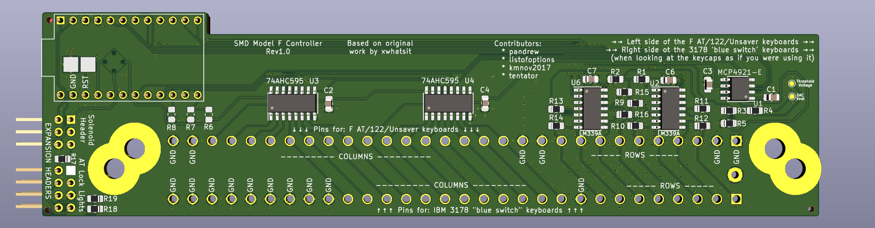

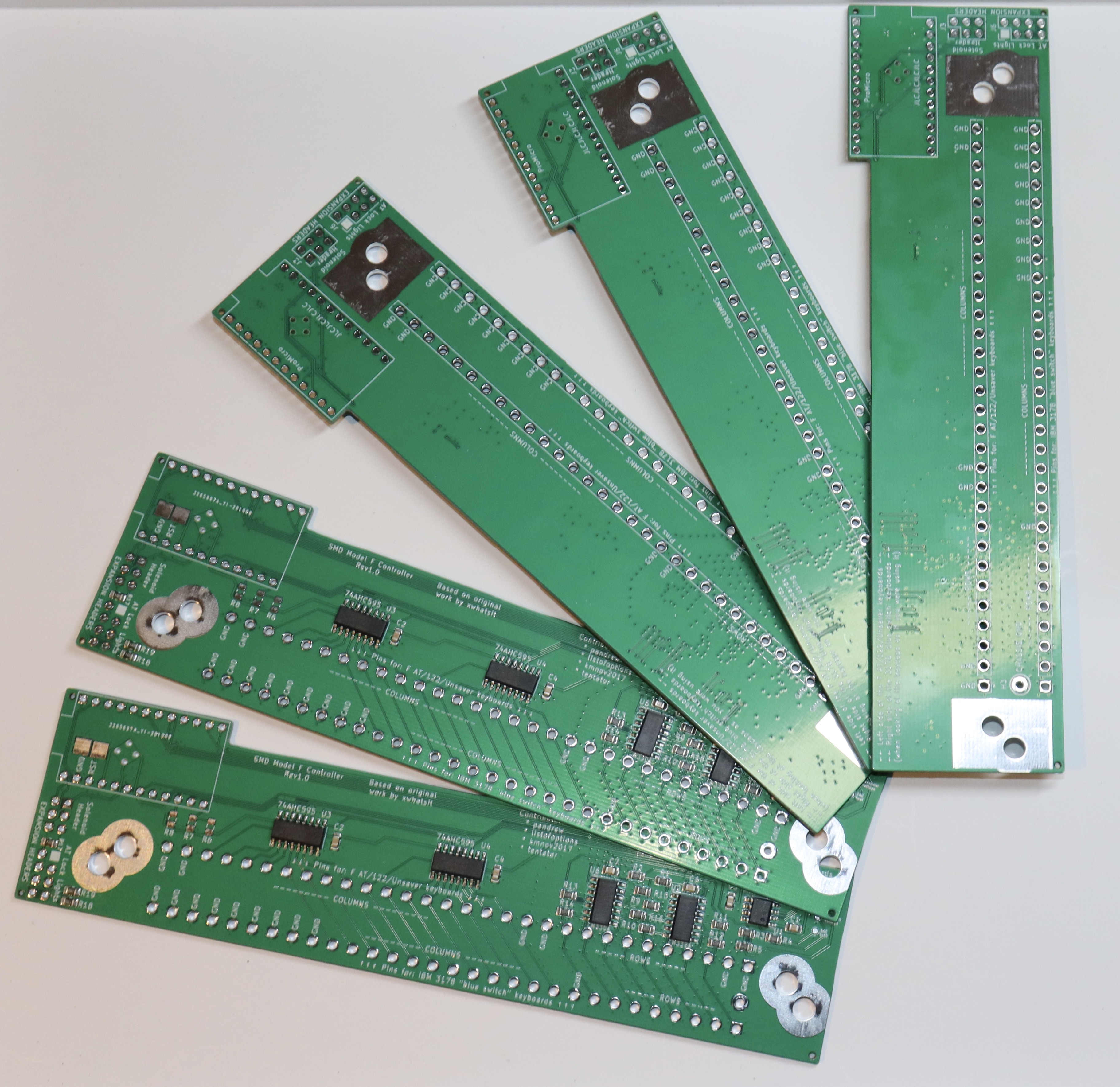

Two new model F controller designs are now available:
1) SMD Model F controller, supporting later "standard" model Fs, including: F AT, F 122, F Unsaver, and the "Blue Switch" 3178 Model Fs:
Github URL: https://github.com/purdeaandrei/SMDModelFController

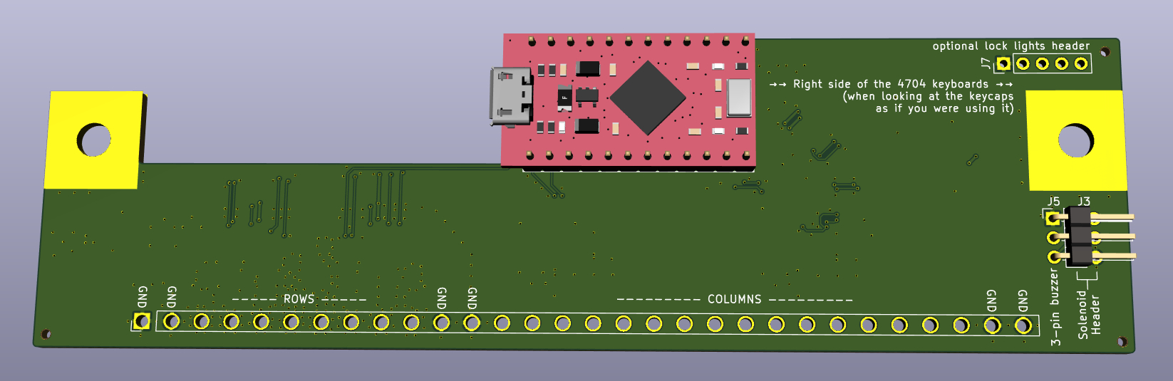

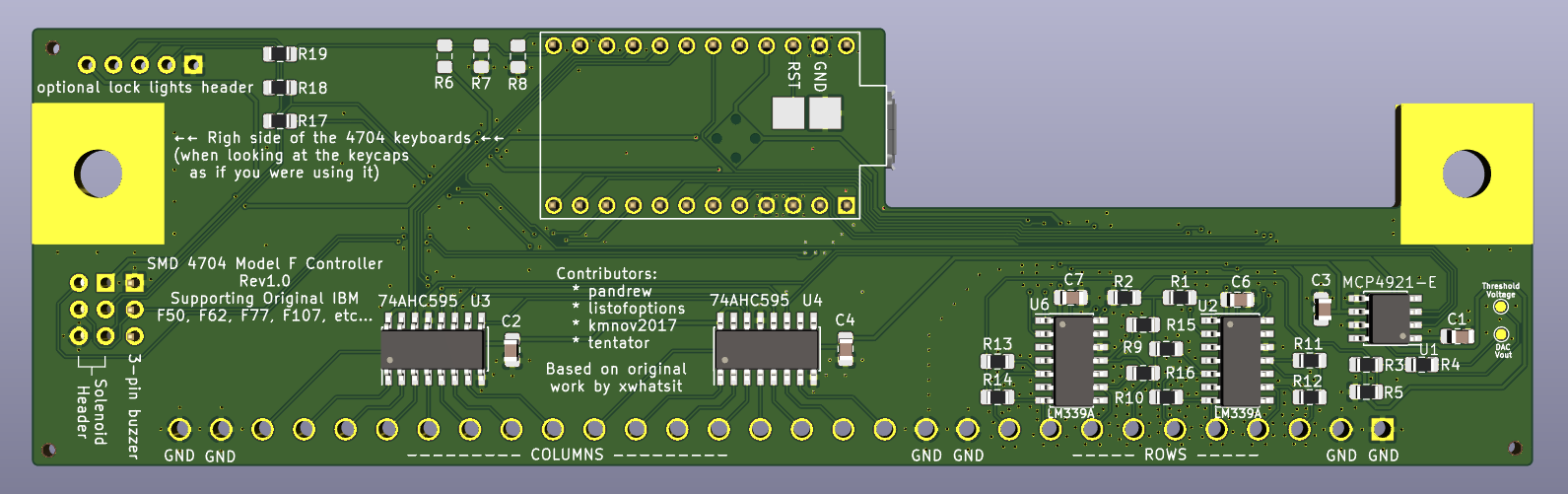

2) 4704 Kishsaver class model F controller, supporting original IBM F62, F77, F107, F50 keyboards.
(Note: this one does not support the reproduction F62 and F77 keyboards from modelfkeyboards.com, because those use 2.54mm pitch ribbon cables.)
Github URL: https://github.com/purdeaandrei/SMD4704 ... Controller
3) A slightly modified version of the "standard" model F controller from 1) above, with extra columns added. This may be useful for custom projects.
Github URL: https://github.com/purdeaandrei/SMDMode ... ra_columns
The differences between these are:
  • Board physical shape
  • Position of mounting holes

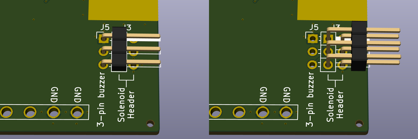

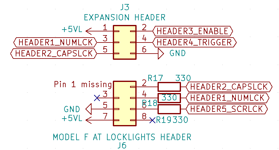

  • An F AT lock lights connector is available on the "standard" Model F controller.
  • A 3-pin buzzer connector is available on the kishsaver class controller.
  • The standard solenoid expansion header is available on both keyboards, but on the kishsaver class one it's hidden under the 3-pin buzzer connector, so you must either install 2x3-pin 90 degree pin headers for solenoid support or 1x3-pin 90 degree pin headers for the buzzer.
  • The third and the first one are almost the same, except the third one has extra columns, possibly useful for custom keyboard projects.
These can be ordered mostly assembled directly from jlcpcb.com. You must also order 5V pro micros (note MUST be 5V, not 3.3V!), and 90 degree pin headers, and solder them yourself. I am not planning on selling any (I may have one or two extra after my order arrives, but don't count on that). If anyone plans to build larger amounts, to resell, please post on this thread.
These have not been tested yet, but they have a high probability of working. My previous beamspring controller design worked out-of-the-box, see here:

    • These are only for kishsaver-class controllers if deciding to support 3-pin buzzer, and no solenoid.
  • 90-degree/right-angle dual-row pin header with plastic part on the long side: LCSC, TME, Digi-Key, Mouser
Assembly instructions:
  • Make sure you have an 5V pro micro. (Either by checking that the crystal is a 16 MHz, and NOT a 8MHz one, or by measuring >4.5V on VCC even if J1 jumper is not shorted. (if the pro micro comes with J1 shorted, then it's a 5V pro micro. If it comes with with J1 open, then it could be either an 5V or 3.3V pro micro))
  • You MUST short the J1 jumper on the 5V pro micro
  • For the kishsaver-class controller, you must decide to either support a 3-pin buzzer, or solenoid controller. Based on your decision you must solder in either a 2x3 pin 90 degree pin header or an 1x3 pin 90 degree pin header
  • For the 'optional lock lights' header on the kishsaver-class controller, don't solder in any pin headers, there's not enough space for that in some keyboards. This is for soldering wires to it directly.
  • For the standard controller all soldered-in pin headers must be 90-degree ones. For the lock lights header you should start with 2x4pin header, and remove one of the pins from the plastic using needle nose pliers.
  • Please follow instructions on the pcb itself related to which row of pins to use for the ribbon cable, and how to orient the board.
  • Pro micros and pin headers are designed to be on the "top" side of the PCB (opposite of where the SMD components are)
  • For 3178 "blue switch" keyboards you can't use the mounting holes for grounding the backplate, so you must solder a wire with a crimp terminal to the controller. There is a hole marked "chassis ground" for that (but you can use any ground). You can ignore that for other keyboards since the controller is grounded via the mounting holes, and as such the ground connection is achieved by touching the exposed metal around those holes..

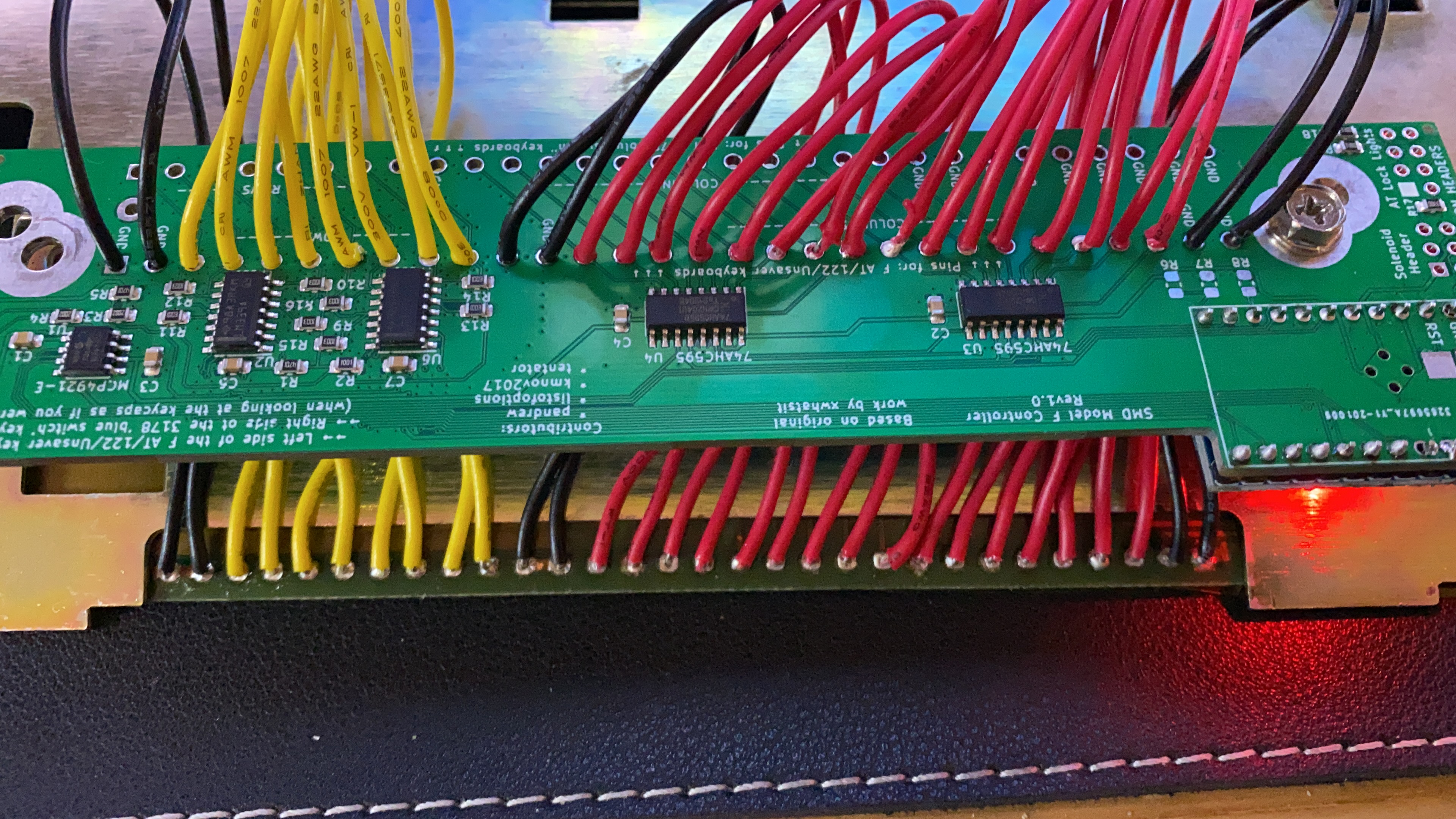

I have not soldered these to a keyboard yet, but I did some limited testing today.
I soldered on a Pro Micro (to both an option 1) and an option 2) board), and I verified, that all the columns work, all the rows work, and that the correct threshold voltages are generated. Everything looked fine.
I'm not in a hurry to convert my keyboards, so I guess probably darkcruix will be the first to connect these to an actual keyboard.
PS I also added a link to option 3) on the first post, which is a variant of option 1) with 8 extra columns on a separate header. This may be useful for some custom projects.

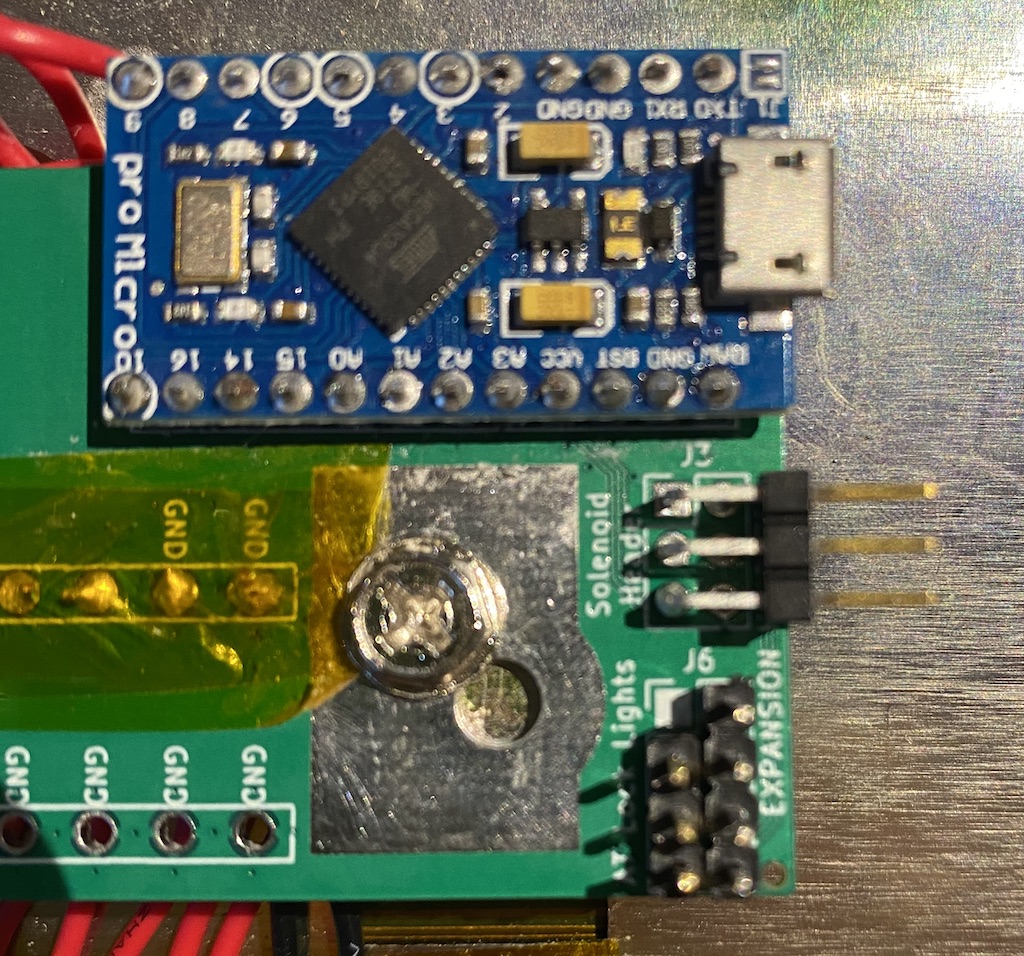

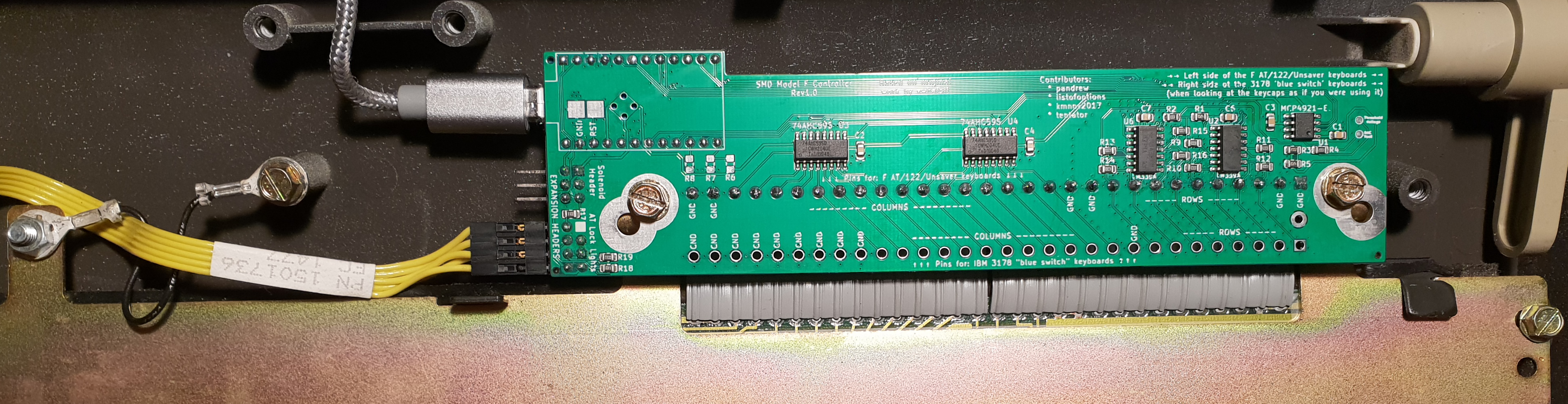

darkcruix
18 Oct 2020, 11:52
pandrew wrote: 18 Oct 2020, 00:18 ...
Good to know!
Nice looking color coding on the wires!
Is there an issue with the second mounting hole position?
I measured out the mounting holes using my F AT original controller PCB, which should be the same as for the F122.
Cheers,
Andrei

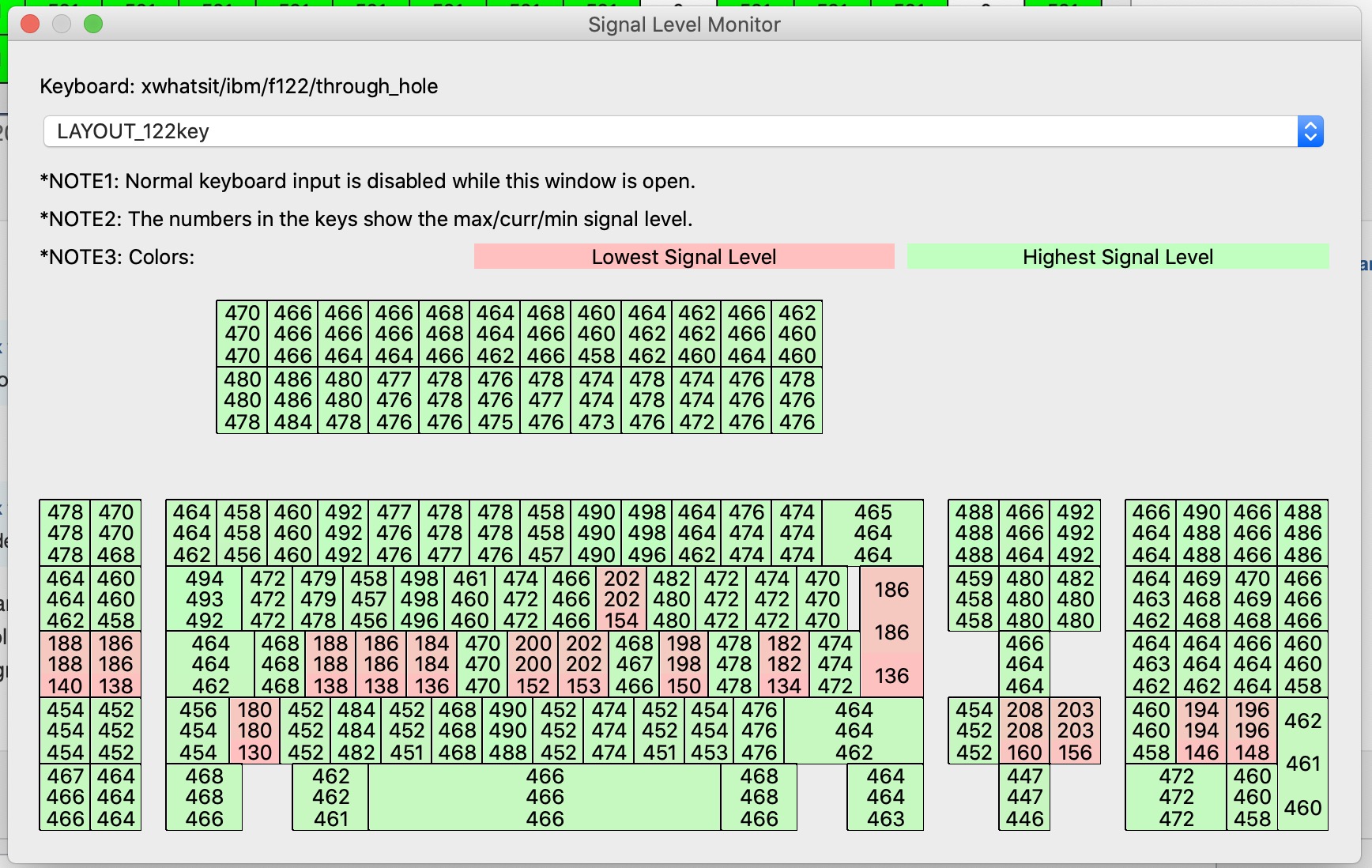

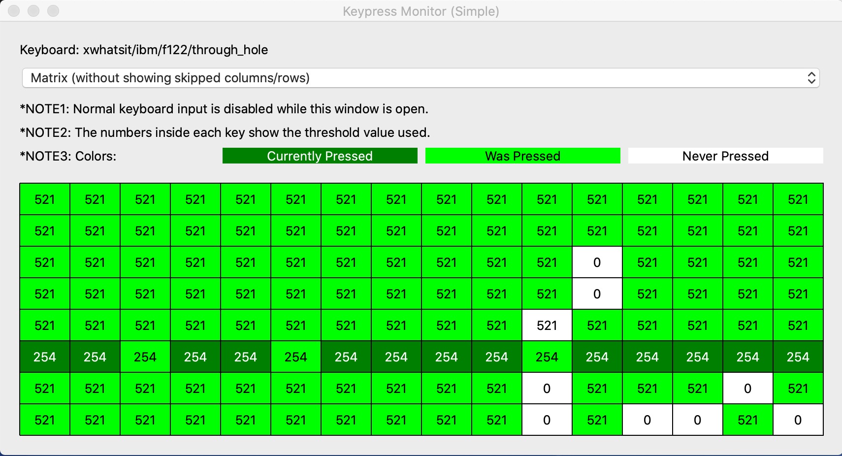

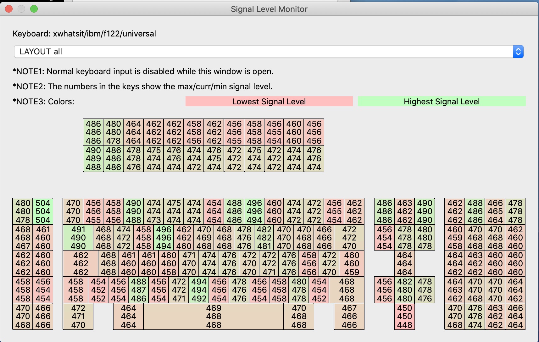

Fits like a glove ... I am still in determining an issue with row 6 ... can't find any obvious shorts, but have to find the issue - other keys just work :)

pandrew
18 Oct 2020, 17:25
darkcruix wrote: 18 Oct 2020, 11:52 Fits like a glove
That's great!
darkcruix wrote: 18 Oct 2020, 11:52 I am still in determining an issue with row 6 ... can't find any obvious shorts, but have to find the issue - other keys just work
I suggest to try and clean away all flux residue from where you soldered the wires (both the sense PCB and the controller), with isopropyl alcohol. Flux can be a bit conductive and can cause problems especially around the sensitive rows. Can you post a picture of the signal level monitor?
darkcruix
18 Oct 2020, 18:56
find attached the screenshot - I cleaned it with iso propyl alcohol without success.
Screen Shot 2020-10-18 at 18.54.14.jpg (552.07 KiB) Viewed 34883 times
pandrew
18 Oct 2020, 19:17
So what happens with those low signal value keys when you press them? Does the signal value increase?
I'm available on telegram or discord if you want to do some more efficient debugging.
darkcruix
18 Oct 2020, 21:10
Sorry mate - thanks for making you available whenever I have an issue - WOW!

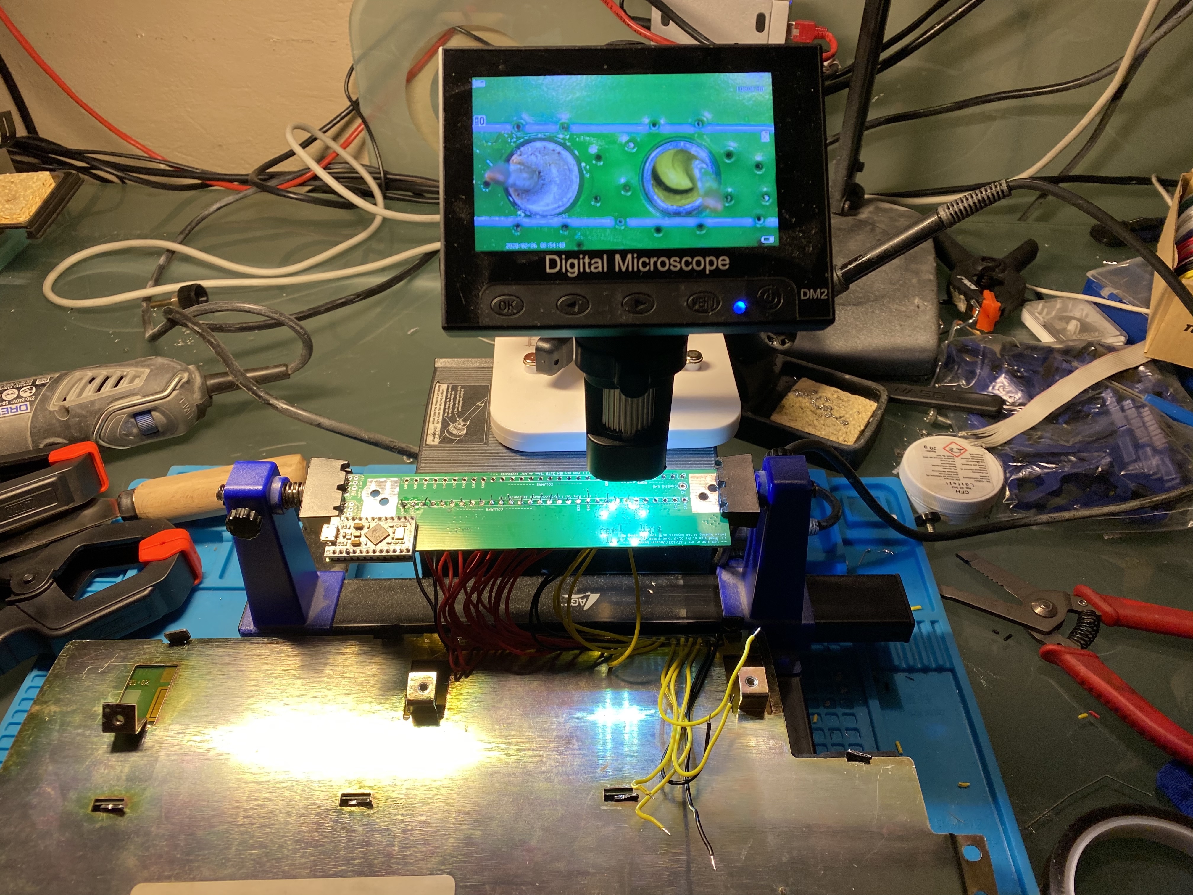

I fixed it by just re-doing the solder job.
This time I just used a Microscope and cleaned up properly (Yeah, not the workbench, it is a real mess, I know).
HUGE THANKS again - it is working flawlessly. Now I just want all 127 keys I use on the sensing PCB to work (looked at your xwhatsit.h and LAYOUT_all which should do the trick), but that is for another day.
Tell me, how could you put all this together without having all those IBM PCBs at hand? Genius !!!
pandrew
18 Oct 2020, 21:35
Glad to hear it works!
What do you think about that microscope, is it worth getting one? How's the depth of focus? Is there a noticeable delay in the image?

darkcruix
18 Oct 2020, 23:59
pandrew wrote: 18 Oct 2020, 21:35 What do you think about that microscope, is it worth getting one? How's the depth of focus? Is there a noticeable delay in the image?
For the price (around EUR 70) I was surprised about the clear picture without much lag and the optics. It focuses quite well. Just had to remove the protective plastic below the lens, as my soldering iron was melting pieces of it each time :)

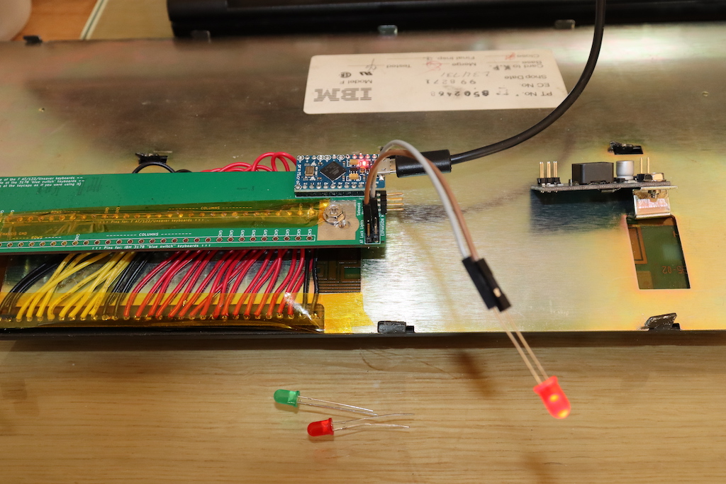

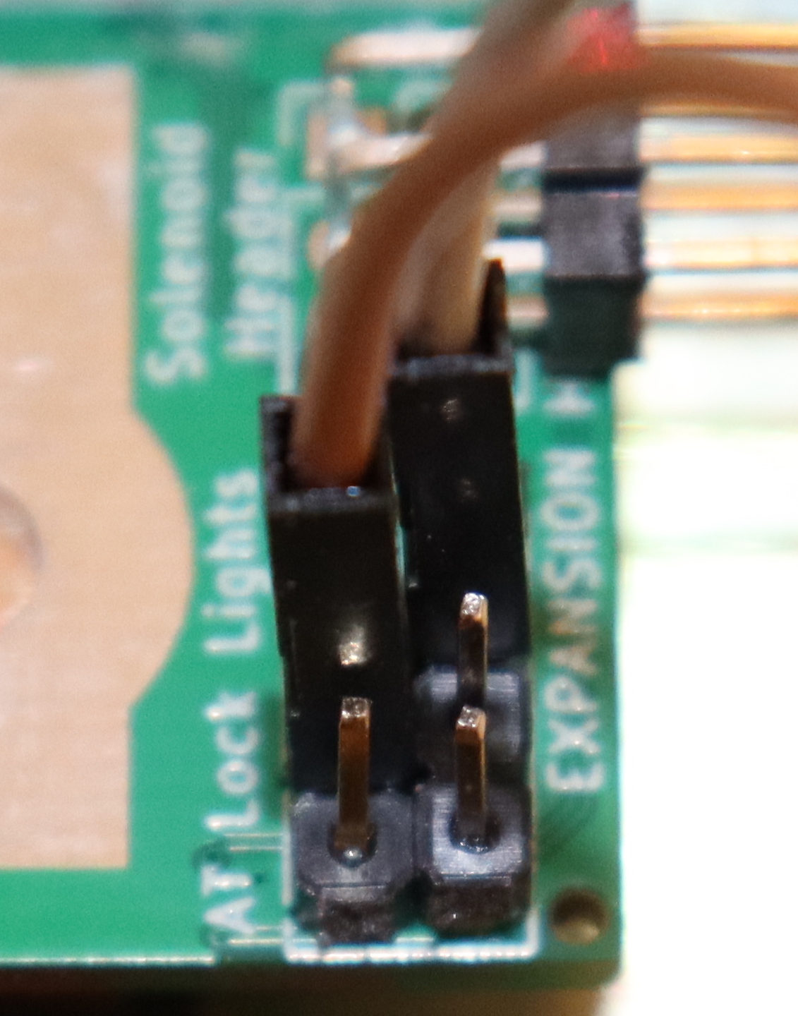

4) I added support for lock lights, by default configured to work correctly with the model F AT lock lights. In other cases lock lights would require mods to your keyboard so please PM me for details.

19 Oct 2020, 10:12
Just pulled the latest source, flashed the F122 with the layout_all settings and 127 keys. I am typing this right now with the F122 and can tell, it is working perfectly.
I can't test lock lights, but would love to have an option to display which layer I am currently in. But that is for another day ...

darkcruix
04 Nov 2020, 19:55

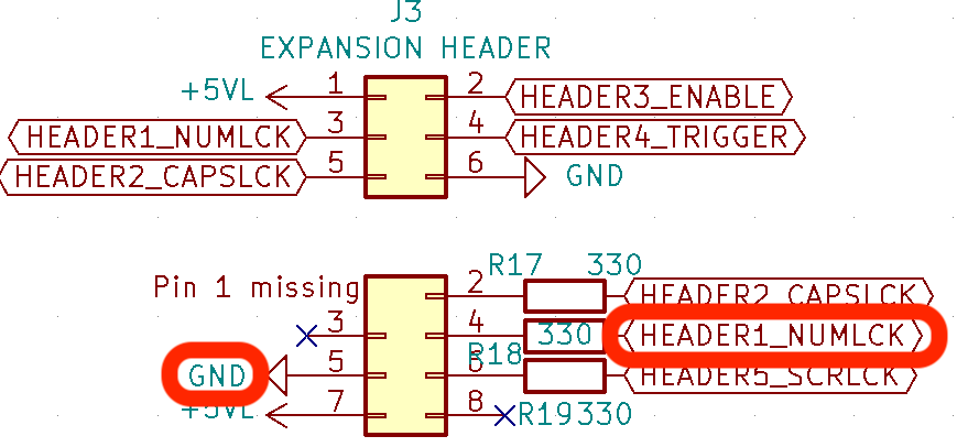

I want to hook-up lock lights to the extension header.
Is there a guide out there with the LED configuration, resistors etc, Pin-outs?
pandrew
04 Nov 2020, 20:26
Already talking to you on chat, but for anyone else reading:
1) Please always short J1 on the Pro Micro
2) Here is a snippet from the schematic:
  • The lock light are by default active-high. If you need active-low you will need to recompile your firmware locally.
  • There are already 330 ohm resistors there for led current limiting. (it's the most typical current limiting resistance)
  • On the solenoid expansion header, the numlock and capslock lights IO pins are available without resistors
  • Model F AT original lock lights are supported out of the box

I realize I never posted a picture of a "standard" controller sitting in my Model F AT :),
here we go:
I used the original ribbon cable. Desoldering it was not fun. After I desoldered it I remembered that I have ones of these sets of hollow needles:
https://www.ebay.co.uk/itm/8PCS-Hollow- ... 2749.l2649
I totally forgot about it. I think it would have been a lot easier with these.
The yellow cable you see is the original cable that goes to the Model F AT's original lock light board.
I still have to figure out a good way to mechanically fix the USB cable, to protect the controller from accidental pulls from the outside.
darkcruix
04 Nov 2020, 22:33
With the original F AT cable and lock lights it works just perfectly out of the box. On the other hand, I wasn't able to translate it into my own circuit for e.g. Caps Lock LED.
You are right, I have the controller up-side down - I used my F122 as a testing ground for the manual.
Update:
Thanks to pandrew (as always), it was an error on my end. It just worked (with the 3rd LED). It is as simple as connecting a simple LED to the PIN-out GND and either one of the lock lights as shown in the first picture:
