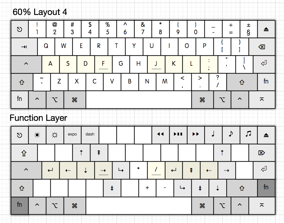

22 May 2013, 00:12
I'll have you carving "Handmade in Italy" on it eventually!

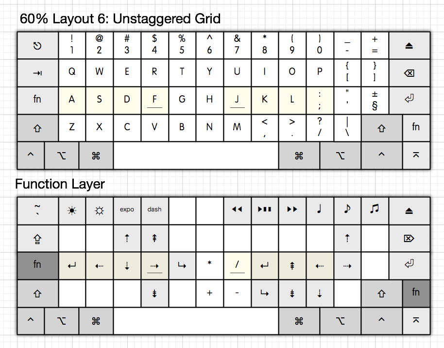

As for the constraint of 1.0<u<2.0 blank caps, I just whipped up this layout:
60% Layout 4.png (96.52 KiB) Viewed 15429 times
The right hand side is the tricky part. Especially return. I'm used to a slim one flush to the right already, so it's not that bad for me. But that whole row really wants a 2.25u cap at the end, to maintain standard staggering. And I'm determined not to pull a Minila! 1+1.25 works, but sub-optimally.
The left side, meanwhile, is pretty much what I am using right now, in ISO.
By the way, is the whole 15x5u grid what makes a 60%? Or am I still needlessly thinking inside the box described by the Poker? I see the HHKB also fits within the same 15x5, just without filling every corner.
-[°_°]-
22 May 2013, 00:22
Muirium wrote:By the way, is the whole 15x5u grid what makes a 60%? Or am I still needlessly thinking inside the box described by the Poker? I see the HHKB also fits within the same 15x5, just without filling every corner.
usually 60% are TKL without the additional right hand keys and function row. All keys are standard sized so you can easily find/replace keycaps. If you do not keep standard key sizes there's no reason to stick with that layout and you could really do whatever you want. If you look at the Steely there's no standard key around but still with default staggering with alpha.

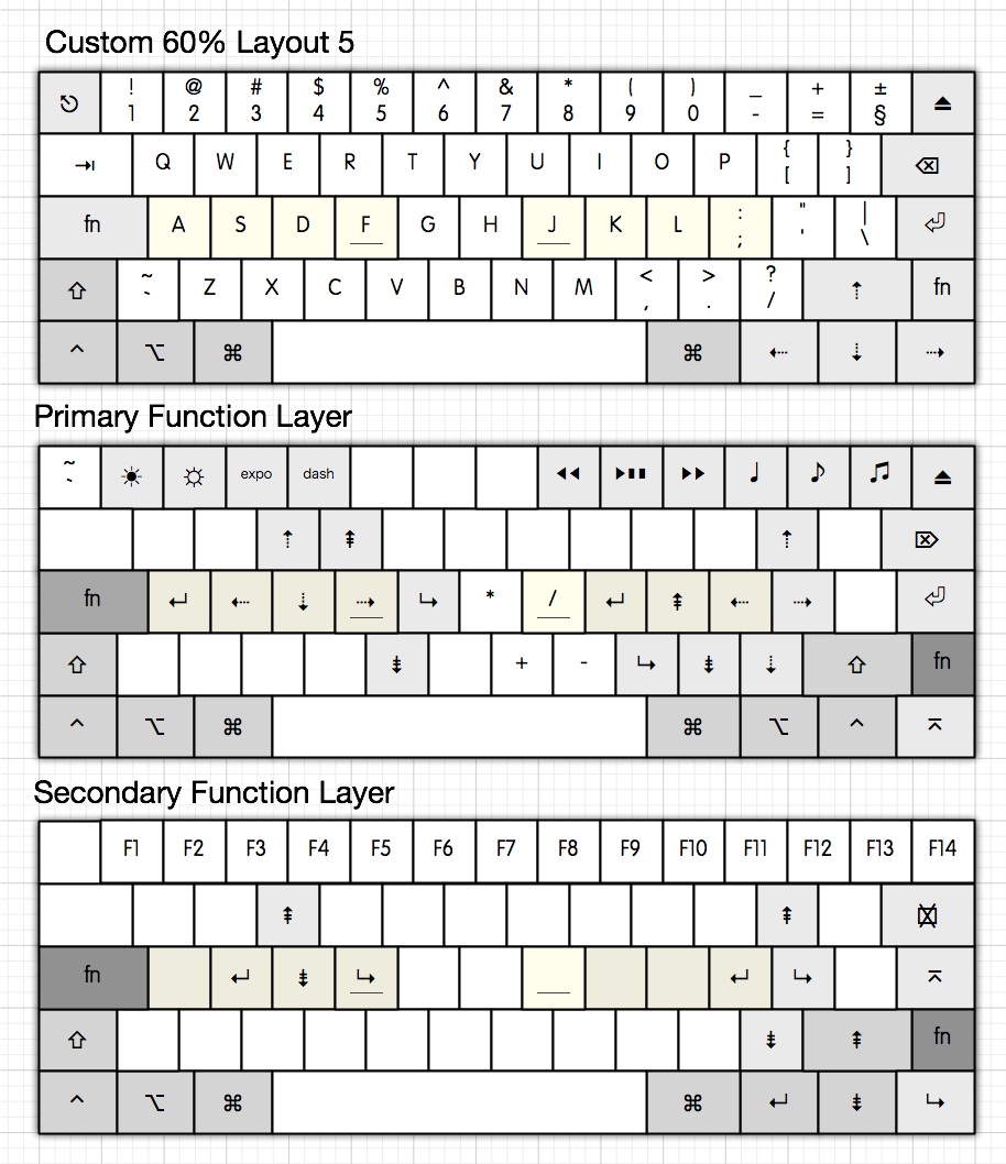

Okay, here's my latest thinking for a 6u space bar and all other keys 2u or less.
Custom 60% Layout 5.png (137.09 KiB) Viewed 15345 times
It's programmable of course, so I can fix the egregious stuff – like the arrow keys – at leisure. Return's a bit small, but I'd rather a medium size return key than a tiny right shift.
I'm thinking that two function keys let me dial up more layers if and when I want them. Up to four, logically speaking. But I doubt I'll want more than three. In this instance, either function key pressed = primary function layer; both simultaneously = secondary.
Oh, wait a minute: not on the one above. I had both function keys side by side for a while, but when they're back apart like that, the combos start to need your nose! Hmm…

Here's a question about stabilisers: what sizes of keys require them? The space bar, of course. But what's the threshold for other >1u keys? My latest layout has no keys over 1.75u. Almost everything is 1.0, 1.25 and 1.5u in fact. It'll be a dense looking keyboard!
Also: if I really do want to have proper arrow keys, what are the unit limits for a 60% + cursor key cluster board? I'd still prefer to leave off the function row.

Muirium wrote:Here's a question about stabilisers: what sizes of keys require them? The space bar, of course. But what's the threshold for other >1u keys? My latest layout has no keys over 1.75u. Almost everything is 1.0, 1.25 and 1.5u in fact. It'll be a dense looking keyboard!
All keys over 1.75u (not included) need a stab.
Muirium wrote:Also: if I really do want to have proper arrow keys, what are the unit limits for a 60% + cursor key cluster board? I'd still prefer to leave off the function row.
Don't remember if that would be feasible with default staggering. I'll give it a shot and let you know.

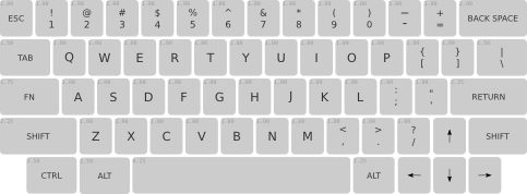

I did a quick test with the arrow cluster in a 60% realm. There are a couple of options, here below one of them.
I must say that I'm not a big fan of this layout. I actually use the right shift quite a bit for right hand punctuation, but it might worth a shot anyway.

Muirium wrote:How about something more like a mini-TKL? So there is a separate island of cursor keys to the right of the main 60% block (with another above them for the usual page up/down home/end etc. or otherwise!) but instead of going whole TKL: still no function row.
to me the purpose is to save horizontal space (to keep the mouse closer to the keyboard). The best option for me is the 65% brownfox shown few posts ago
26 May 2013, 17:53
Fair enough. It's a decent layout. The single extra key's width (16u total instead of 15u) opens up a lot of possibilities. Drawing up my own designs, I have more patience for the compromises always taking place in that bottom right corner. It's the hard part.

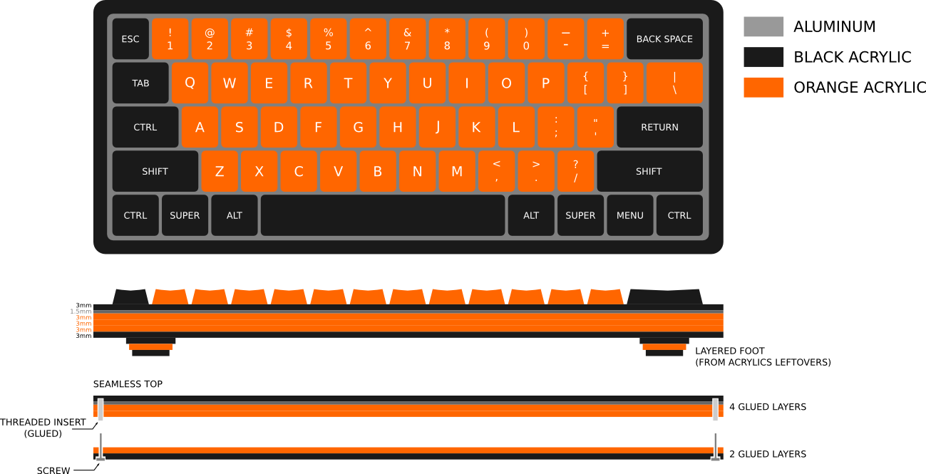

Unfortunately I don't have all the tools needed to make a decent layout now, but the following is a quick test I've done for one of the many keyboard cases I'll build in the coming weeks.
It's mostly made out of acrylic. The good part about it is that the top is seamless (no visible screws). The top 4 layers can be glued together (with epoxy I guess), the same goes for the bottom 2.
A threaded insert is then glued inside a hole in the 4 top layers. The insert is used to fix the bottom layers with a screw.
The plate should be made out of aluminum to give better stability and I could end up spraying it black.
This will be probably the only 60% I'm going to build and it's black and orange to meet Round3-TKL-orange keycaps.
More details as soon as get back home.

What size screws do you use and how much clearance to the edge to do you leave?
-[°_°]-
29 May 2013, 08:54
screws are 2M, inserts are 4mm external radius. Acrylic is rather fragile and cracks easily so the clearance to the edge should be adeguate. This means that the external frame will be pretty big. For that layout I need 3 orange and 2 black layers, I'll laser cut at least a couple spare layers in case one comes broken (it already happened).

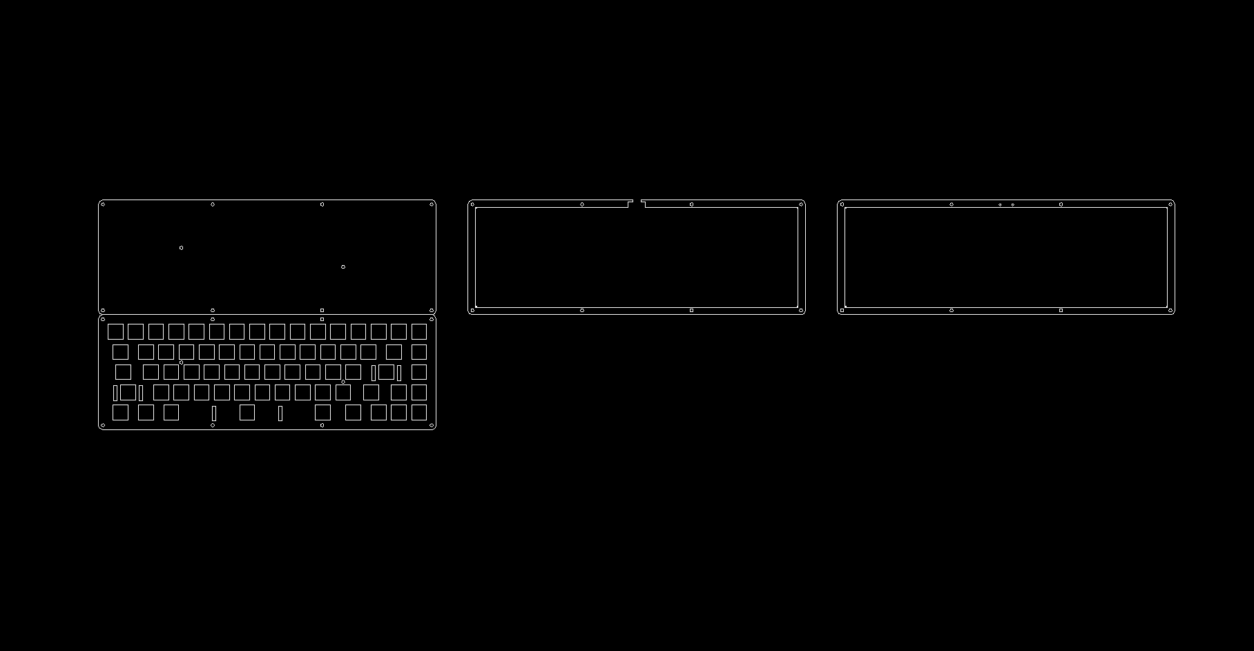

First draft for the brownfox.
It will be an open frame like my Steely but 100% aluminum instead of steel. Later I'll double check all measurements and post the final CAD file.
The top layer (ie the plate) and the bottom layer will be 1.5mm, then I have two 3mm layers with a hole for the USB port and one more 3mm frame.
The whitefox instead will be made of acrylic with an alu plate.
I'm toying with the idea of having a 100% acrylic case for the "lava" board above.

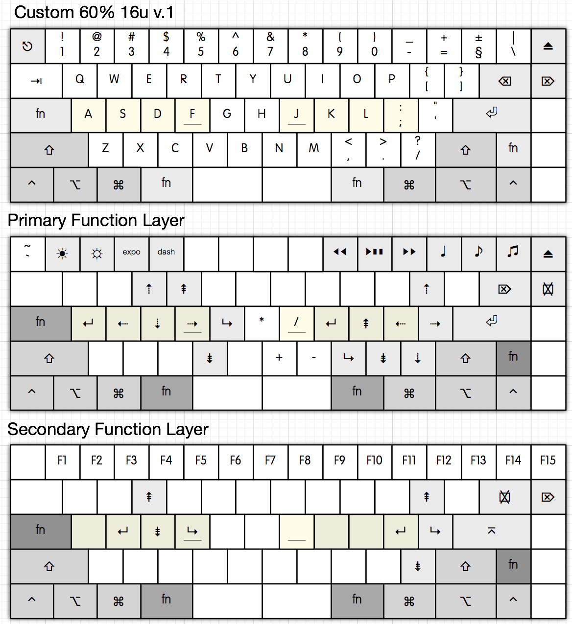

Brownfox is my template: the open frame aluminium version of Steely's design.
I'm aiming to borrow the HHKB's function layer. So my right side shift has a function key nestled at the right side of it. I'm also going for function keys around the spacebar, if I can. A trick from the Japanese layout HHKB and Filco Minila. This will cause complexity with choice of caps down there, however.
This is my latest iteration:
Custom 60% 16u v.1.png (167.87 KiB) Viewed 14976 times
So many function keys! But that's the advantage of a custom controller: they can become whatever I want. The same is true for the handful of spare keys at the far right. (Volume controls? Macros?) This layout has a total of 70 keys, counting both space bars. They are intended to be functionally identical, but I'm definitely still thinking out loud about the whole of row 1.
Matteo's making 15u and 16 unit wide plates, so I'm playing with designs for both sizes. I've looked into integrating arrow keys on the primary layer, but I'm undecided. Final decisions depend on what caps he has spare for me!

03 Jun 2013, 20:00
I'd say that if you are not planning on having an arrow cluster you probably should go for a 15u layout. I'll post it tomorrow.
