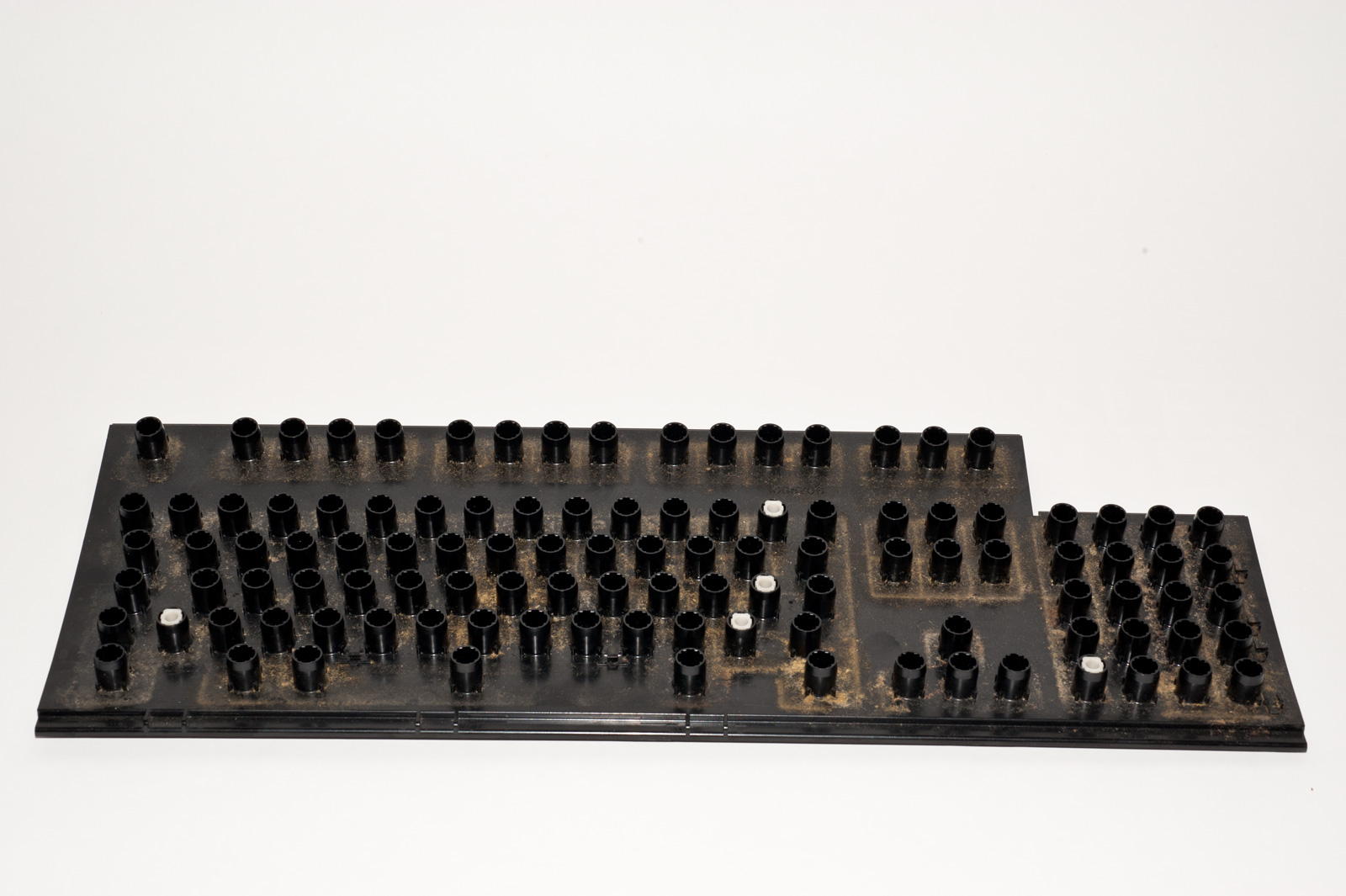

For a mat material I used silicone from Grainger, and also got some neoprene but decided on the silicone due to the lack of smell. I punches the barrel circle and the nub that stick out to the bottom right as two separate punches. Seems to work fine. I thought about using the foam

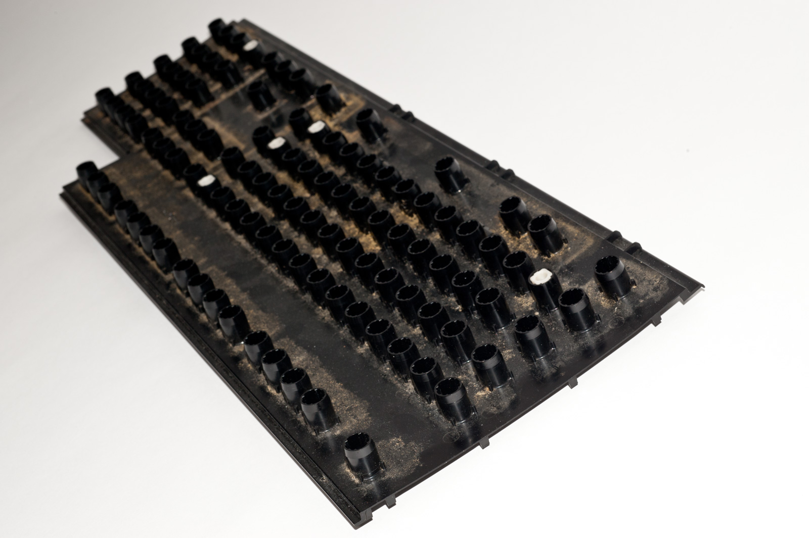

I assume the flip plates strike the foam mat instead of the PCB sense pads directly, like the soft mat inside a Model M. Or otherwise cap sense would be superfluous. But I haven't Dorkvader's direct experience.
Also, the plastic rivets don't seem to take much or any strain in a Model M. When you take apart the layer sandwich, the barrel plate remains curved quite independently. I had a Model M open for about a month recently, waiting on parts for a bolt mod. The metal backplate and the barrel plate were made to that specific curve. Only the floppy layers of the mat and membrane naturally lie flat.
