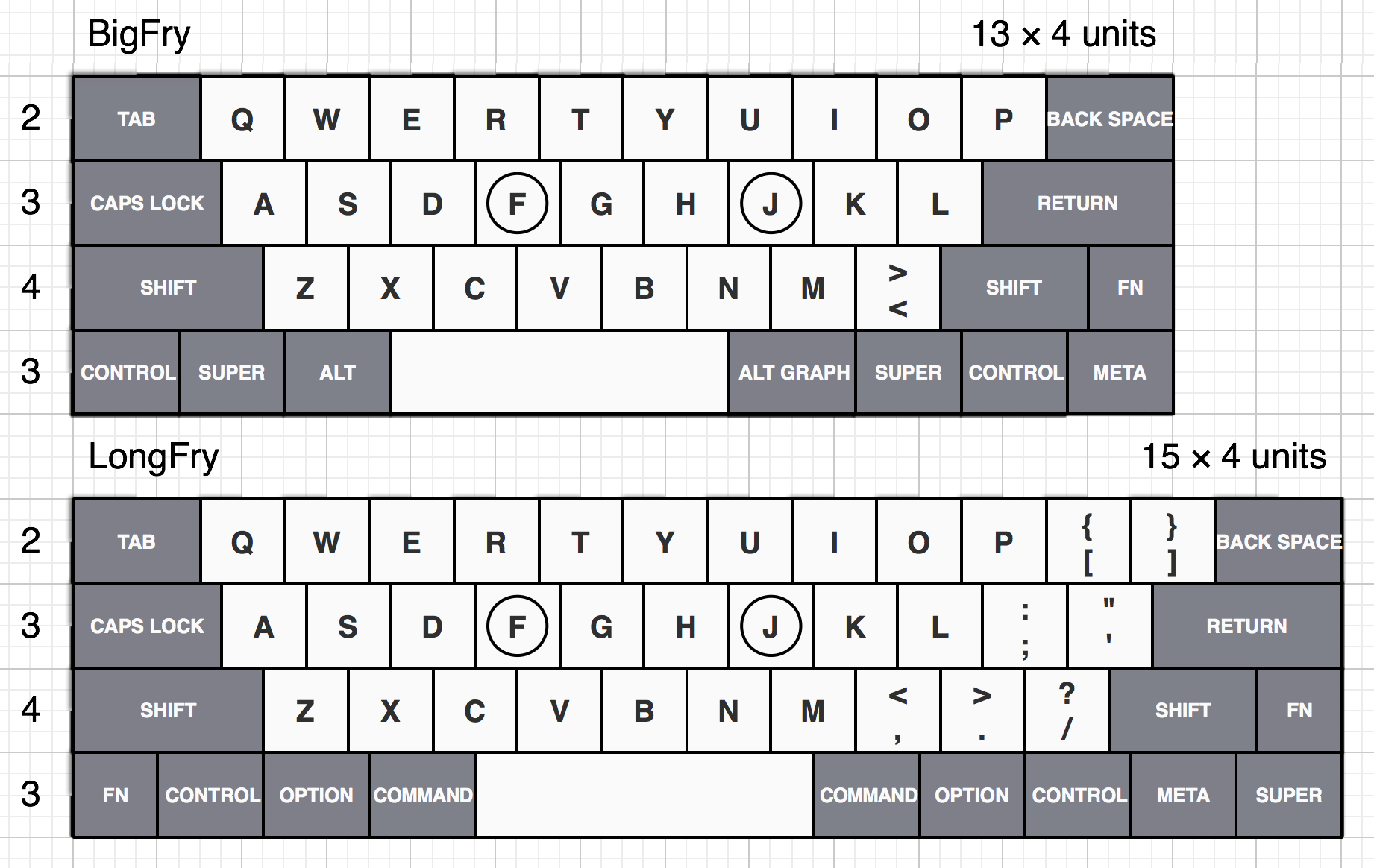

So, here's the SmallFry keyboard kit from Round 5.
I really like it. But I'd struggle with so few mods, and that long spacebar isn't doing it for me. So, I just laid out two versions which can both be done with a TENKLESS kit and a 4.0 unit space bar.
You could probably make these from less than a (costly) TENKLESS kit. That was just my constraint when designing. The caps are fairly standard, besides the space bar.
With a keyboard as small as all these, you're going to live in the function layer. In fact, there's so little space, you'll really need two at least. So that's the motive for the liberal selection of mods: for layer access. Navigation, punctuation, TAB vs. ESC etc. is all in the layers.
The 4.0 space bar is my ideal one from Round 5. The even shorter 3.0 unit is the smallest size (unless I'm mistaken?) to be a true space bar shape (rounded, not squared), but the 4.0 has stab mounts. Round 5 has a 4.5 unit version, too, so there's plenty of choice for the audacious. In fact there are unstabilised space bars at 1.5 and 1.0 units too! But with a standard square profile.
LongFry is wide enough to be doable with a 6.25 unit space bar with some rearrangement, of course.
BigFry is the harder one. The space bar could easily be shunted left instead. And now I see why Jdcarpe went for that single legend period key. But I'm trying to stay standard.

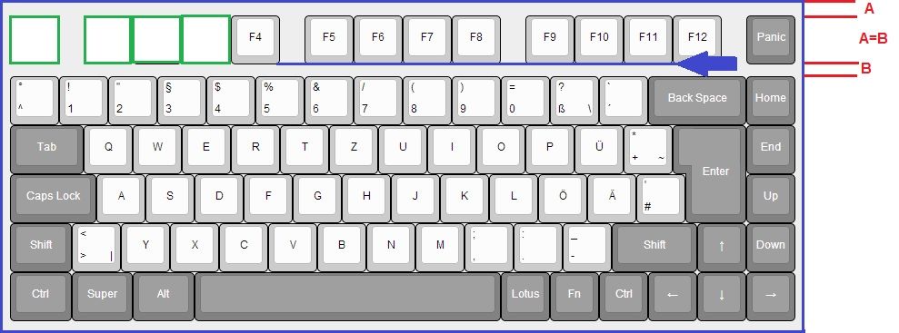

I would have posted about an F row board, but rindorbrot tackled that already. There are a lot of Frow less boards out there, commercial products as well as community ones. Seldom one sees a small footprint board with Frow (TG3, Noppoo Choc, KBC race and keycool 84 are the only ones I can think of) so I vote for this as a (first) for a group buy.
Also, it is a very easy fix - goes well beside the Frow less boards. For example, if you make the space between Number Row and F row the size of the border atop of the top row everything apart from the middle layers can be reused. Instead of cutting the holes for the switches in the top plate, F row, theres a simple cut along that line to make a F row less board. Same with the bottom layer, and if the PCB is layed out accordingly even that could be reused the same way, no?
Here's a simple drawing, original image by madhias, just imagine the layout being the switch holes instead, the blue lines are the case outside:
If the general layout of the middle layer pieces are open at the top, as in no "O" shape frame but rather an "U" shape frame with a square profile piece atop the top row to close the gap, this will even make a corporate design for both, Frow equipped and less boards.

Muirium wrote:With a keyboard as small as all these, you're going to live in the function layer. In fact, there's so little space, you'll really need two at least. So that's the motive for the liberal selection of mods: for layer access. Navigation, punctuation, TAB vs. ESC etc. is all in the layers.

Muirium wrote:Both those mods aren't uniform!
don't get it sorry. you mean 1.5u on the left and 1.25 on the right?
18 Feb 2014, 15:46
iPad miscorrection, sorry. That's what I get for thumb typing on the bus. Both was But. Because the layout above it was a mix of 1.0, 1.25 and 1.5 unit mods.

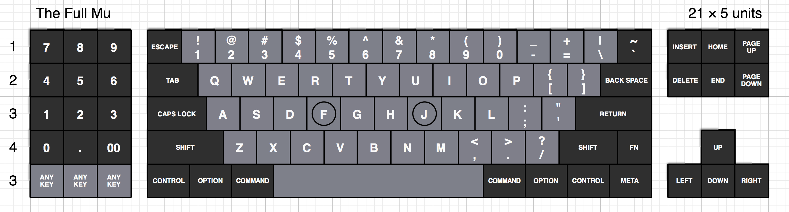

A basic rendition of the lefty numpad concept discussed earlier. Without a function row:
The Full µ.png (158.48 KiB) Viewed 8430 times
I already like it more than a standard full size keyboard. But I'm unsure what to do with the numpad's fifth row. A traditional numpad is bigger still. But I use the operators very seldom indeed.

18 Feb 2014, 18:18
The IBM XT style function column does balance it up a bit, actually. I've found those keys quite useful (as media controls) on my Soarer powered XT.
