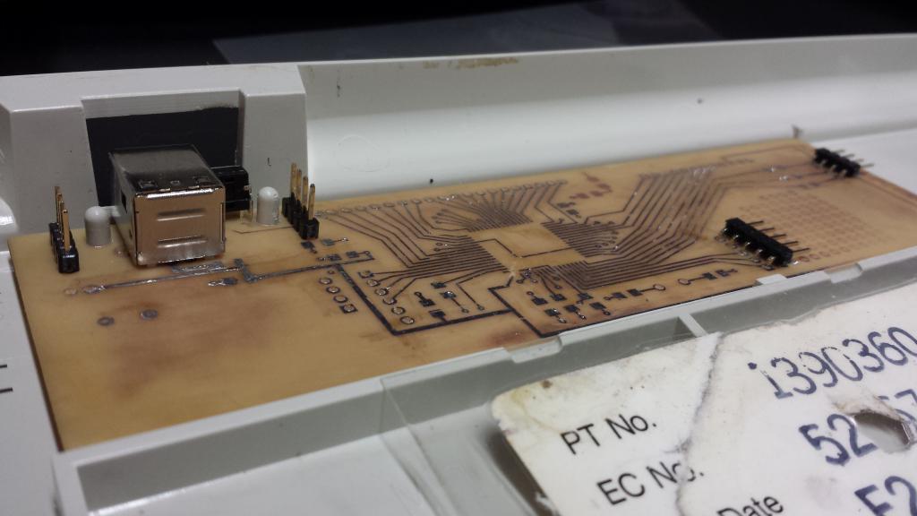

Additional update:
I've been toying with the second PCB idea and here's what's up:
I'm happy to hear the feedback about the big USB-B connector preference, it's definitely staying. Additionally, I'm definitely including a provision for Micro. My original idea for having secondary pads next to the USB-B won't work - there wouldn't be enough clearance for the cable and case, so the connector needs to be moved vertically to center it a little more.
I have enough room next to the mounting posts for two female headers. The second (modular) PCB can then be stacked on top where I can mount the Micro, some buttons, a switch, and LED. The board will be 5cm x 1.5cm which I can keep in this PCB layout and keep it in the 20cm total design limit and have it v-scored during production.
Excitement continues to ensue.

The first aim I had in mind is simply aesthetics. I absolutely hate having to desolder the SDL connector from a stock controller. I do it very cleanly without damaging the board or connector, with specifically cut wires running to a Teensy (I'm a stickler for pretty wiring), and a specifically Xacto cut panel header that mounts to the board and doesn't require drilling holes in the case (another no-no in my book). In the time it takes me to do all that annoying stuff, I can happily solder a bunch of SMD components to a brand new pretty PCB and be waaaaaay happier with the final result.Halvar wrote: Is bluetooth really the most important feature? After all this is still a Model M, which is not one of the most "mobile" keyboards from the start... My guess is what phosphorglow is originally aiming for is mainly the ability to make and sell fully refurbished, bolt-modded and modernized Model Ms that come with a programmable USB controller from the start, for a crowd that wants the quality and retro look of a Model M but no hassle. For that goal, bluetooth might actually be a less important goal, right?
To have a bluetooth controller for the Model M as a "sellable product" (although small scale) would also be a great goal of course, but I guess it would probably look different, not based on this microcontroller and an Adafruit EZKey...
So I guess it's a good compromise to have the option to add bluetooth to this with easily available components and a bit of (more or less) easy assembly required, and maybe go for a full bluetooth design in a different installment.
It's pretty, but I hate it. The same goal applies to the rest of the community. I want everyone to have a nice layout that they can use which suits their preferences in as many variations as possible for a singe board. I'm also planning a different through hole version to simply mount a Teensy++ to that I'm sure a lot of people would love. Buy a $5 board and solder it together yourself and have a super pretty specialized board for your M. I love it and would love seeing it.

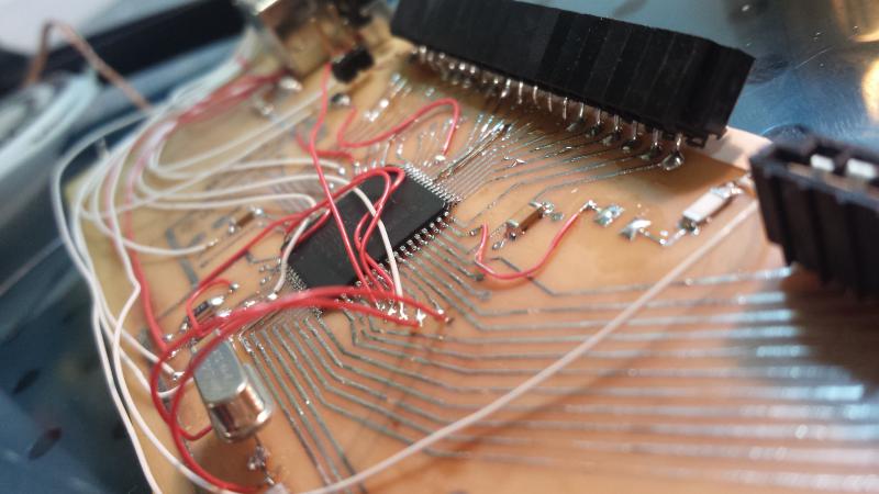

Sooooo I need to run a couple of wires to replace crappy traces, otherwise so far so good.
The toner transfer sheets I got were utter crap.

In all its wondrous glory. Can't wait for a real double sided PCB!
Amazingly, it's functional! Not so amazing is that FLIP now throws me an error upon erase/verify after I loaded Soarers Controller (it did flash and verify properly the first time). Google tells me it's because of some stock fuse/lock settings and I need to re-flash the bootloader. Aside from that though, it's working. Time to put the TeensyduinoISP to work!
A thought occurred to me: Do I really need the crystal? Isn't there an internal oscillator? I'm sure I need it, but it doesn't hurt to ask.
Have you ran into the above mentioned issue with the erase/verify error?
Very nice to know about the resistor - I was hoping that was the case!hasu wrote:Thanks for keeping us updated!phosphorglow wrote: Time for some thinking out loud again...
