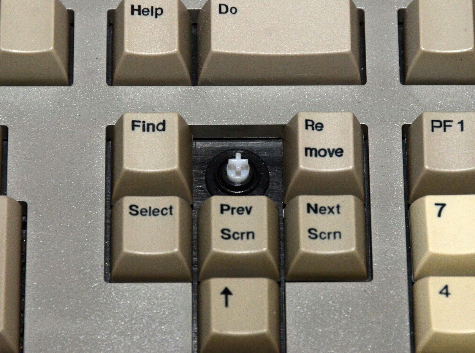

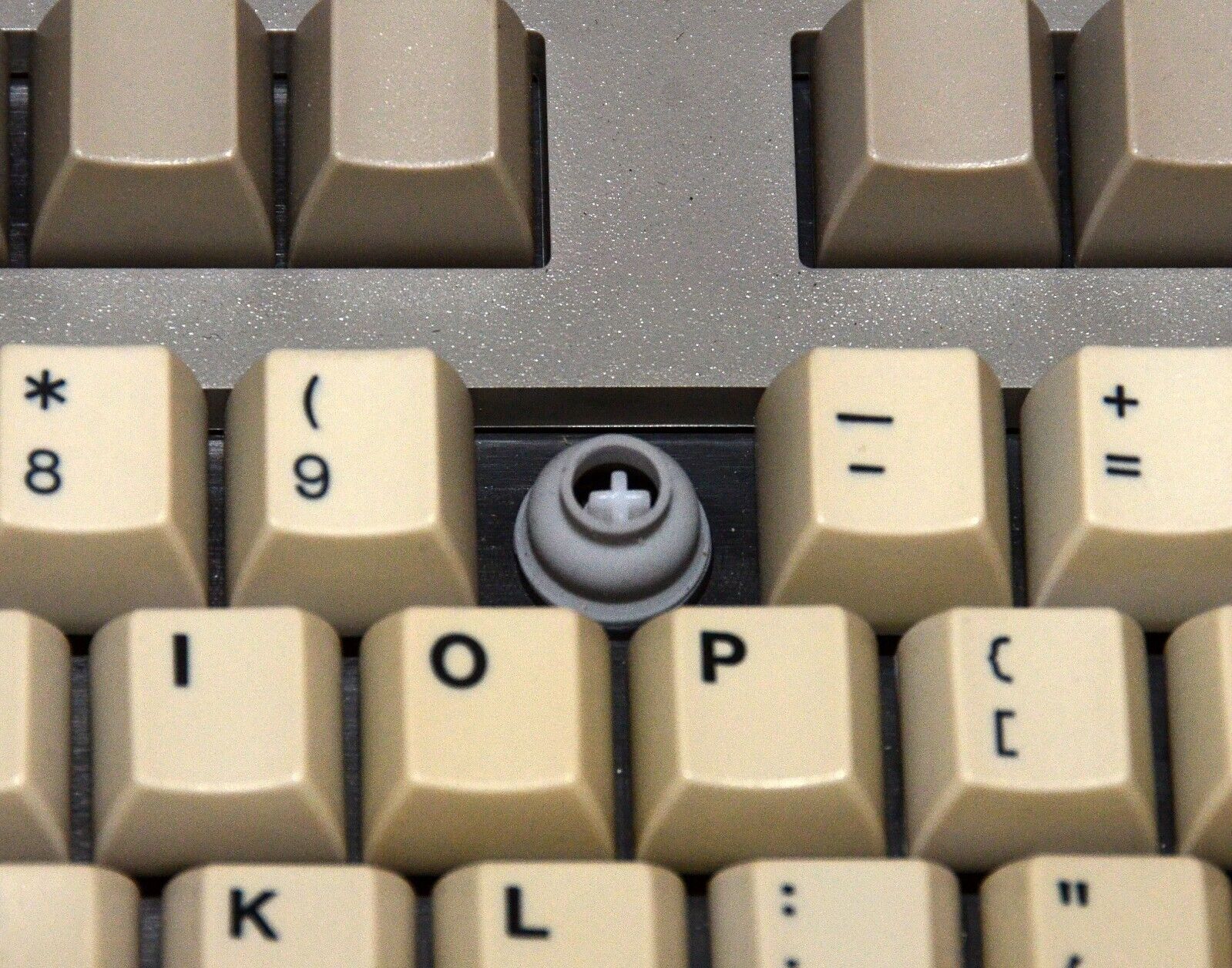

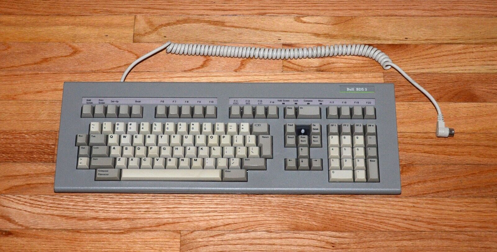

Any ideas on what this is?
Here's a similar keyboard, but it seems to have the mounts broken off.
The keyboard also seems to have the exact same layout as this other post here (But with different switches)

I don't think Cherry M7 or M9. Those have "Cherry" on the upper housing and the switches in the keyboard(s) above don't. Looks close to Mitsumi Standard Mechanical.

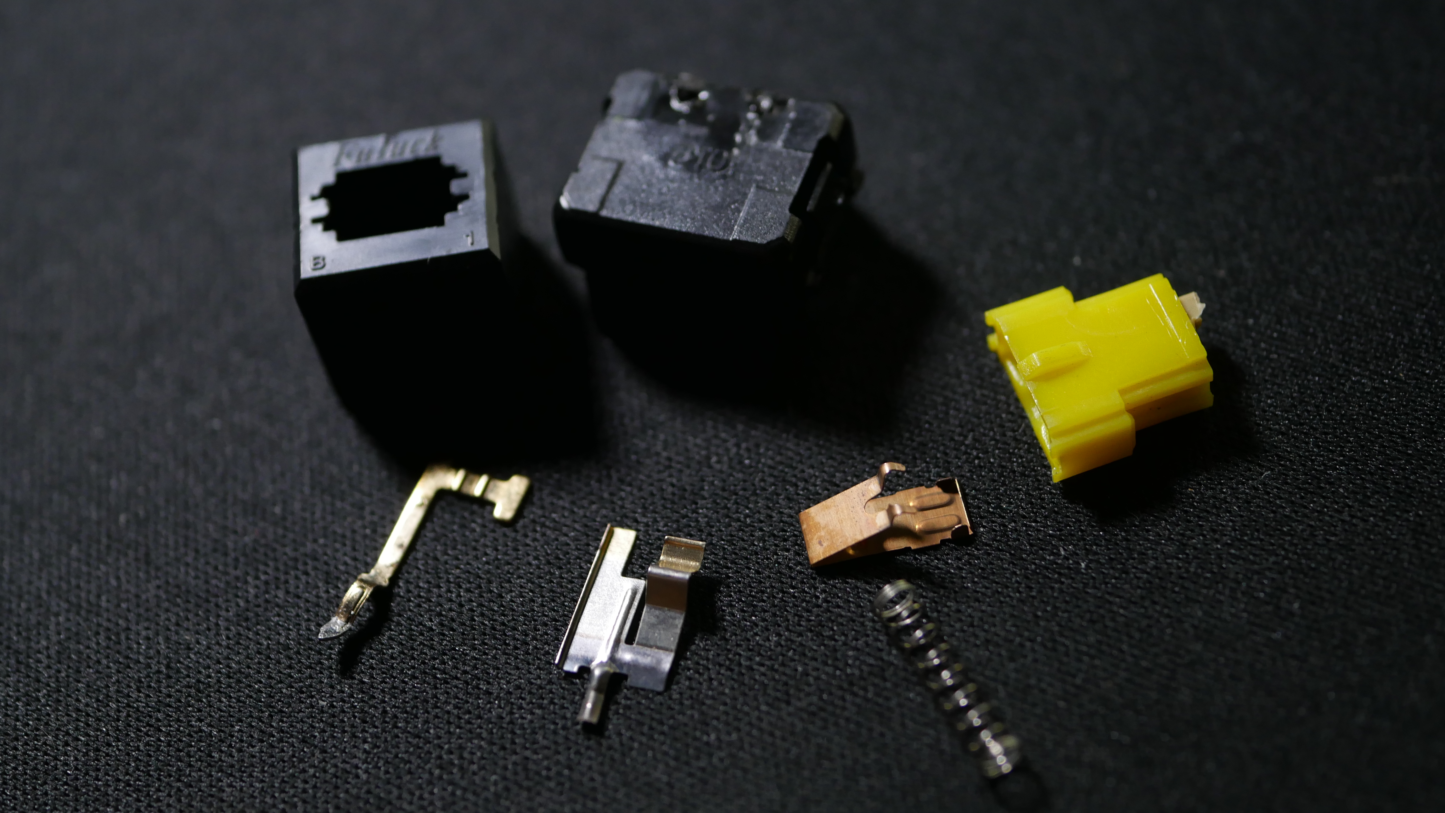

do these internals match any alps clones that y'all recognize? they are from a fuluck branded alps clone switch
edit: never mind, i think they're the same as wiki/SFON_Alps_clone with a different shell

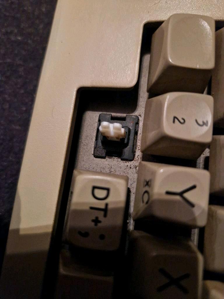

https://www.ebay.com/itm/314229594948
I thought of a couple different things, but that circular mount is throwing me off. I Googled and the only keyboards that looked like this had Cherry MX. This is obviously not MX. Dome/slider?
- Location: Stockholm, Sweden
- DT Pro Member: 0011
I'm sure I've seen it before but I can't remember or find it in the wiki. The rubber cup supposedly goes in-between the plate and the keycap, which would indicate a "hybrid" or foam-and-foil type switch.hellothere wrote: 15 Nov 2022, 17:59I thought of a couple different things, but that circular mount is throwing me off. I Googled and the only keyboards that looked like this had Cherry MX. This is obviously not MX. Dome/slider?

I've seen a couple of switches using similar rubber thingies as "dust protection." You may be right, though.Findecanor wrote: 15 Nov 2022, 18:18 The rubber cup supposedly goes in-between the plate and the keycap, which would indicate a "hybrid" or foam-and-foil type switch.

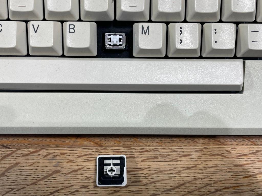

Somebody can identify them ?
John Doe
- hellothere
- Location: Mesa, AZ USA
- Main keyboard: Lots
- Main mouse: CST2545W-RC
If you want to get one of these keyboards, check the forum. There are older reviews saying that they're not that great of switches, but if you use some sort of (spray?) lube, they turn into "not bad" switches.
Don't confuse them with Mitsumi Standard Mechanical switches, which were most commonly found on Apple Extended Keyboard IIs. I've also got a typewriter with them.

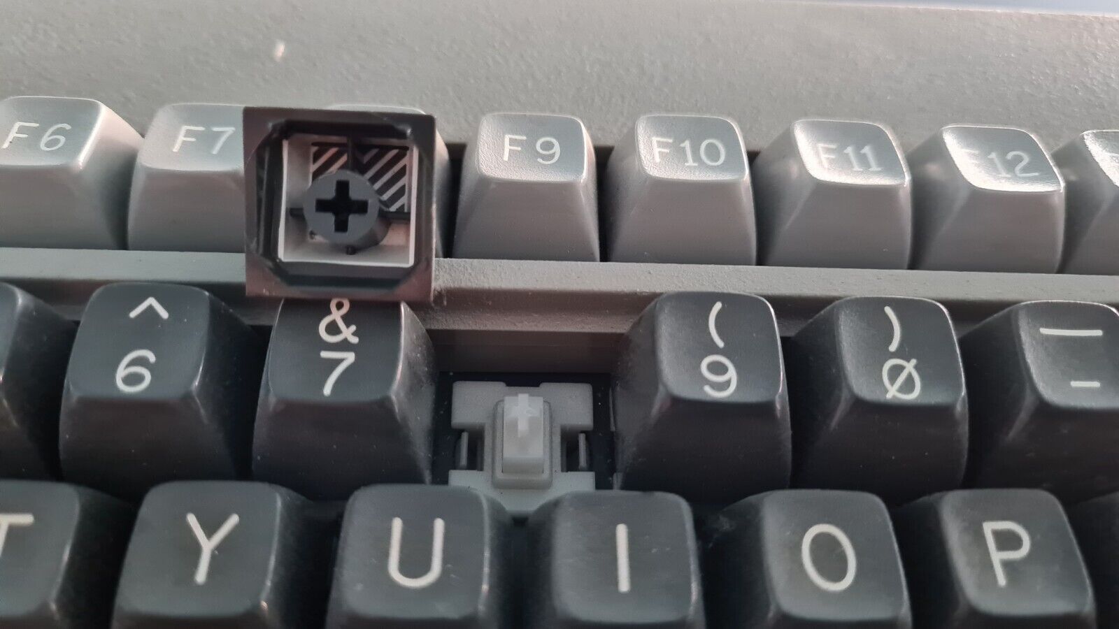

Anyone recognize these switches? They are off a "Model 970" that I have found a listing for and considering if if it is worth $150 dollars and if I should buy it. Obviously I want to make sure I am not buying a board with switches in the same tier of Datalux's MEI switches
Thank you all in advance!
- Muirium
- µ
- DT Pro Member: µ
SMK vintage linear, I think. They’re okay, quite like Cherry M7, the ancestor of MX.
