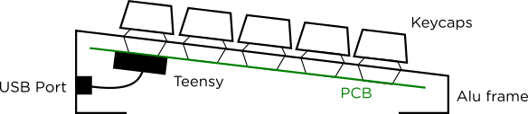

This is a quick diagram of the bent alu/steel case
The problem is that there's a minimum distance that we can bend and I don't know which is it. Also, we would have to find a way to connect the bent metal to the side/bottom wood.
Vierax
03 May 2014, 12:07
matt3o wrote: Also, we would have to find a way to connect the bent metal to the side/bottom wood.
(I don't know the name in English :oops: )
-[°_°]-
03 May 2014, 12:10
actually I was thinking to have some slots in the wood and insert the plate inside. I don't know I have to think about it.

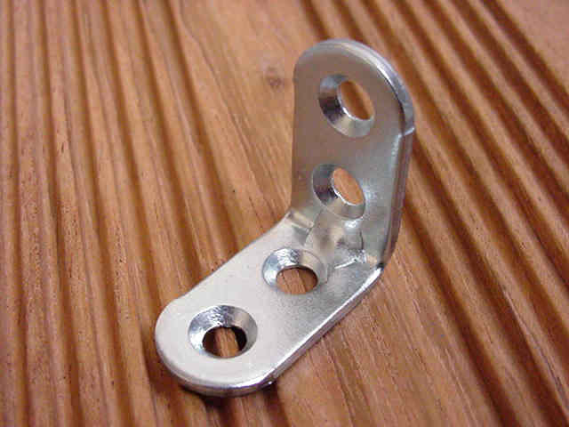

Yup that's what I was thinking. It might be easiest with the wood being individual pieces that fit into grooves. The 2 wood sides fit onto the edges of the metal case and then you could add a wood base, using grooves in the 2 wood sides.
Basically they all press fit together and then if needed use some of those coroner type bracket things to hold it together.
