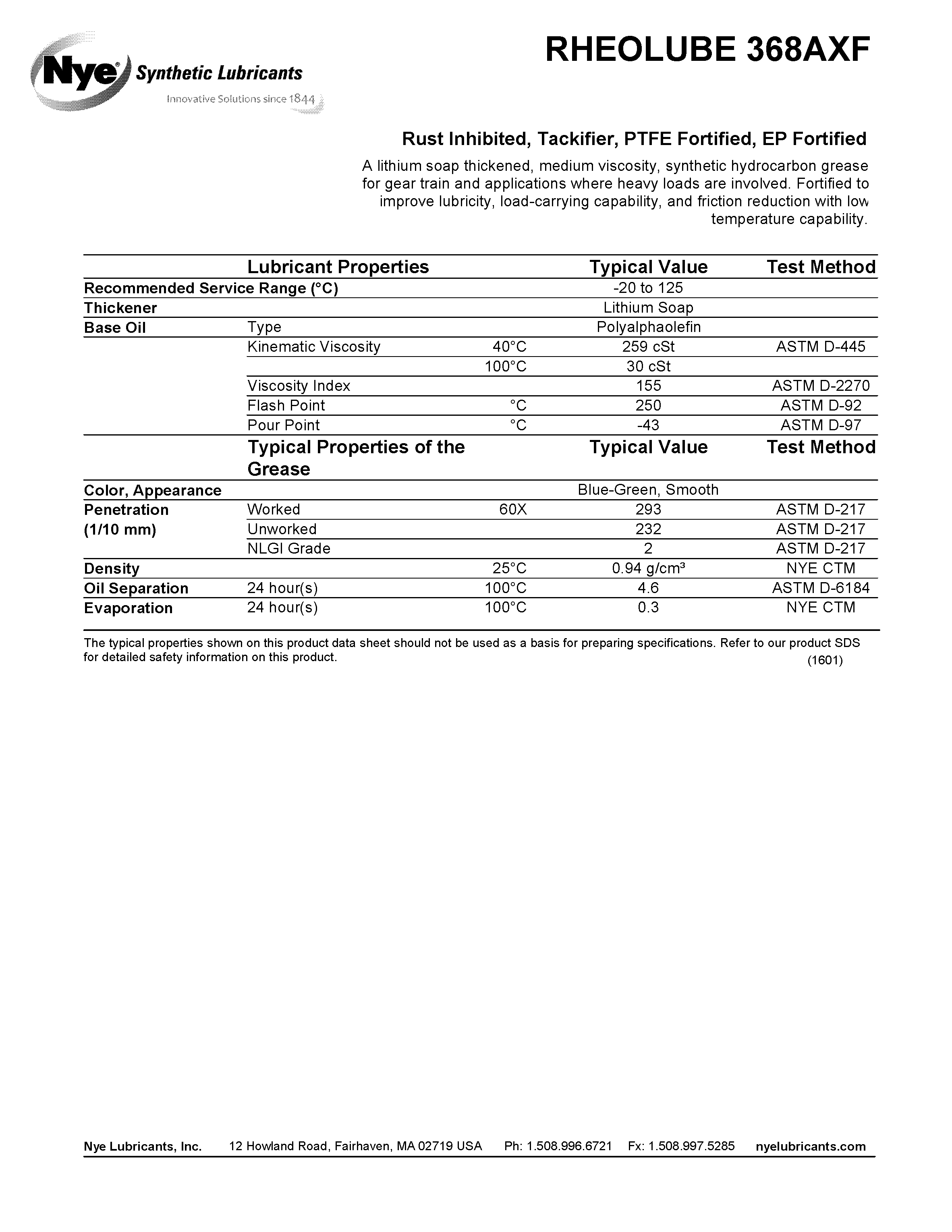

But OKS 402 is way to thin in viscosity. The OG lube is 800mm2/s at 25C (japan measurements) not 660. How did 660 came up?
Also the Rheolube 368 that I tried is more viscous. About 200mm2/s at 40C. So 100mm2/s @ 40C of OKS402 seems way, way too thin. If the R368 didn't work, it will be even worse with oks402. (Assuming that viscosity plays a major role, which may not)
Yeah, I thought the same about the viscosity when I received the mail. Might be interesting to try it out anyways.
I sent him the information on the ThreeBond lube thats where the number 600 comes from.

I've done my first testing of the greases and here are my results:
NOTE: I removed the click leafs, in order to focus only on the sliding smoothness, stick-slip and binding
1. Rheolube 368AXF

The Rheolube 368AXF, despite not being viscous enough to give a smooth sliding and eliminate stick-slip and binding, it was certainly not as bad as the F868 or the N. 774H, in fact it did feel kind of like the OG lube. This makes sense, because they are made of the same ingredients as the OG. The difference is that the R. 686AXF is much lighter (more than half the viscosity of OG). Therefore I guess that if there was a version of 368AXF that had at least double the viscosity, it probably be similar to OG.
One more important thing that I don't demonstrate in this video, is that the Rheolube 368AXF, when used with the click leaf, it eliminated the upstroke click, just like the OG lube. N. 767A on the other hand is doing the exact opposite, it accentuates the upstroke click instead. So, the takeaway is that there is something about Lithium Soap thickener that works with SKCM both for the stems and for the leafs.
Next test that I will try, is to mix a bit of 767A with 368AXF, and I hope that it will make the 368AXF strong/thick enough to eliminate any binding and stick slip while retaining its good properties that both it and the OG lube have.

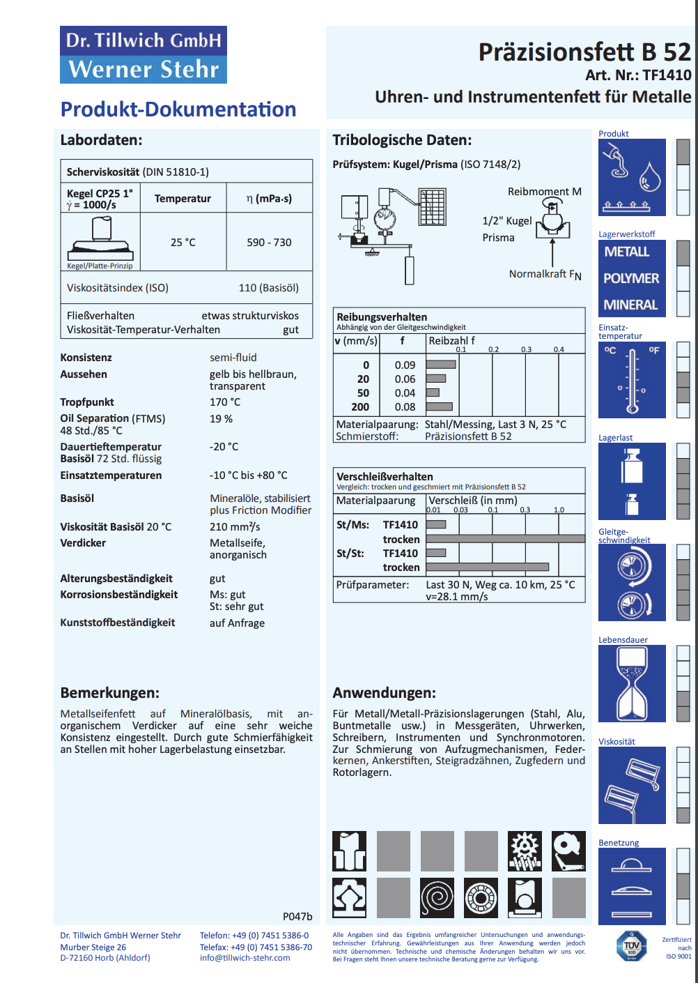

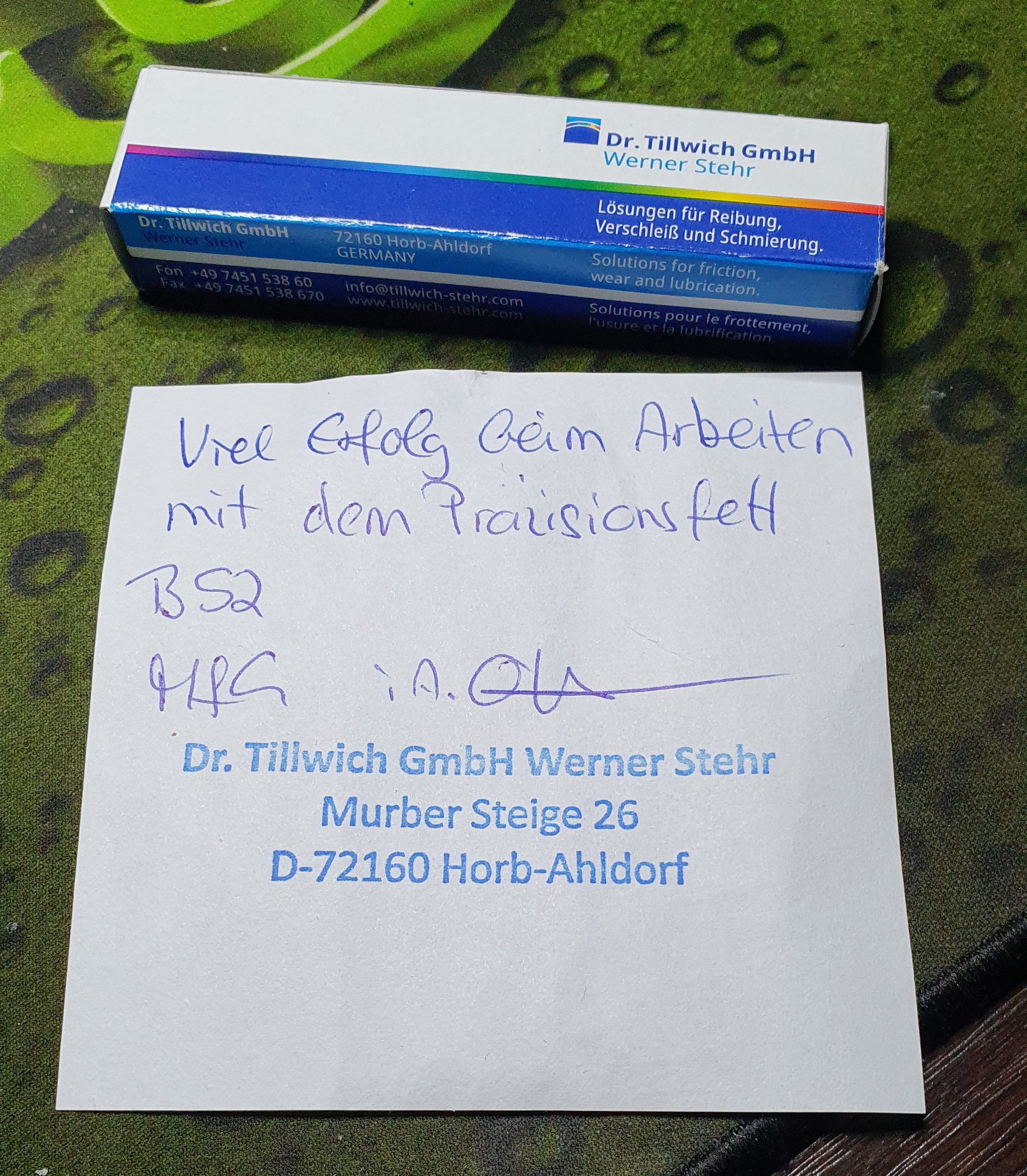

A different company responded an advised me to use the so called ,,Präzisionsschmierfett B52 TF11410''. It's a precision grease used for mechanical parts and the specs are as followed:
Precision grease -> TF1410, grade B-52
Content -> 7 g
Appearance / Color -> yellowish / ASTM 1
Consistency -> very soft, semi-liquid
Density 20 ° C (g / cm³) -> DIN 0.9
Density 20 ° C, mPa - s -> D = 500 s · ¹ ---> 1100 | D = 5000 s · ¹ ---> 600
Dropping point ° C -> 180
Base oil -> mineral oils
Thickener -> metal soap + inorganic
Basic construction -> Metal soap grease based on mineral oil adjusted to very soft consistency by inorganic gel agents
Application temperature. ° C -> -20 to +80
Dangerous goods -> NO
an extra data sheet is also available, but unfortunately only in german (https://www.fohrmann.com/media/pdf/a0/6 ... tt-B52.pdf)
If someone wants to buy it here's the link:
https://www.uhrmacherwerkzeuge.com/Till ... ase-TF1410

however I can't seem to download the pdf from my mobile. And those specs they gave are not helpful. I'll try later with my pc.
Bjerrk
23 Jan 2022, 14:26
Somehow the links were cut off.
Lalaland124
23 Jan 2022, 14:35
Should work now. If not here's a screenshot:
NeK
23 Jan 2022, 14:50
thanks! Looking at the specs, I found what the important bit: viscosity basisol, which I guess means (absolute) Viscosity of Base Oil. At 20C is 210mm2/s. OG specs are 800mm2/s at 25C, which is 5 times more viscous at 5C more. Which at 20C mudt be even more viscous (more than 800mm2/s).
So, it's way too thin and imho it is not worth pursuing it any further.

Wait a minute. It has this table on the top left with the title "scherviskositat" that it is 590-730 mPa/s at 25C. can you please translate what that means? It seems interesting.
Bjerrk
23 Jan 2022, 15:08
Sounds like the dynamic shear viscosity! (It's mPa*s btw :-) )
Lalaland124
23 Jan 2022, 15:11
NeK wrote: 23 Jan 2022, 15:01 Wait a minute. It has this table on the top left with the title "scherviskositat" that it is 590-730 mPa/s at 25C. can you please translate what that means? It seems interesting.
Here's a translation based on the German explanation for "scherviskosität":
"The resistance between the upper and lower plates can be measured as dynamic viscosity in Pa-s (Pascal seconds) and specified as shear viscosity for lubricating greases. The velocity gradient between the plates is given as shear rate in 1/s."
So it seems like it's shear viscosity :)
Maybe someone with a background in mechanics can tell us more about it.
23 Jan 2022, 15:15
Shear means sliding, like a slider in a switch. So I reckon that's the sliding viscosity: the relevant kind for switches.
Ordinarily, viscosity is the scientific term for how gloopy something is. But sheer viscosity will be specific to how it slides.

That means that if "dynamic shear viscosity" is comparable to the plain "dynamic viscosity" of the OG specs, then... it comes pretty close!
However I don't trust the other generic things they mention like "thickener: metal soap". Metal? I mean, it can be anything from lithium soap to calcium complex or aluminium complex, right? Also the "inorganic" probably means silica/silicone which. All those deviate from the OG specs. :(
Bjerrk
23 Jan 2022, 15:31
Yeah, agreed, super vague. Shear stress basically refers to forces due to sliding motion, so it should be the kind of (dynamic) viscosity we're looking for :-)

What confuses me is that there is a Viscosity for Base Oil, and there is a Viscosity for the whole lube? Am I reading this correctly? If that is the case then this means that the specs of all greases that state the Base Oil Viscosity, could be different from the Viscosity of the whole grease. Now that is something I didn't think before. And makes everything much, much more complex.

Can you ask her:
1. is the Dynamic Shear Viscosity, the common "Dynamic Viscosity" that is found in all lubricant TDS and that we should focus on it or we should only focus on the "Base Oil Viscosity" ? In other words, is the grease's viscosity 730 mPa*s @ 25C or is it 210mm2/s at 20C? Which is the one?
2. What "Metal" soap is exactly? Lithium-Soap, Lithium-Complex, Calcium-soap, Aluminium-Soap or is it something else?
Lalaland124
23 Jan 2022, 19:12
She sent me this in her original mail. I don't know why but somehow I didn't see it until now:
,,Es ist auf Basis von Mineralöl und Lithiumseife aufgebaut und wird auf eine Zielviskosität 660 mPa.s bei Scherrate 1000/s und 25°C Prüftemperatur eingestellt.''
So it's based on lithium soap and mineral oil. The target viscosity is 660 mPa.s at a shear rate of 1000/s and 25°C test temperature. She also added that I could have a test sample sent to me.
I (also?) sent an email to https://www.tillwich-stehr.com/en which makes the product and asked them about it and if it is adequate to replace the original lube or if they have another product that can do it. Let's wait and see what they will reply.
Lalaland124
03 Feb 2022, 10:23
NeK wrote: 03 Feb 2022, 10:11
Lalaland124 wrote: 23 Jan 2022, 14:02 A different company responded an advised me to use the so called ,,Präzisionsschmierfett B52 TF11410''. It's a precision grease used for mechanical parts and the specs are as followed:
Content -> 7 g

NeK
27 Feb 2022, 23:58
Thanks to Lalaland124, I received the Dr. Tillwich lube!
(no idea what it says, I don't speak German) :oops:
And here are my results:
Ouch... That didn't go well, at all. :|
I am starting to think that the consistency of the lube may be the detrimental factor and not the viscosity for SKCM. Still the only lube that really does is still the Nyogel 767A, which apart from being exceptionally viscous, it is also NLGI 3 (stiff).
Maybe that is way wax works somewhat, because it is pretty stiff (at least NLGI 3, even more). The OG lube specs do not state its consistency, maybe that's what we have overlooked all this time? :?:
