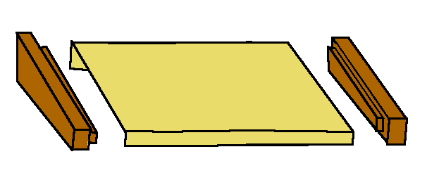

03 May 2014, 20:06
matt3o wrote:I mean that the slot for the plate has to be CNC'd. I don't see any other way of doing it.
How about a sandwich of two laser-cut wood pieces on each side?
Either, you would have the inner wood piece enclose the metal plate, or the metal plate would enclose the wood part, or both. That would give you your friction-fit, but there would also have to be a bracket or two on each side.
-[°_°]-
03 May 2014, 20:17
you mean wood > plate > wood ?
03 May 2014, 20:24
No, instead of milling a groove down to half the thickness, use two half-thick pieces where the groove is cut right through the inner piece.
-[°_°]-
03 May 2014, 20:26
yes gotcha. so basically if you look the keyboard from the side you see wood > alu > wood. it might work actually

03 May 2014, 20:45
matt3o wrote:yes gotcha. so basically if you look the keyboard from the side you see wood > alu > wood. it might work actually
Yes. To make it easier to see what I mean, here is a very rough sketch. Brown = wood. Yellow = sheet metal. (Switch holes take too much effort to draw :P )
I am not sure I would like this myself, but I got the impression that the discussion was about something like this and I want to give input.
-[°_°]-
03 May 2014, 20:48
oh ok. you have to find a way to fix the metal to the wood though but the one you show there is definitely the easiest solution. I actually liked the idea of insetting the metal into the wood.
