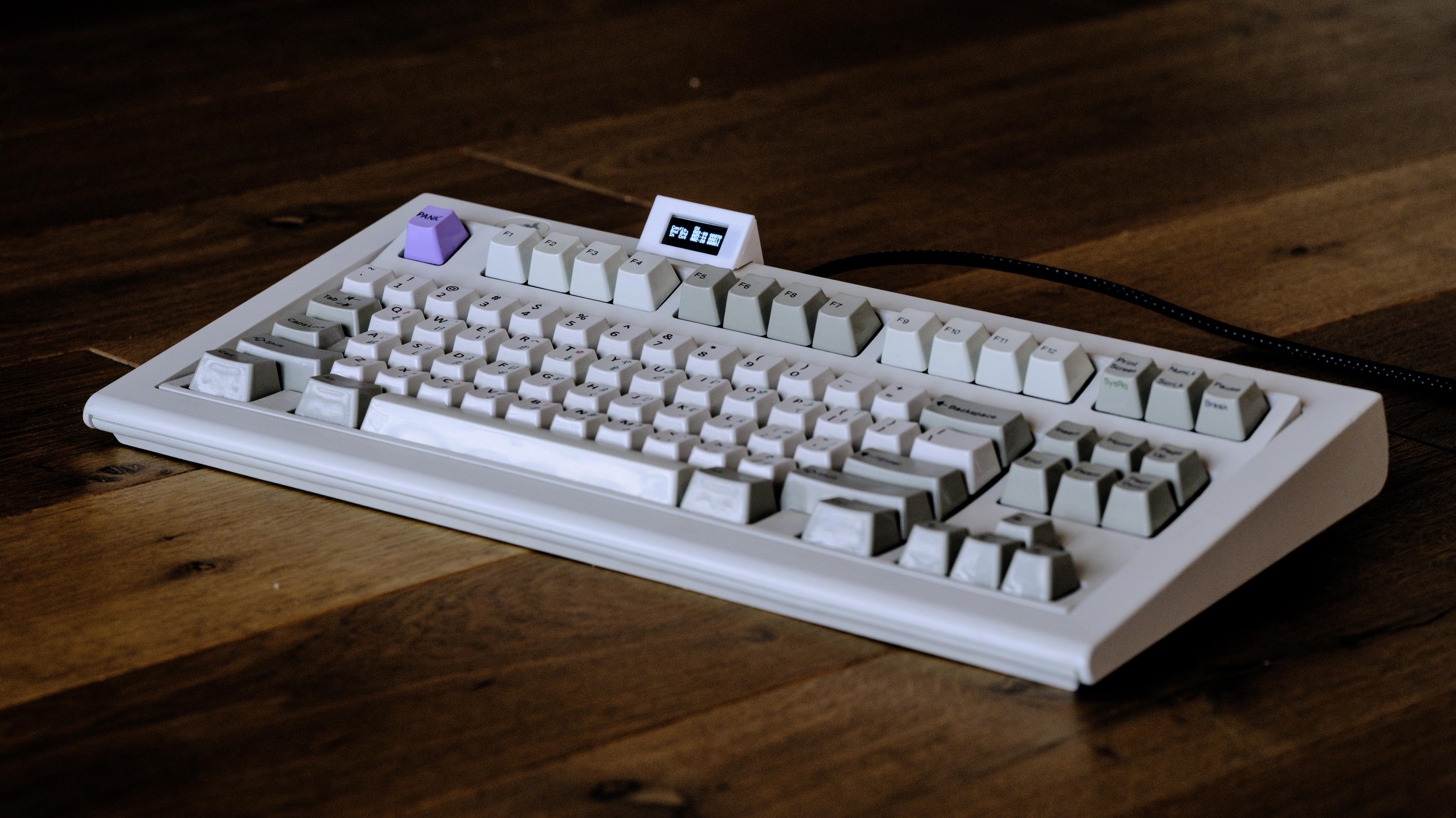

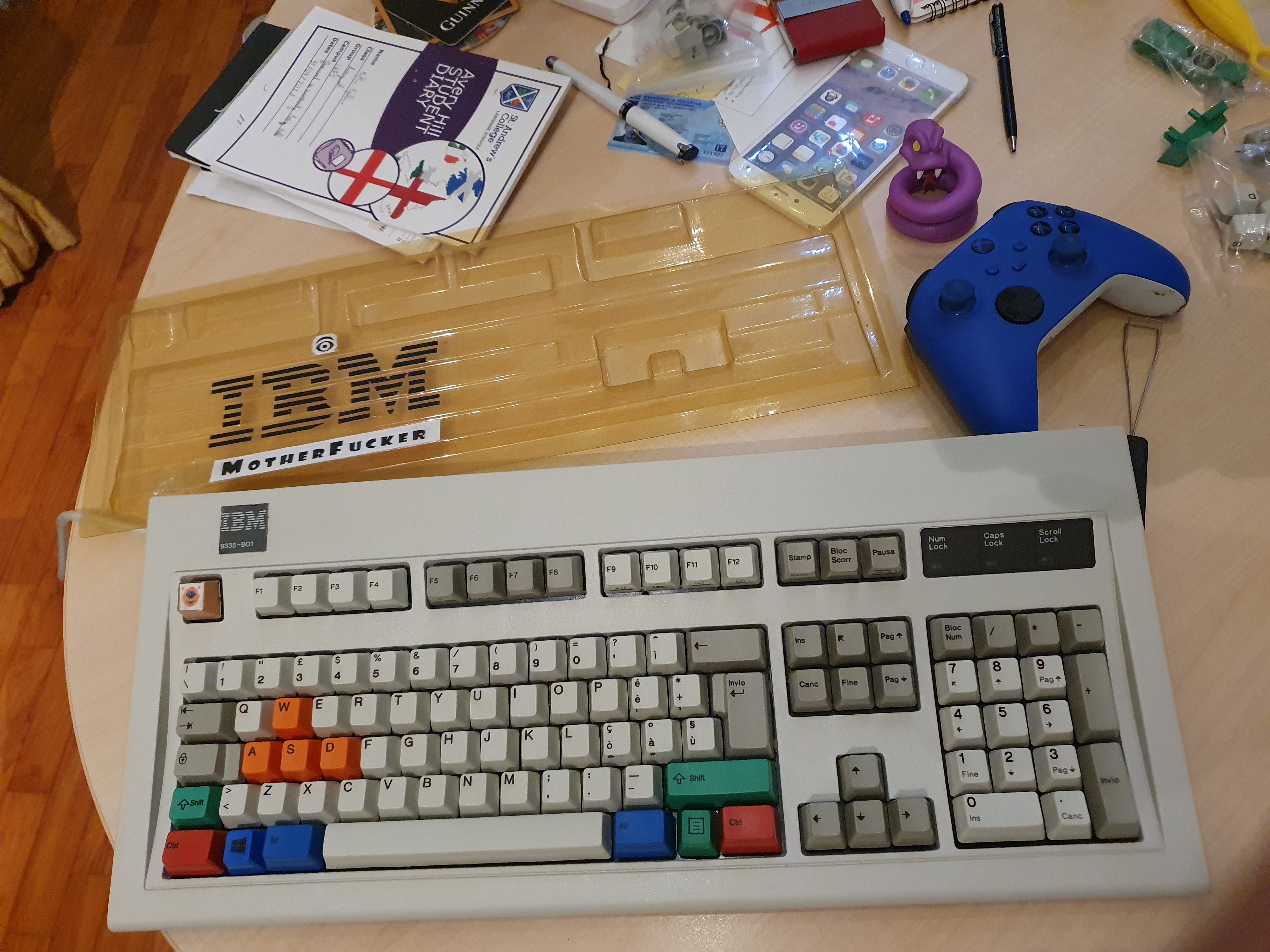

Let's create the FSSK/FEXT = DONE !!!!
inozenz
16 Dec 2022, 13:01
dcopellino wrote: 16 Dec 2022, 12:36 20221215_171542.jpg
all well that's end well
omg i love this! great job man! also super nice carpet for the mouse hahaha :D
dcopellino
16 Dec 2022, 16:39
inozenz wrote: 16 Dec 2022, 13:01
all's well that ends well
Thanks my friend. You caught my typos on the spot before I realised them out and I could fix them in seconds with all due respect to Shakespeare and Muirium. The latter, always on time.
Man from Mars
16 Dec 2022, 19:30
dcopellino wrote: 16 Dec 2022, 12:36 all's well that ends well
Very nice! How (When) can I book a "test drive"? :D
dcopellino
16 Dec 2022, 19:54
Man from Mars wrote: 16 Dec 2022, 19:30
whenever you want, you're welcome to my home. Sorry, but i can't take it to the billiards :D

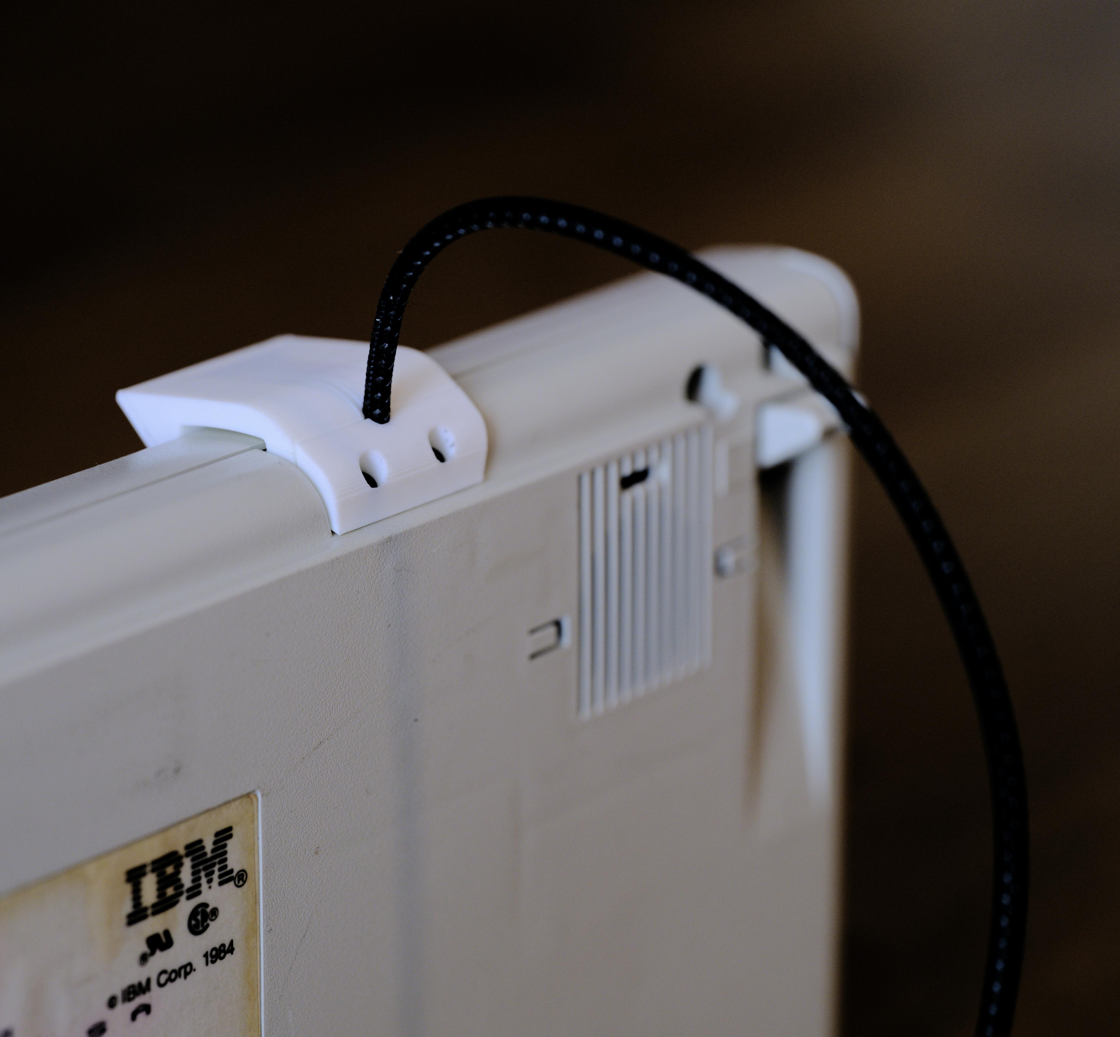

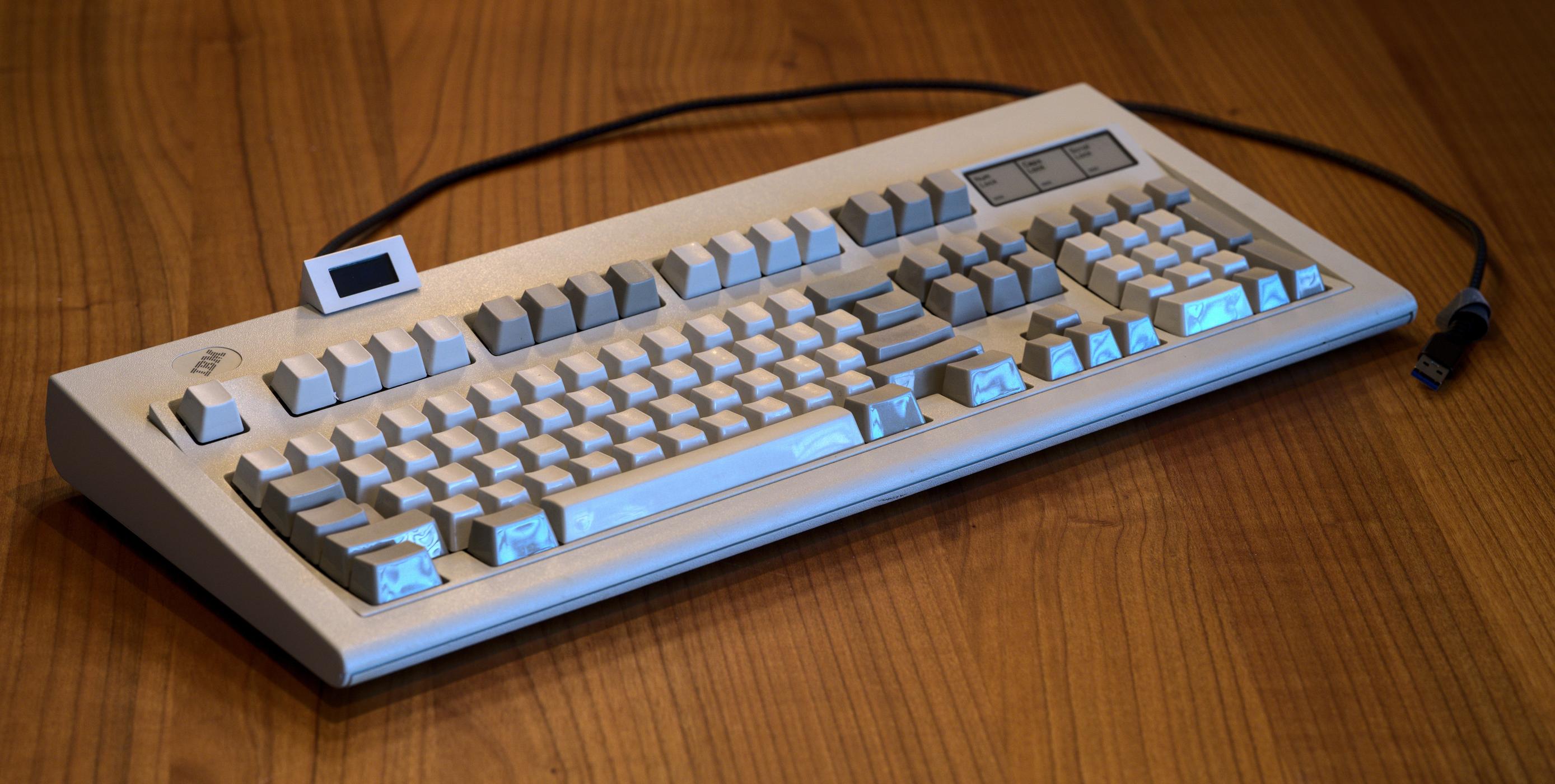

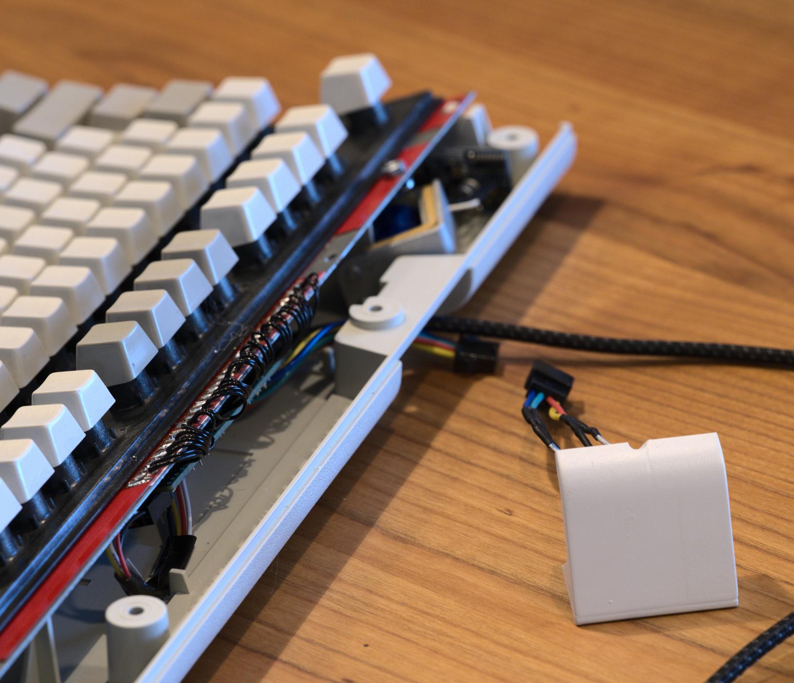

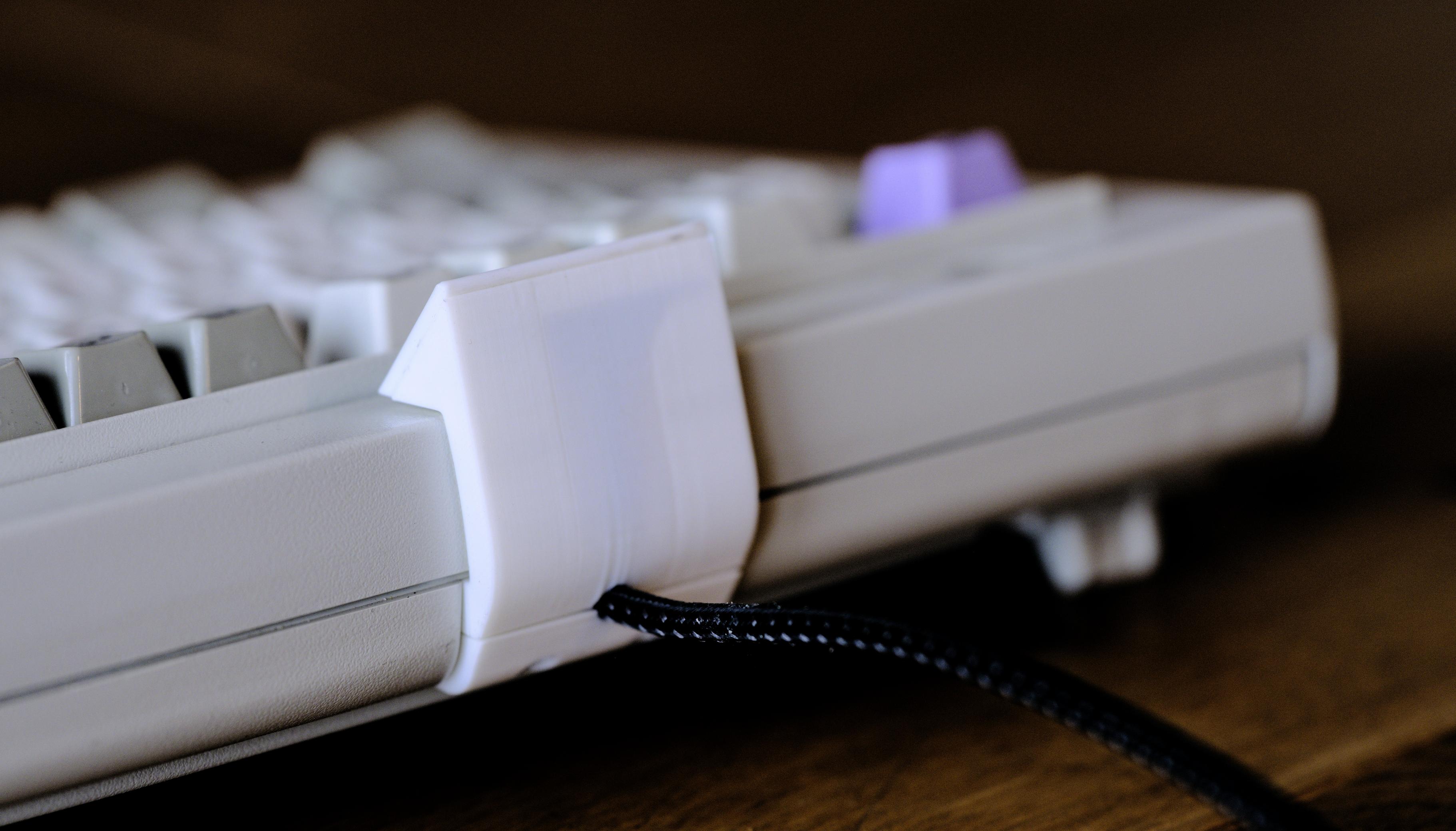

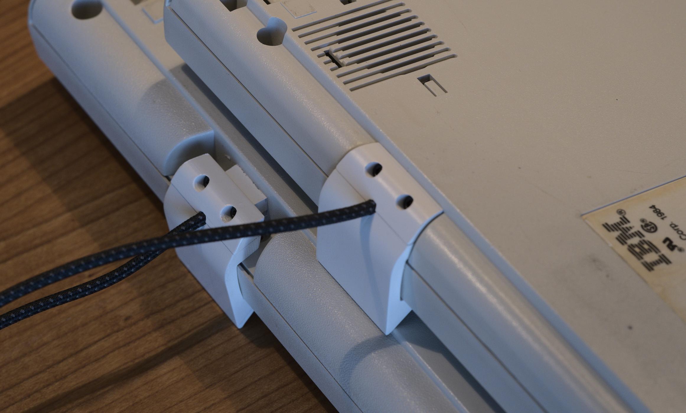

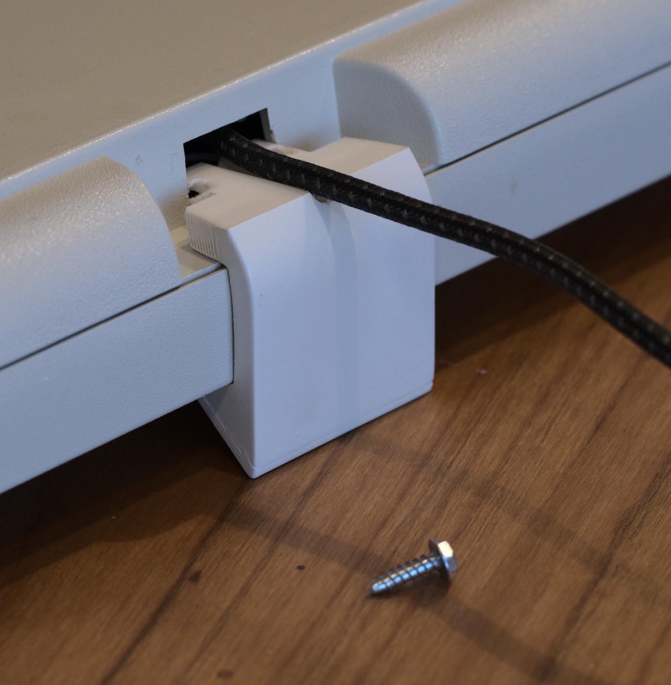

dcopellino wrote: 16 Dec 2022, 12:36 .......continues from the post above

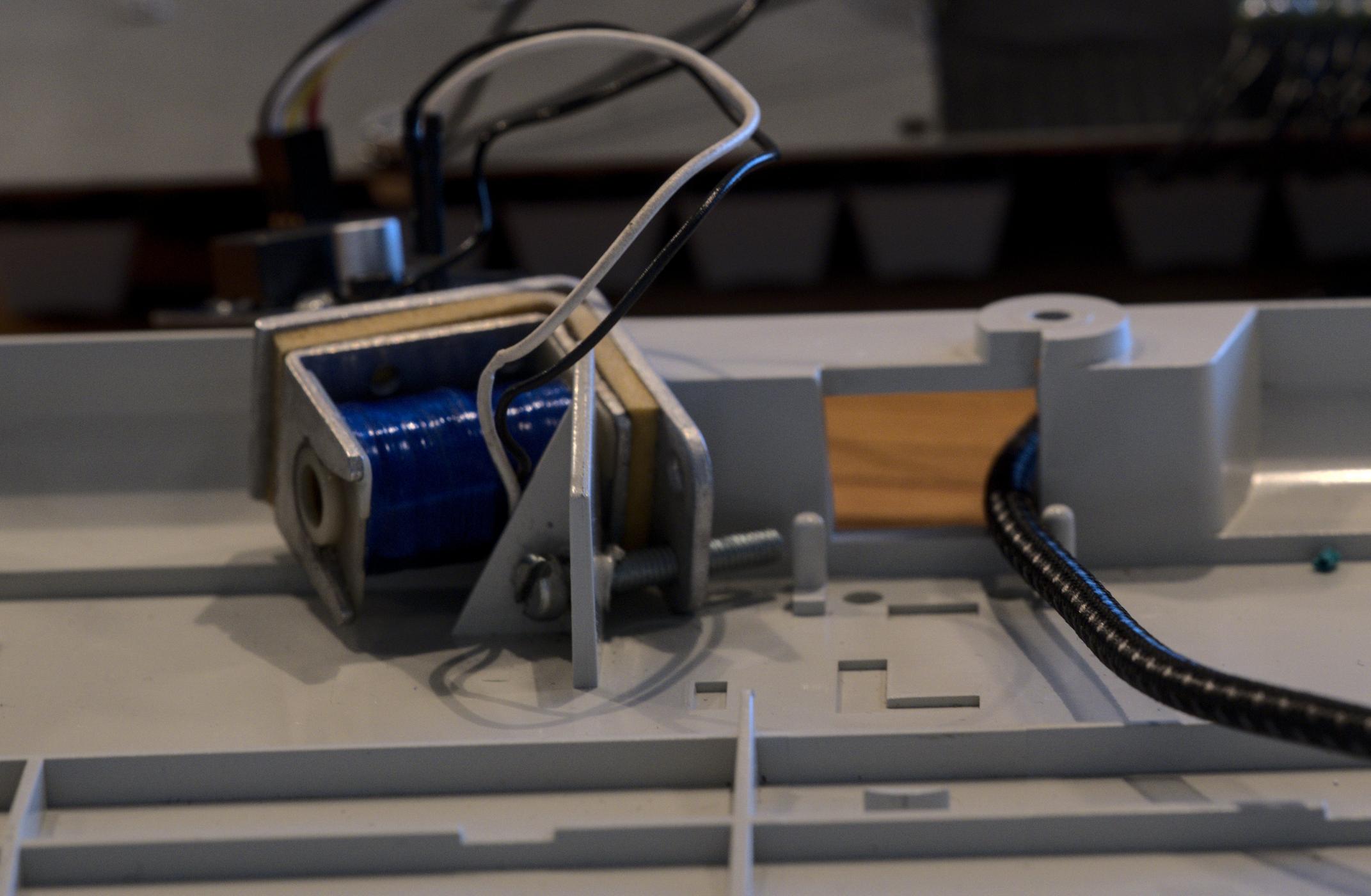

Fastening and unfastening all layers together or tuning a musical instrument
I had to devise this system, instead of the classic pair of books placed on the sides of the metal plate, in order to get the right tension throughout the surface during the process of inserting the screws. The wood sticks (2/3 horizontal and 1 vertical, the big pencil) protruded just enough to prevent the springs from touching the desk, letting the hammers lose their correct position in the barrel frame.
I know, I completely missed the building of the right tool, lost somewhere among DTs posts.
I’ve done several MODs on Model Ms, both the bolt mod and the screw mods, even on a Model M122 but this time was different, very different due to the presence of a PCB that changed my references in terms of thickness and curvature tolerance of the parts involved. I had to pay more attention to filing the edges around the holes. Any inaccuracy in the alignment of the parts or excessive screwing force inevitably caused problems in obtaining the correct key feeling and relative click-clack sound. I had to close and re-open the layers at least 6 or 7 times in order to get the perfect combination. It was nothing more or less like tuning a musical instrument, in the true sense of the word.
Making extra room to house the controller into the bottom case. Look at my birth date.... :mrgreen:
Finally, the case closes. I had to cut the piece of plastic swown in the pic if I wanted the SMD controller with the attached microUSB cable to properly fit beneath the keyboard bed, avoiding to damage the Micro Pro the usb connector (oops).
Keep testing and other extra final steps.
Some final tests with Pandrew’s USB utils before closing the case. On the right side LED lights work even though in a weird way, due to some incompatibilities. It seems that the SMD controller supports natively only the IBM AT leds.
This is so well done! hope you are enjoying the "FSSK" well.

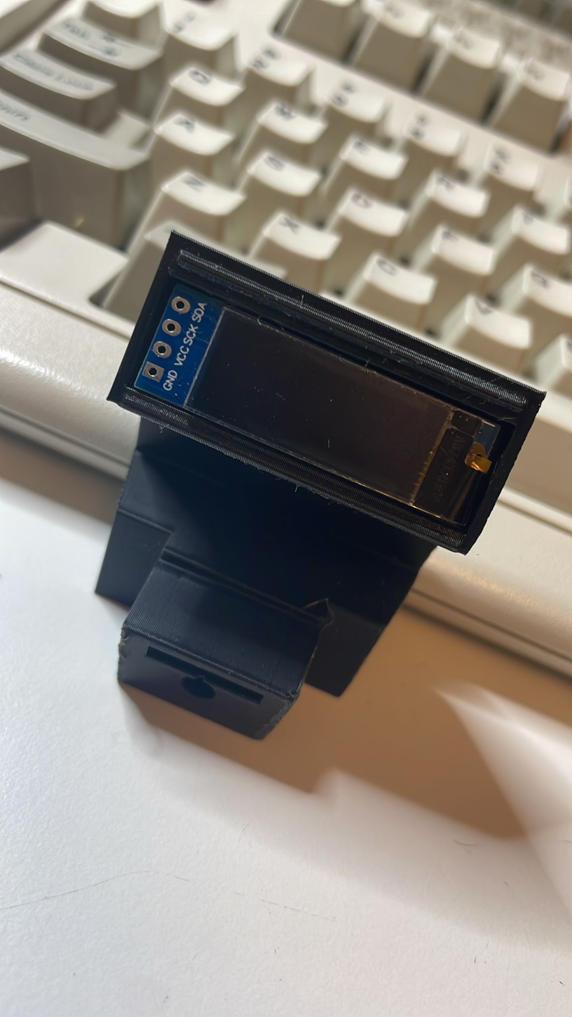

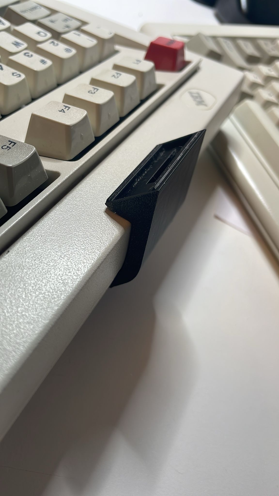

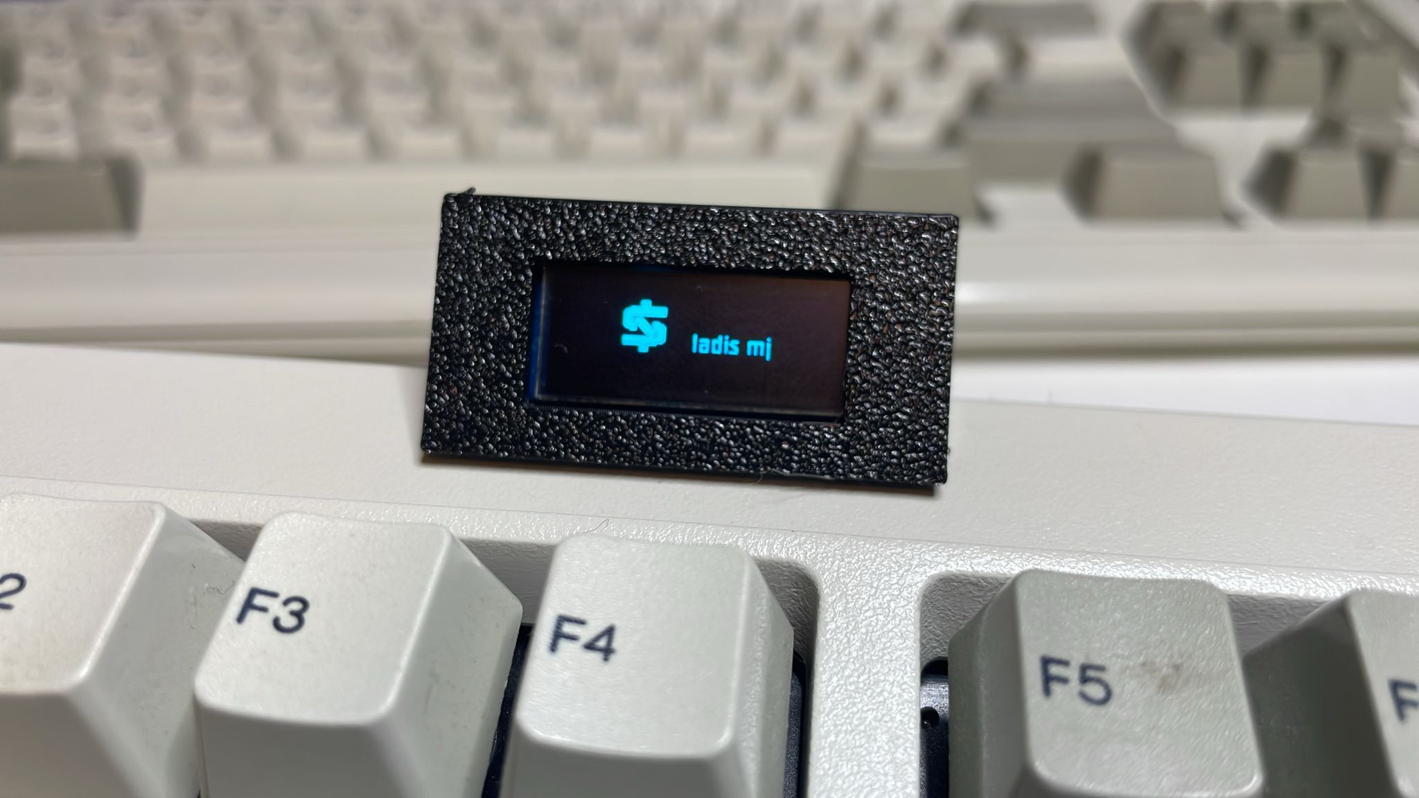

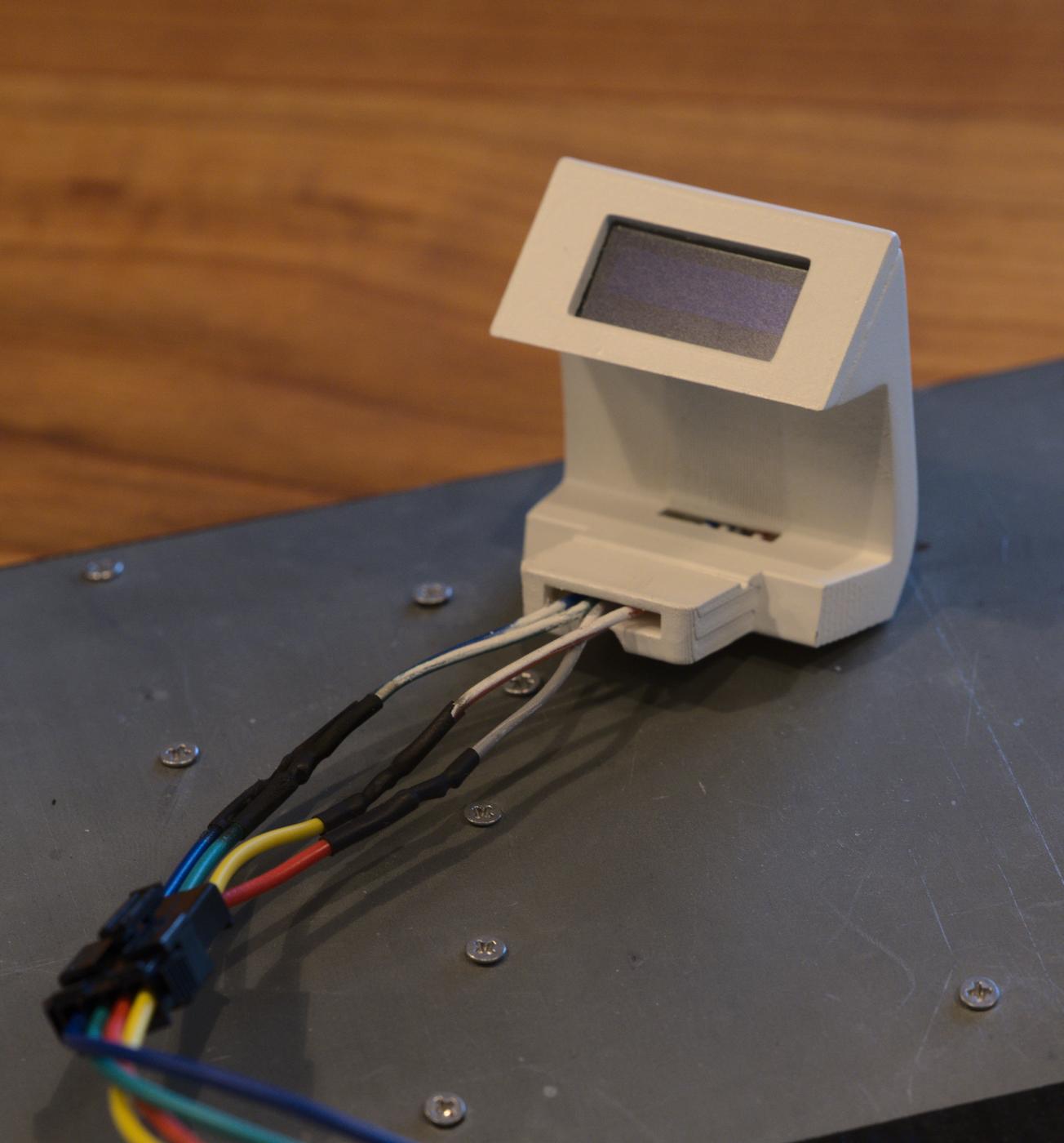

    Hi,
    I post a spoiler of the posts which I plan in the next days once the work is completed to my satisfaction.
    You may know that I have replaced the xwhatsit controller in my FSSKs with the wonderful Leyden-Jar designed by Rico. I just use these keyboards to type.
    The RP2040 MCU used in the Leyden-Kar controller is much faster. It also has more storage space which allows to update the firmware as needed. I compiled Rico's firmware to include QMK & VIAL. (reference: https://github.com/mymakercorner/Leyden_Jar)
    Rico has exposed the i2c interface in his controller. This allows to solve the only issue that I found in the SSK: these keyboards miss the status LEDs. It is possible to use the i2c interface to add an OLED display, supported by QMK. The question was, how to integrate it ... the answer is 3d printing and Fusion360.
    In the attached you can find the first prototype which I completed last weekend.
    By mistake I purchased blue OLED displays which I do not like. They need to be white.
    Also, I plan to properly finish the 3d part and paint to a colour closer to the original SSK case.
    I will post the progress on this project. I just need to find the time to continue.
    Until then ... let me know your comments/suggestions.
    Cheers
    Note: forgive the quality of the pictures, I used the telephone.
    Note2: disregard the content of the LED in the picture. It was just a test using a library from a LadisPad which I have.
    i$

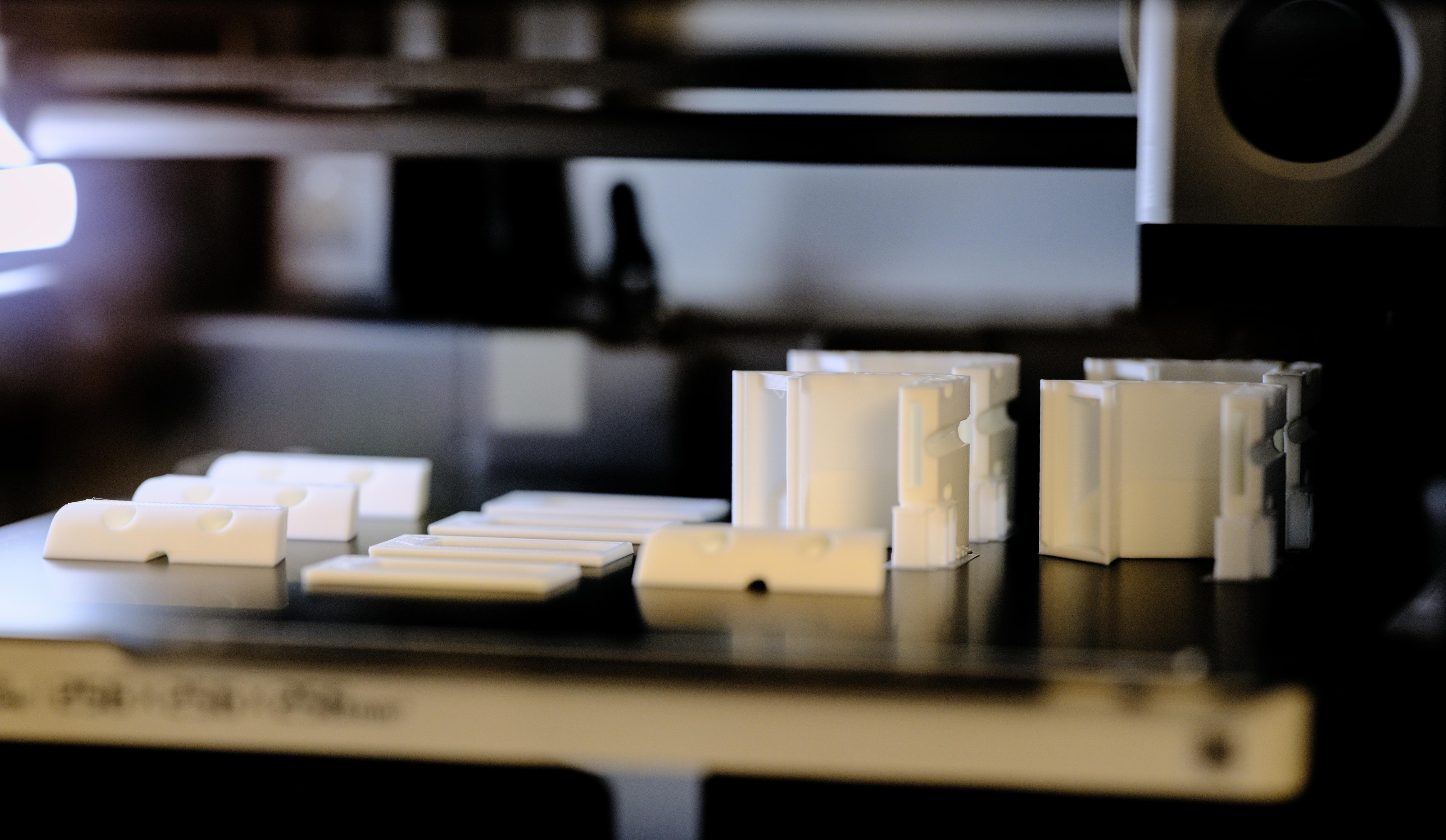

    idollar
    i$
    22 Nov 2024, 10:05
    Hi,
    Following some proper pictures on how the printout looks in white.
    I should finish and paint the parts.
    Cheers
    i$
    idollar
    i$
    22 Nov 2024, 10:09
    In the case that anyone wants to upgrade to the Leyden-Jar their real fssk, and perhaps add the oled screen, send me a PM.
    We will find a way to send you the 3D files, instructions etc ...

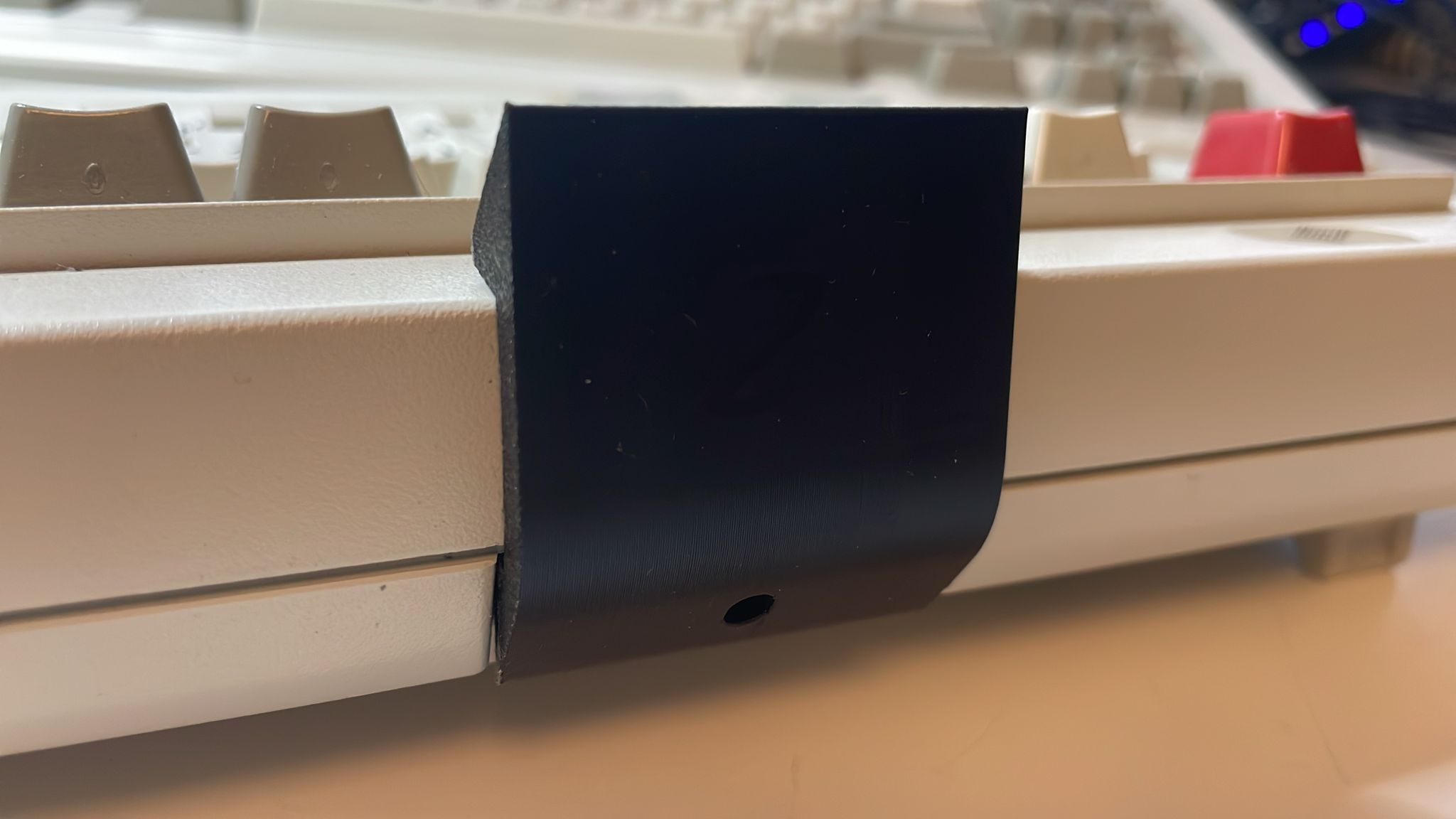

    idollar
    i$

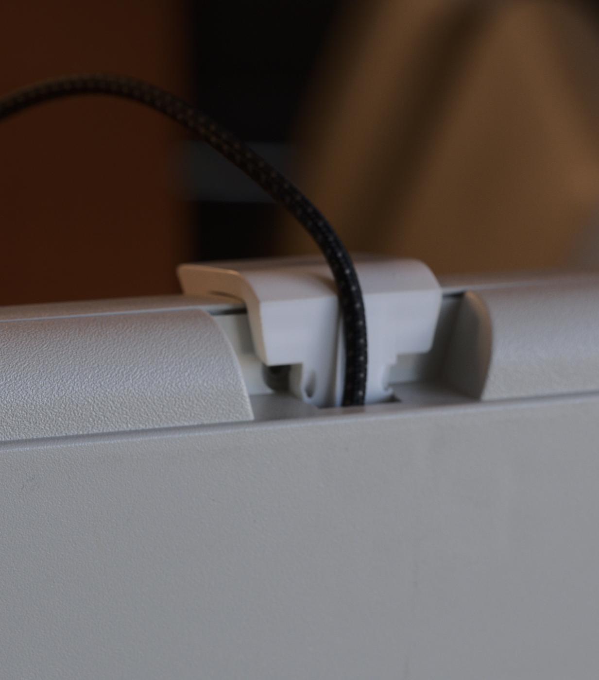

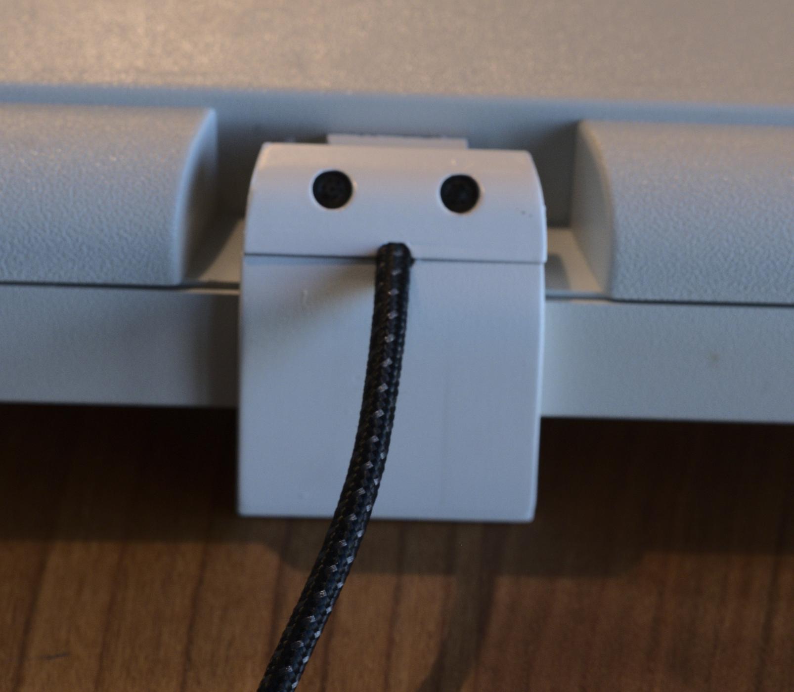

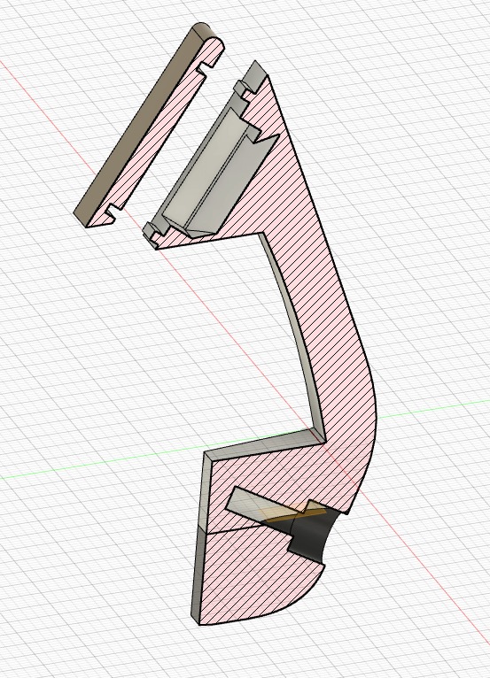

    04 Dec 2024, 20:49
    Hello,
    I attach some picture of the FEXT which I have put together these days.
    It is equipped with
    - LeydenJar
    - Solenoid

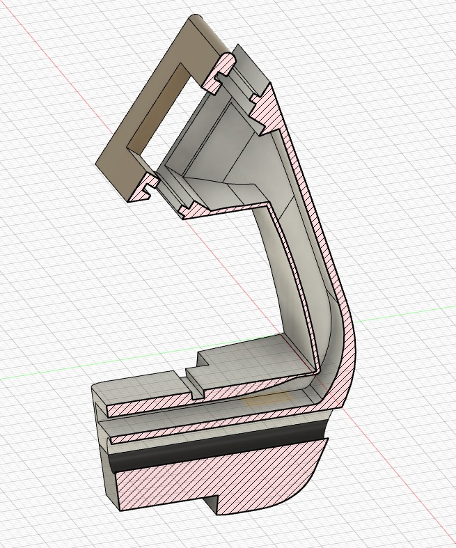

    - OLED display
    You can see that the 3D part required for the FEXT is different. I need to update the model to fit properly.
    Cheers
    Rico
    04 Dec 2024, 21:16
    This is looking great !
    idollar
    i$
    05 Dec 2024, 10:34
    Rico wrote: 04 Dec 2024, 21:16 This is looking great !
    Your controller is the core of this built, Rico.
    Thanks a lot !!
