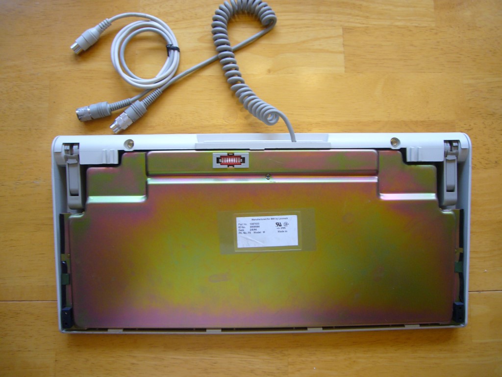

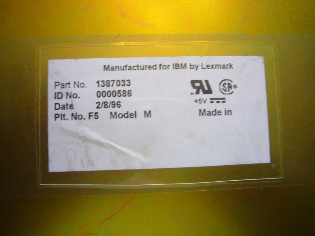

I have a Model F "Unsaver" but the sticker on the back says "Model M" and it is dated 1996.
My guess is that it was serviced or refurbished at that time, stickered with a "for-IBM-by-Lexmark" sticker, and resold or sent back to its regular owner.
F-unsaver-2016-label (Medium).JPG (119.64 KiB) Viewed 31252 times
F-unsaver-2016-rear (Medium).JPG (143.22 KiB) Viewed 31252 times

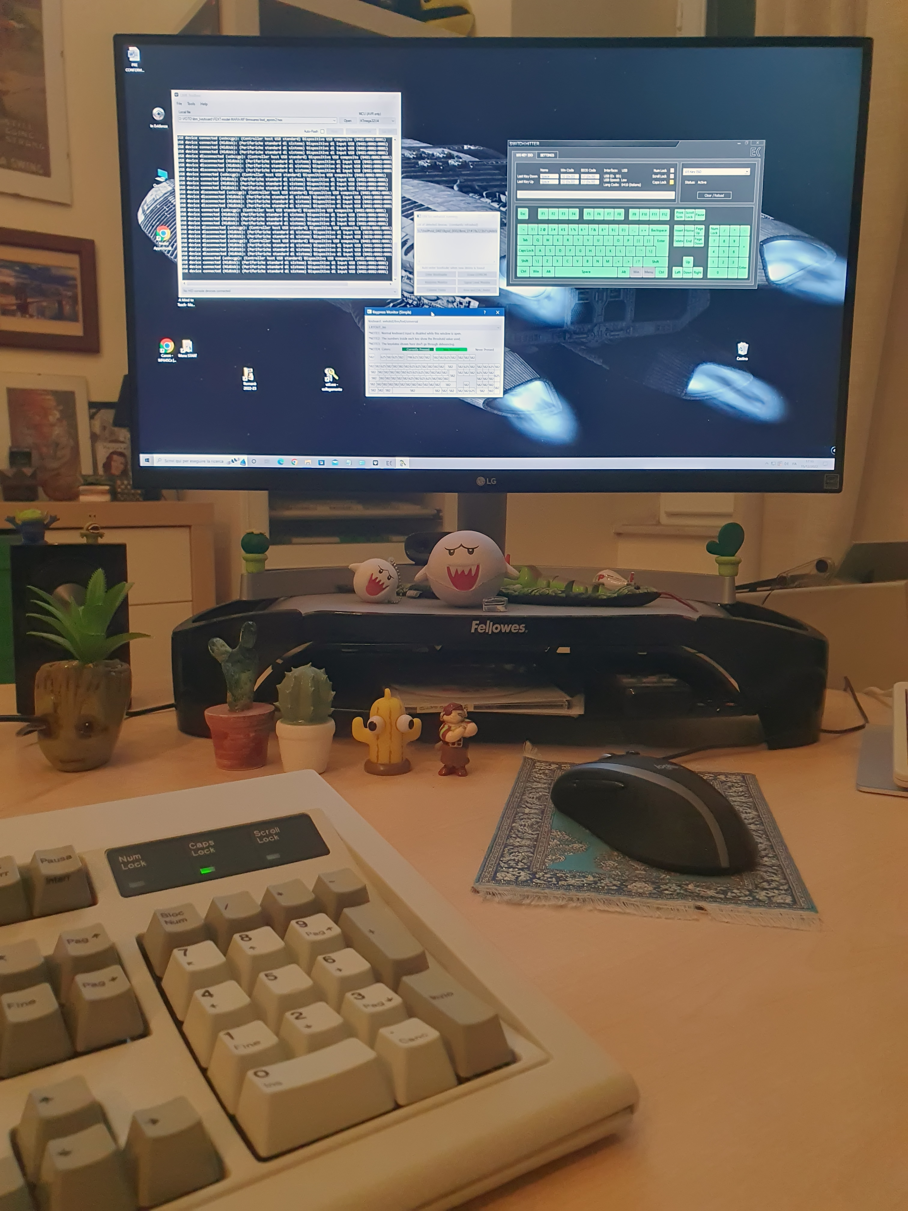

I have a working FEXT prototype without any problem !!!
As it should be, I am typing this post with the first of the FEXT, based on the PCB v1.00b with the XMIT keys (which I have not tested as I do not feel like breaking the case that I have)

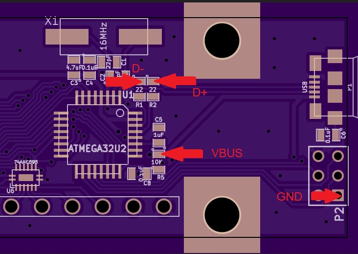

Today I reordered my desktop resulting in a broken FSSK ! The USB cable was two short so I opened it to replace it with the longer version that I needed. The connector in the xwhatsit controller got lose and … BROKE ! This is the FSSK prototype. Yes, the very first keyboard which demonstrated that we could use F flippers in an M model.
I tried to re-solder it without success. In my desperation, I decided to cut the USB cable, search for the cables and solder them directly in the components. I am posting this in case that you suffer from the same problem one day.
Here is how the cables should be soldered:
I hope that no-one suffers from the same, but if it is the case, you may try my solution
Cheers
i$
DMA
29 Feb 2020, 02:29
i$ please double-check polarity.
According to https://oshpark.com/shared_projects/eTR858GJ the square pad (with "GND" arrow) is Vbus, and GND is the one directly opposite (top left pin of P2). That USB socket is super-easy to tear off the PCB.

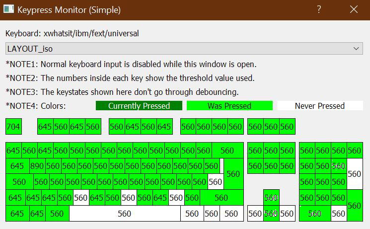

Hello. Finished with my FEXT recently, and I have a peculiar problem with an xwhatsit that I bought from Ellipse. I connected LED panel to the controller and the problem is that when I activate a lock the actual lock light switches off, and when I deactivate the lock the light turns on. I did not test it with the original firmware (v0.9.0), but with v0.9.1 and v0.9.2 the behaviour is the same.
Did someone faced something similar? I guess if it was a physical connection problem it would not be working at all, but it works only in strange manner, so it should be problem with the firmware. On the other hand there is not a word about such a problem on the Internet, and I do not believe no one uses locklights. Ellipse himself says LEDs should work flawlessly, because it historically did. So, I think the problem is in the firmware, but reality just counters my guess.
Please tell me how did it work for you?

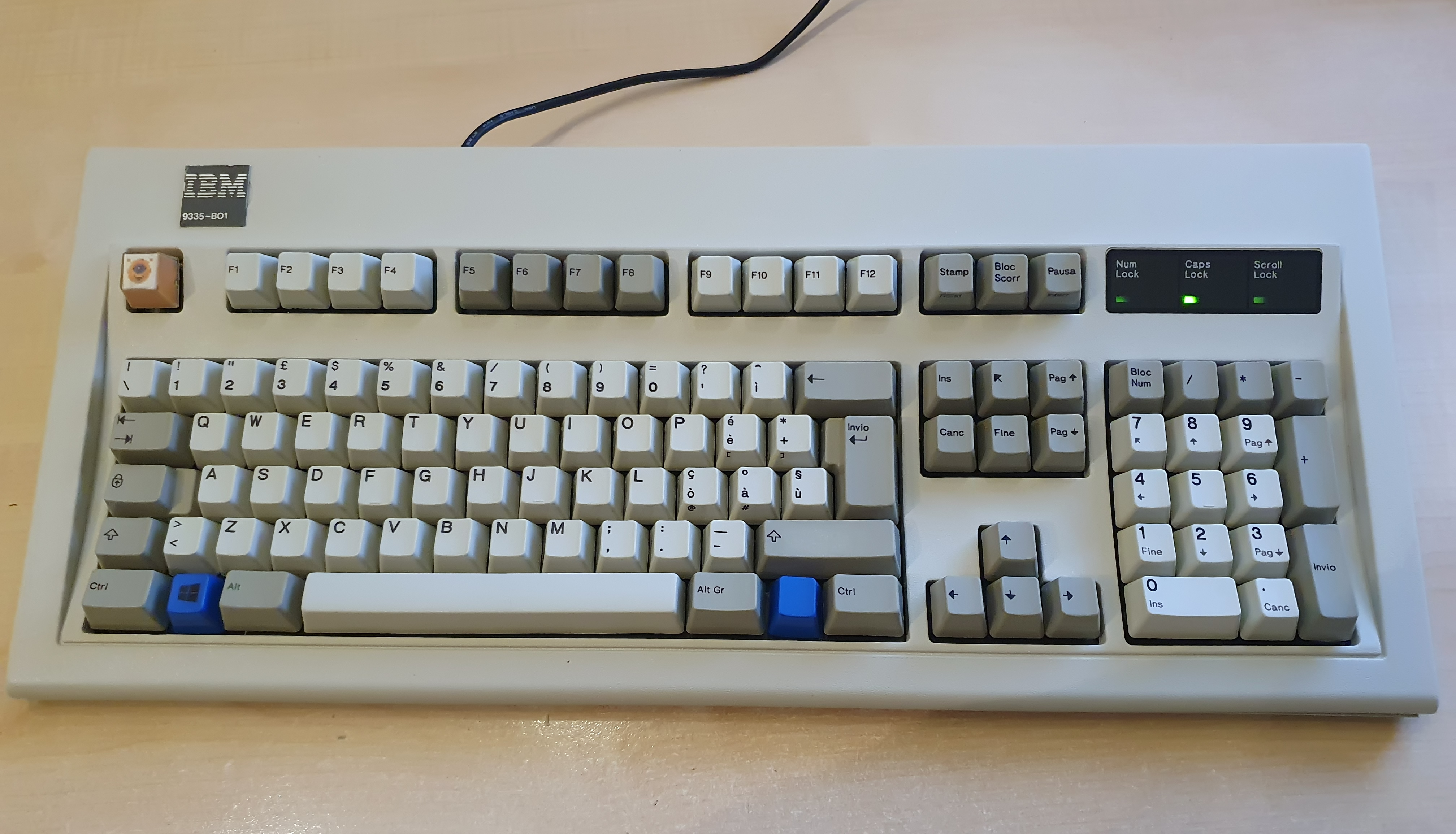

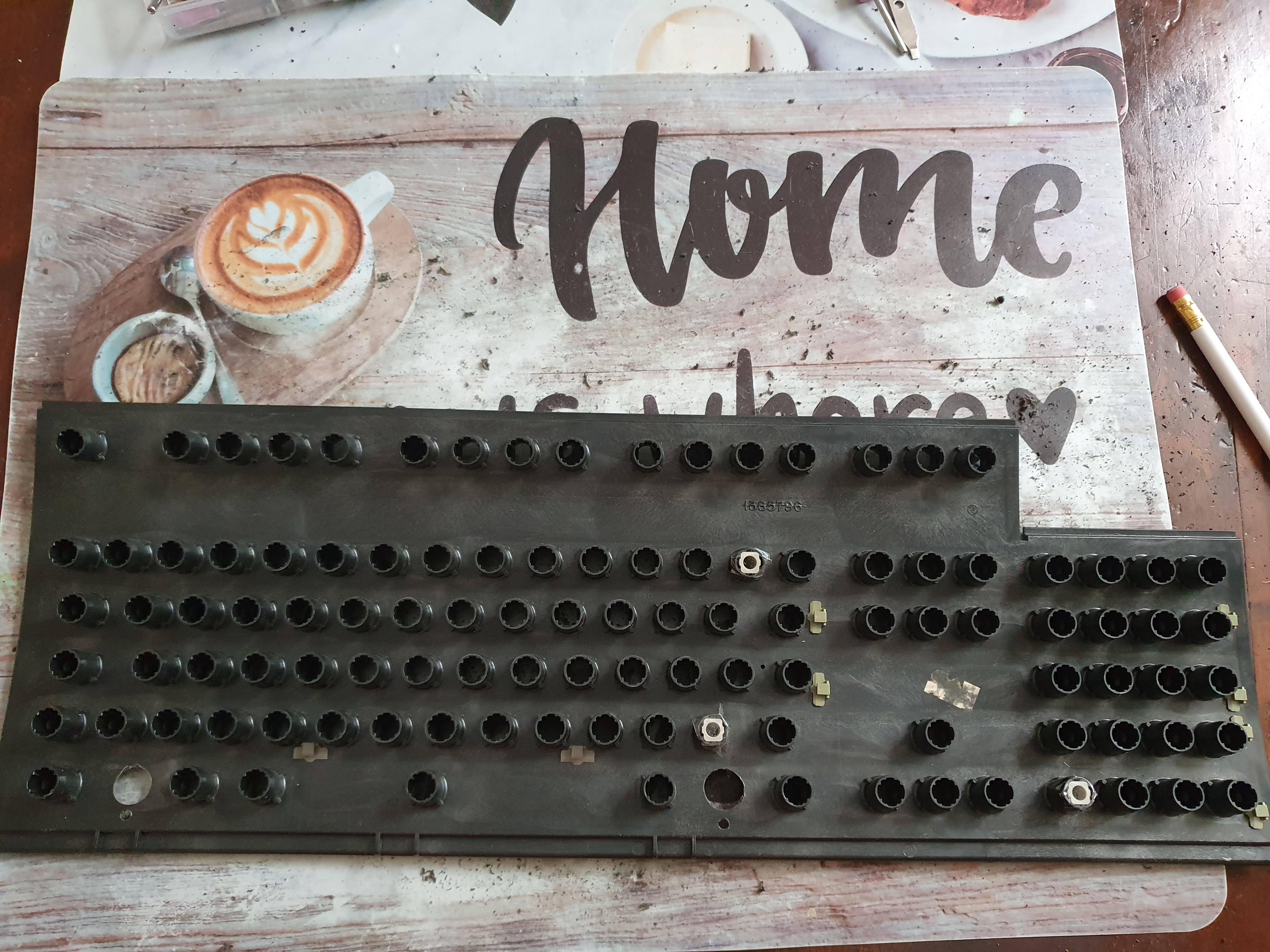

Yet another model FEXT implementation,
(aka IBM model MotherFucker*)
Assuming that “Let's create the FSSK/FEXT = DONE !!!!” should never be considered a necro but rather an evergreen common thread, I’d like to share here my pic log presenting my personal FEXT implementation according to i$'s original post to whom I give credit and gratitude, along with all the other thread contributors.
I don't know exactly why I embarked on this laborious journey that began about a year ago. Irony of fate, I started just a while after I got rid of a couple of extra Model Ms on eBay I had previously bought just because of their affordable price. Even though I’d already given a glimpse to the original i$’s post Let's create the FSSK/FEXT = DONE !!!!, At first, I didn't take it as really feasible. It must have been the awareness gained over years of accumulation and use of IBM models that finally pushed me to consider the thing in a real way. Among all the reasons that led me to assemble a model M/F I’d put in the foreground the need to ideally try to perk up a product like the Model M that is commonly perceived by click-clack lovers as nearly perfect. A feeling that is truly realized only after trying Model Fs following being a fan of Model Ms. Btw, most likely I started this adventure for having some talking during the long pool playtime with the DT user Man from Mars (thanks mate), or I'd rather tell the truth: I liked the idea of playing to be Ellipse in the middle of the QA process on his model F repros.
Ok! now that I've made peace with myself, I can start my pic log, highlighting those moments of the process that I consider by my humble point of view particularly crucial or worthy of a little more attention, just in case some other madman wants to follow me on a similar journey.
Disclaimer: the following pics were taken with my smartphone. So apologise me in advance for the poor quality, bad light exposure, etc.
Furthermore, be aware that I just documented my FEXT implementation, focusing on issues that I encountered on my way and how I troubleshot them, without any further claim.

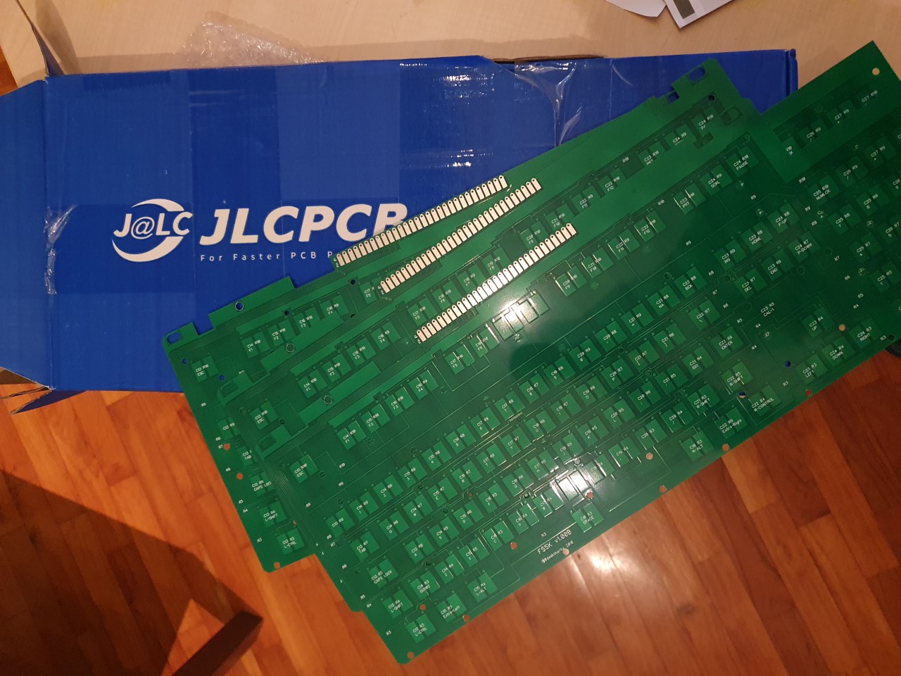

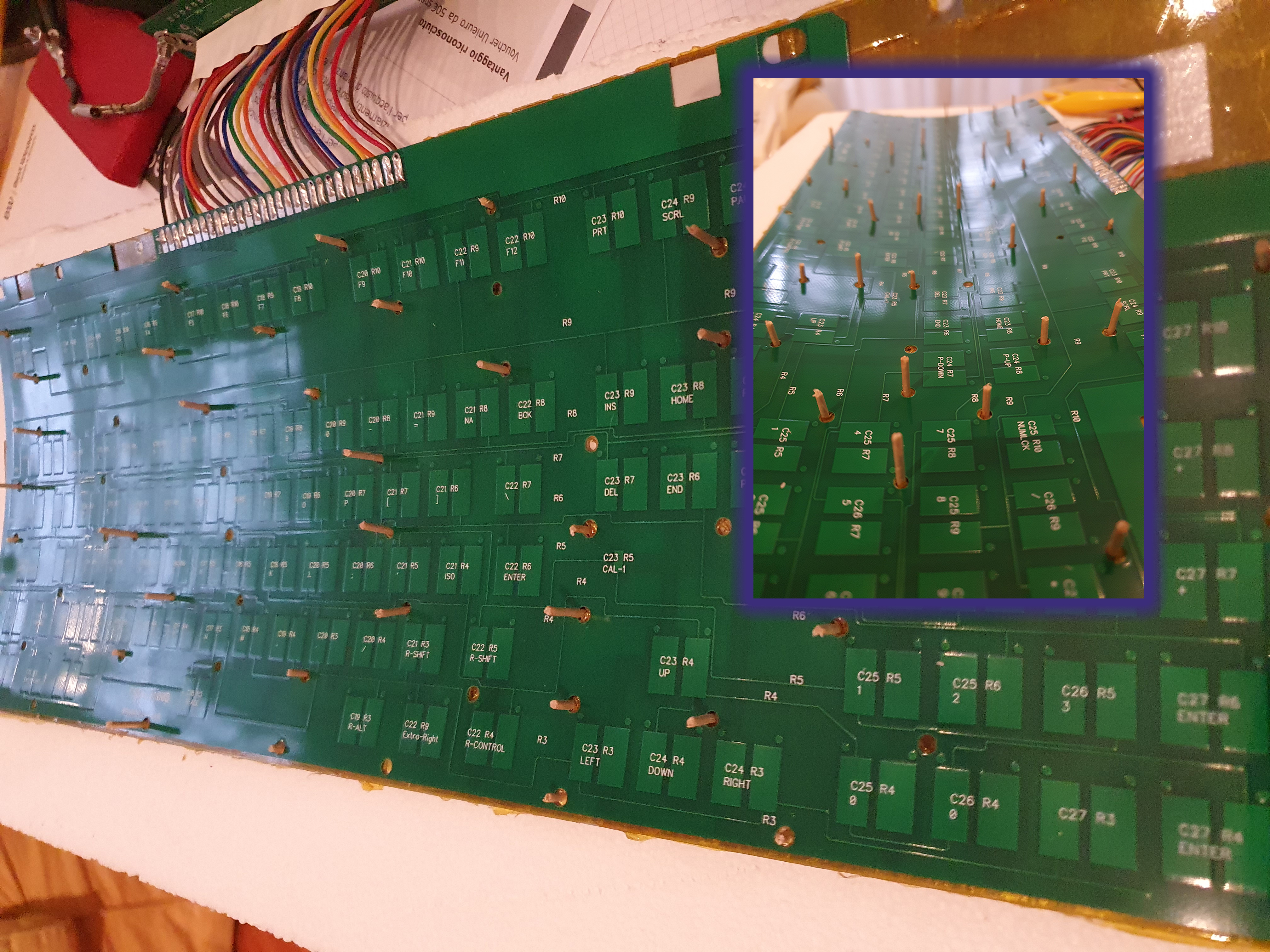

The FEXT 1.0B PCBs
PCBs (0.6mm thick) arrived very quickly from JLCPCB’s China factory, even though with a manufacturing defect. Keep reading for more details about it.

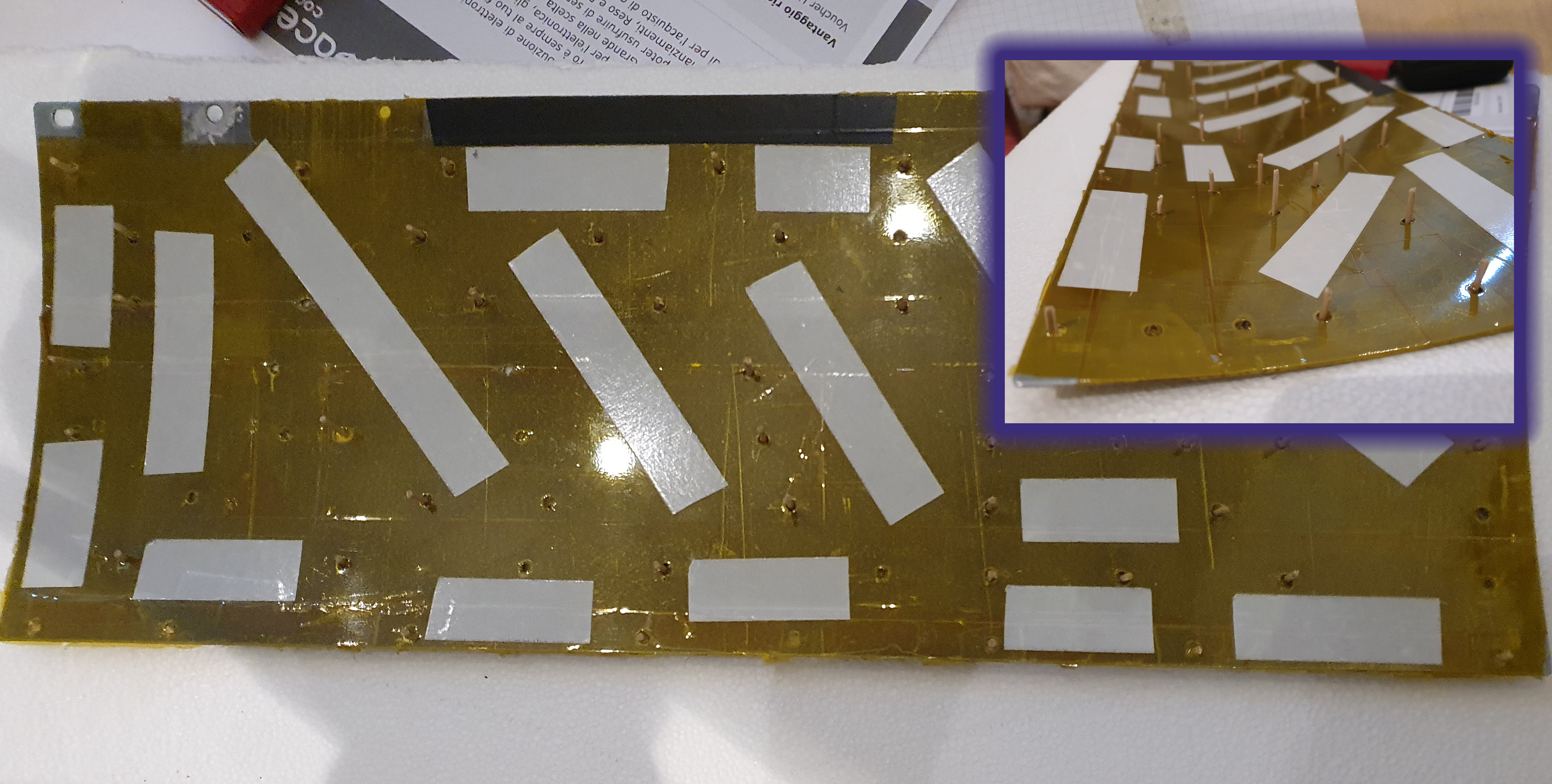

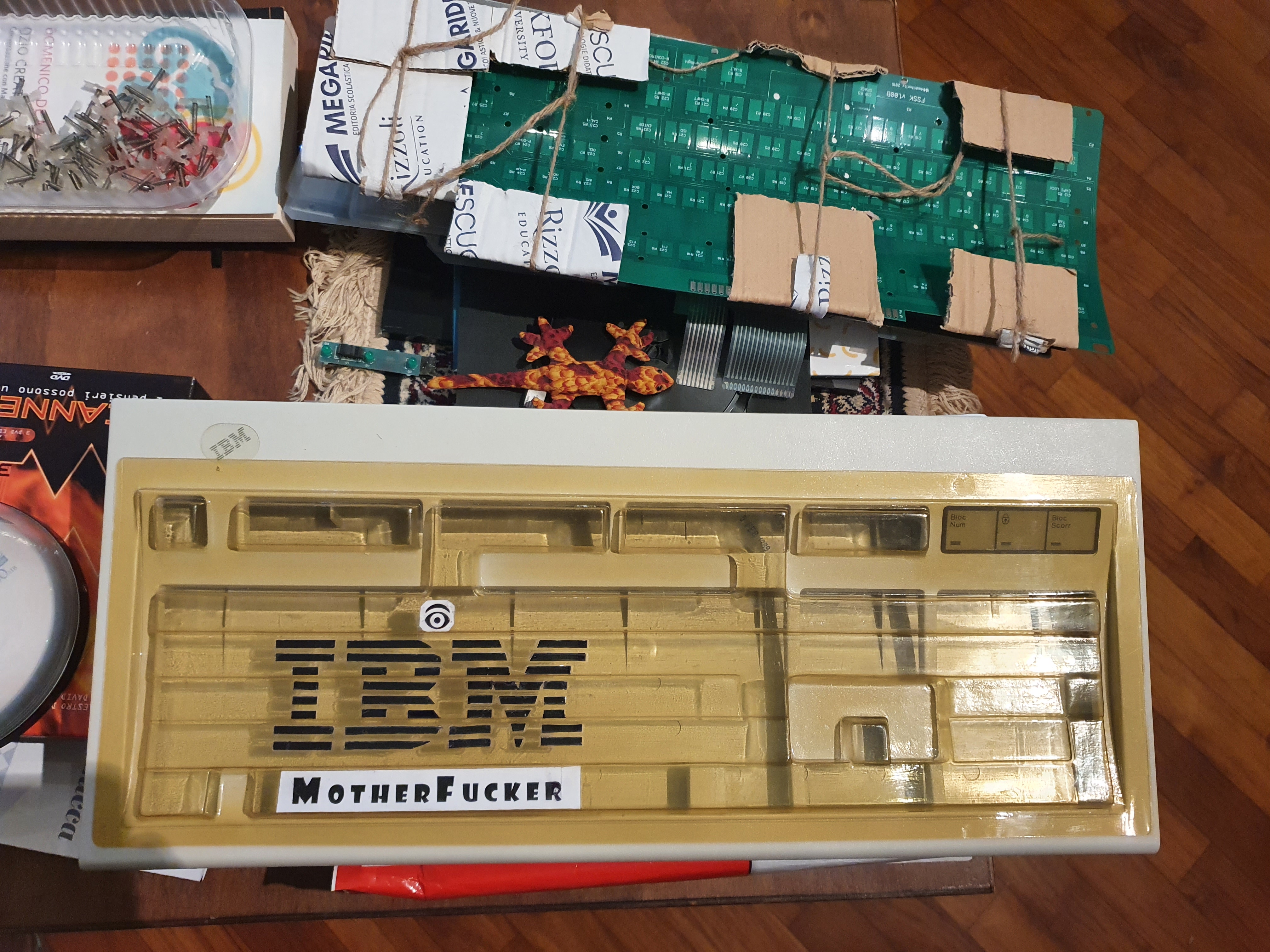

Trying to bend the PCB
Even if you too have a Greek column at home, you don’t really need to do this for bending the PCB. Being it thick only 0.6 mm, the screw mod will be sufficient to bend it properly without any problem.
Meanwhile....
Meanwhile, I had some fun by customising an old and quite yellow dust cover

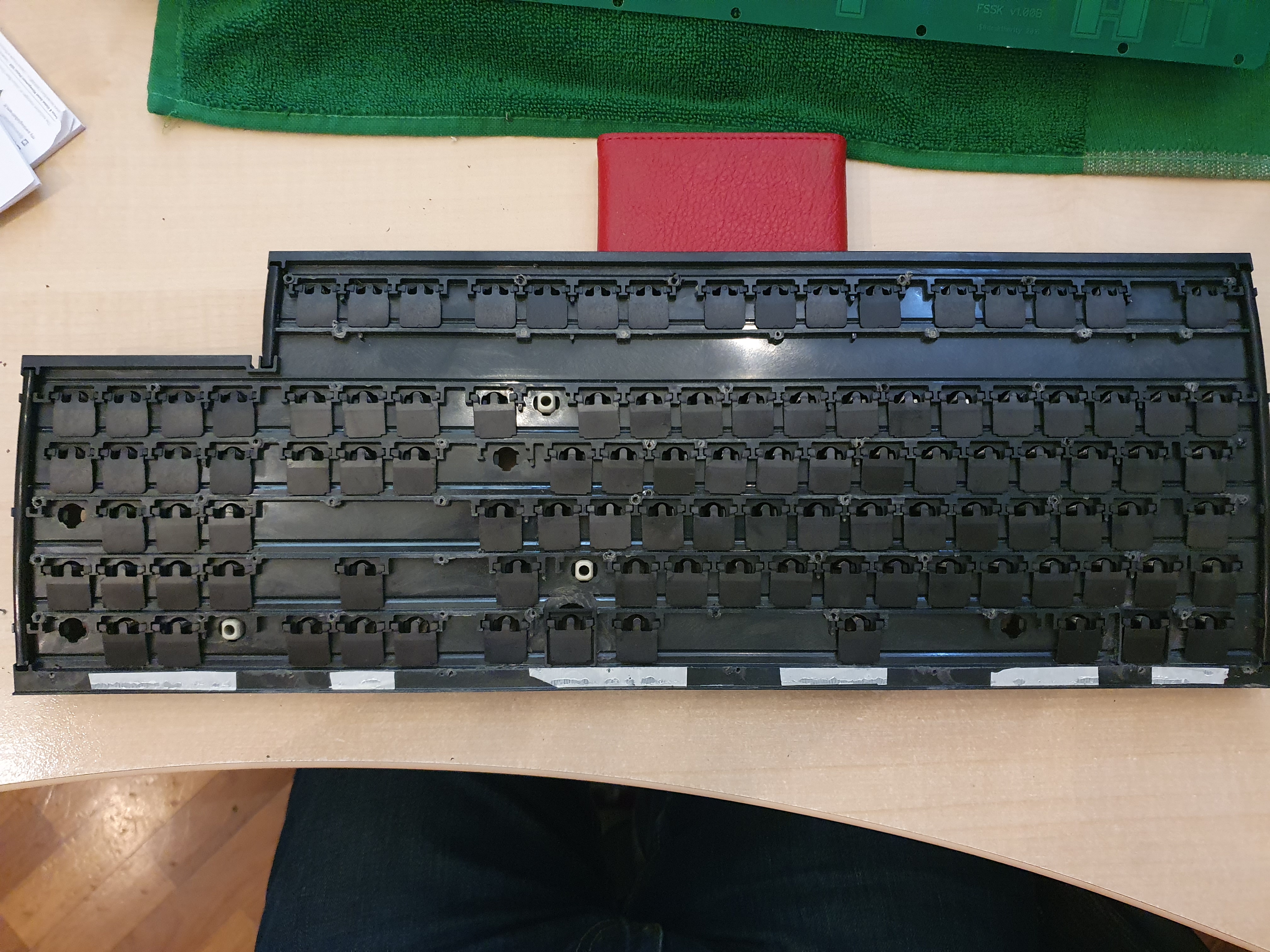

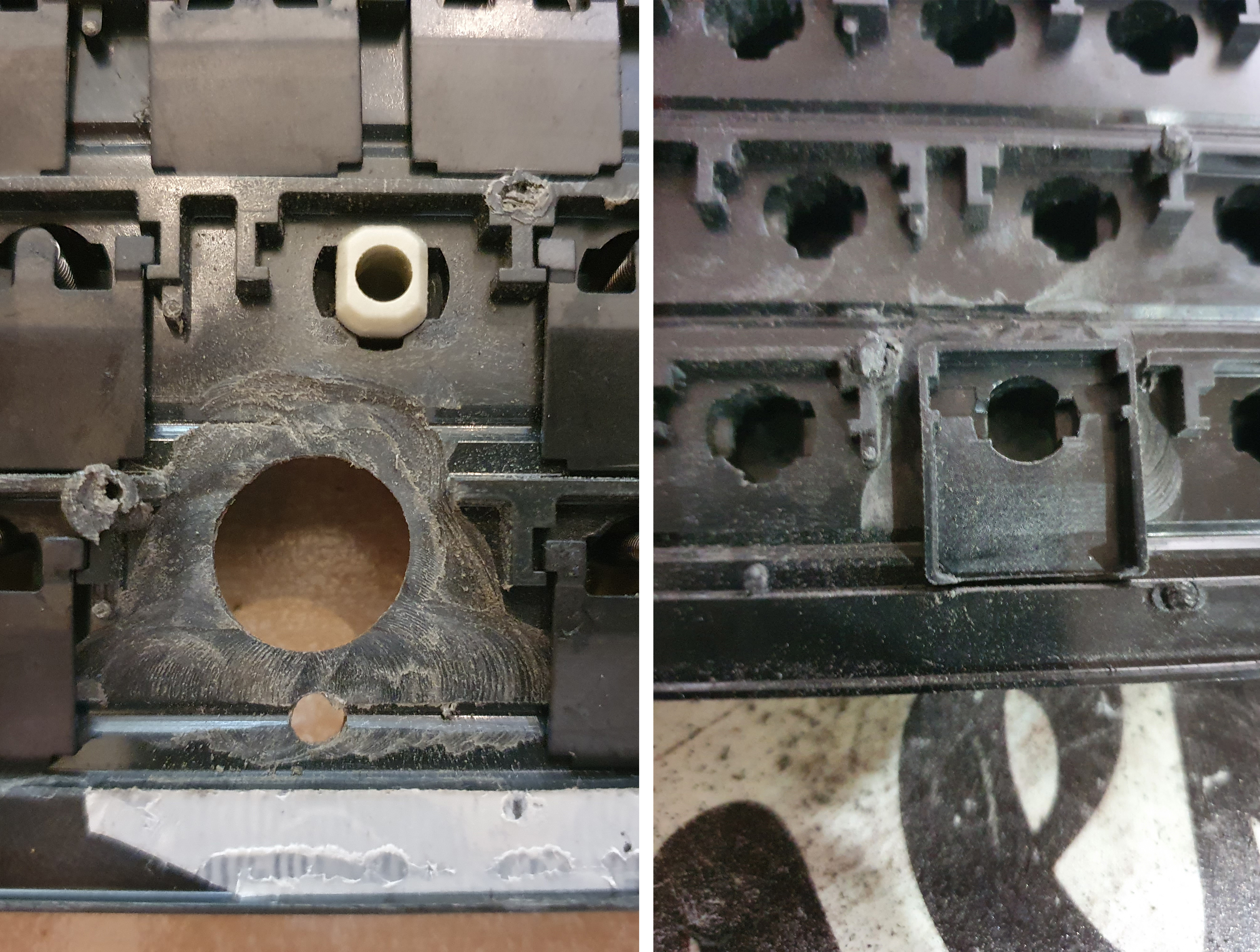

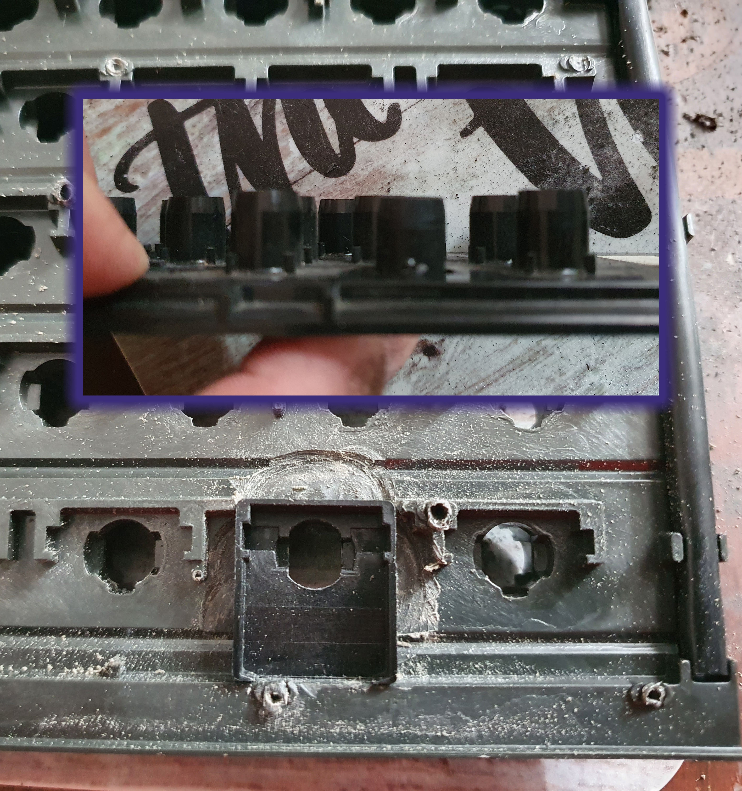

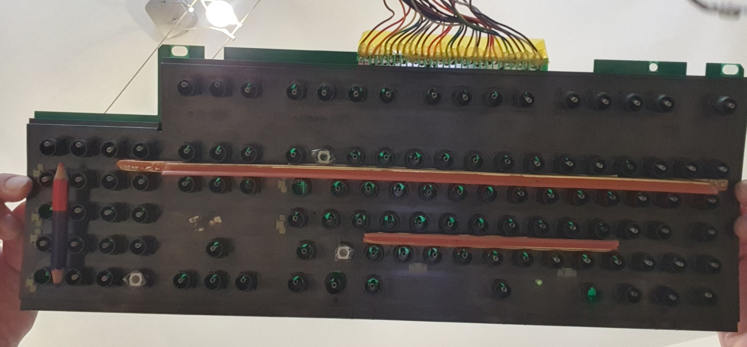

Working on the barrel frame
drilling into the Model M's barrel frame to house the Win key and the Fn key on the right
with Dremel I slightly lowered the thickness of the barrel frame in order to better align the two model F barrels to the others
beware of debris while using the Dremel. they are your enemies

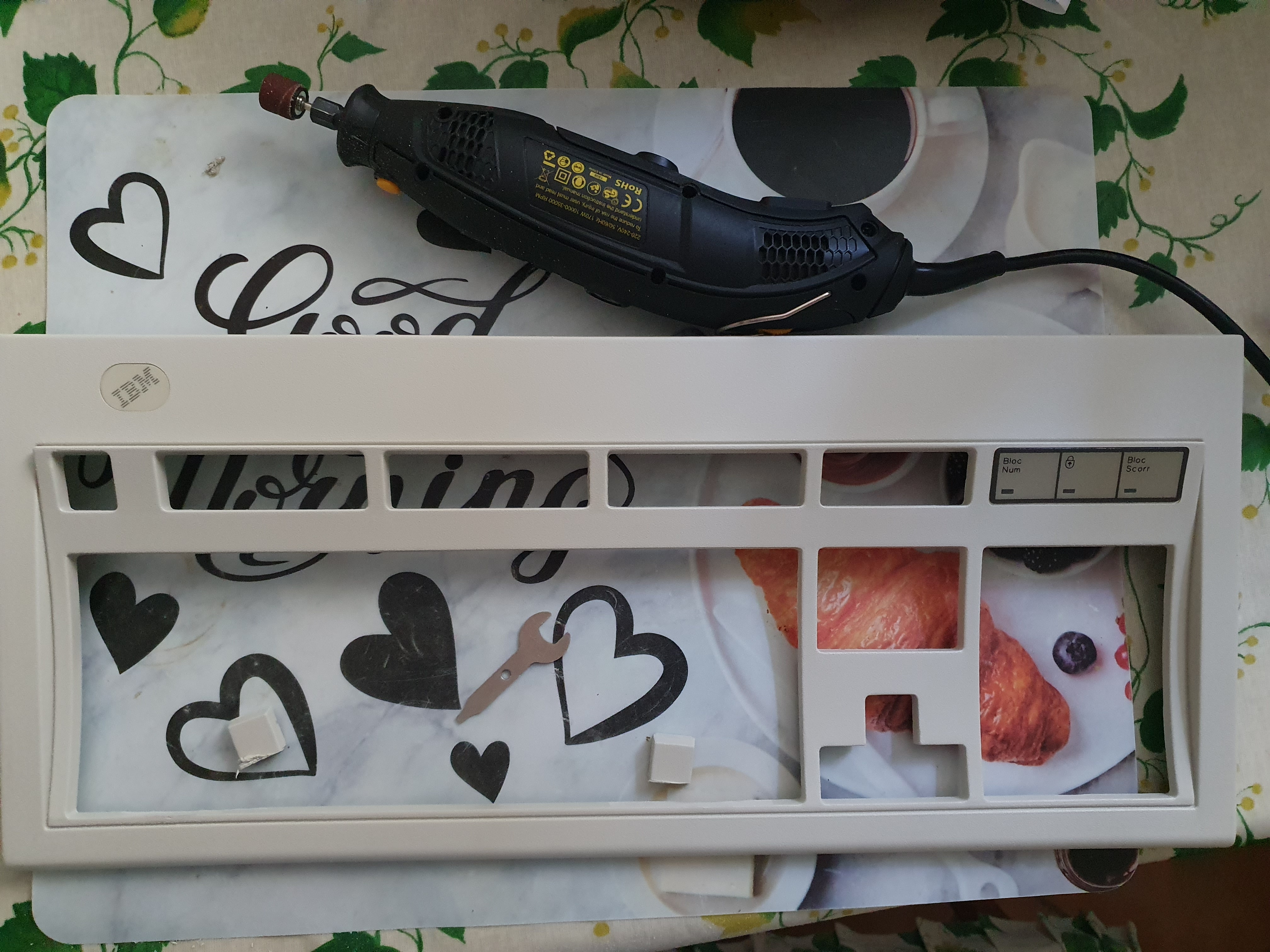

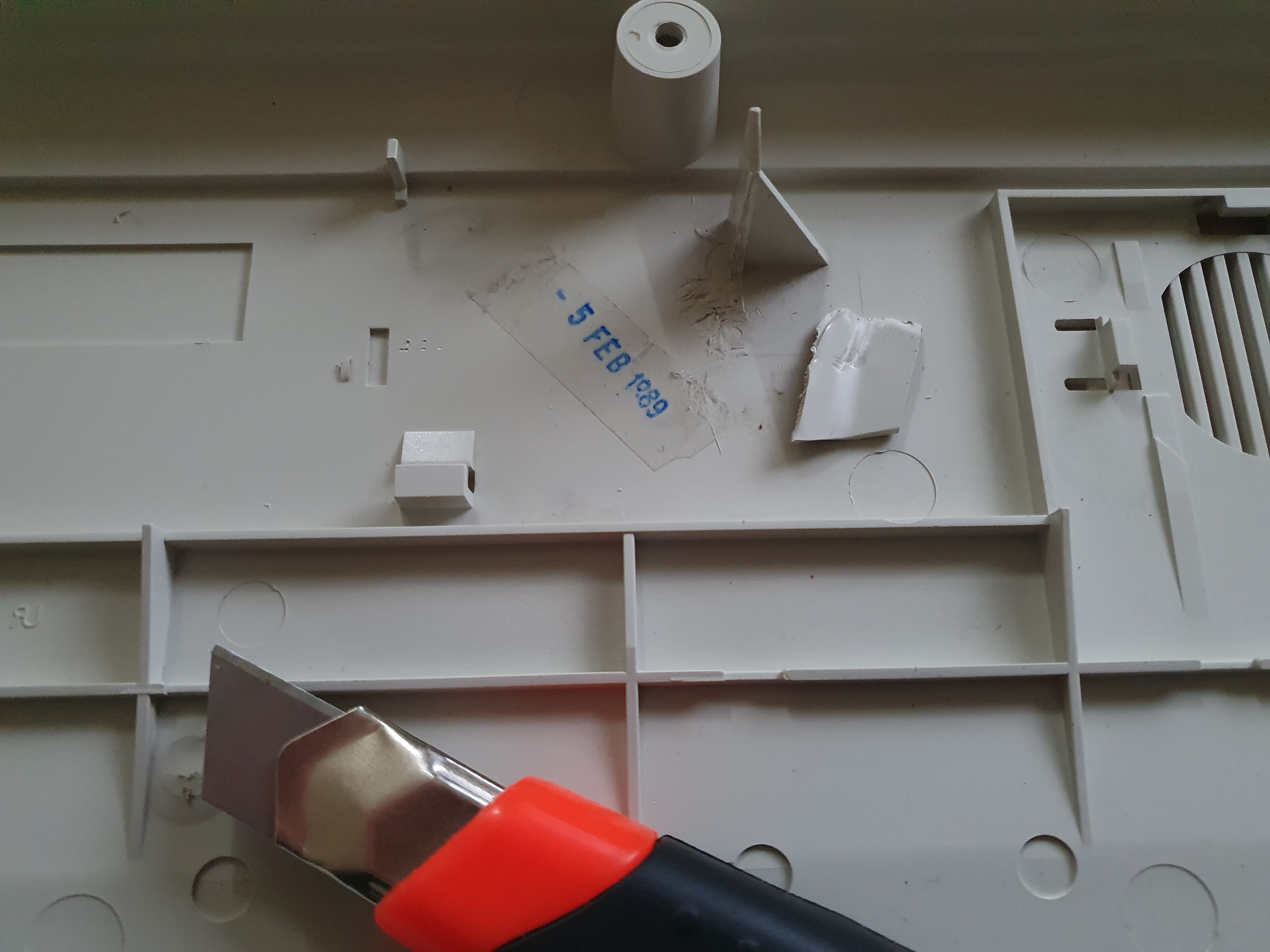

Model M top case trimmings
cutting off the extra pieces from the front part of the Model M case

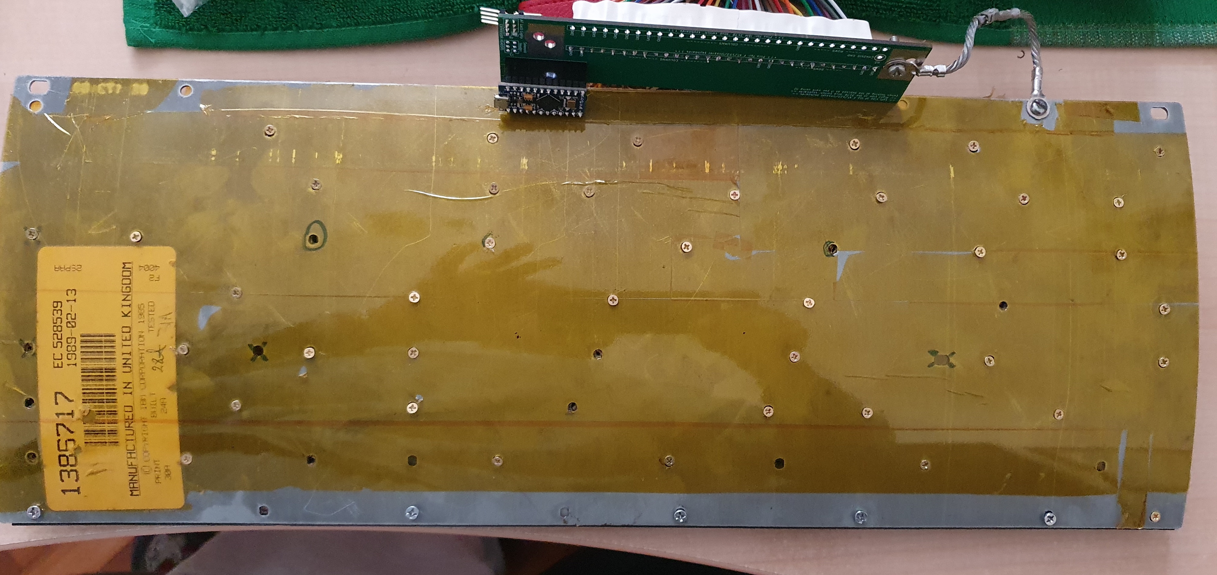

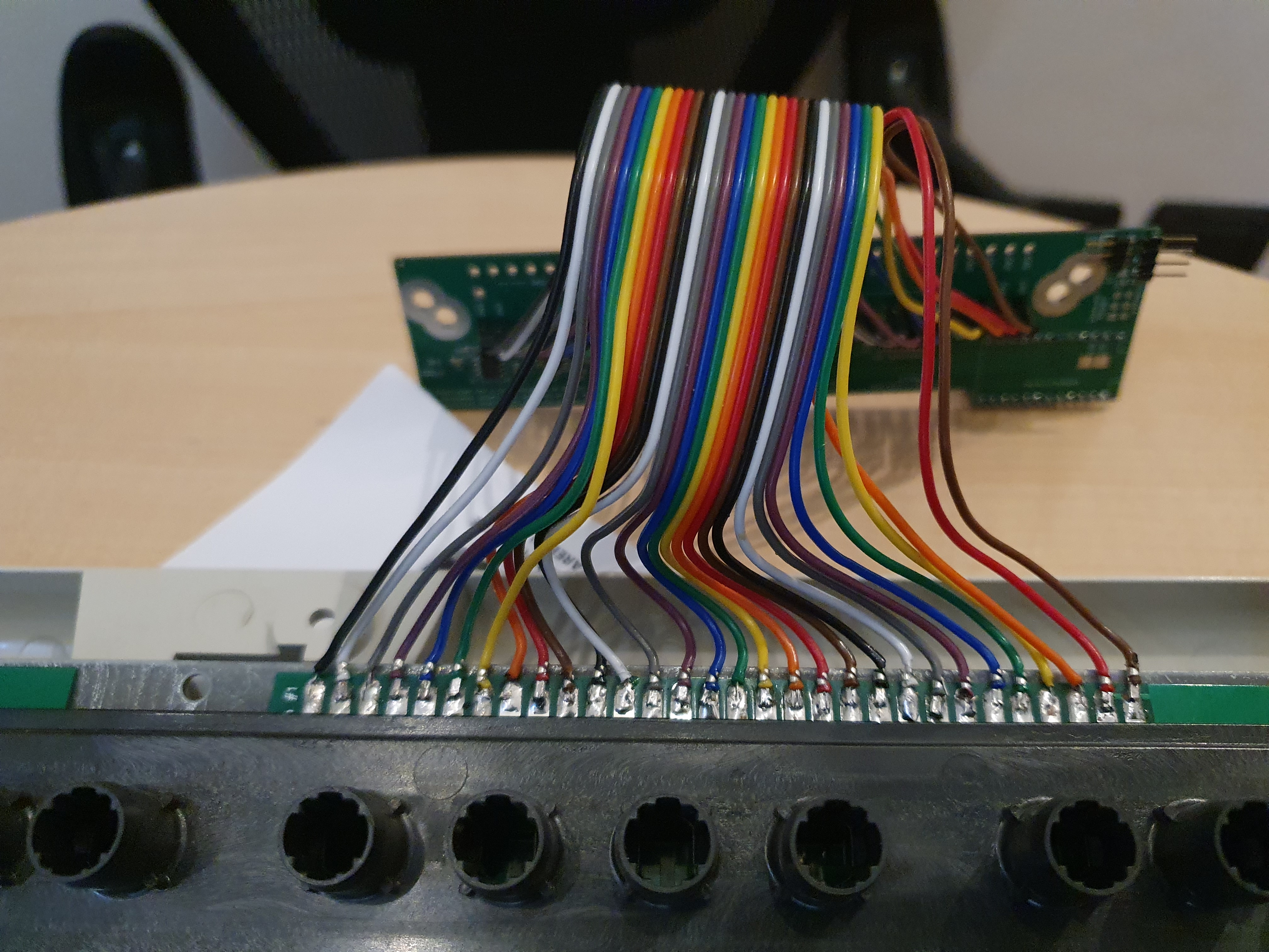

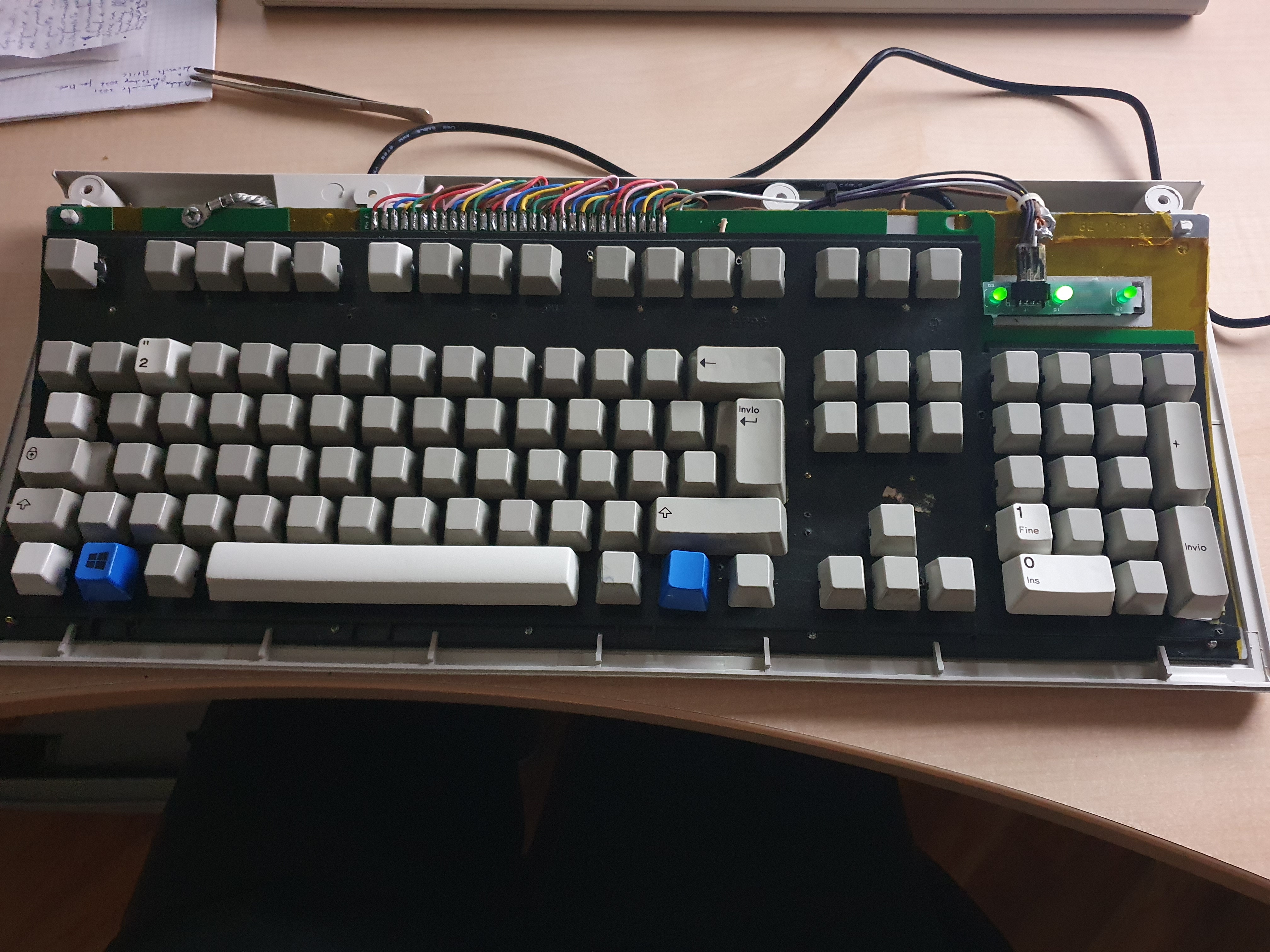

Soldering the controller I: First “bad” attempts
soldering has always been my gripe. I’m not good at all. So I hired someone to do the job for me, but……something went wrong.
Warning: also the choice of wires can be very tricky. Those illustrated in the pic have proven to be completely flawed. They were poor in copper and very rich in heavy plastic. Also the length of the wires was bad and misunderstood by the fellow. So I had to start all over again.

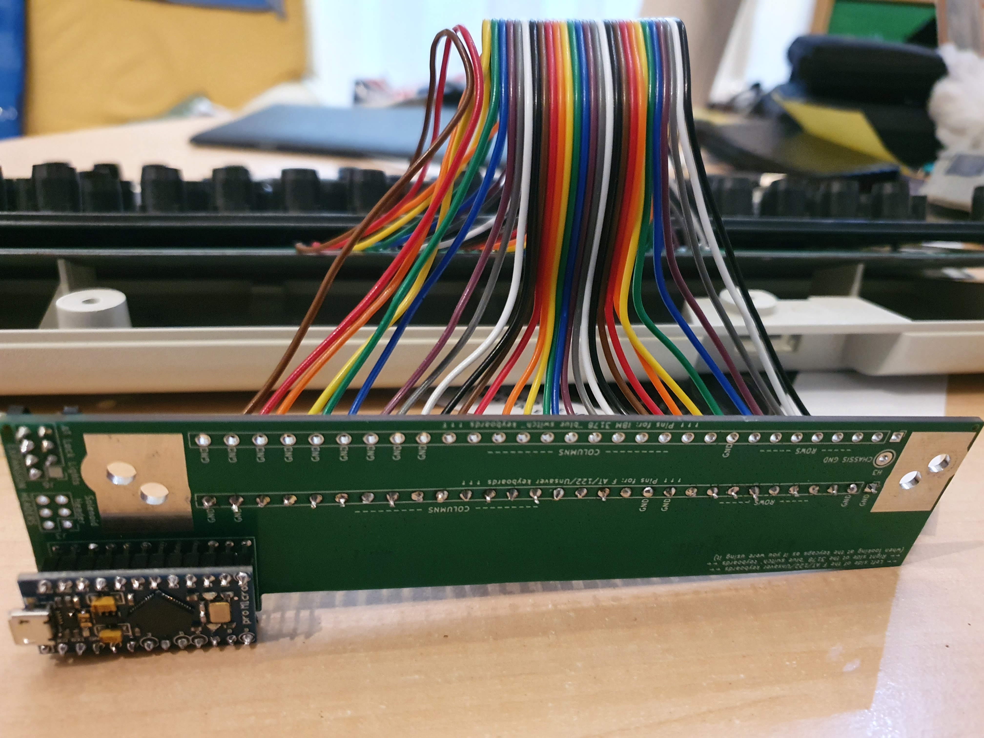

Soldering the controller II: on the right way.
A new fresh start seems to get things better, but the issues were not over…..
Checking the electrical signal. Capacitance....ooh my gosh!
Since the first capacitance test sessions, the PCB had shown a huge electrical signal problem on all the pads belonging to the first row. At first I didn't want to believe my eyes. Thinking about a problem involving aspects related to capacitance, I asked the DT Arkku user for help, and he was very friendly and kind in providing his support, offering me several pre-complied firmwares, derived from Pandrew's QMK fork which adopt, through his source code reprogramming, significant improvements in terms of performance as well as adaptation to signal tolerance. No luck. The problem was to be found elsewhere.
My big big BUG
Due to some manufacturing defects, partly due to a borderline project design too, a hole interrupted the first row circuit path of the PCB. In the pic, my saint welder made the trick and the miracle of resuming the circuit integrity.
Starting with the assembling
Having overcome the electrical issues, I dedicated myself to the conception of this system for the assembly of the mechanical parts. A few toothpicks guided the insertion of the perforated pcb onto the metal back plate so that a screw mod can be carried out more easily. Some bi-adhesive strips relieved the initial tension of the screws as they are fastened in.
NB. I also coated the metal plate with Kapton tape in order to insulate and minimize electrostatic charges, as suggested by i$’s original thread.
The presence of toothpicks, inserted into the back plate lying on a story foam sheet, acts as a guide to align the holes of metal plate with the PCB’s and the incoming barrel frame (next documented step).
Springs coming from an old Model XT mix with some from Ellipse
Springs coming from an old Model XT mixed with some from Ellipse

Fastening and unfastening all layers together or tuning a musical instrument
I had to devise this system, instead of the classic pair of books placed on the sides of the metal plate, in order to get the right tension throughout the surface during the process of inserting the screws. The wood sticks (2/3 horizontal and 1 vertical, the big pencil) protruded just enough to prevent the springs from touching the desk, letting the hammers lose their correct position in the barrel frame.
I know, I completely missed the building of the right tool, lost somewhere among DTs posts.
I’ve done several MODs on Model Ms, both the bolt mod and the screw mods, even on a Model M122 but this time was different, very different due to the presence of a PCB that changed my references in terms of thickness and curvature tolerance of the parts involved. I had to pay more attention to filing the edges around the holes. Any inaccuracy in the alignment of the parts or excessive screwing force inevitably caused problems in obtaining the correct key feeling and relative click-clack sound. I had to close and re-open the layers at least 6 or 7 times in order to get the perfect combination. It was nothing more or less like tuning a musical instrument, in the true sense of the word.
Making extra room to house the controller into the bottom case. Look at my birth date.... :mrgreen:
Finally, the case closes. I had to cut the piece of plastic swown in the pic if I wanted the SMD controller with the attached microUSB cable to properly fit beneath the keyboard bed, avoiding to damage the Micro Pro the usb connector (oops).
Keep testing and other extra final steps.
Some final tests with Pandrew’s USB utils before closing the case. On the right side LED lights work even though in a weird way, due to some incompatibilities. It seems that the SMD controller supports natively only the IBM AT leds.
all's well that ends well
