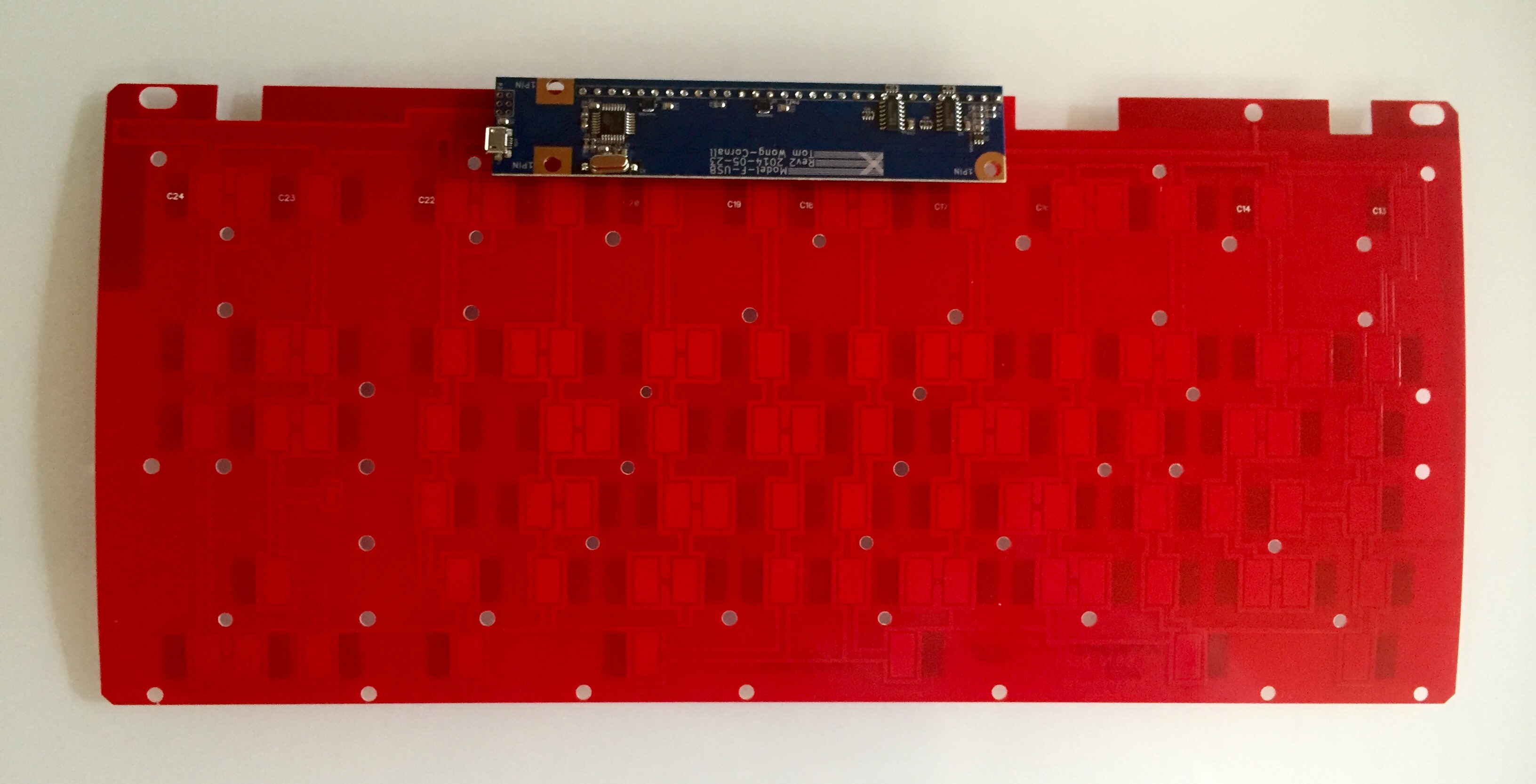

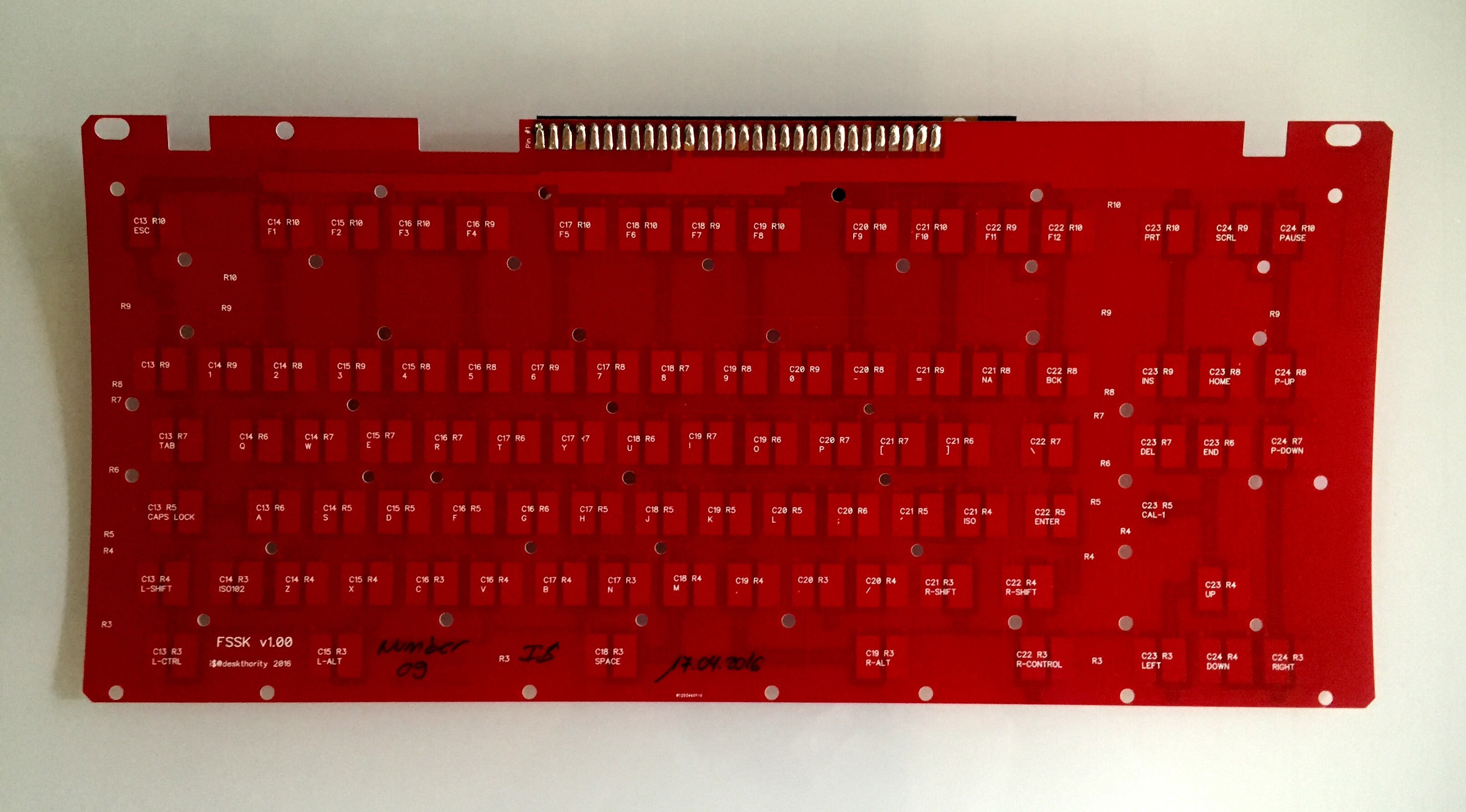

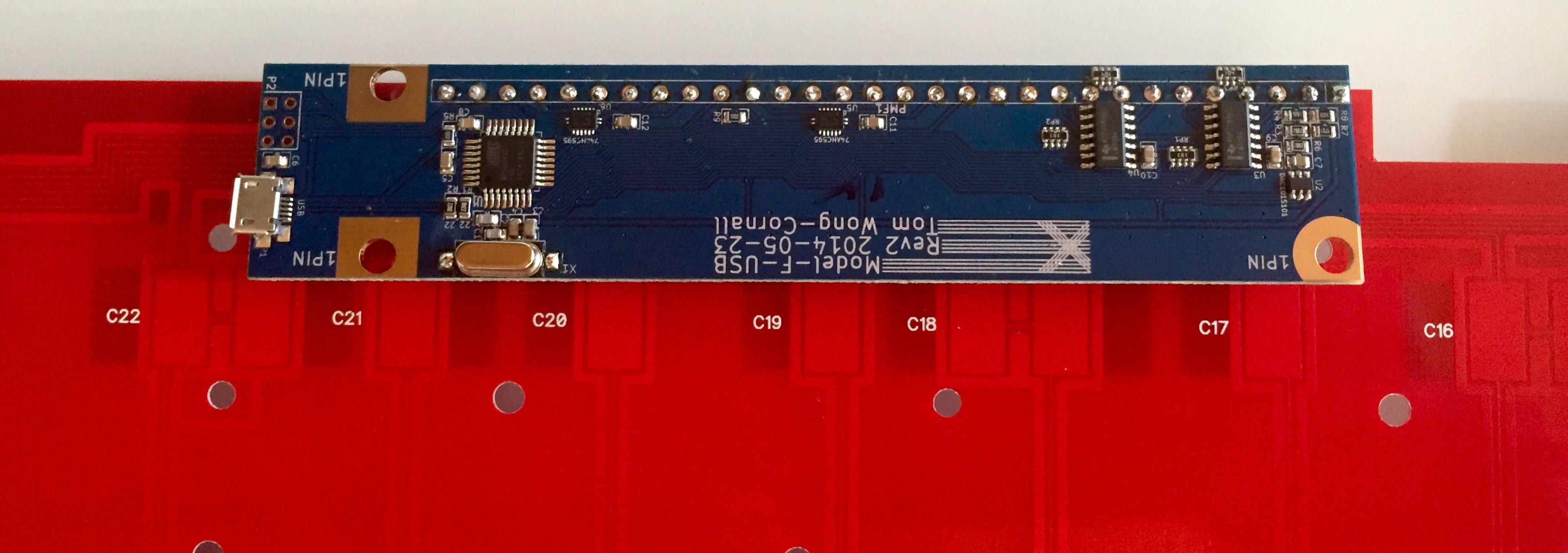

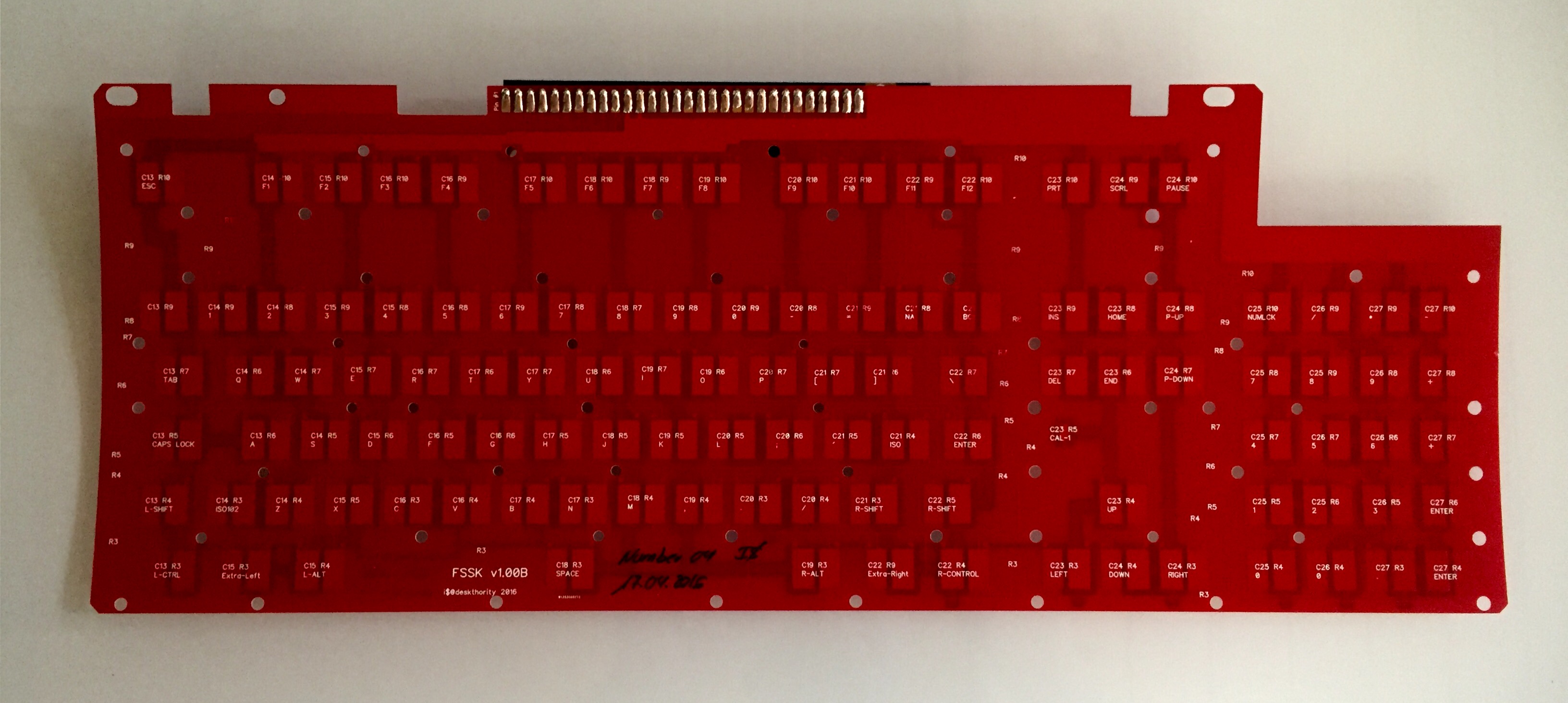

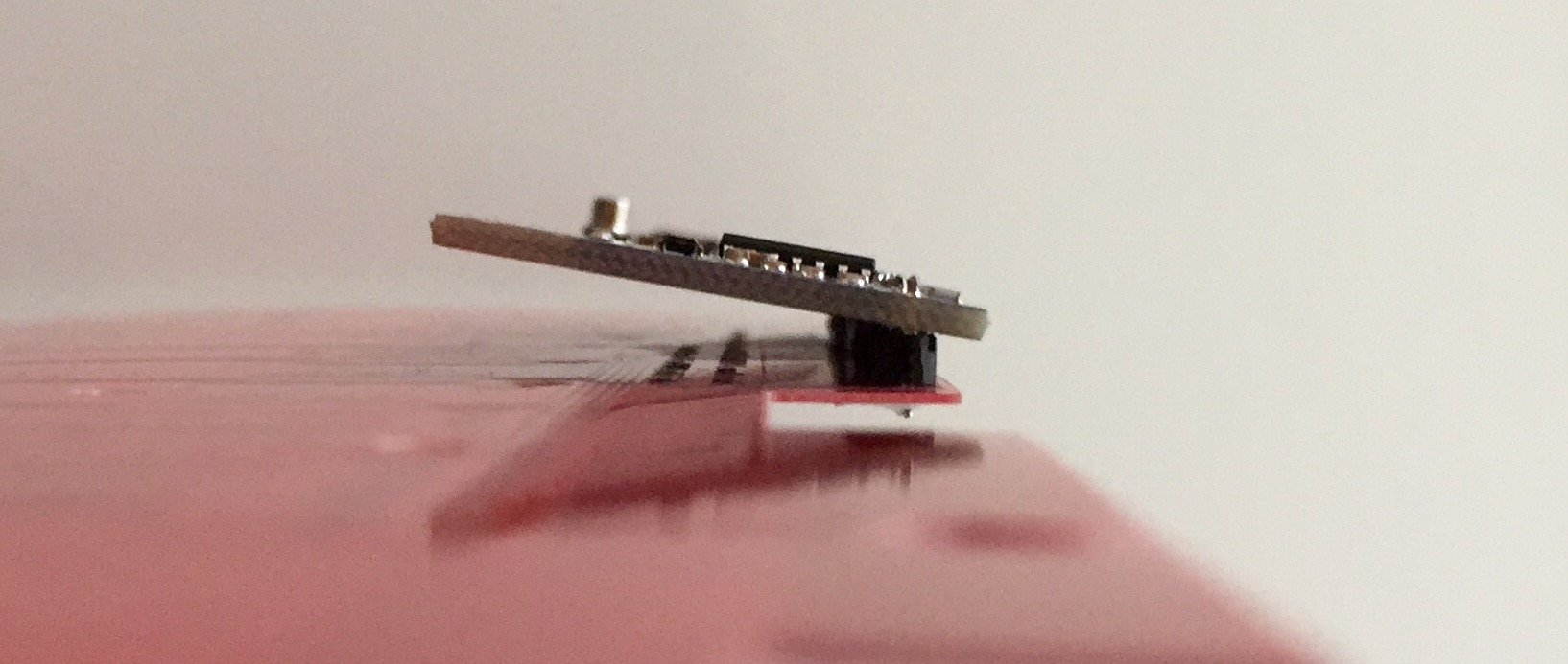

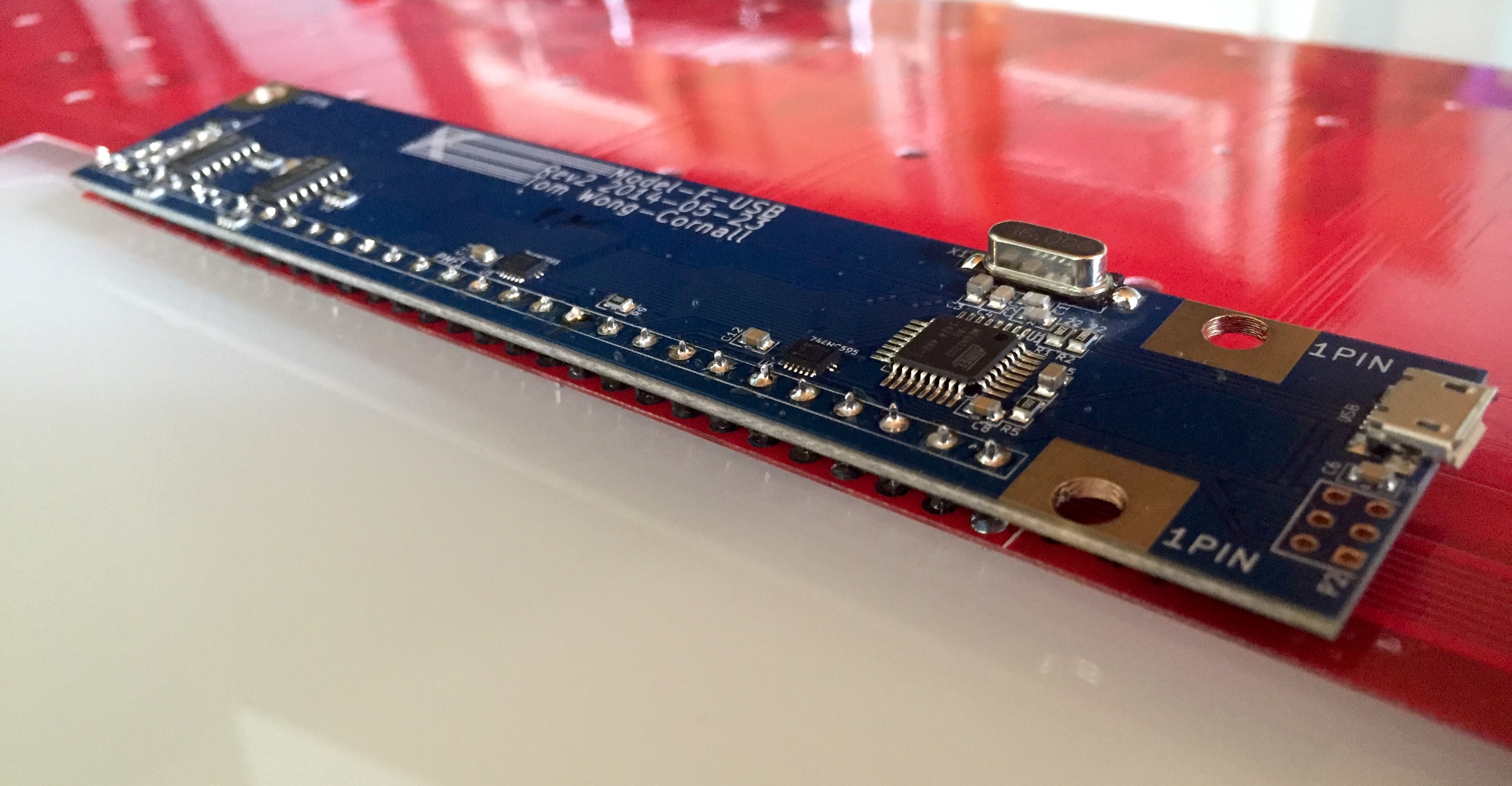

I'm out of town for work until late tomorrow evening, and will reply to the PM's on Friday morning (sorry for the delays). It dawned on me though that I never posted the pictures of the SSK and full-size PCB's with the controller attached in the new style. This was to test the direct connection WCass mentioned (think slip on connector like the xWhatsit beam spring). I wanted to test clearance in the case, and soldered the controller directly on the back of the PCB in an inverted fashion. Turned out well (I prefer this to the ribbon cable), and clearance is not going to be a factor. Thought it might help to visualize what the eventual configuration would look like (will use the smaller xWhatsit, and slip on connector versus soldered). Certainly a cleaner approach.
xWhatsit soldered directly to the back of the SSK PCB (inverted)
Side profile to get a feel for spacing between the controller and eventual assembly back plate.  The controller was isolated with tape anywhere that could present grounding issues
Easier to visualize the inverted positioning.  Nice thing about the xWhatsit is there is no "solder side"
SSK PCB from the back
SSK PCB from the front
Full-size PCB from the front (just to remind everyone that we aren't forgetting it ;))

That looks great! It'll be perfect with a "clip in" configuration and daughter board combo. 8-)
Invisius
10 Aug 2016, 22:44
Wow! Looks as professional as a factory original. Impressed at how far this has come in such a short time.
My SSK case is just begging for these. :)
