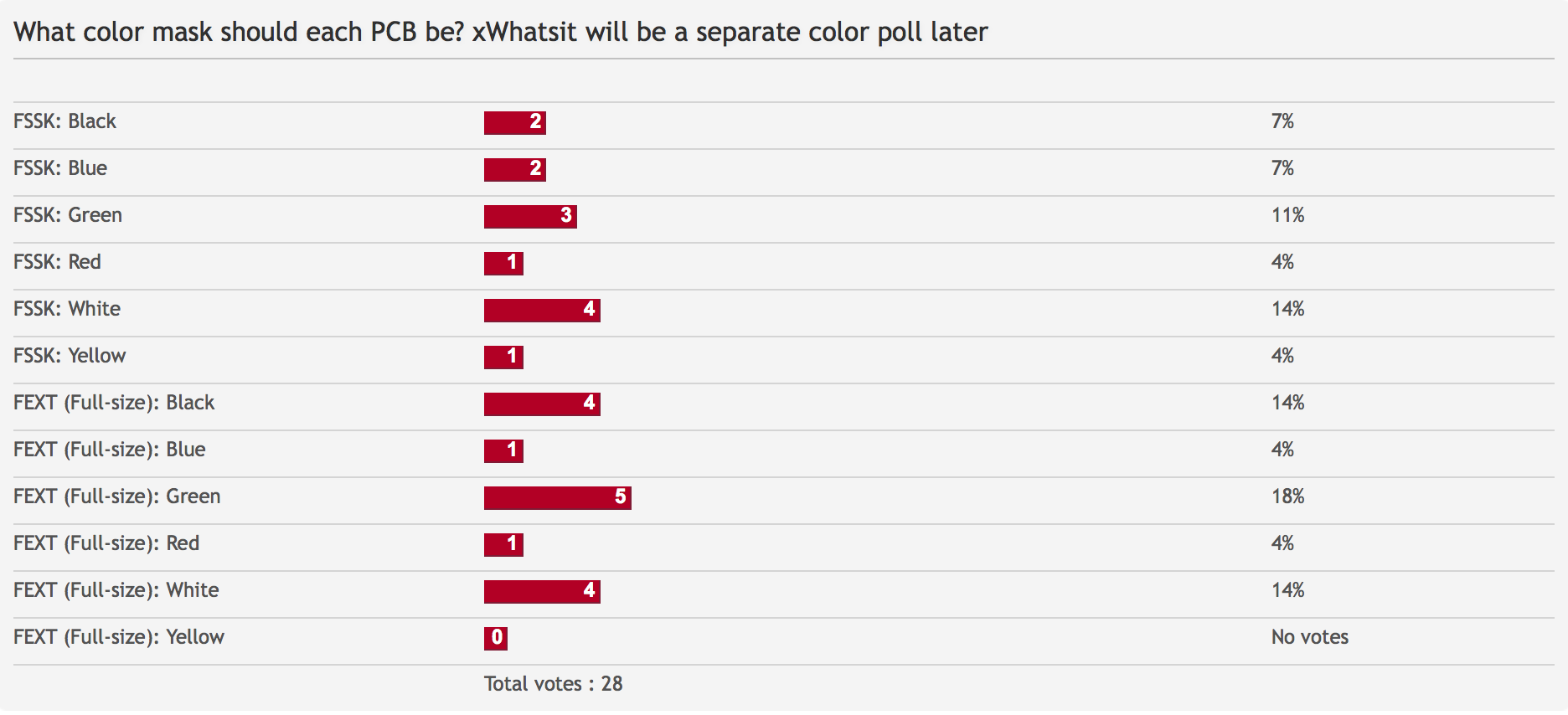

Would anyone be DISSATISFIED with a White SSK PCB and a Green FEXT (full-size) PCB? I actually like the idea of them being different colors myself, but the poll hasn't been up long. We will move onto the xWhatsit and daughter board (USB connector) board color poll if we are.

alh84001
v.001
12 Aug 2016, 12:52
I voted for white FSSK (although I have an original and I probably won't be getting one), and black FEXT, but green FEXT was my second option, so these are fine with me :). Just don't make them red ;)
E TwentyNine
12 Aug 2016, 14:39
lot_lizard wrote: Would anyone be DISSATISFIED with a White SSK PCB and a Green FEXT (full-size) PCB?
Eh, kinda. I'm a traditionalist (and a little biased toward green anyway).
Come on, some of you people who voted for the Green full size, go vote for the Green SSK!
12 Aug 2016, 14:54
Yes, green is classic and neutral. But a different-colored controller might be OK.
Techno Trousers
100,000,000 actuations
12 Aug 2016, 15:19
I'm fine with white and green for the PCBs.
lot_lizard
12 Aug 2016, 16:36
I checked on pricing for having a couple of color options per each PCB, and we are looking at a ~1 dollar increase per. So let's do the following. Thanks for voting... I will update the poll shortly with the xWhatsit color choices if you want to check back.
SSK PCB Colors
  • White
  • Green
Full-Size PCB Colors
  • Black
  • Green
Screen Shot 2016-08-12 at 8.58.04 AM.png (142.3 KiB) Viewed 6061 times
lot_lizard
13 Aug 2016, 01:04
If you voted Deep Purple (OshPark) or White, please re-vote... I would really only like one color for the controller to keep the costs down. I would change the poll to only two, but it would reset the counter. More votes in general (quickly)... would be appreciated
dokyun
13 Aug 2016, 01:24
I voted purple...count me as black instead.
Can you edit the poll to allow changing your vote without resetting the results? I'd change my vote there if I could :)
lot_lizard
13 Aug 2016, 01:34
You should been able to pick a different radio button, and hit Submit. If that option isn't there, let me know. It would be a bug I need to report.
dokyun
13 Aug 2016, 02:21
Done. It's possible I'm merely blind.
