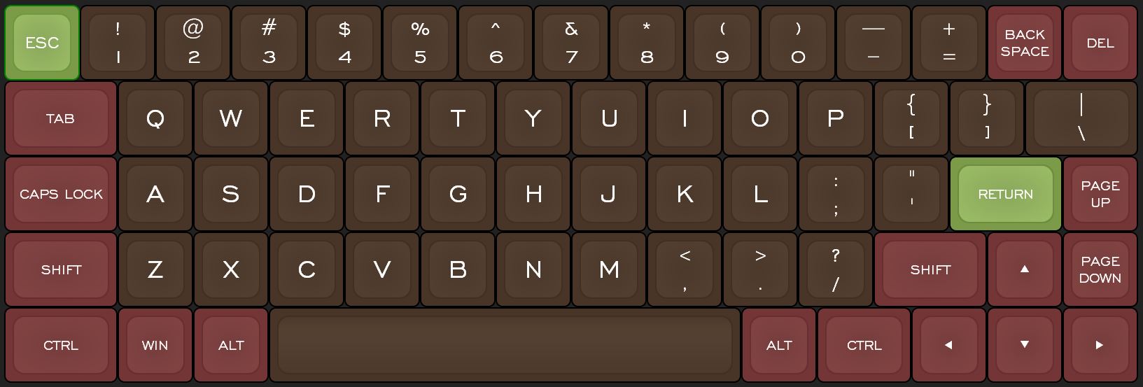

I'm just trying to think out of the box. The only way to get more keys in the same space is a slight rearrange/downsize which apparently kills the case compatibility. What are the design parameters? I myself would not mind modding a case to make it work.
- Location: Stockholm, Sweden
- DT Pro Member: 0011
The problem was that the Poker-compatible cases bolt holes/standoffs would fall right under switches in your and matt3o's layouts.Req wrote:This would fit in a 60% case and fits your bill I think.Findecanor wrote:Too bad that matt3o's custom 60% design with a nav column did not work with a Poker/GH60 case, or I would have been in on that.

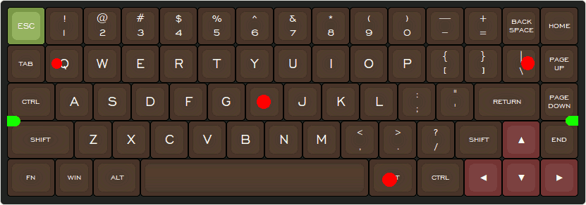

isn't that what I said?Findecanor wrote:The problem was that the Poker-compatible cases bolt holes/standoffs would fall right under switches in your and matt3o's layouts.
this is a very empirical diagram
Yeah sorry, I missed that before posting and then. "You can't delete a post that has been replied to".matt3o wrote:isn't that what I said?

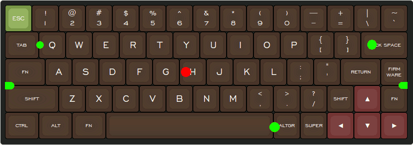

Here is(I think) a Poker compatible Matrix (Except for H). I know someone did not like the matrix idea but a few did.Findecanor wrote:Yeah, missed that before posting and then. "You can't delete a post that has been replied to".matt3o wrote:isn't that what I said?![]()
Here is another dupe:![]()
- poker compatable minus H Matrix.JPG (108.31 KiB) Viewed 8138 times
The Alt Gr key does not work though. Not all Poker cases have the post under H.Req wrote:Here is(I think) a Poker compatible Matrix (Except for H).

This fixed it I think.Findecanor wrote:The Alt Gr key does not work though. Not all Poker cases have the post under H.Req wrote:Here is(I think) a Poker compatible Matrix (Except for H).

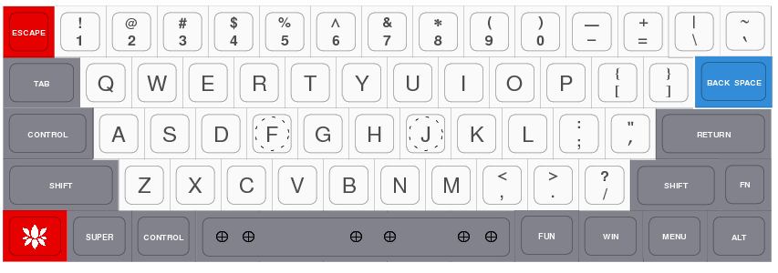

Any problems with those Poker cases and my shiny layout? I'm not sure what I'm meant to be looking for…
That case remains. But I could try a remake, as the layout is a good 'un.

I think the goal is to make sure that in the layout, the standoffs and screw placements of the Poker case, do not interfere with the switches. So making sure your layout has the screws on the edges, and in between switches rather then dead center of a switch.
Could be wrong though.

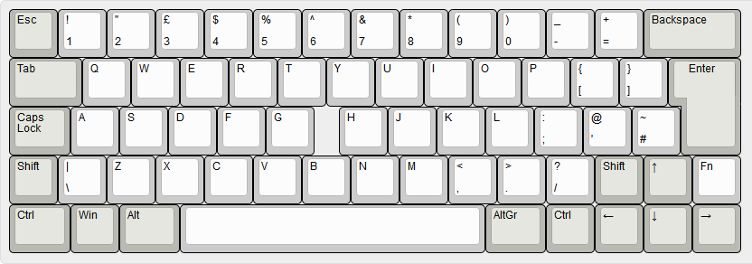

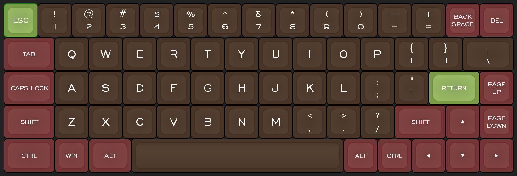

I would like something like this:
The plate can take Costar or Cherry stabs, plate mounted, at least on paper so far
I would love a PCB for this keyboard, but in the end also handwiring will do.
It is the same layout the shiny 60% has, for me is the best of both worlds (HHKB & Poker). I have both HHKB and Poker X, I love the layout on HHKB and the 3 extra keys on Poker X.
The final keyboard would look something like this the bottom row will be different, this was just a quick mockup (I'm basing the whole build on Round 5

You can already create that layout with the GH60, which in case you were not in the group buy, will most likely be available from mechanicalkeyboards.com when the gb is over as well as in the marketplace since a lot bought more than one PCB.

I'd be interested in one of those too, of course! Plate and PCB. This time we can make sure the stabs get the holes they need. Last year's plates needed a bit of filing. Lesson learned!
But are Poker case standoffs a problem? Well, my layout is so similar to a Poker there's really only so much to look for:
Nothing near split backspace: hooray! But the Fn key right of right shift? Will it work?
Then it's "just" a case of figuring out where a Teensy would go. The old space bar trick? Or maybe under row 1 / 2 somewhere, in the case's greatest depth?
Man, I want this board. Again!
Edit: having read Broadmonkey's point: how does the GH60 handle the Teensy and standoff issues? Anyway, it may still be easier for us to build this here as a little group project than everyone wander off for individual trades. Especially those of us considering more than one build…

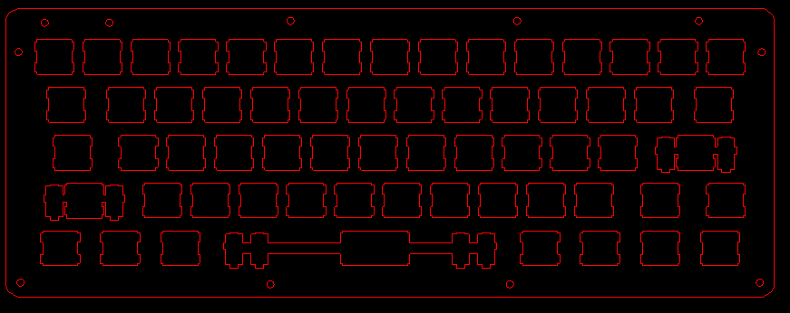

This layout should be in theory 99% compatible with the Poker case. In my project I started from this open source poker acrylic case http://geekhack.org/index.php?topic=44382.120 . This was made for Poker/Pure keyboards, and at least one case was build based on this project and was a success . I started from this project and changed it to my requirements, at least on paper the layout would fit the Poker case. The plate should be modified for the Poker case, the plate I posted is for acrylic case (I wanted a Korean style 60%
I can make public my DWG file, it's Open Source as it's initial creator meant it (this is why I linked also his original thread).
@Muirium: You could use a green Vim key for that extra FN if you ordered one, it's row 3 SA
