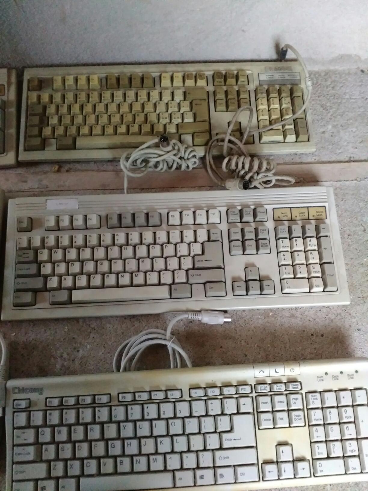

thebluefox wrote: Hi! Does anyone recognise these keyboards? :
The compaq is not bad for a RD if you get a good one. I have had a few , had a older cream/white one that was good , had a new-ish white one that was crap, but had a newer black one and that was fine.

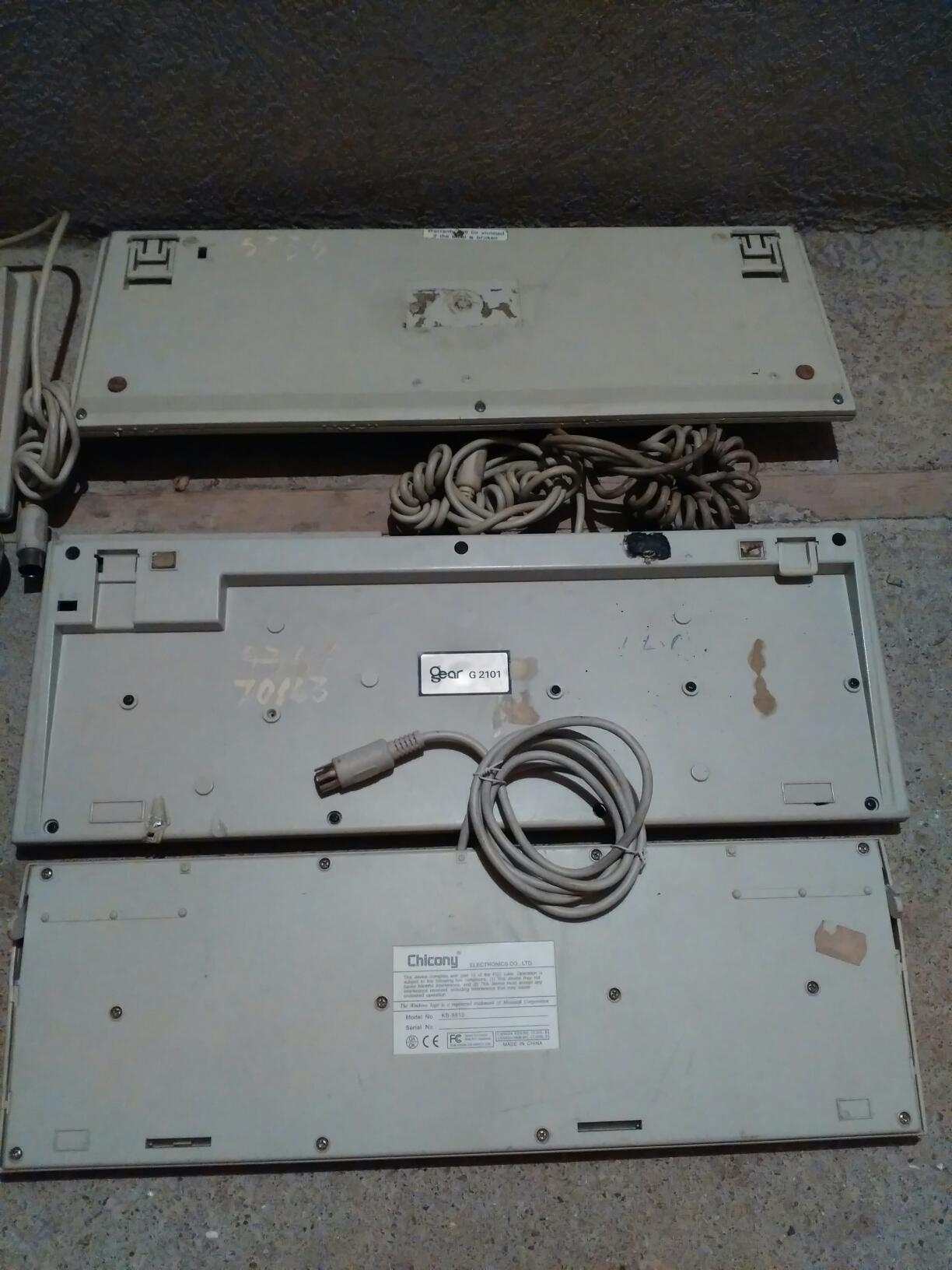

Hi guys! Do you know anything about the picture from the top? The plate is missing:

28 Oct 2016, 20:17
The Chicony is almost certainly NOT mechanical.
The middle one might be, but I'm doubtful due to the screws going through the middle of what would typically be a plate or PCB.
The top one looks mechanical, but I have no idea what it would contain. It reminds me of NTCs slightly.
thebluefox
28 Oct 2016, 21:15
It seems that Gear G2101 has White Alps. Chicony is RD for sure.
Edit
So, Alps compatible keycaps , semi-mechanical for Gear G2101, in case someone needs to buy this model.

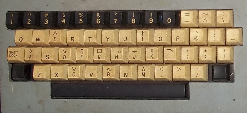

Can anyone guess at what the keyboard mechanism might be from the key caps? I don't know the age and it's coming out of a unit that is manufactured by a company that doesn't make keyboards. It's on it's way to me so I won't know for a week or so. It's also from NASA.

snuci wrote:Can anyone guess at what the keyboard mechanism might be from the key caps? I don't know the age and it's coming out of a unit that is manufactured by a company that doesn't make keyboards. It's on it's way to me so I won't know for a week or so. It's also from NASA.
Looks like it could be micro switch or hall effect.
snuci
Vintage computer guy
11 Nov 2016, 13:23
mike52787 wrote: Looks like it could be micro switch or hall effect.
I would have guessed that knowing where it's from but with the shift keys replaced with the smaller black 1u key caps, the mechanism that is exposed doesn't look like Micro Switch. Unless the keyboard mechanism is covered underneath the key caps.

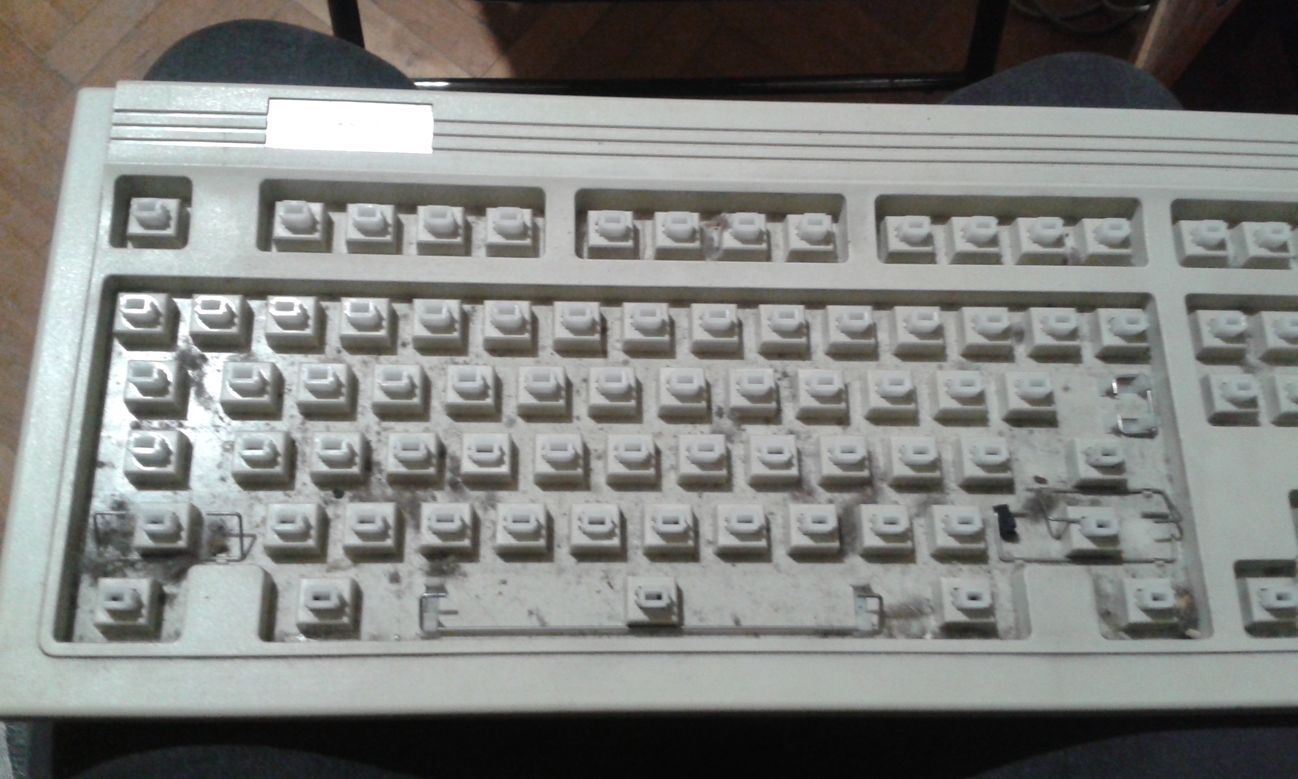

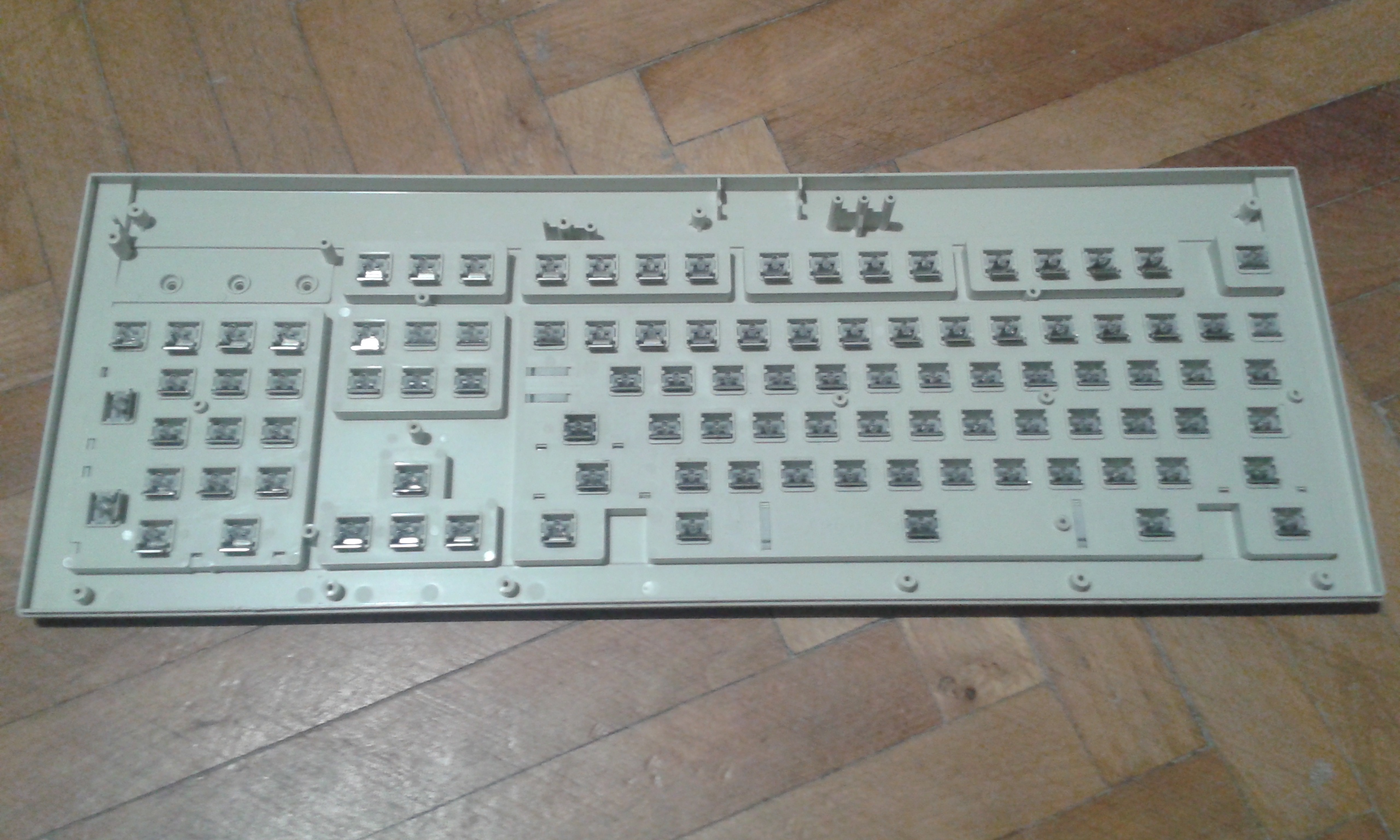

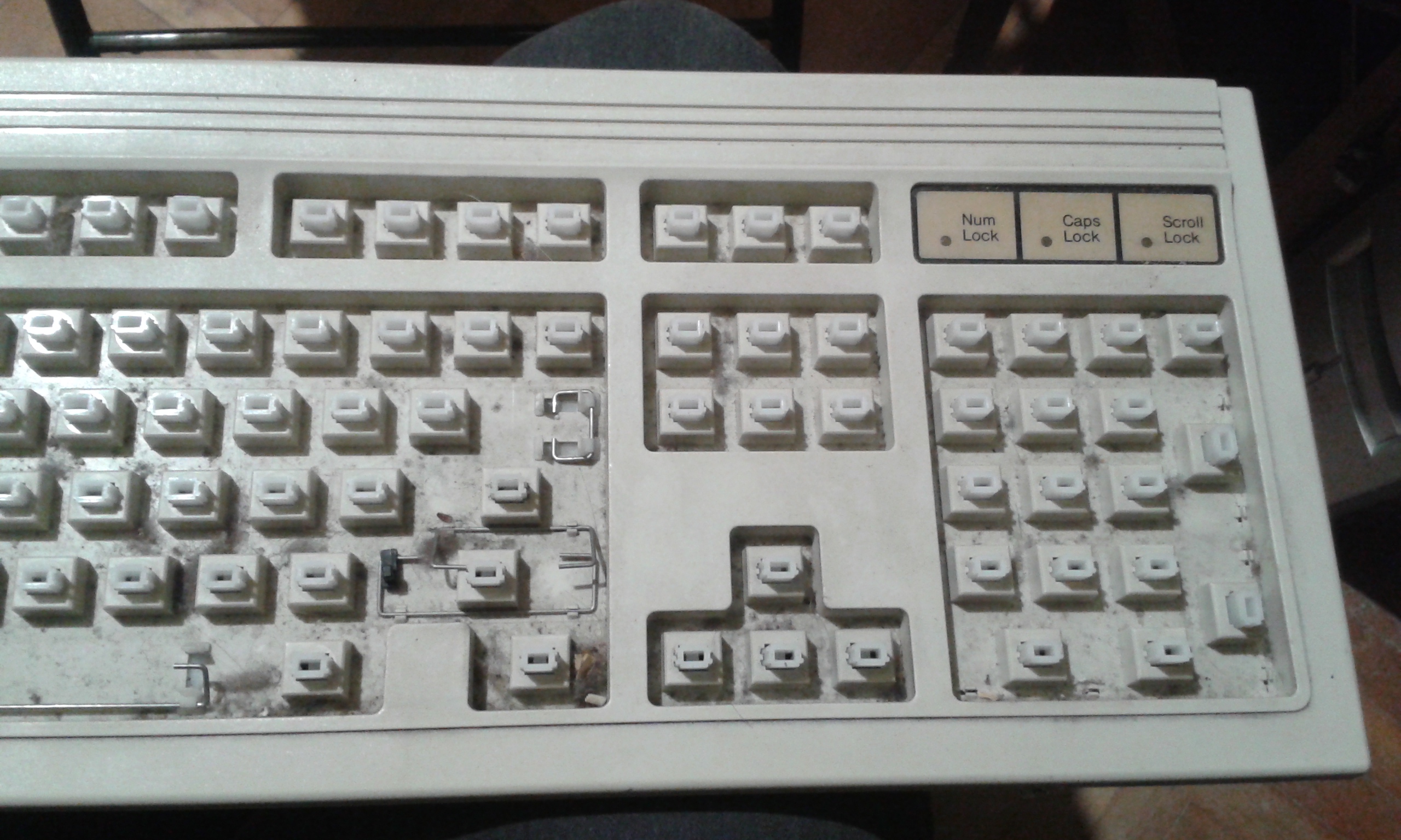

Anyone can help me identify this board? Thanks in advance.
ohaimark
Kingpin
23 Nov 2016, 06:59
I don't have a clue... I'd be interested in knowing too.
23 Nov 2016, 08:36
ba7777 wrote: Anyone can help me identify this board? Thanks in advance.
Have a look there:
photos-f62/hoft-wessel-pos-keyboard-t7290.html
