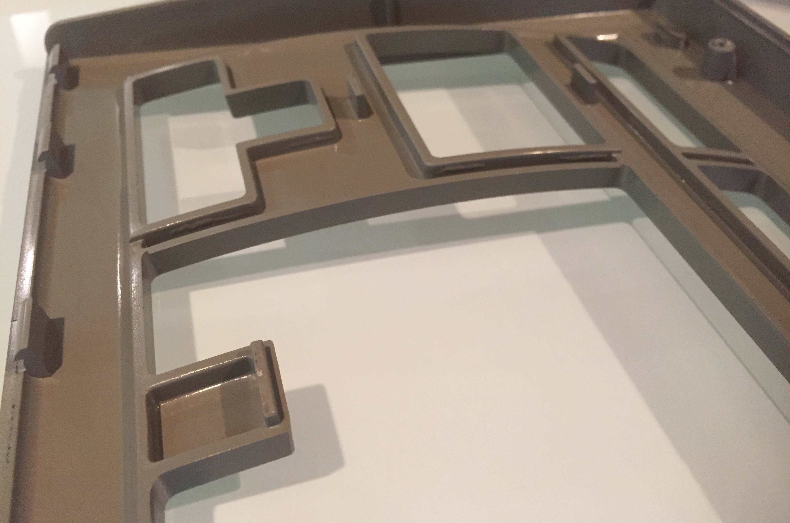

E TwentyNine wrote: Now that I'm done ogling - are the extra screw holes near navigation a bit of securing that you've realized isn't needed?
Also, what's the function of the rectangular cutouts in a few places?
I am still experimenting with the tension screws, but ultimately we want the least possible that provide actual value (cost and appearance impacts). The o-rings do provide value (more than I expected). Over tensioning is proving to be less than ideal in the middle of the board, and the reduced force per screw revolution using the rings helps with that (thank Phosphorglow).
The rectangular cutouts are for the top case shell extrusions. We are thicker now than the original M assembly with the thicker top plate. These cutouts allow the top plate to be "infinitely" thick without putting unnecessary stress on the shell itself.

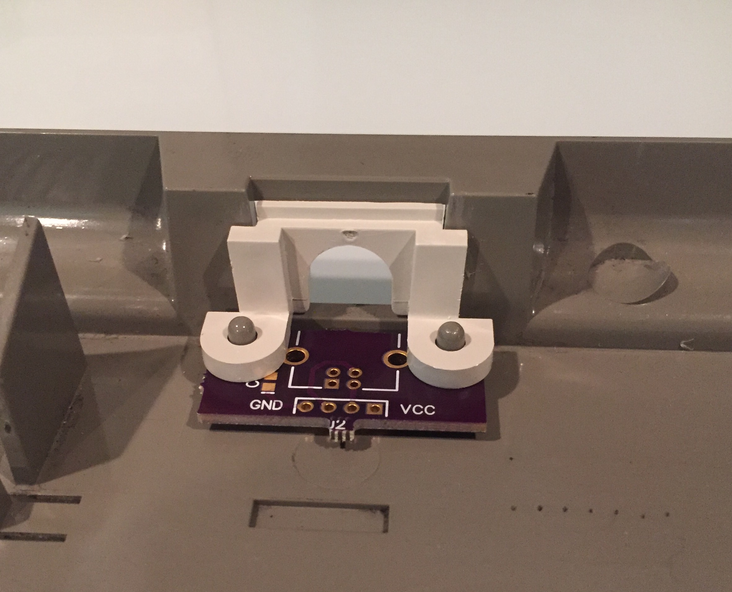

Wow!! Three thumbs up for sure, lizard. Looking at the picture of how the daughter card sits on the pegs, it sure seems like the custom port blanks could share those pegs as well, for extra stability.

Techno Trousers wrote: Wow!! Three thumbs up for sure, lizard. Looking at the picture of how the daughter card sits on the pegs, it sure seems like the custom port blanks could share those pegs as well, for extra stability.
I think that's a great idea. Keep everything aligned, and as easy to install as possible.

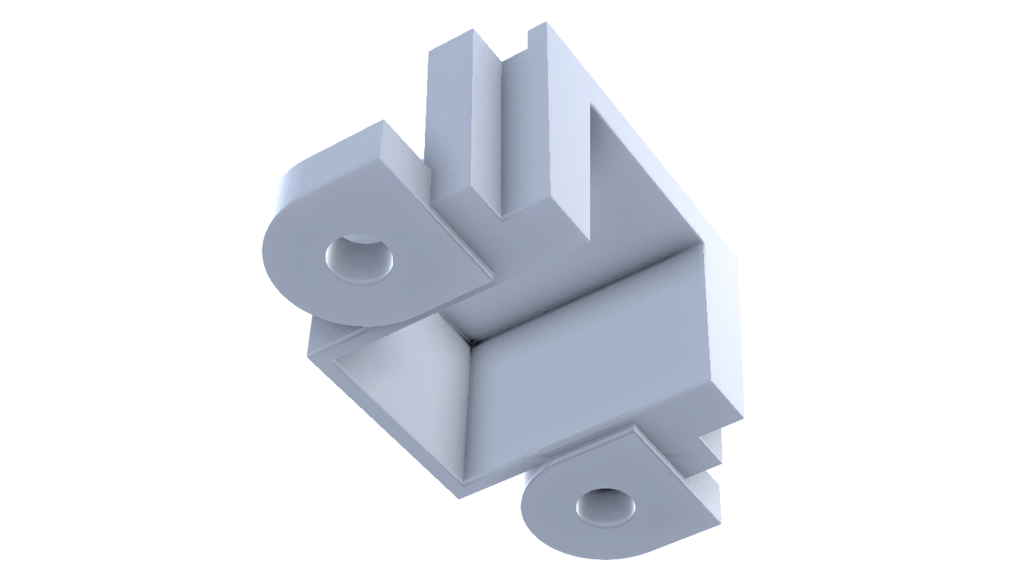

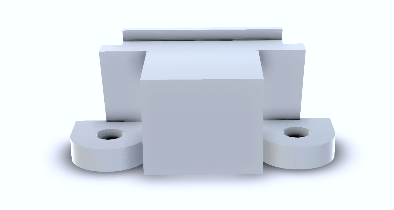

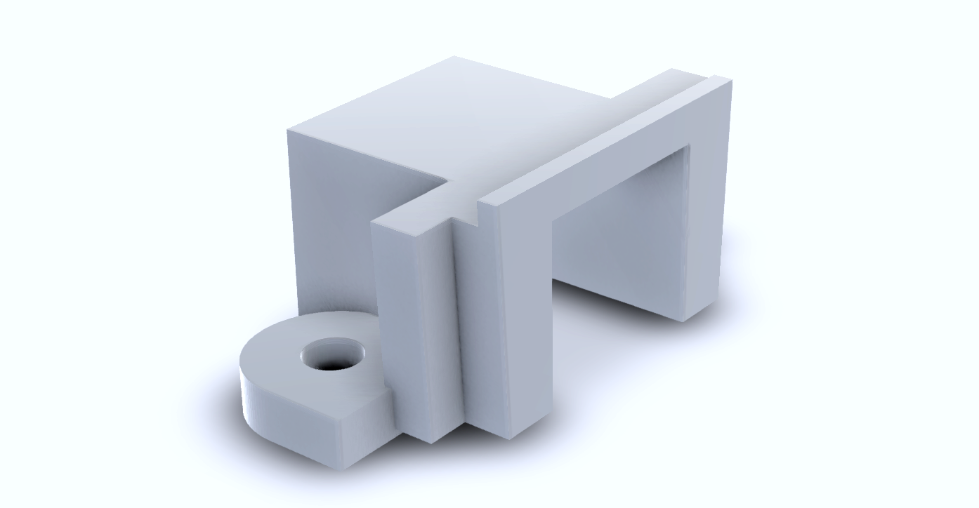

Updated the retainer clip, and sent off for printing. This will sit over the top of the daughter board PCB, and cradle the USB female port on three sides (.25mm tolerance). The retainer clip uses and extrusion from the top shell to hold the clip in position on the retainer pins of the bottom shell.
I really like how the USB-B sits in there. I know we are offering 4 variations of the USB connection, but I will probably only mock-up a retainer clip for the B and C. We will have a "blank" version as well if someone would like to dremel out for a mini, micro, or some future connection (note this would not secure the USB port like the B and C will).

lot_lizard wrote:Updated the retainer clip, and sent off for printing. This will sit over the top of the daughter board PCB, and cradle the USB female port on three sides (.25mm tolerance).
That is absolutely PERFECT! The USB ports are going to be virtually unbreakable.

The USB connectors are by far the weakest points on my Xwhatsit Model F boards, so it is good to see this much work put into beefing up the connectors for these boards. These should be pretty indestructible when all said and done.
19 Aug 2016, 21:49
Or, perhaps better, easily replaceable!

I see one minor issue.
The xwhatsit calls for a 0.1 uF capacitor between USB shield and ground (C6). I moved that to the daughter board but looks like i put it too close to a peg and it is under an ear of the retainer clip. I should turn it 90 and move that further out of the way. The "back wall" of the retainer clip looks thin enough to not interfere with the 4 pin header, but should be checked to make sure.
Please let me know if i need to move anything else.
lot_lizard
20 Aug 2016, 02:40
wcass wrote: The xwhatsit calls for a 0.1 uF capacitor between USB shield and ground (C6). I moved that to the daughter board but looks like i put it too close to a peg and it is under an ear of the retainer clip. I should turn it 90 and move that further out of the way. The "back wall" of the retainer clip looks thin enough to not interfere with the 4 pin header, but should be checked to make sure.
i actually reduced the radius of the retainer peg ear in that corner to account for the capacitor overlap (not in the render, but in the order). If you would prefer to alter the board, let me know. Either way works well from my standpoint.
The back wall is 1mm, and I believe works based on measurements (though tight). We'll know more after the prints. I am very impressed with how flush the USB-B female port "front" sits in relation to the cases's shell. You really did a great job without anything in hand to play with (all abstract).
