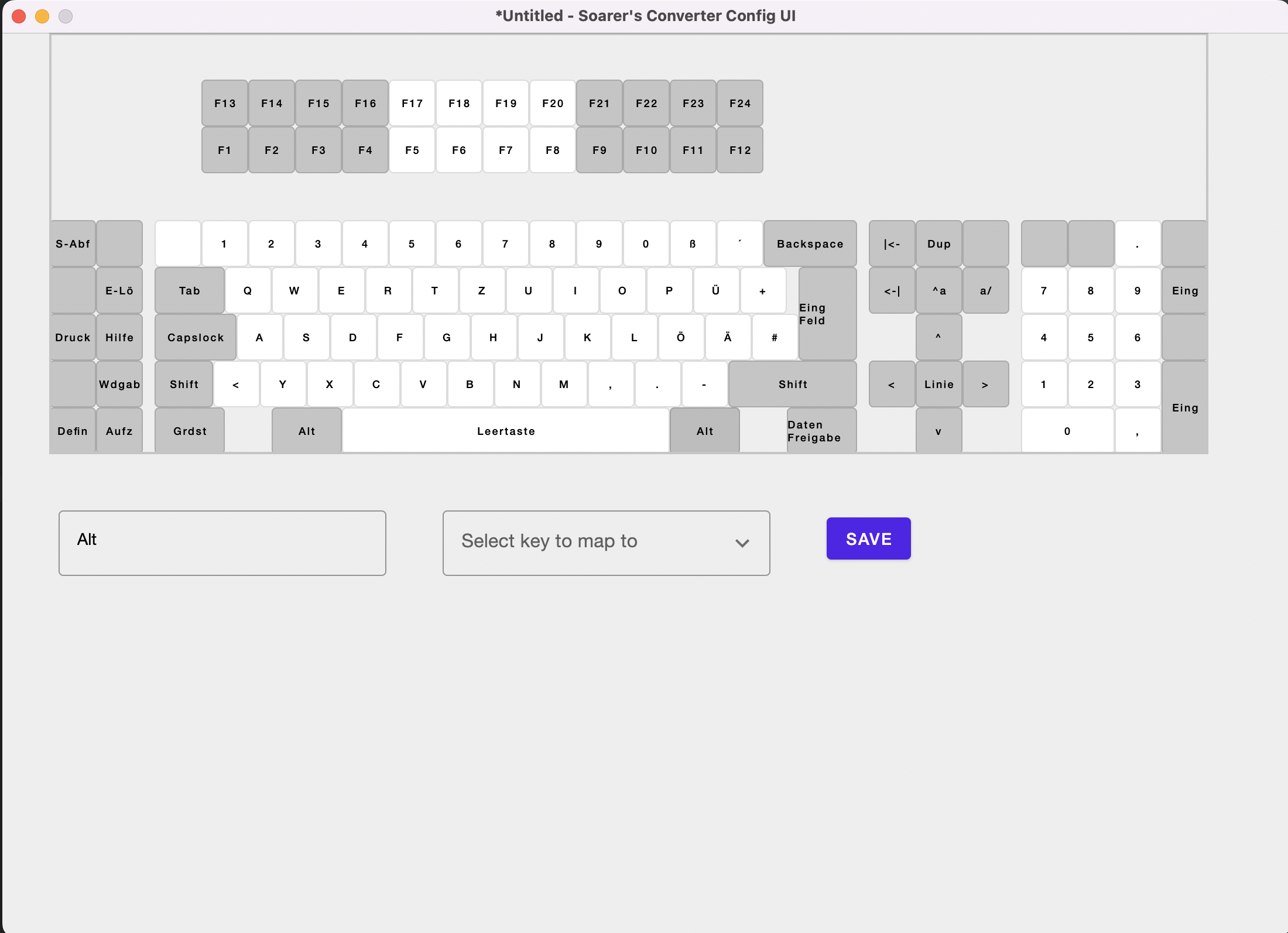

AngryCockroach
Hi,
I restored a few Model M 122 key terminal keyboards and also used the Soarer's Converter to flash Arduino Pro Micros with.
The way to write your config files and flash them to the converter is fairly easy if you done similar things before. But when you did not, it may be a bit difficult. That's why I tried to make a UI for the Soarer's Converter.

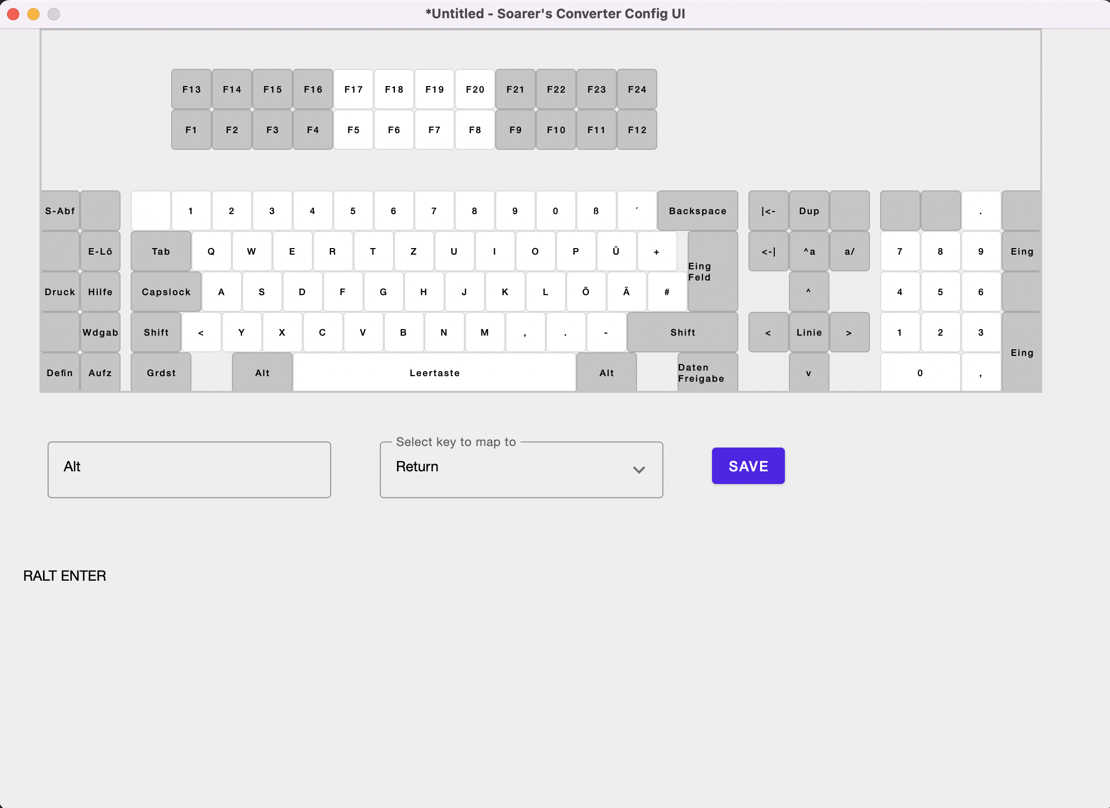

With this very early version you can see your keyboard and click an a key (right ALT in this example).

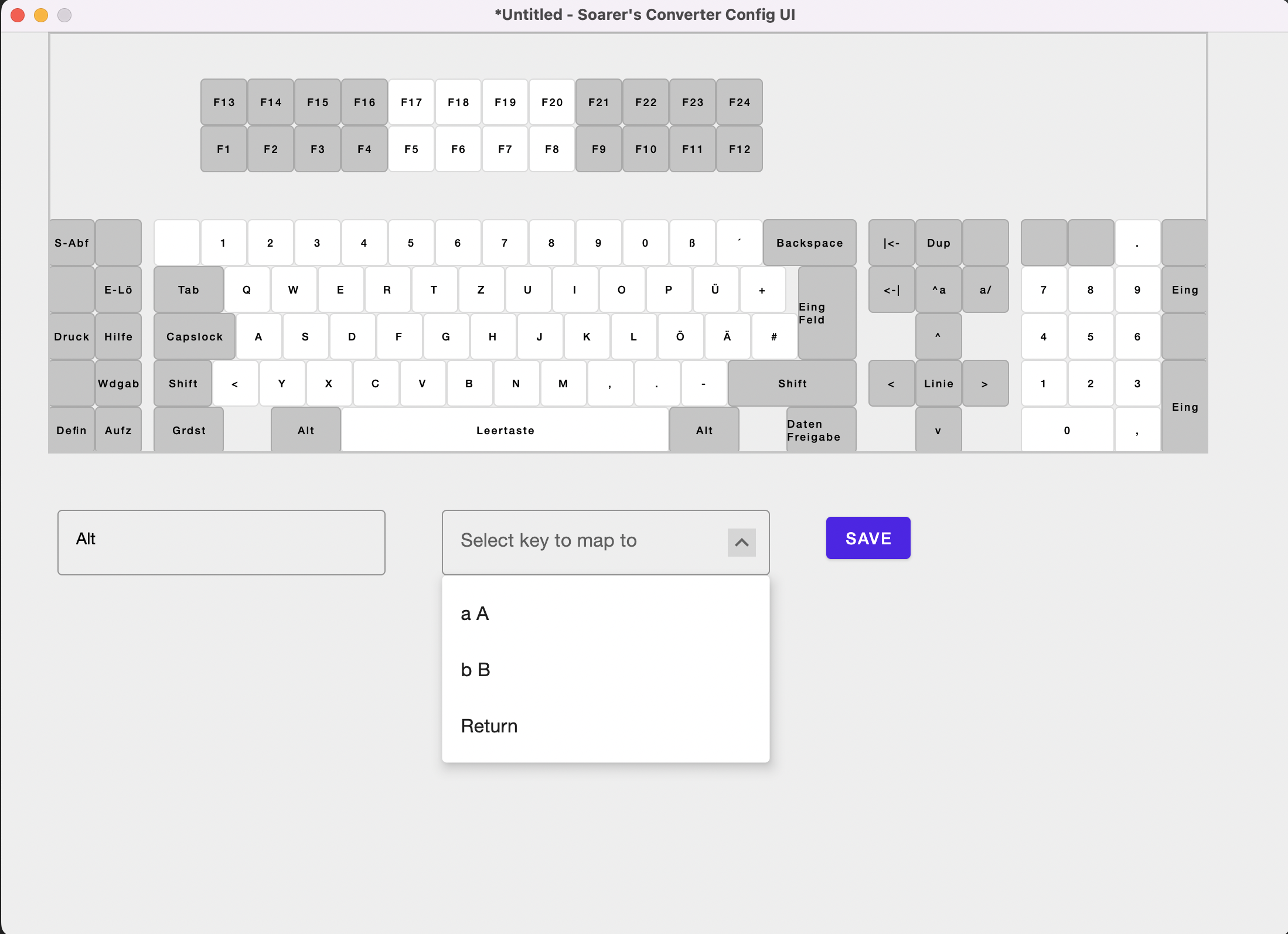

You can then select a key to remap to (I only entered 3 keys for testing).
And then you see the mapping below.
Of course there are many features still missing, e.g. switching to another keyboard layout, macros, layers, read and write configs to the converter directly etc.
But do you think this could be interesting to continue as a tool for beginners?
EDIT: See viewtopic.php?f=7&t=27533 for releases and download links.

Interesting. I see a Mac window. What are you building this with?
As for handing it to the masses: even (and especially) newbs have finicky requests for very particular things they’re trying to do. You’ll wind up with one almighty todo list of a project!
AngryCockroach
I am using Kotlin and Compose for Desktop. So I can build it for MacOS, Windows and Linux with the same code (but I need to build it on all three OSes separately…)
Well, since it is a hobby, it should not be finished soon anyway
And also some people may help…
As soon as I implemented the flashing within the app I will build it and it can be tested.
But I need some more different keyboard layouts. So feel free to paste the hid code layout for other keyboards.

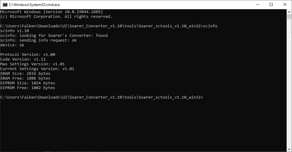

Running the batch file does create .scb files, but the cables just won't accept them. Maybe more information will help:Muirium wrote: 06 Sep 2022, 23:26 The Z<>A remap really should work. Something is wrong with your Teensy or your software tools. Using that batch file Soarer included, which may hide the intermediate details from you? Sounds like scas is working but scwr is not.
I bought these two pre-made SDL to USB cables from Orihalcon on Ebay. (Seems they have an account here too)
I'm running Windows 10 Home edition with one cable at a time connected directly to the motherboard.
I've tried re-downloading Soarer's v1.10 package and unzipping it to a separate folder in case there was an error in the first one.
I've tried holding Shift to run the programs as an Administrator.
I've even tried running the programs in compatibility mode for Windows 7 and XP.
The only thing I haven't tried yet is a non-Windows OS. I know a little bit about Linux, but not enough to trust myself and I'm not a fan of macs.
lylat1an
- Location: Washington state
- Main keyboard: IBM "enhanced" model M
- Main mouse: Logitech M570
All it says is that it's running version 1.12.Muirium wrote: 07 Sep 2022, 10:27 Try running scinfo to confirm the converter is in fact running Soarer’s firmware.
Screenshot attatched.
- SCInfo.png (1.92 MiB) Viewed 25176 times
- Muirium
- µ
- DT Pro Member: µ
No good reason why it won’t work then. Scwr should be able to see it just as well as scinfo. Maybe try giving scas an empty text file and flashing what it builds from that. I do just that to erase all settings from a converter.
