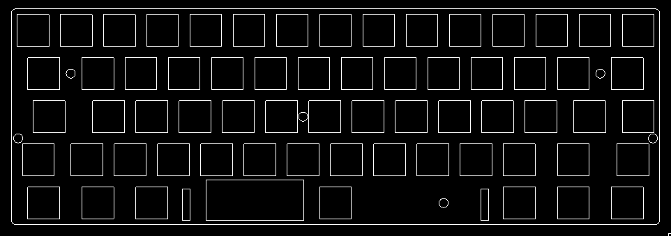

this might be the funky 60%, 1 only stab for spacebar, compatible with poker case.
It's basically this one:
with a 7u spacebar instead of 4 1.75u.
The big hole under the spacebar is for the teensy (and enough room for the connector).
Does anyone know the size of the screw holes?

11 May 2014, 17:37
Poker cases use M2 screws if that is what you ment.

11 May 2014, 21:00
matt3o wrote:nope, I mean the size of the holes on the plate.
I would guess "large enough for the head of a M2 screw". ;)

11 May 2014, 23:32
I believe screw heads are between 3 and 4mm so I made the holes 4mm. They should fit.
