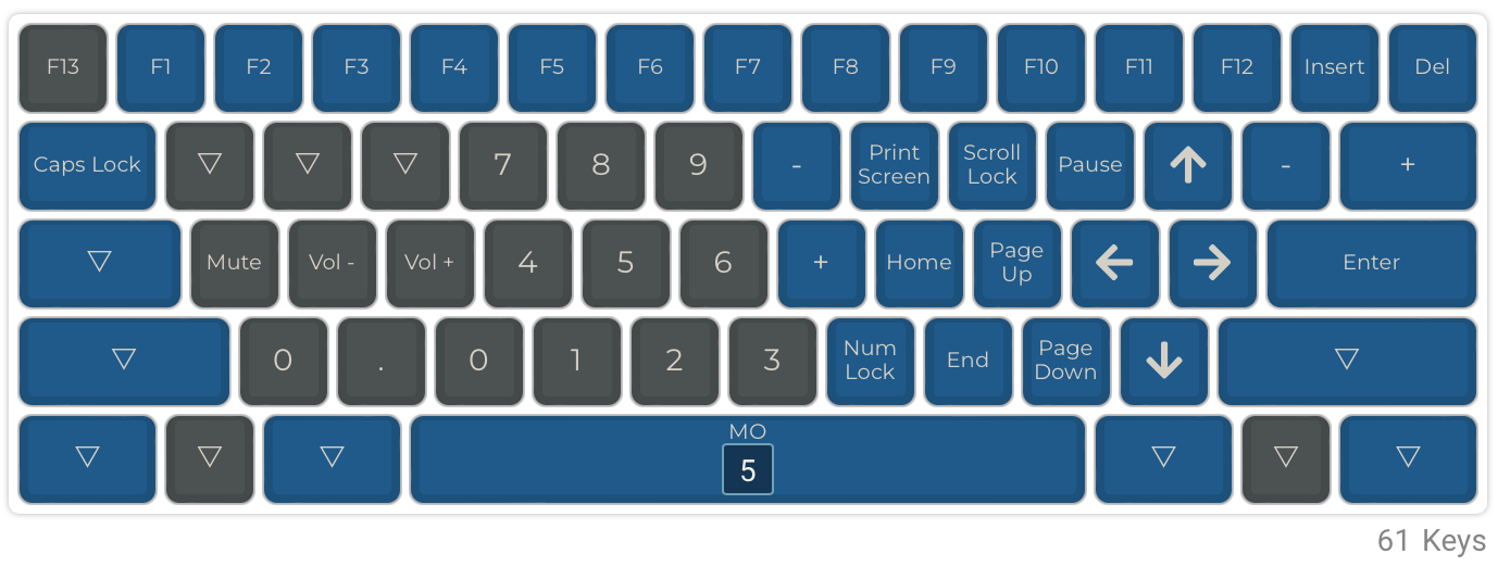

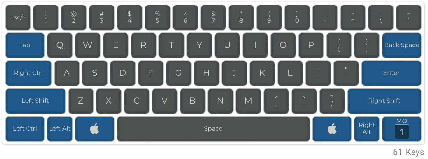

01 Feb 2024, 16:48
Here's how I have my IBM Kishsaver laid out, if you're looking for ideas:
Layer 0
Screenshot 2024-02-01 at 3.46.57 pm.png (93.34 KiB) Viewed 11669 times
Layer 1
Screenshot 2024-02-01 at 3.46.47 pm.png (95.9 KiB) Viewed 11669 times
Load the attached json into Pandrew's QMK configurator to dig around inside.
The key is to pick a good—HHKB!—function layer. The essentials are the arrow keys and Page/End etc. group, which I keep consistent across all keyboards. My layer 1 is packed full of extra stuff I've added over the years, including numpad functions which I hook into other purposes with Karabiner. :geek:
The Esc key, meanwhile double-actions as a ~ with that keycode in the editor.
µKishsaver.json.zip
(2.1 KiB) Downloaded 216 times
