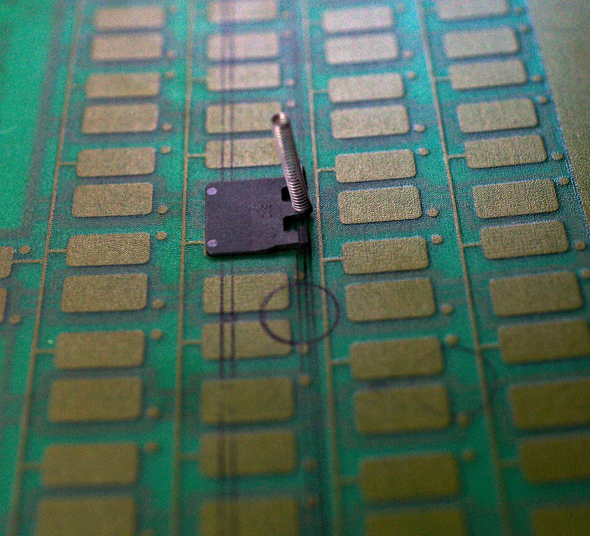

Alright ... lets come back to the PCB creation and its layout.
Here is the research that I have done so far.

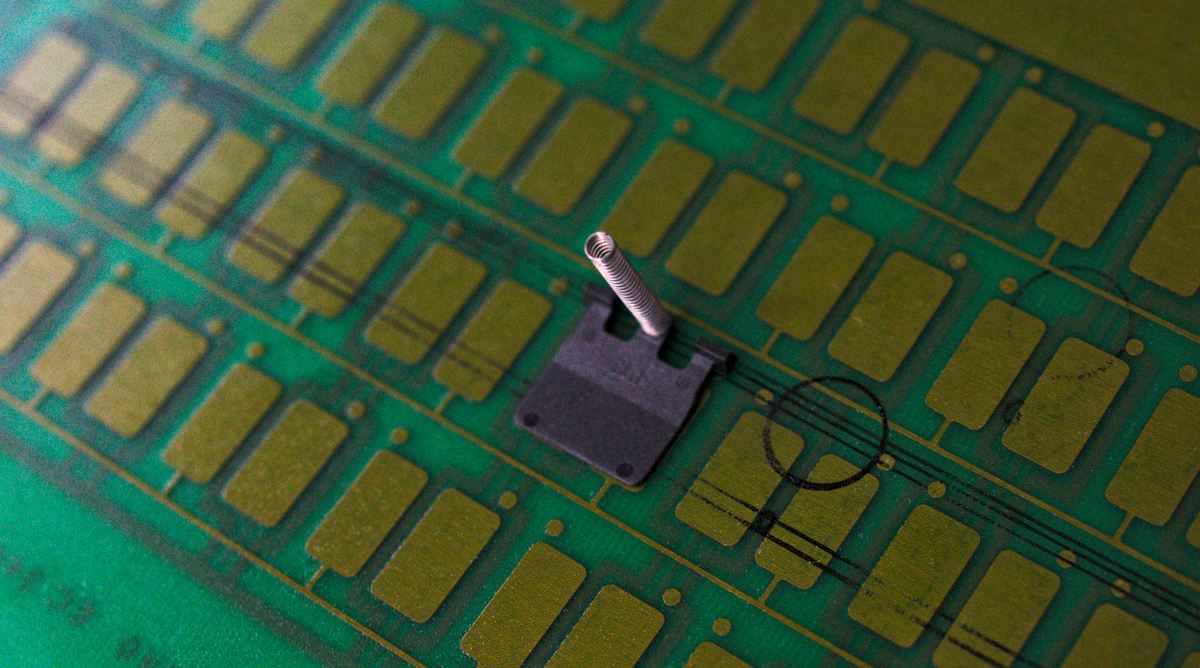

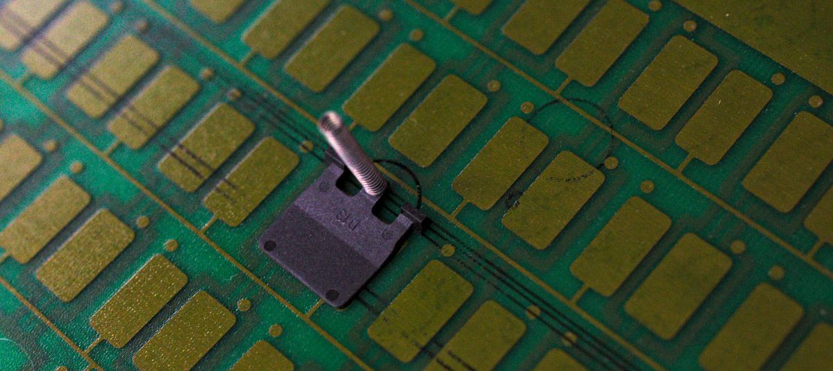

The pivoting points of the flippers in the barrels are not exactly in the centre. They are just above it.
If I paint this in the bifoot PCB, before the flipper is tested, I get the following:
You can see that my observation was correct. The foot of the flipper exactly covers the capacitor:

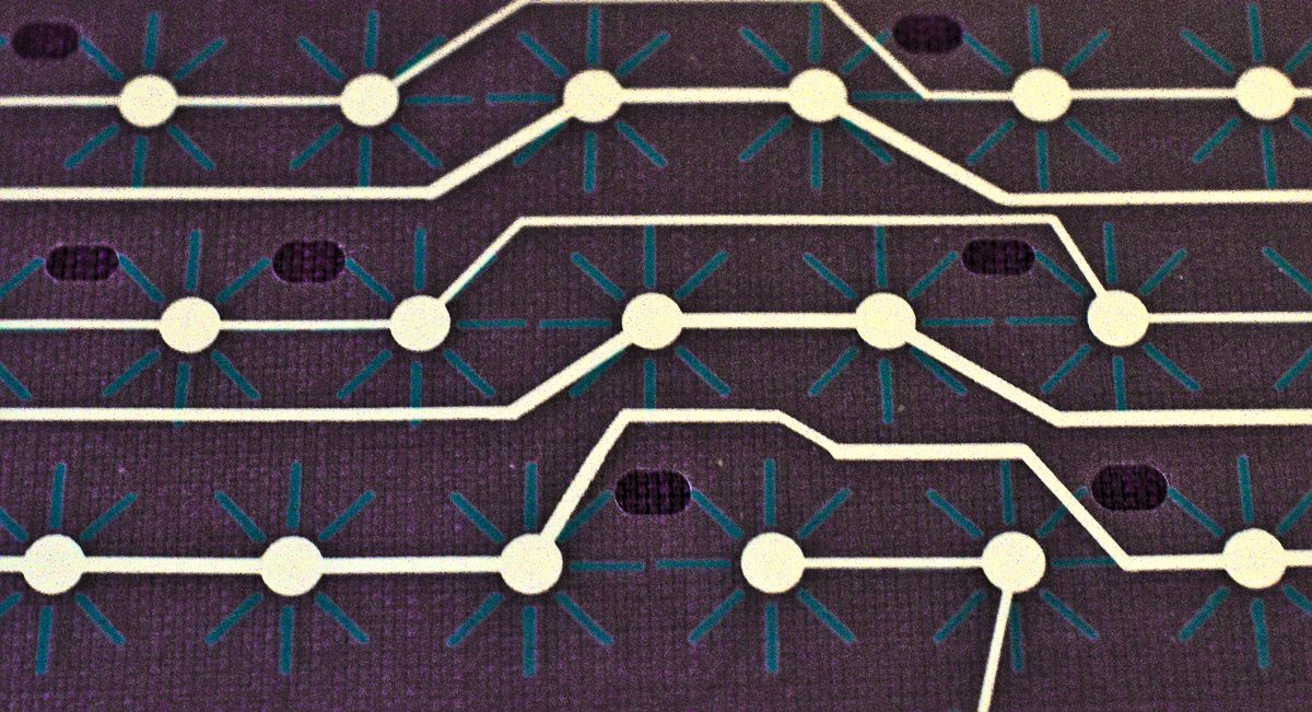

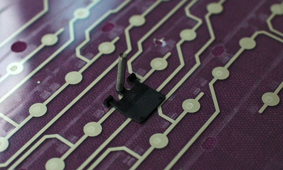

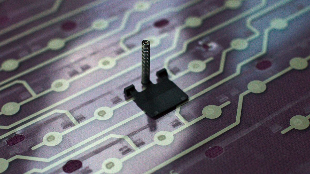

Now we can move to the SSK: the membrane has clear marks of the flipping points of the flippers that can be used to position the F flippers and check how would they sit on top of it:
I send you a second picture without the nasty reflection. You may see better what I mean:
You can see the the top part of the flipper foot is aligned with the conductive line and therefore with the centre of the contact point in the SSK membrane. This is very good news. We have a simple reference on the membrane,

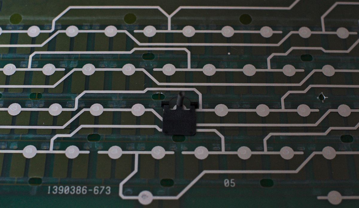

26 May 2015, 20:53
If we put all together (the membrane is transparent) we can see how the PCB should look like with respect to the distribution of the keys in the SSK.
The next step is therefore to model the SSK membrane first using the right software that produces the required file format for the company doing the prototype PCB. We could create this as a "virtual" layer that will latter be deleted. We add the two capacitor layers on top, using the references that we have found, link them ensuring that the holes for the screws are not in the middle, create the connector and we will be done.
Comments ?

I think adding the membrane is an unnecessary intermediate step that could lead to dimensional errors.
Since both the Model M and Model F barrels are basically identical this should be enough information:
- relationship of positions of capacitive pads to center line of Model F barrel
- locations of centerlines of Model M SSK barrels.
idollar
i$
26 May 2015, 21:02
XMIT wrote: I think adding the membrane is an unnecessary intermediate step that could lead to dimensional errors.
XMIT, That's exactly what I have done/suggested.
- the location of centerlines of model M SSK barrels is given by the centre of the contact point in the membrane (with a vertical displacement). We could simply use the membrane as our template for the barrels positions. The fact that is flat and transparent will help a lot. Measuring the barrel plate may lead to mistakes.
- the relationship of the positions of the capacitive pads to the centre line of the Model F barrel is show in the last picture.
Feel free to criticize this approach ... we might find a better way

Yes, I think that makes sense. I think the photo would be clearer with a Model F flipper foot on one contact point and a Model M flipper foot on the adjacent contact point. I had to think about what a Model M flipper foot looks like, where it pivots, and where the strike point is on the underside.
But, if you can use the membrane as a guide, that would be best. You know it is correct, it is transparent, etc. I may suggest scanning it on a flatbed scanner and then using it as a template in whatever CAD program you use as you proposed earlier.
Sounds great!

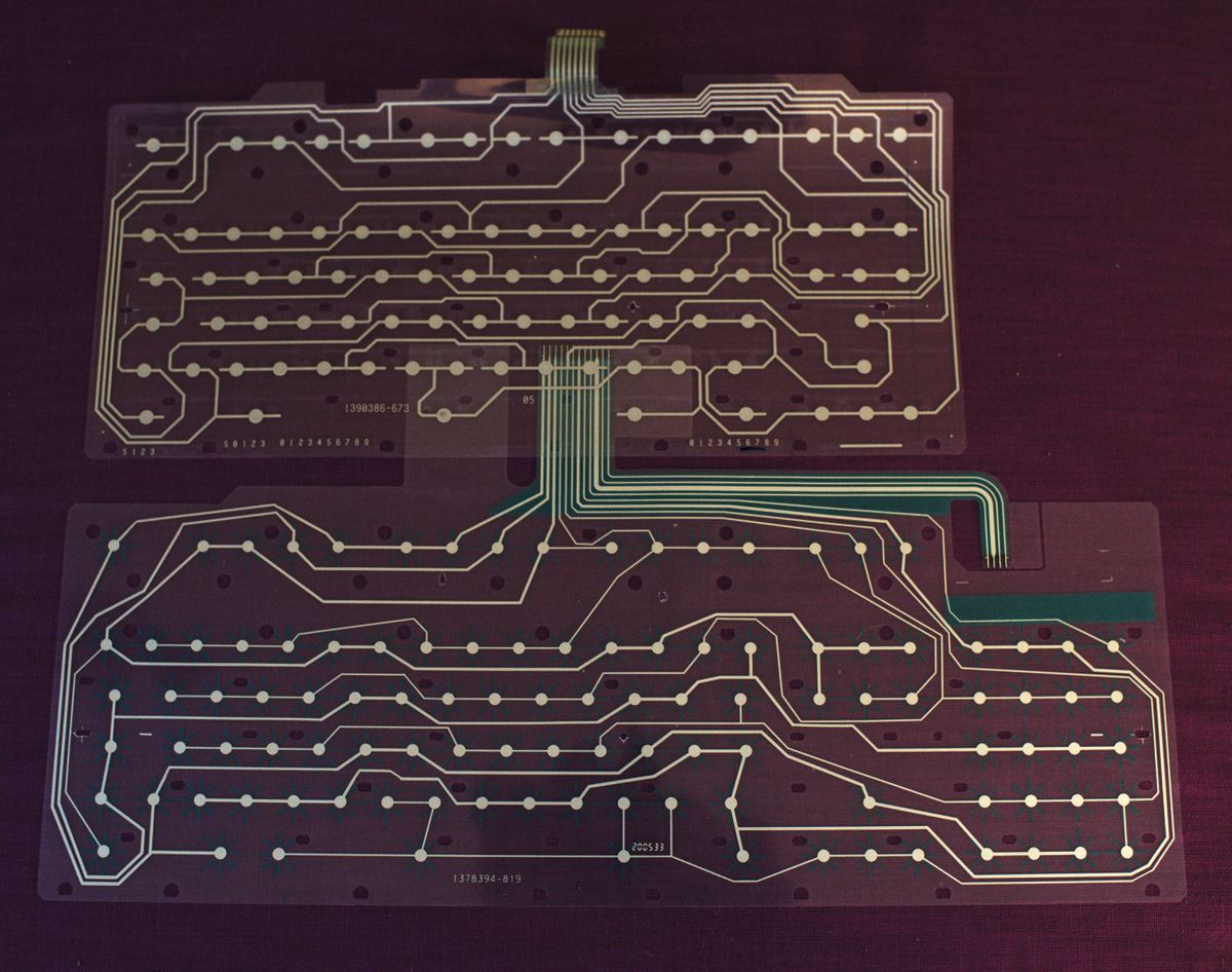

26 May 2015, 21:21
As expected the unicomp membrane and the ssk have the same distribution
The unicomp one has lines marked which ease even more finding the centre of the contact point !
(apologies for the quality of the pictures, I am working without light and in real time.)
26 May 2015, 21:52
Are you working under the assumption that Model F cap sense pads should be centred on the same alignment as Model M membranes? The flippers are different sizes, I expect the Model F pads are a bit lower down the board so they lie dead centre under each lare flipper. Just a guess though.
Did Wcass share his XTant PCB design file with you? Can't remember if it's open source.
idollar
i$
26 May 2015, 22:01
Muirium wrote: Are you working under the assumption that Model F cap sense pads should be centred on the same alignment as Model M membranes?
No I am not. Read above again. I guess that this was already answered.
The common reference point is in the center of the barrel or the spring.

idollar wrote: I cannnot see how RF shall affect such a big capacitor ... but I may be wrong here.
It's both RF getting into the capacitors (because the sensing works using a decently high frequency scanning frequency, and measuring how much charge the capacitors are storing, IIRC - stray RF can affect that), as well as RF coming from the keyboard and affecting other things (said decently high scanning frequency) that is a concern.
idollar
i$
27 May 2015, 09:46
If I am not mistaking, the Xtant used a non-metallic board to hold the barrels. And it worked.
I am not very worry about this, but it may be worth looking again at the Xtant thread to see how it was done.
