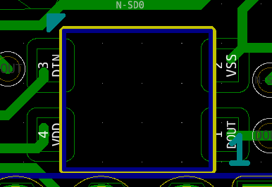

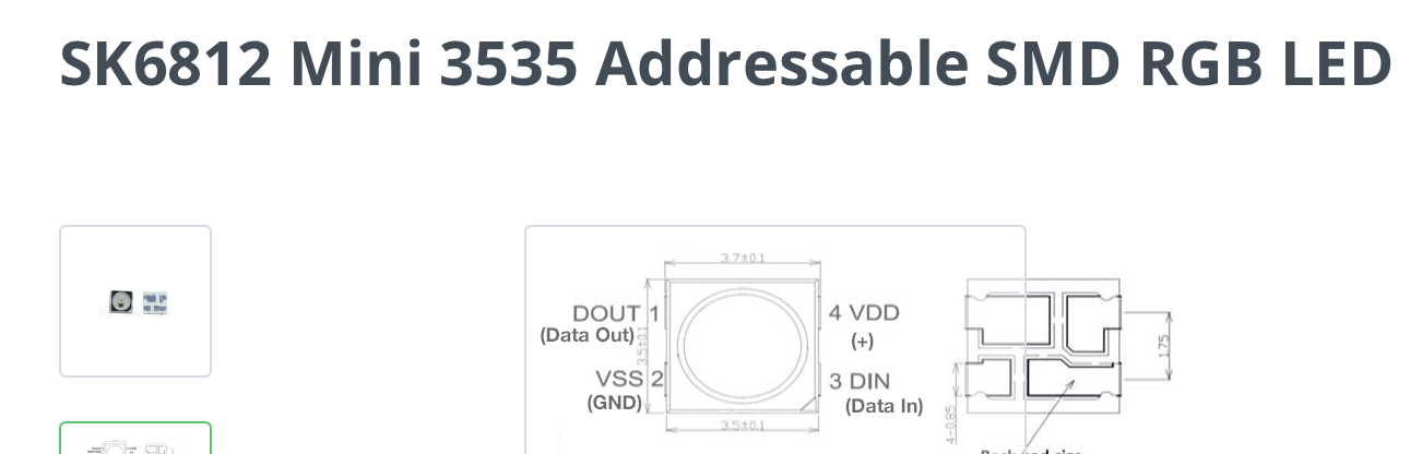

The ones you want are the SK6812 Mini 3535 (https://keycapsss.com/keyboard-parts/pa ... gb-led?c=6). If you take a look at the pinout on that website it matches the pinout on the amoeba-royale PCB (rotate the pinout on the website by 180°)
Screen Shot 2020-12-29 at 9.49.56 PM.png (19.15 KiB) Viewed 26518 times
Screen Shot 2020-12-29 at 9.49.47 PM.png (99.62 KiB) Viewed 26518 times
If you take a look at the pinout of the mini-e ones the pinout doesn't match.
Saying that though I ordered some SK6812 Mini 3535 and they fall straight through the hole on the royale. So either JLCPCB didn't drill the holes accurately or the LEDs I bought are on the small side.

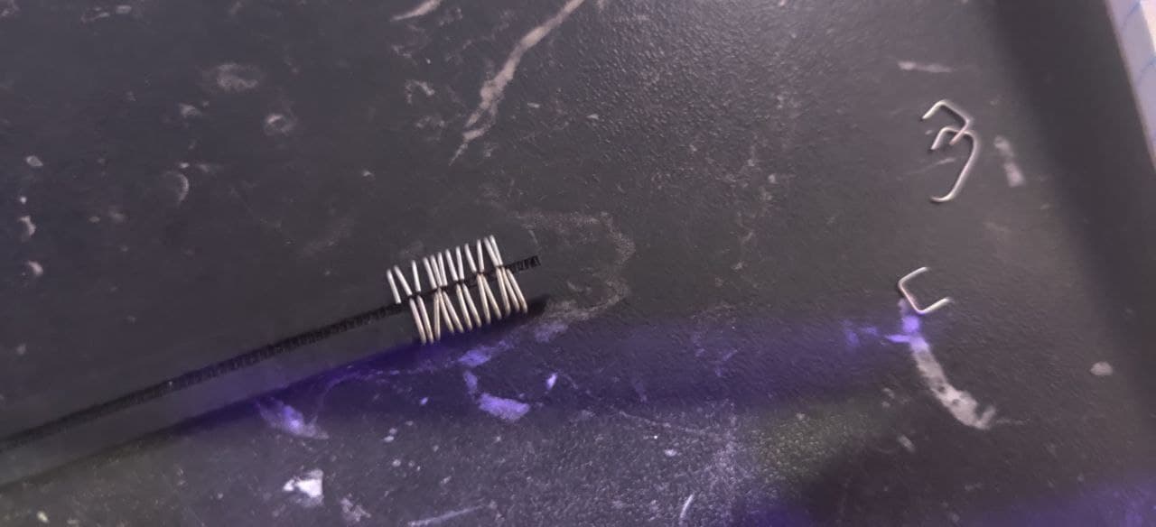

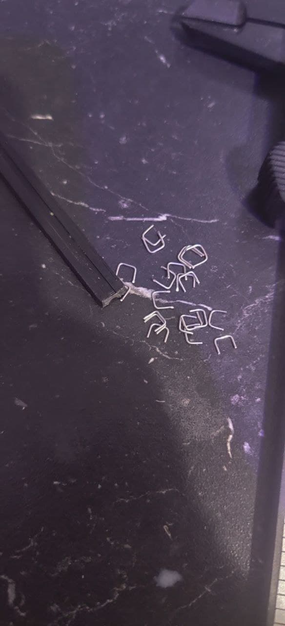

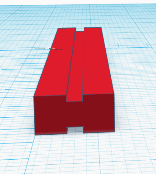

I think they said that space was limited seeing as how there's a lot of stuff in a small single-switch pcb.

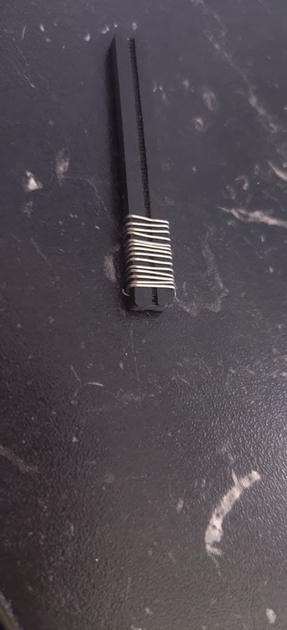

I feel you though, and I made a wiring jig that you can 3d-print.
I'm printing another one right now to test the print quality required.
Basically you just wrap an unshielded solid-core wire around the jig and cut down the middle with some flush cutters. It's basically the right size to just take the Half-square shaped wire and drop it into the holes. Will upload an STL here or thingiverse once it's done printing.
Here's a sample though to get an idea of what it looks like:

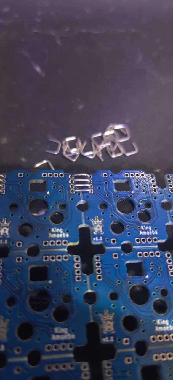

ping
25 Feb 2021, 20:32
It's not perfect, but it does speed up the process quite a bit (in my opinion).
Here are some images of me using the jig:
Amoeba_wiring_jig.zip
(1.24 KiB) Downloaded 380 times
feel free to use/modify/sell or whatever you want with that STL. Took me 10 mins in tinkercad.

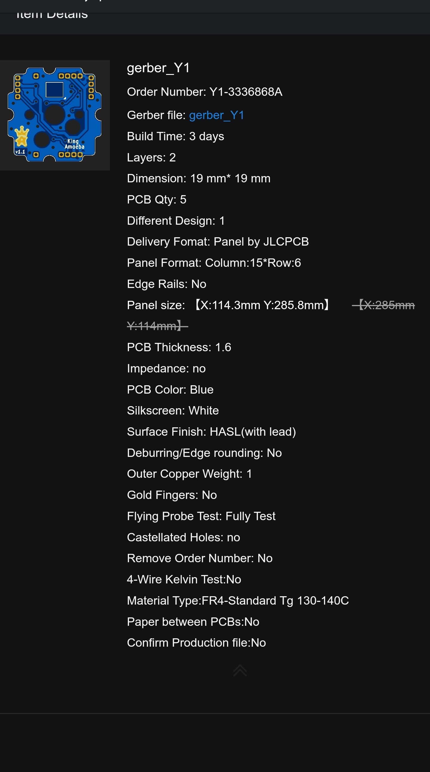

1. Did you order from JLCPCB? If so what options do I need to select after uploading the gerber zip?

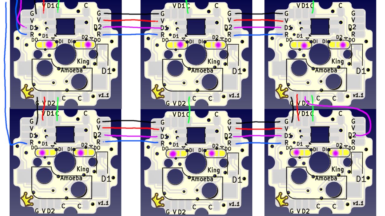

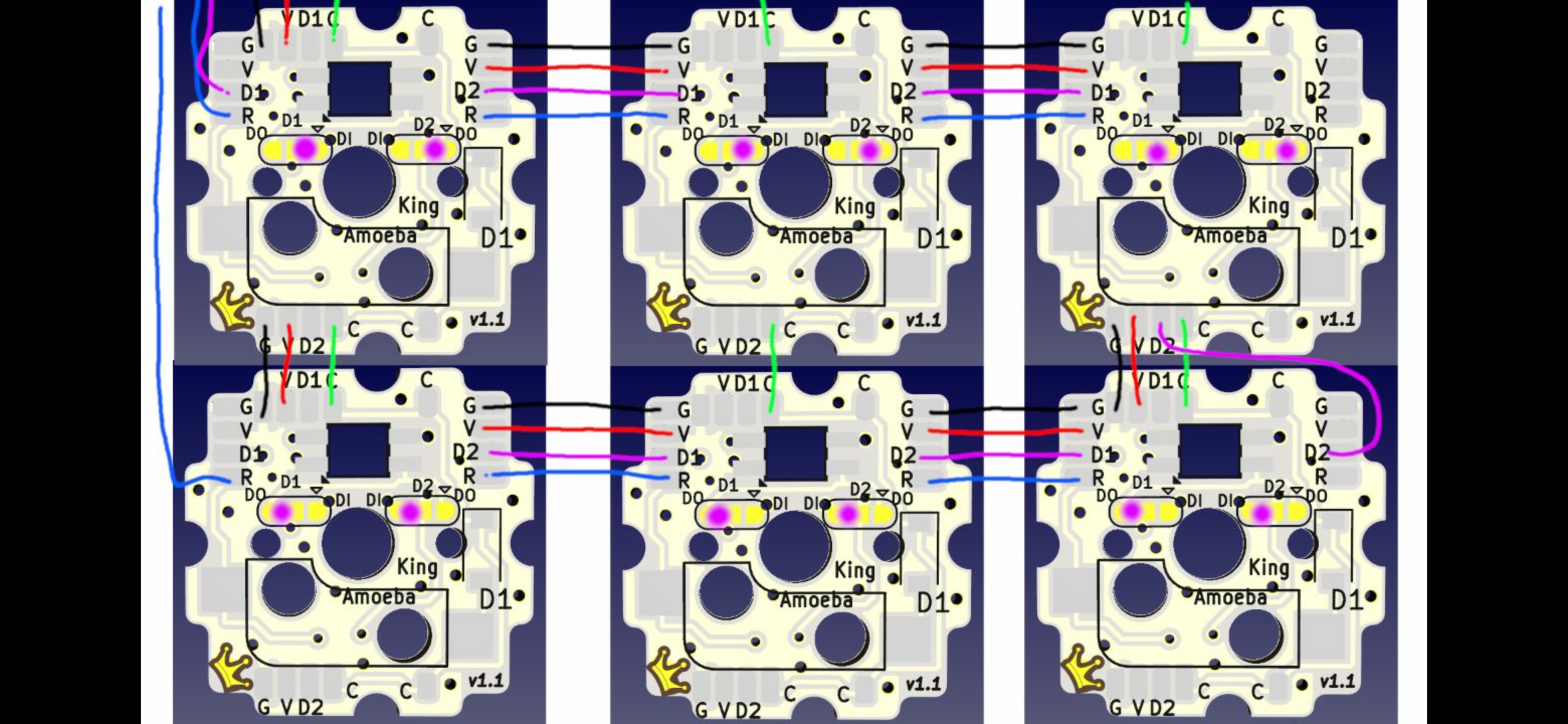

2 and 3: My 3535s also fall through the hole and I am going to try to bridge the gap with wire or solder.
4: Earlier in the thread (page 2 or 3 maybe?) there is a wiring diagram, I have attached it here. The text associated with it is "Here is a wiring diagram, not showing the column data connections needed at the ends of each row"

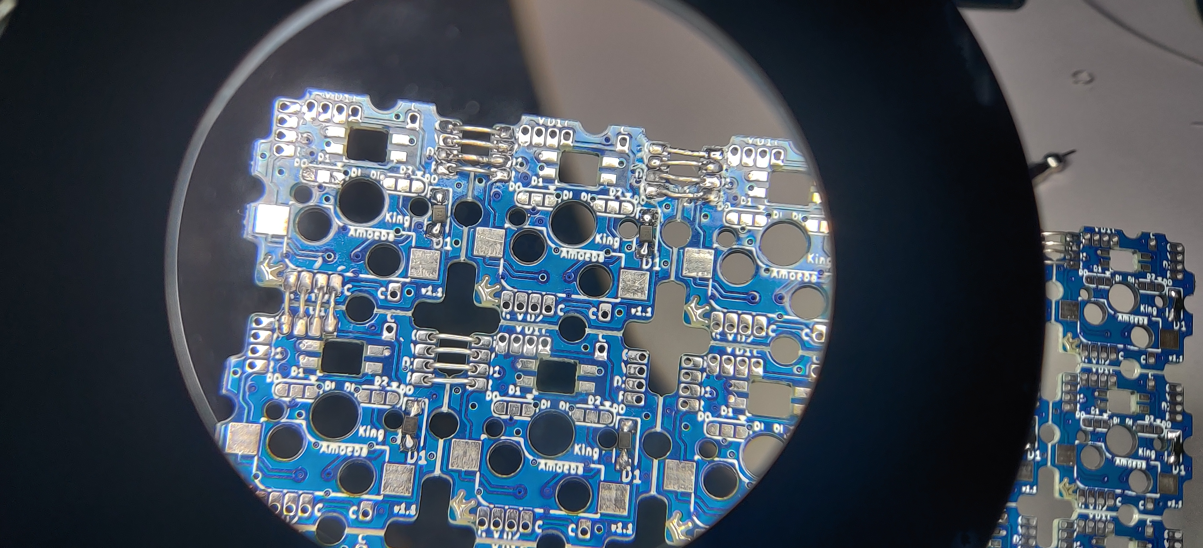

Oh gosh :o , sorry for the delay. I thought email notifications were enabled.
This is what I ordered from JLCPCB:
Ordered 200 of these(reduced amount to stay in budget): https://m.aliexpress.com/item/4000475685852.html
500 of these:
https://a.aliexpress.com/_msnCAuR
Kailh hotswap sockets from kprepublic.

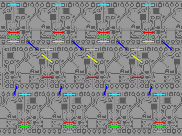

And I reached out to superami and they sent me this to help with wiring:
If you have any other questions, I'll do my best to answer. (And to enable email notifications lol)

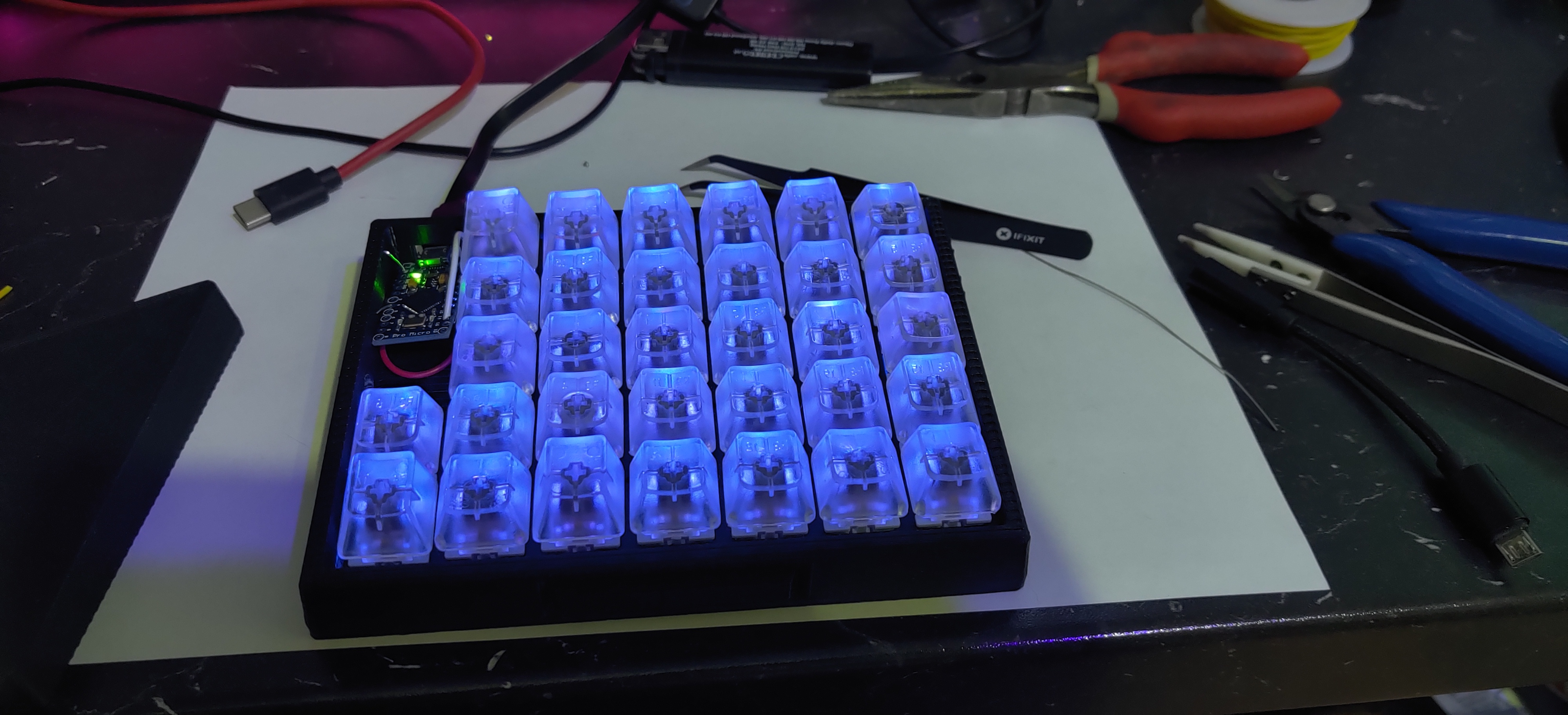

21 Jul 2021, 04:19

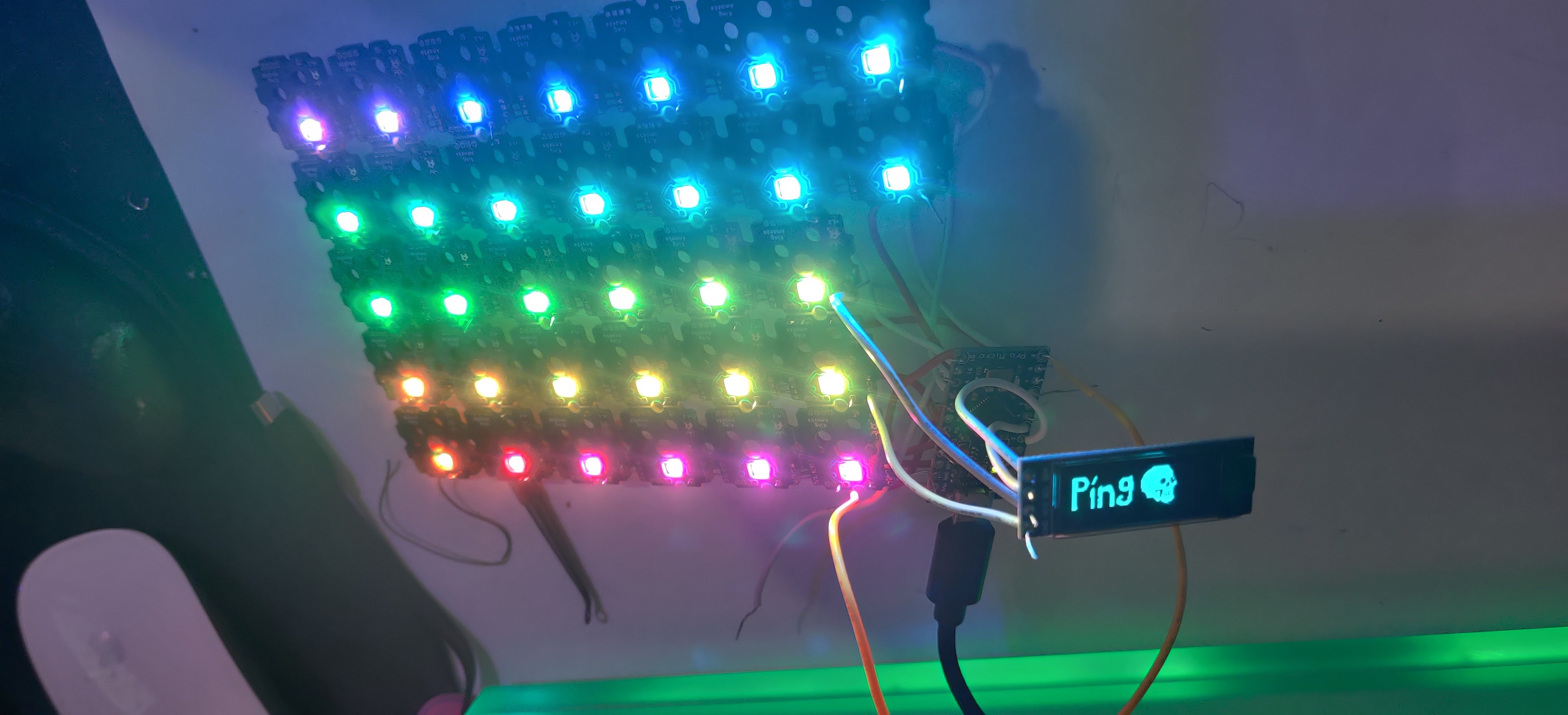

Here's some more media:
GIF/vid of LEDs in action:
http://imgur.com/gallery/wWluNvc
freznel10
Hi I was wondering how the jumpers work for the Amoeba King. Do you have a guide on it?
ping
25 Jul 2021, 16:49
freznel10 wrote: 25 Jul 2021, 12:41
ping wrote: 21 Jul 2021, 04:19 Here's some more media:
Hi, I don't have a guide other than the image superami provided.
Consider this to be a 2x3 ortholinear keyboard. Each of the colored lines connecting one pcb to the one right next to it is a jumper. At the end of the row, you'll see a column (on the right side) you'll see where all the black/red/green jumpers connect, but we have a pink wire connecting d2 to d2. That has to be done at the end of each row. All the other non-ending amoebas need the "C" column connected. This will feel familiar if you've ever done a hand-wired board without a PCB, each row and each column needs a wire connecting it all together, and then to the microcontroller.
Hope that helps. I'm not an expert, but if you have further questions, I'll do my best.
Good luck on your build.
ping
25 Jul 2021, 16:55
Oh you'll also see below the LED we have D1 D2 D0. That is directional, you'll see the top row is all middle&right while the bottom row is middle&left. All that needs to be done there is to put a small blob of solder in the direction of the row.

ping wrote: 25 Jul 2021, 16:55 Oh you'll also see below the LED we have D1 D2 D0. That is directional, you'll see the top row is all middle&right while the bottom row is middle&left. All that needs to be done there is to put a small blob of solder in the direction of the row.
Thanks. What kind of wire did you use?
ping
27 Jul 2021, 16:37
freznel10 wrote: 27 Jul 2021, 14:42
https://www.amazon.com/dp/B07TX6BX47/
freznel10
27 Jul 2021, 17:08
Oh so you stripped the insulation? Then bent them using the wiring jig
ping
27 Jul 2021, 17:24
freznel10 wrote: 27 Jul 2021, 17:08 Oh so you stripped the insulation? Then bent them using the wiring jig
Yep, exactly. Those are the "jumpers". The jig just facilitates making them since you need so many.
