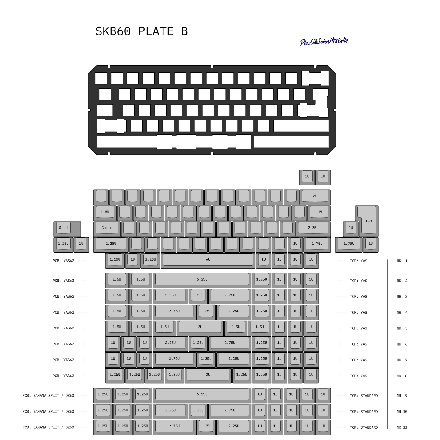

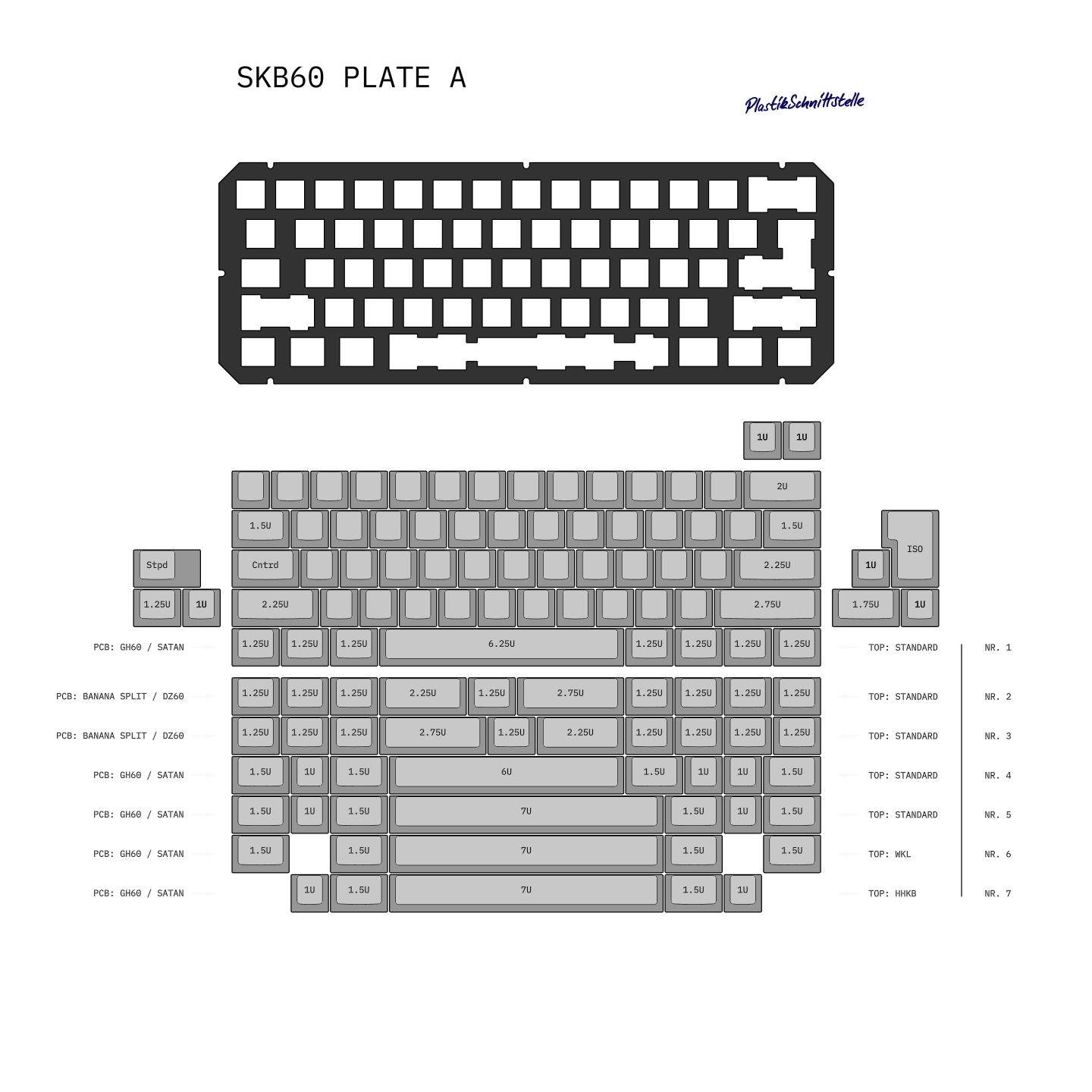

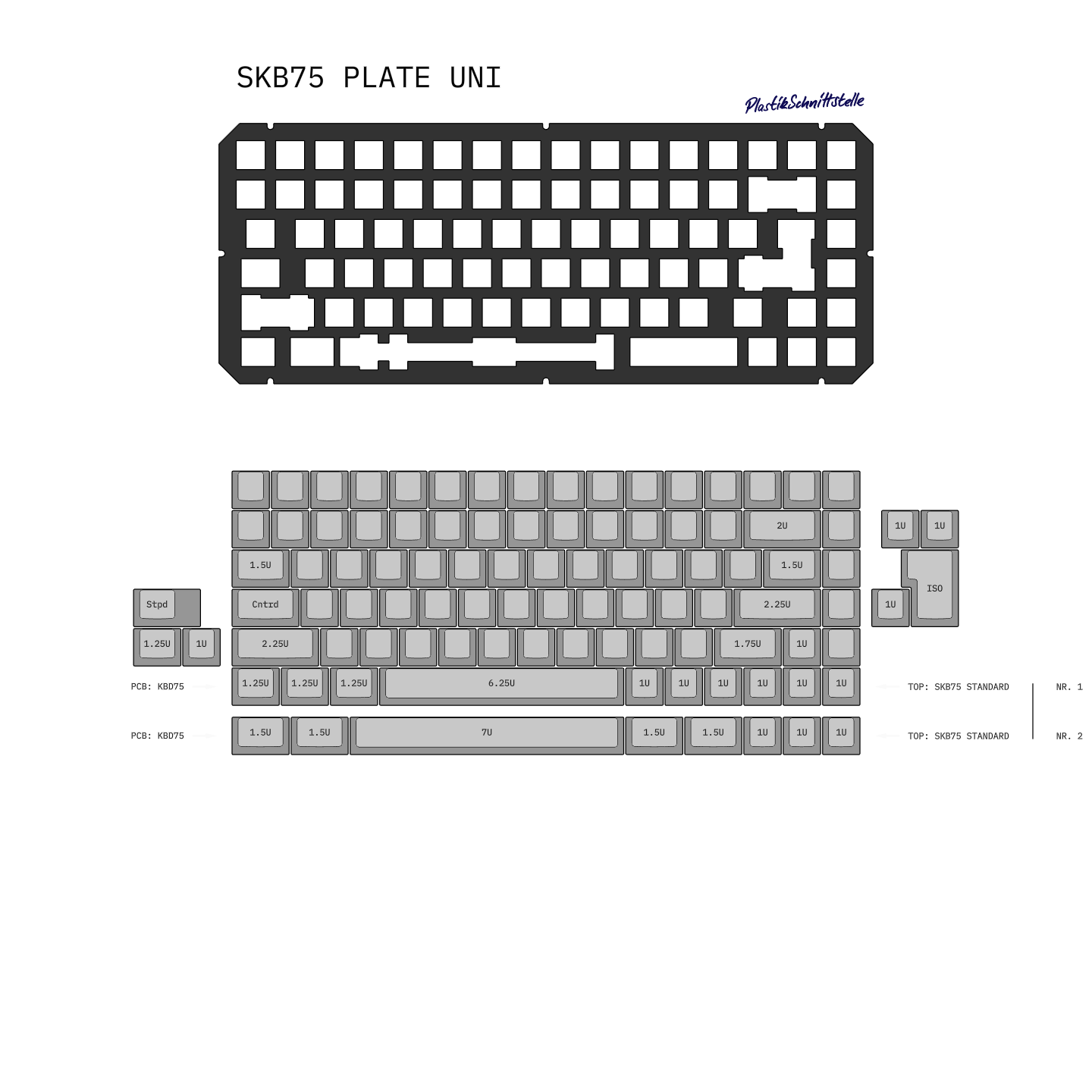

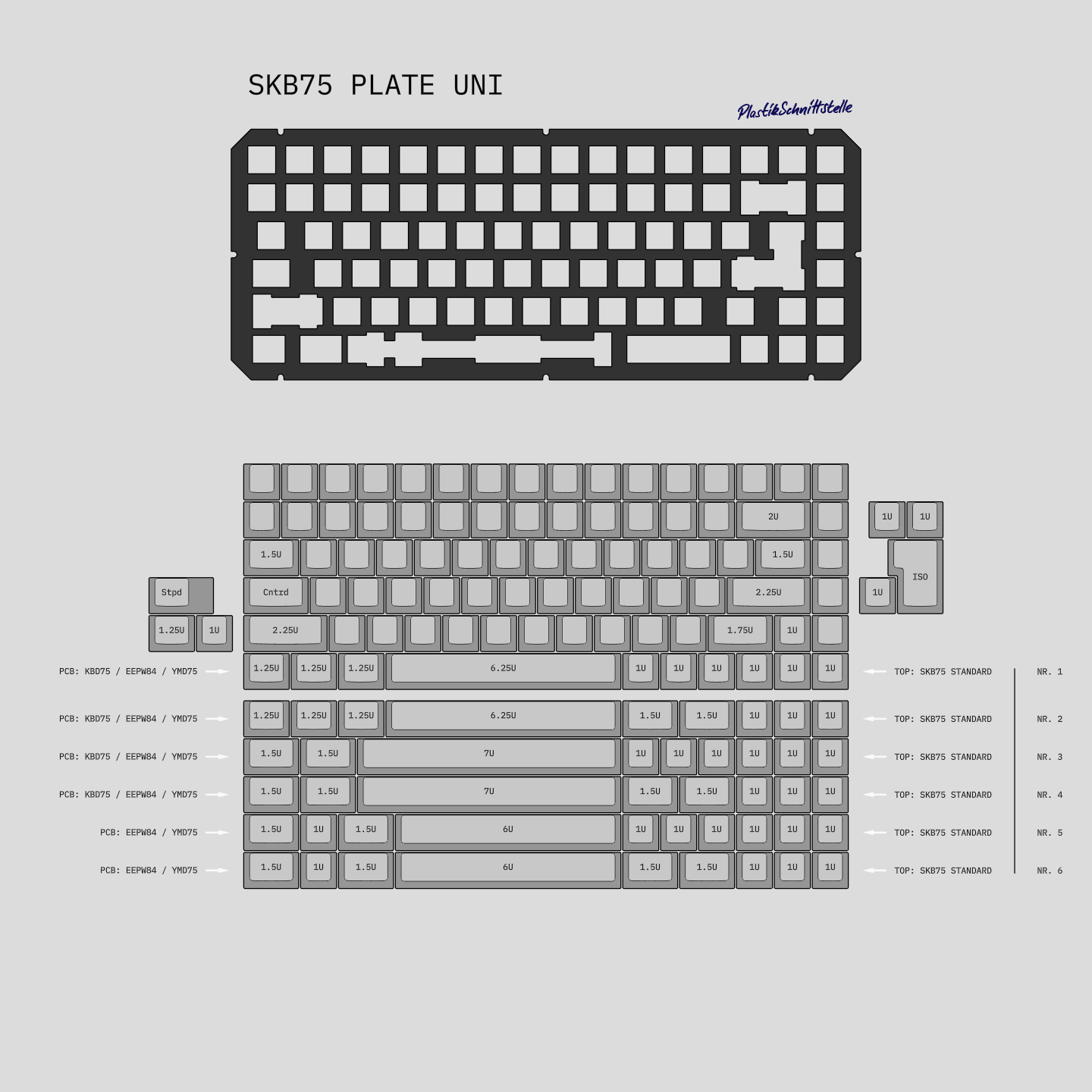

Aaand another thing! You know how much I stressed about how I wanted to go for "highly individualized" plates in the beginning? Yeah, I have to admit now, that I just wasn't that experienced with plate designs and learned a lot since. Some of my thoughts back then just don't make sense and also offering lots of different plates(more parts) is an insanely stupid way to drive the prices up.
So, when I was told I'd have to wait a bit for the prices due to the "complexity" I went into panic mode and made a last quick change in order too keep the prices in check.
In short: ANSI/ISO separation got cancelled and now we are down from four to three individual plates. Two for the 60% and one for the 75%.
Yes, the 60% B-plate has huge cutouts. Combining the possible YAS layouts just isn't possible any other way. Also because the arrow-cluster DZ60 layout had to fit in the B-plate as well. The A-plate therefore is kept nice and clean, it holds the most common layouts.
Even though the B-plate has the big cutouts, I'm not worried. The wide frame of the plate ensures good stability.

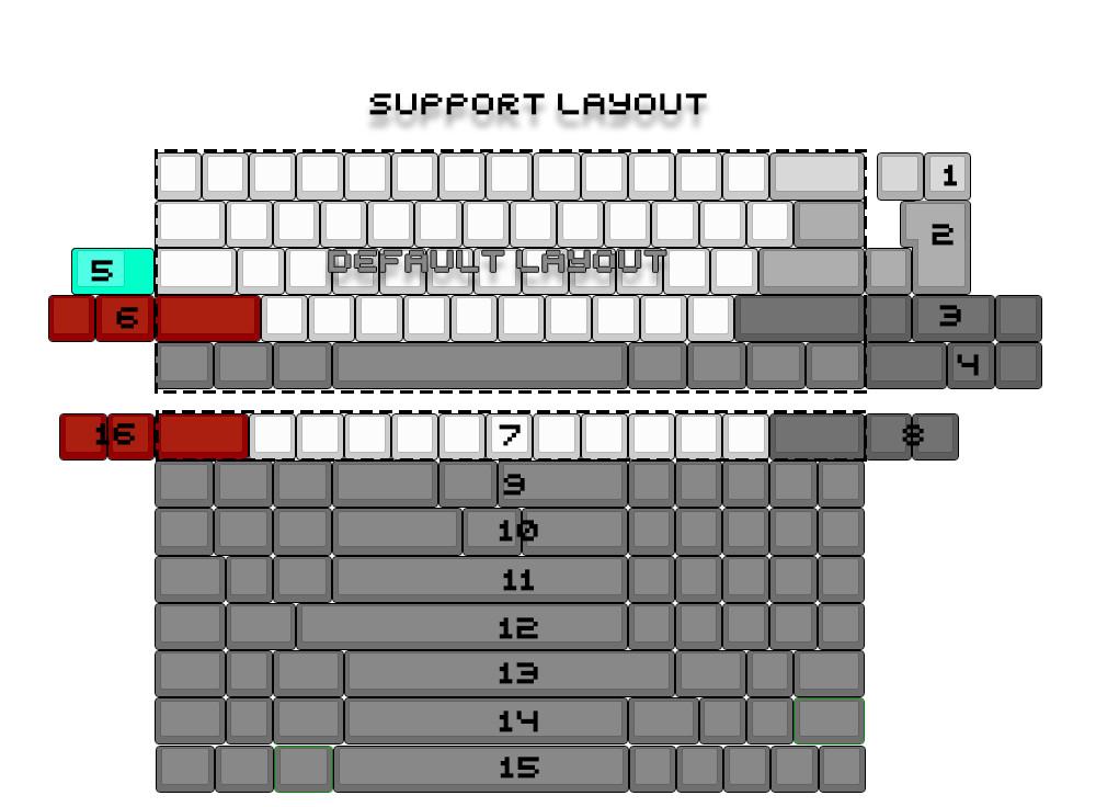

I made more graphics so you can already have a look and think about what you might go for.
I'm pretty curious if the support for split bananas and DZ-arrow-clusters, which I implemented following some requests, will be worth the time spent.
Please let me know if I missed something.

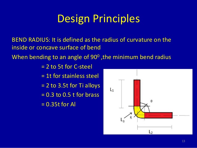

I like the idea of bent steel, I just wonder how can you bend a thick plate with such a small curvature, that will be a big problem if you don't want microfractures along the bending. Otherwise the plate needs to be near to fusion temperature if you don't want fractures to appear. If you make the plate too thin, it will lose some appeal.
In this slide, t is the thickness.
canc theory-of-bending-13-638.jpg (60.24 KiB) Viewed 11864 times

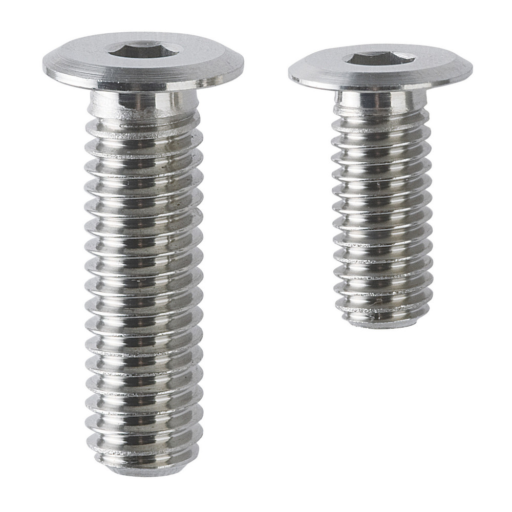

I'd suggest recessed head screws, flat is nicer.
canc screw rw_01.gif (5.32 KiB) Viewed 11846 times
This option would be compatible with a standard hole:
Ultra Low Head Cap Screws Hexagon Socket
canc 110302280540_20149999_m_01_99999_jp.jpeg (133.31 KiB) Viewed 11840 times

gianni wrote: I like the idea of bent steel, I just wonder how can you bend a thick plate with such a small curvature, that will be a big problem if you don't want microfractures along the bending. Otherwise the plate needs to be near to fusion temperature if you don't want fractures to appear. If you make the plate too thin, it will lose some appeal.
The case will not be made of steel but aluminium (3mm), only the plate will be steel (1.5mm). Yes, 3mm is pretty thick for sheet metal - the high thickness contributes to its special appearance. The curvature/outer radius isn't that small actually, it might just appear that way on the renderings. It is roughly a 4.5 - 5mm radius (or curvature, to be more exact).
When you bend sheet metal ("Biegen" or "Abkanten" in German), the outer side of the material get stretched - that is just normal.
I did projects with bending sheet aluminium before, thicknesses of 0.5mm, 2mm and 3mm at various angles. This is done by a company who specializes in metalworking. They do this stuff every single day and the method of bending is a standard procedure that is commonly used in all sorts of applications. The opening post also includes photographs of the prototype, there are no fractures. Even if there would be (on a microscopic level) - after the bead blasting they wouldn't be visible any more.

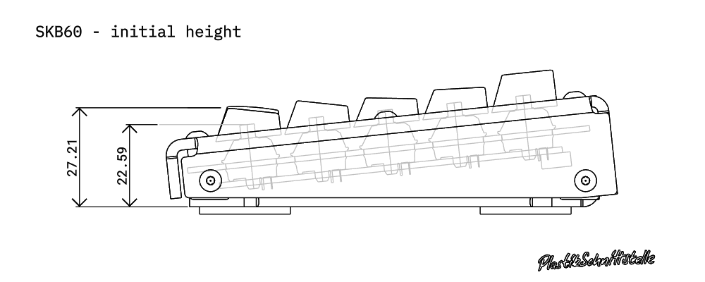

gianni wrote: Also, given a cherry profile, what is the heigtht of the top of the keycaps, in the bottom row? Higher cases are painful for my wrists :shock:
This is an interesting observation and a matter that is very important to me as well. I elaborated on this a bit more over on GH, this is what I wrote there:
Keep it low
By this I don't mean the profile height or the overall height. What I mean is specifically the "initial" height of the lowest row, the one with the spacebar - I want it to be as low as possible.
If this lowest row starts too high, the case gets uncomfortable to use. Ergonomically that doesn't make much sense, only the addition of a wrist-rest makes too high cases comfortable to use. But that's just my opinion, maybe this is not a concern for you.
There is of course a limit of how low you can accomplish and I think I'm at this limit. In order to compare I suggest measuring the height of switch stems tip. You may take of a Ctrl-cap for example, take your preferred measuring tool and look what you get. My case has roughly 22.5mm (excluding the rubber feet).
Here, I made a new picture to illustrate this better:
Regarding the screws:
This was also detailed a bit further over on GH. I just try to avoid c&p content between the two forums and rather just answer what comes up in each separately.

faxe wrote: is there any info on the pcb?
60%:
Yes, for the SKB60 all standard 60% PCBs will work, but not all layouts are supported, see here. Faxe, you live in Germany, so you could get PCBs from Falbatech or Candykeys. The DZ60 PCB is an option as well.
YAS62:
Silentreader has a few more of his YAS62-PCBs to offer. We came to the conclusion, that shipping them around the globe so I could offer them as bundle might not be that smart - it could end up more expensive due to import taxes. So if you want the SKB-YAS version, you just order the PCB directly from silentreader. This is his original GB and here is the currently running extra sell.
75%:
Follow hansichens link above.

14 Feb 2018, 08:13
So all the 75 options (YMD75 or KBD75 and maybe the EEPW84) will work? great to hear! Thanks for the info!

PlastikSchnittstelle
15 Feb 2018, 15:29
faxe wrote: So all the 75 options (YMD75 or KBD75 and maybe the EEPW84) will work? great to hear! Thanks for the info!
Exactly! Here as well the updated 75% layout graphic, so you can have a look right here. Maybe I'll just order one EEPW84 PCB for myself to check if it fits although it has the added controller board. But for now the EEPW84 PCB is NOT SUPPORTED because I just can't say for sure at the moment.
