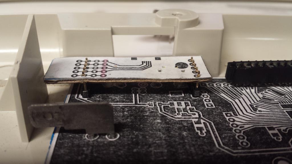

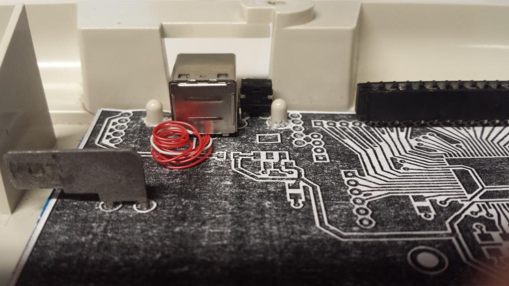

Okie doke. Well, in the mean time, here's what we've got:

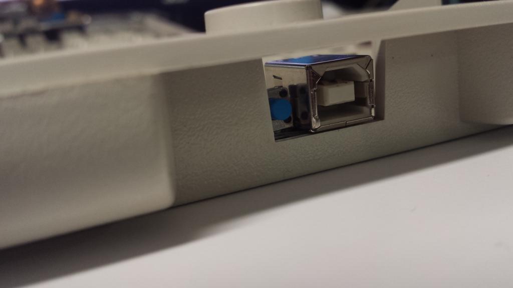

View of USB-B connector and reset button. The reset button will have a smaller actuator and be more recessed than this. I'll have a slot in the "cover" to poke it with a paper clip.
2015-03-04 11.02.58.jpg (38.63 KiB) Viewed 10284 times
View from the inside looking out. Notice the voltage regulator pads.
Also note the row of through holes on the upper left, that's the USB header tap, which comes in handy for your own cable/panel and for the next picture...

Take form of... MICRO USB!
(Well, visualize it. I don't have one on hand yet.)
2015-03-04 11.05.05.jpg (76.5 KiB) Viewed 10284 times
I'll be updating the pads to accommodate through hole mounting legs, once I find the perfect connector. I keep going back to the Hirose ZX62D-B-5PA8.

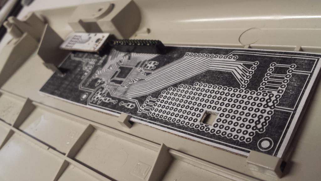

Here's where things get a little fun. Ignore the highlighted holes. They don't exist. The rest do.
So, the idea is, USB input riding the rails to the controller. Unless you're using a Lipo for bluetooth, in which case you cut the traces. Then you have the USB input cabled to the Lipo, and then coming back in on the left side, which then goes back to the controller.
On the bottom of that board will be a SMT pushbutton (found one that sits in at 1.7mm) for bluetooth pairing. The previous reset button will be replaced with the same size button in the spot that the USB-B connector took up on the controller.
And lastly, for now, this.
2015-03-04 11.05.25.jpg (88.65 KiB) Viewed 10284 times
The EE's can stop cringing at my previous use of 90 degree traces. Got those taken care of. :P
Mounting holes for 122 key M's, as well as a square cut out for the M's with the smaller controller. So far it happily fits everything I've tried it on, one way or another.
These pictures are maybe an hour or two old? There have been small revisions since then, but even those are bound to be tweaked, so you get the idea.

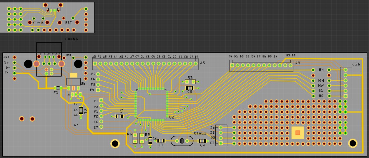

Thanks for clarifying, Halvar! I think I got this pretty well rigged up for that scenario now.
Found a perfectly fitting slide switch to fit where the USB-B goes. 5mm tall, with a 5mm actuator that will sit just above the case and be just accessible enough. Just high enough to keep that little board from being too high and interfering with the USB cable. So far, looks like perfect clearance. That connector area looks like it has plenty of space until you start trying to cram stuff in there! :P
Also leaving extra through holes to stuff an LED or two on the mini board.
Anyhoo - pretend like you're connecting the bluetooth hardware, and let me know if anything seems weird or could be done differently.
Open for suggestions/modifications before I send this off to be made on Tuesday or Wednesday.
Before then I'll be tweaking some traces to pretty them up, extending the breadboard area to the right a little more, possibly adding traces to the correct pin locations for the EZ Key module (maybe? It looks like it will fit with clearance to spare, at least on a full sized M), and probably adding some pad connectors on the bottom that connect to the ribbon connectors in case something goes horribly wrong with this layout. Then a Teensy can get slapped in the breadboard area and save the day. Don't think that will be an issue since my prototype worked until I put it in a coma that I haven't woken it up from yet, but it's a nice reassurance when you're getting 50 boards...
Also, going for an ENIG finish for shelf life and solderability with leaded/lead free. I really like the idea of a green color PCB for the sake of tradition, but red looks awesome... So I don't know yet?

I skimmed the board image and found some to think about. I'm not 100% sure about these, just hope it helps.
- J4 and J11 connectors are provided 5V from USB. This won't be safe when MCU runs at 3.3V. I think they also should be supplied MCU VCC voltage(3.3V).
- For Bluetooth option 'external power input' pin is needed to feed with battery? If you use EZkey it has regulated 3.3V output(100mA).
- VCC line(U6 regulator input) will be connected to USB 5V directly when it acts as a normal USB only controller or it'll be connected to 'external power input' when Bluetooth. You will need solder jumper for this.
EDIT: Added diagram.

phosphorglow
09 Mar 2015, 18:52
Ok I think I see what you mean, but I'm still a little confused.
The Lipo rider regulates the voltage back up to 5V, so essentially we're still running off of "USB" voltage even on battery power.
So, that power input will be heading to the voltage regulator AND to UVCC (which is an internal voltage regulator on the 1286). From the voltage regulator, it's brought down to 3.3V and connecting to VCC, AVCC, and UCAP.
So, regardless of whether the controller will be connected to external USB or internal power, it should still be configured to run at 3.3V/8MHz in this application.
Am I overlooking something or do I understand this correctly?
Configuring for 3.3V/8MHz will lower the power consumption which is the goal for battery operation, and we still get the same 5V for LEDs.

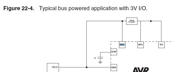

phosphorglow
09 Mar 2015, 18:56
Here's this from the datasheet.
Teensy schematic connects 3.3V to UCAP as well, but I think that's basically just for direct 3V battery power. According to the datasheet, I suppose I don't need to do the same thing, right?

hasu
10 Mar 2015, 01:34
I didn't know Lipo rider output is 5V. I think it works as you said but my concern is sitll there. When MCU core runs 3.3V it is not safe to handle higher 5V with IO pins. Pratically it may be no problem.
Another concern is,
VBUS is used for USB plug-in detection and it is not good idea to connect to battery, it should be connected to real USB 5V line. This is not indispensable but will be needed to support switching between Bluetooth and USB.
phosphorglow
11 Mar 2015, 03:15
No problem Havlar! Hope all is well! It'll probably be another couple of days anyhoo. Lots of other things keep popping up.
I see what you mean hasu. For some reason the idea that the IO pins pulling 5V to ground for the LEDs when set for 3.3V wouldn't be a big issue, but I agree - it doesn't sound safe at all. It might work, but who knows for how long.
So, I'm thinking the simplest solution would be to just cut the 5V trace that runs the remainder of the circuit and power it from the voltage regulator? It's rated for 500ma. How does that sound?
Sounds good. Probably 3.3V is even enough to turn on old LEDs.
hasu wrote: Another concern is,
This I'm curious about since Halvar seems to have been able to do this:
Halvar wrote: One pole is in parallel to the switch on the Lipo Rider and switches the battery power supply on or off. The other pole of the switch is connected to an AVR pin so the AVR chip knows if it should be running on Bluetooth or USB. This second pole might be unneeded though, you could directly get the voltage on the switched side over a high ohm resistor.
I'm guessing he's using one of the ADC pins?
As Halvar said, Bluetooth module can be controlled with the physical switch state IO pin.
VBUS is for doing funcy things in firmware, you can use Bluetooth without VBUS connection I described.
EDIT:
Technically VBUS is needed to USB interrupt VBUSTI which is useful for USB stack to manage power/connection cycle. But without that I think you can do, in fact ATMega32U2 has no VBUS pin.
Halvar
12 Mar 2015, 09:54
VBUS and UVCC are connected to the Lipo Rider's 5v USB output pin. I can't detect if USB is connected to the PC from these, because they're always on +5V whenever the controller is on. It wouldn't make sense to use this for detection of a connected PC anyway, because you could always also connect a USB charger or a PC in some power saving mode to the USB port. You could also want to use the keyboard for your tablet via BT while it's connected to the PC by USB for charging. That's why I went with the switch instead of some kind of autodetect.
