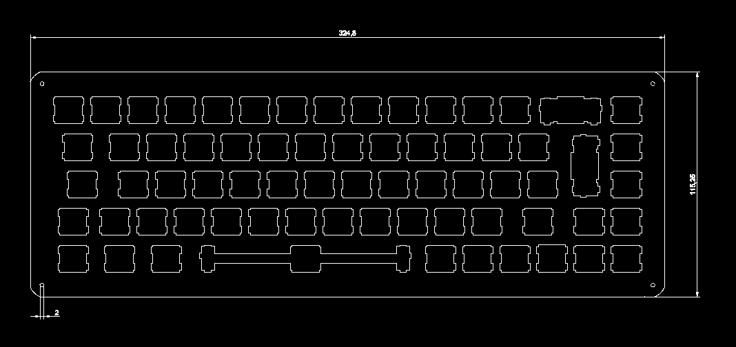

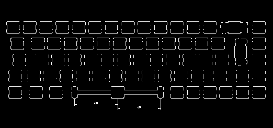

I don't know if it can be useful, but I made a plate layout for a possible ISO version of 3rd model. I have never used a CAD software before, so I hope I didn't make any big mistake:
I read that the stabilizers for space bar are 50mm from the center, is this good? Also I am not sure about the enter key.
-[°_°]-
23 May 2014, 08:50
from the pictures the measurements seem right...
I reviewed the prototypes I sent to the laser cutter and I'm afraid a made a little error with the ISO version (darn!). Basically I have 2 1u instead of the 2u backspace... hope someone wants it anyway. otherwise I trashed it.
23 May 2014, 09:27
Split backspace is a must! Although with fat ISO return under it, the victory is smaller, while the cost in awkward caps remains the same.

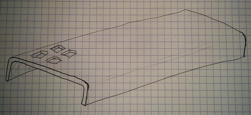

My dream case / plate :
A simple creased alu plate with the HHFox layout (with stabs).
The main goal is to made the handwiring visible.
I don't know how much will this case / plate cost ?
-[°_°]-
23 May 2014, 10:43
that would very easy to make actually and not expensive at all. Alu might be too light though, you probably have to use steel (which is also cheaper) and find some way to rubberize the feet

What's the difference between plain square keyholes and the other ones? Blue ones compared to white ones in this picture
Square ones allow to completely remove the switch, while the other ones only the top?
I also have some few other questions about the plate layout: how big are the screw holes and the plate in general? Of course to be compliant to the versions you are prototyping. I am asking this because I might be able to laser cut a plate or two (should ask a guy I know who works with laser cutters), so I'd like to have a proper layout in the case.
I don't know if it is allowed to directly post the .dwg file, I will if there is no problem about it.
-[°_°]-
23 May 2014, 12:09
mr_peck wrote:
matt3o wrote:I can ask a for quote if you are really interested (bent steel)
Please !! Is the manufacturer in europe ?
I'll let you know. Yes, in Europe.
Pyrox wrote:What's the difference between plain square keyholes and the other ones? Blue ones compared to white ones in this picture
yes, square ones are cheaper (less machine time), but you can't remove the top casing.
Pyrox wrote:I also have some few other questions about the plate layout: how big are the screw holes and the plate in general? Of course to be compliant to the versions you are prototyping. I am asking this because I might be able to laser cut a plate or two (should ask a guy I know who works with laser cutters), so I'd like to have a proper layout in the case.
currently the plate for the wooden case is 312x103, but it's subject to change based on the prototypes. The screw holes are 2M, but again, it may still change.
I don't see why you shouldn't be allowed to post dwg :)

23 May 2014, 13:57
I didn't make it, the plates were already cut yesterday. So I get an ISO without 2u backspace. I actually prefer that (maybe that's why I did it that way...) but I understand it's not everybody's cup of tea.
Pyrox
23 May 2014, 15:04
Ok, I was adding holes and borders to the plate. It is bigger than yours because from what I saw yours doesn't have holes being "sandwitched" between wooden layers, which will be screwed then (tell me if I am wrong), anyway I put them just in case.
Here is the .dwg for further modifications :)
plate_template_mm.zip
(53.26 KiB) Downloaded 212 times
-[°_°]-
23 May 2014, 15:09
the plate is not screwed at all. the layers are glued together so that the plate doesn't need screws.
The bottom layer is indeed screwed.
Pyrox
23 May 2014, 15:17
Ah, I see, it'll look even cleaner in that way.
