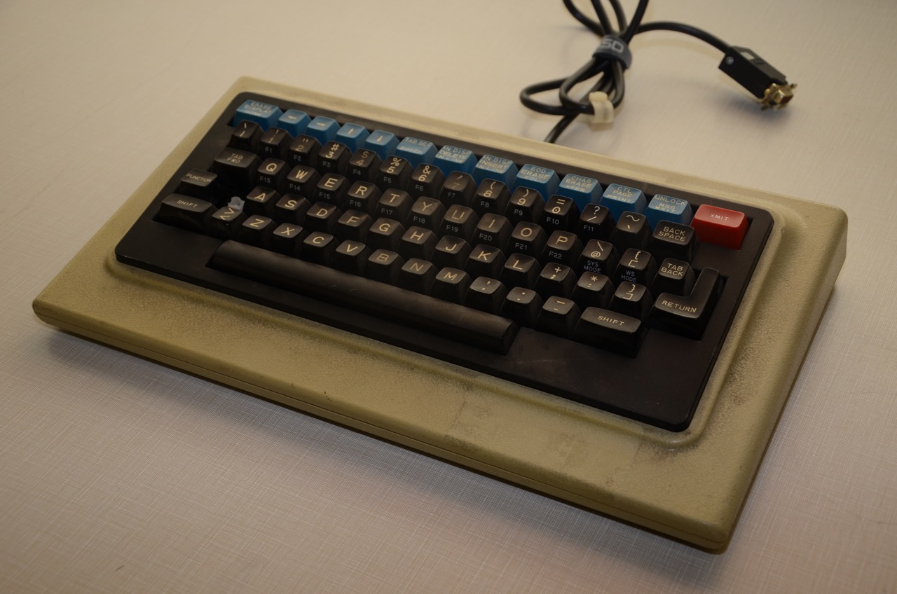

I started with this beautiful keyboard:
It is, I think, a Sperry Univac F39W-00? As you can clearly see the outside of the case is very yellow compared to the inside:

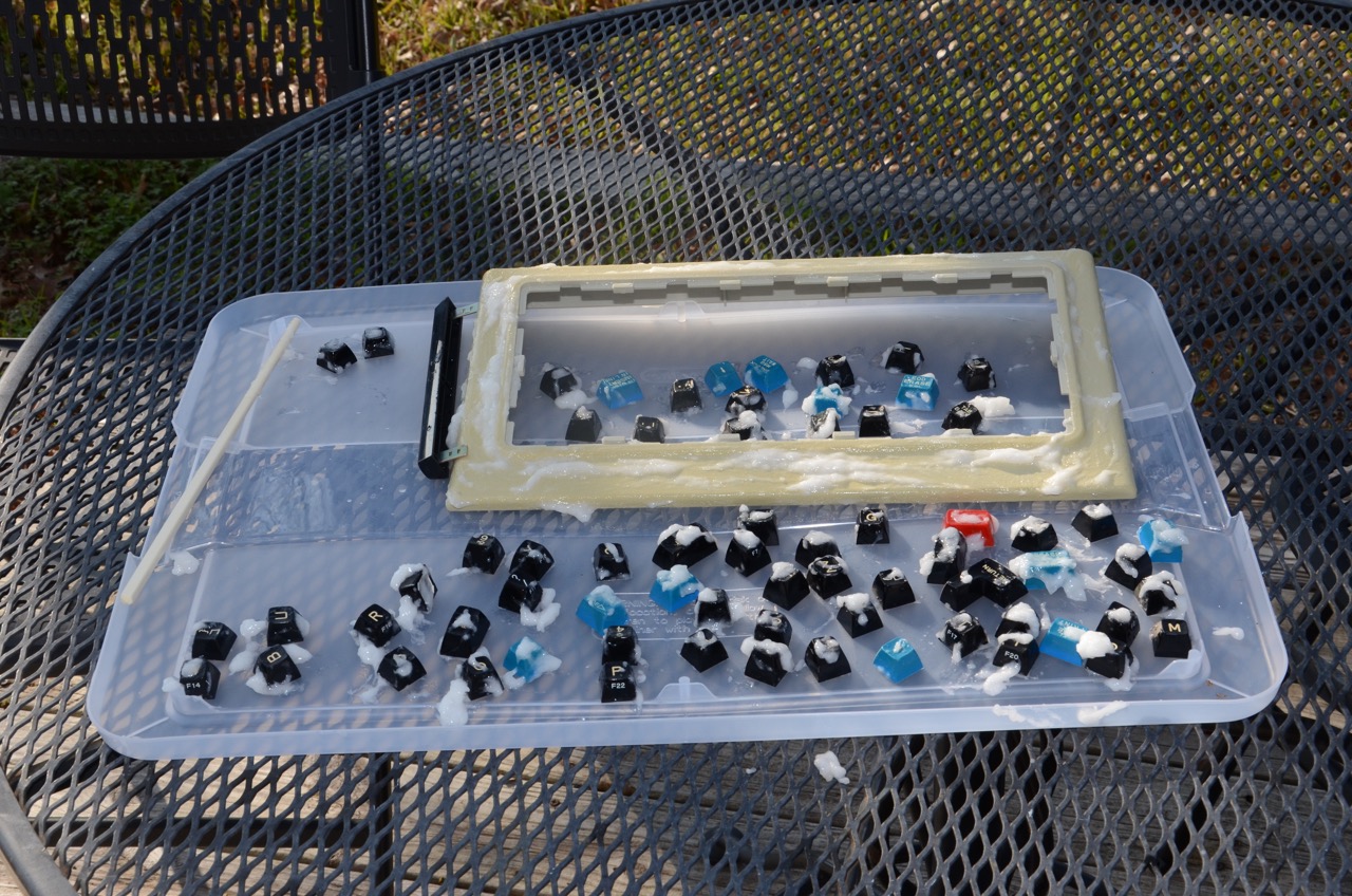

So retr0bright to the rescue! My first attempt differed from the "official" recommendation in several ways:
- peroxide strength: I only had 3-5%, when 10%+ is recommended;
- UV strength: I did this on a cloudy day;
- temperature: I left the setup outside where it was 3 C. Room temperature (20-25 C) is recommended.
I also decided to Retr0bright the key caps to pull yellowing out of the legends. In retrospect I should have tried the entire process on *one* key before proceeding. Though, even this would not have saved me necessarily, as there were different plastics used on the same keys.
This attempt was not successful. The case got a tiny bit lighter, but it was barely noticeable.

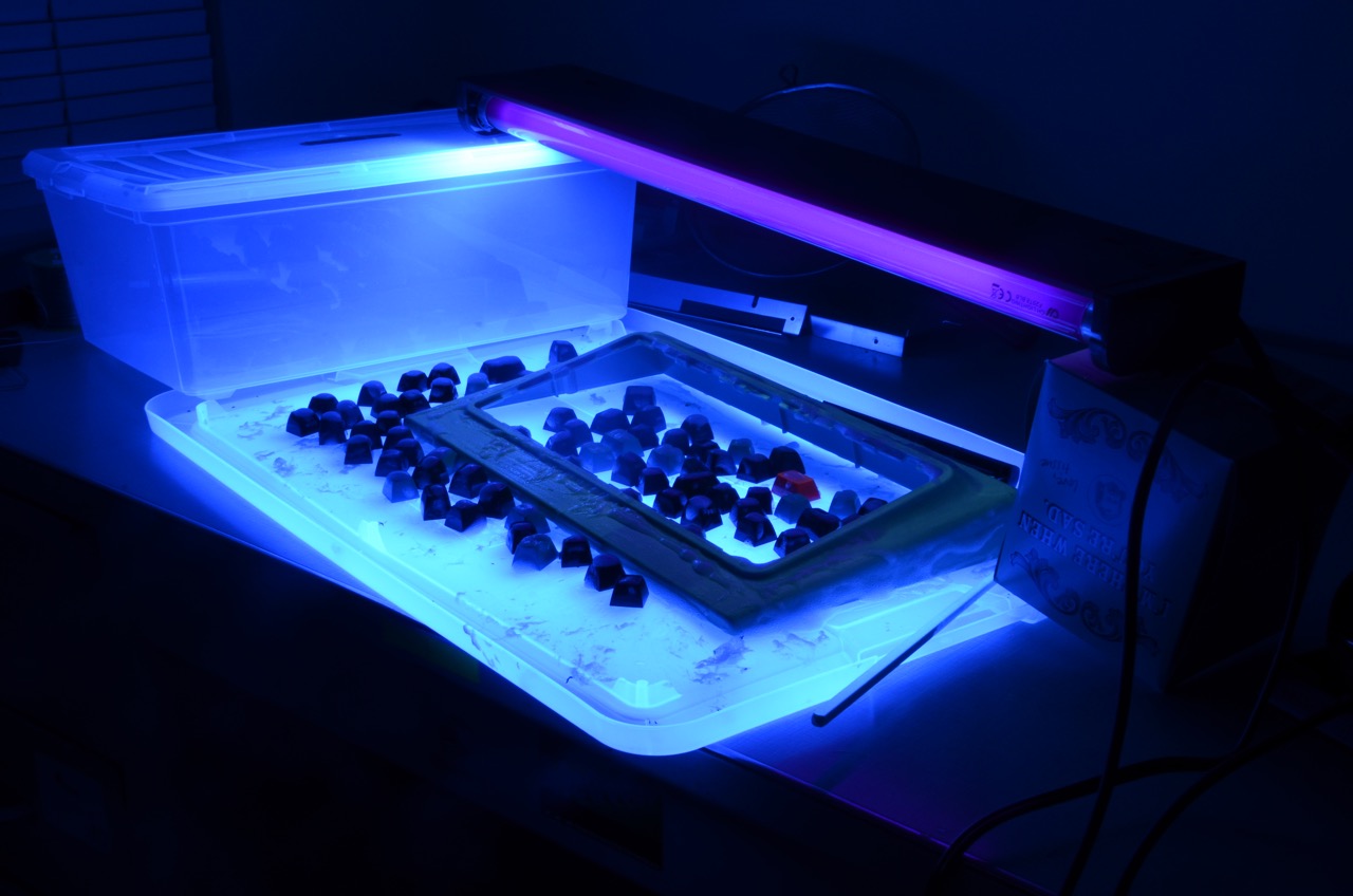

So I made some process improvements to better align with the Retr0bright website's recommendations:
- peroxide strength: 10%, using a "volume 40 clear developer" from the local beauty supply;
- UV strength: I purchased a 20W UV bulb and placed the setup at point-blank distance;
- temperature: I did this indoors, where the temperature was a controlled 20 C.
I let this go for 12 hours. I misted the setup with reverse osmosis water a couple of times to help prevent the paste from drying.
Here is the UV setup in action:
...success! The case is lighter! Not 100% lighter but it is noticeable!

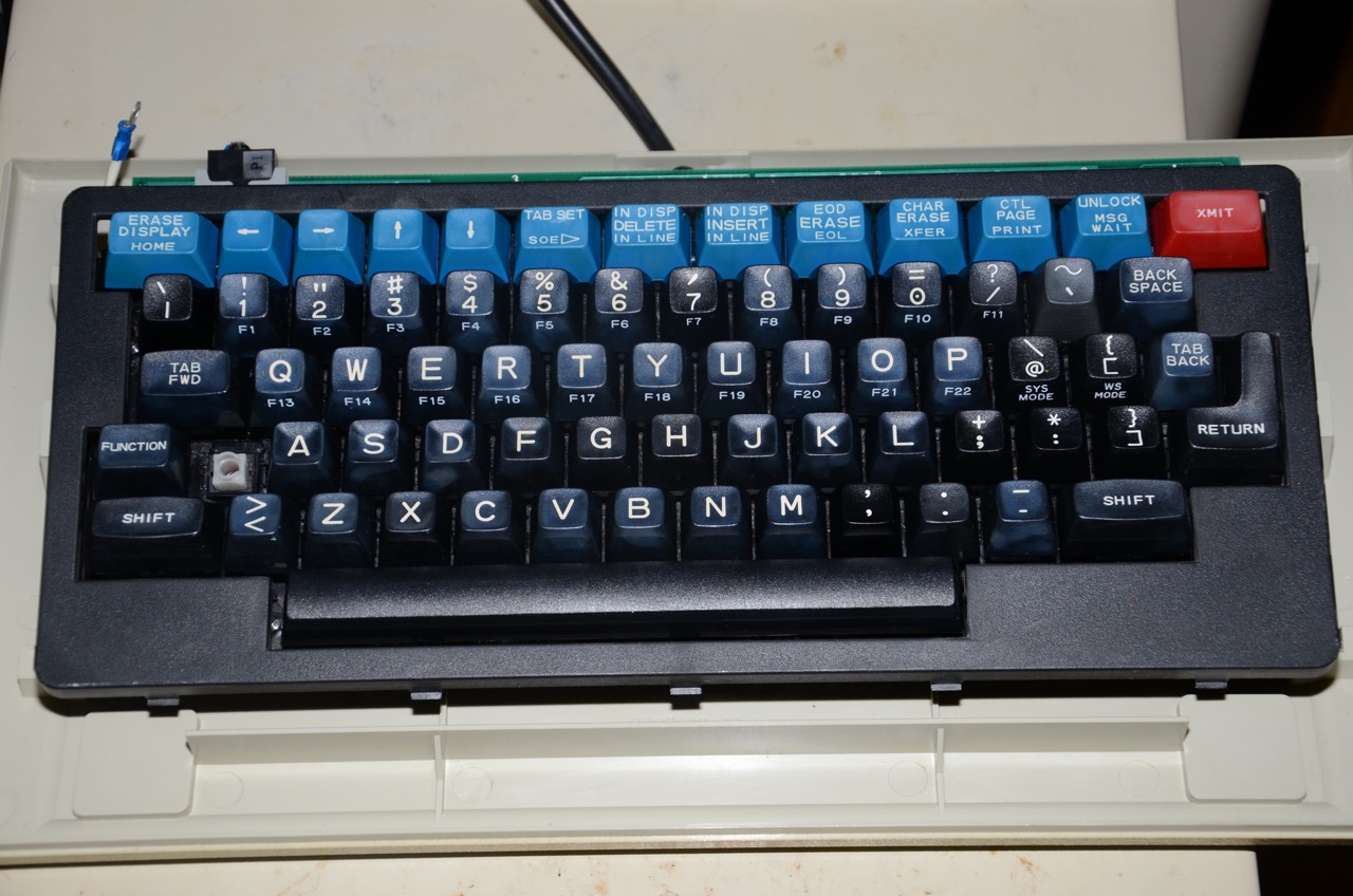

Now here is the bad news. It looks like two different batches of plastics and/or dyes were used for the double shot key caps. Some, but not all, of the black, blue and red plastics were irreversibly bleached. This was not present after the first round of Retr0bright, but was very clear after the second round once the keys were washed and dried.
The good news is that the legends did lighten. The bad news is that so did everything else. The beautiful deep red of the XMIT key is gone, and the remaining keys are inconsistently lightened.
So, my cautionary tale: I cannot recommend Retr0bright for double shot keycaps at all.
