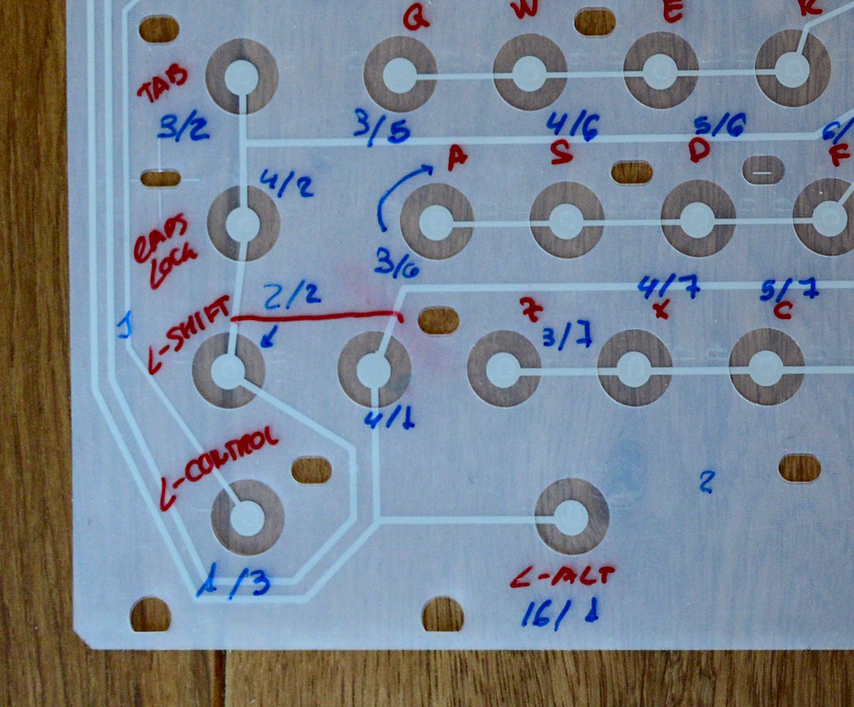

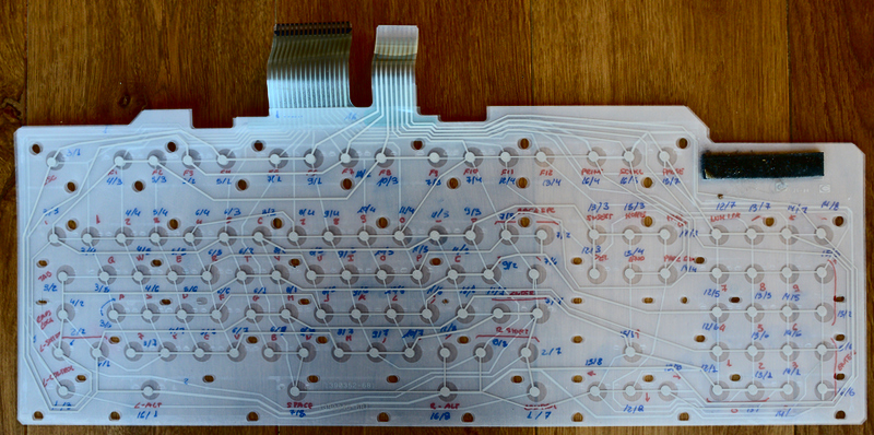

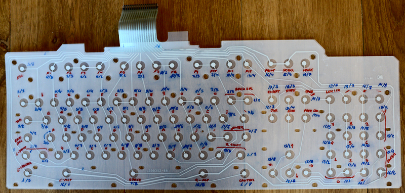

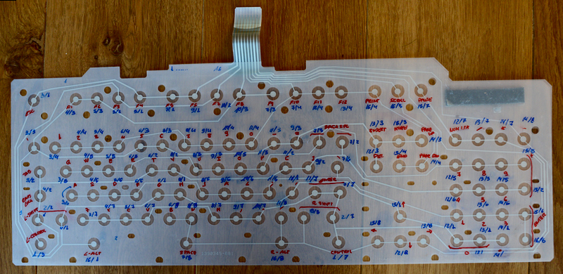

You may use the attached pictures to test your matrix also.
This shows the lower layer
This one the upper layer
And this one together
You can use a tester to check the continuity in the connector pads for the suspicious keys.
The key you are after should be 4/1

I was finally able to connect this to my PS2 port on my desktop and I can confirm that the <> work perfectly. There must be something wrong with this adapter. At least that part is solved :)
