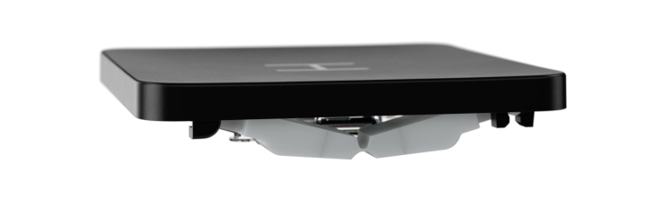

So, it's basically half-scissor stabilized metal dome?
It should keep the same feel for a good while, unless lint or grit gets in there.
I'd like to try it when it hits the stores, but I am afraid it will feel like those metal dome membrane keyboards, too tactile with too little travel.

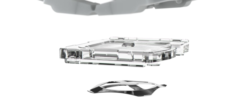

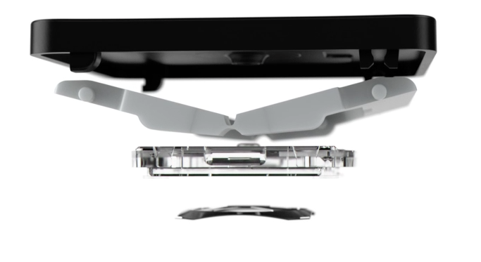

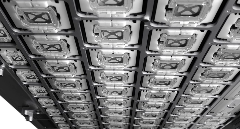

Edited the OP to include Apple's stock photo. Also, here's some crops I just took from the video, during the keyboard segment:

It's a double stabilised take on scissor switch, with a segmented stainless steel dome. Quite what that does to the feel… I'll find out once they have some on show at Princes Street!

chzel wrote: So, it's basically half-scissor stabilized metal dome?
Pretty much, but the scissor part is "glass filled nylon", whatever that means.
I guess it's a lot more rigid.

abhibeckert wrote: Pretty much, but the scissor part is "glass filled nylon", whatever that means.
GRP (glass reinforced plastic) is nothing new or exotic, but it is a lot more rigid and durable. It is basically plastic with tiny glass fibers mixed in.

One of the themes of the presentation was their fondness for fancy materials. I'm sure it all sounds impressive when you're otherwise not interested in the topic at hand. But the keyboard bit caught my interest more than most, of course.

The metal domes in the keyboard looks a lot like the ones in some of my TI calculators from the 1970s... Nothing new. Very low key travel though.
The "butterfly" stabiliser is also nothing new: there have been lots of variations of that. I expect Apple's to break in the middle. Some larger ones have gear teeth connecting the sides instead. I can't see what it is here that prevents the keys from falling out ...
chzel wrote: GRP (glass reinforced plastic) is nothing new or exotic, but it is a lot more rigid and durable. It is basically plastic with tiny glass fibers mixed in.
Yep. You can get 3D-printing filament with it. I sometimes add microfibres manually to epoxy when I glue or cast something when I need extra rigidity and strength.

So there's no rubber part in it any more? But a metal spring instead kind of like in a Futaba switch? Sure sounds interesting.
