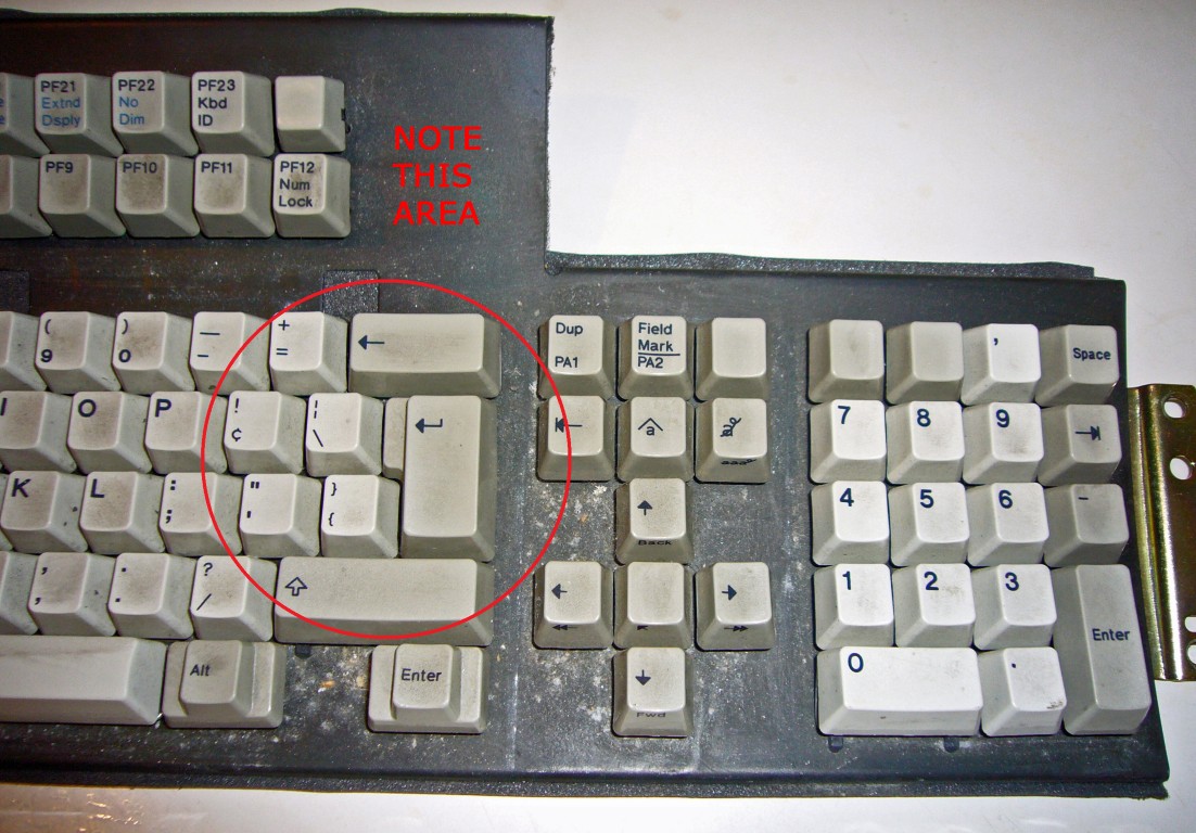

What did your AT mod involve? I see you have added a key where the top part of the Enter key was... does the board have capacitive plates at each barrel position?

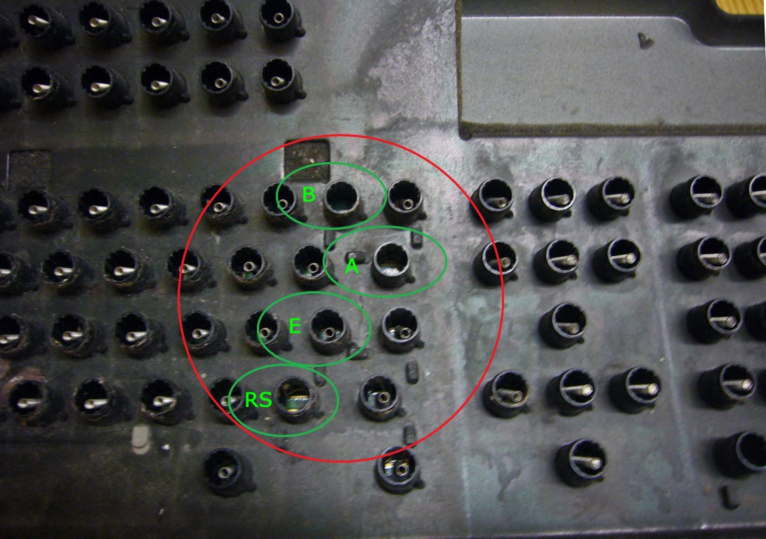

(1) Yes, (2) no & (3) yesSigmoid wrote: In the meantime I got an XT off eBay, I'll clean it out, refit it, and if I get an AT, I'll just use it myself. ;D BTW, I'm wondering, (1) are the keycaps interchangeable between Model M and Model F? Also, (2) are the keycaps themselves sculpted for each row, or is the keyboard profile formed through the barrels?
What did your AT mod involve? I see you have added a key where the top part of the Enter key was... (3) does the board have capacitive plates at each barrel position?

It is all trivial except for putting it back together!
These photos show the F-122, but the idea is the same.
Be careful with the case, unscrew the back and carefully and gently open the front like a book.

Yup. Model Fs are awesome for mods! And awesome for feel, too.
You'll need the right caps for your new layout, of course. The arrow keys on mine are from a Model M set. You're better off with original IBM caps (harvested from other boards, especially cheap 122 key Model Ms) than going for new caps from Unicomp because the original legends are sharper and deeper so look better across the board. Unicomp's blanks are most useful though!
This is what the inside is like:
http://deskthority.net/workshop-f7/open ... ml#p209092
All those pads are available: even the hidden ones either side of the massive spacebar. I don't know if the XT also has those, but to use them I'd need to drill and I decided to keep things simple for now.
But BEWARE the spacebar! ATs and XTs have this annoying way of attaching it that means you can snap things unless you take the whole board apart *before* removing the spacebar from behind. Reinstalling it is annoying too, and requires a bit of floss to do the trick; I tied many times before I learned that one! The details are in my thread. Feel free to ask us lot whenever you're in doubt. XT's demand respect!

Another thing about the electronics side... So I see there are lots of pads, but are there XT scan codes for those? How does the XT keyboard protocol describe keypresses?

As for signals, every pad does indeed have its own scancode. Some of them are quite strange! As you'd expect, because they were hidden. I don't know how you'd handle them with an AT plugged straight into a PS/2 port. I do everything over USB via a Teensy.
