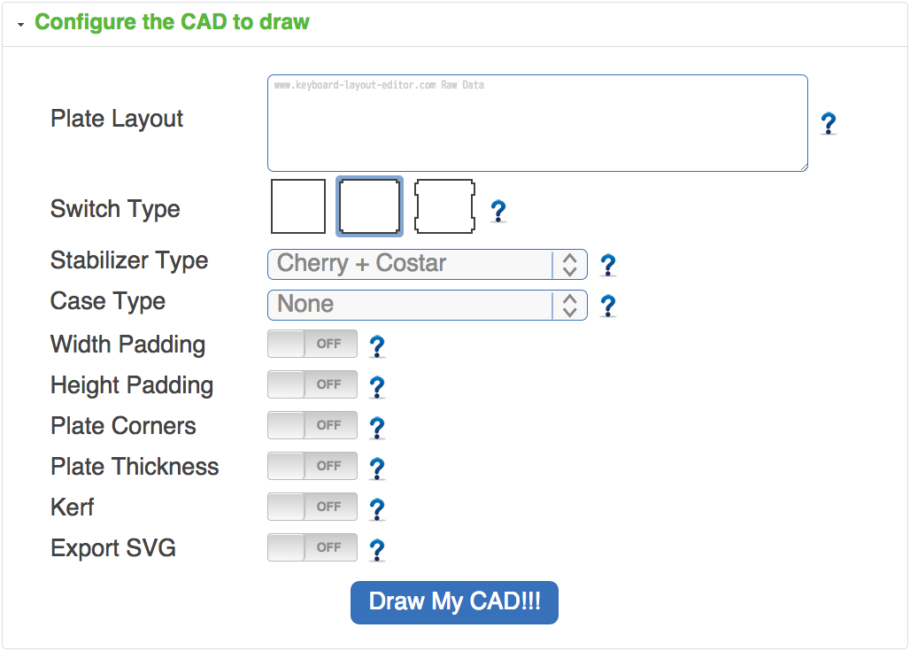

Here is the UI you are presented with right away when you go to the tool.
Screen Shot 2015-03-18 at 10.52.51 AM.png (88.77 KiB) Viewed 6568 times
As you can see there are a lot of different options you can decide to use (or not). I currently support 3 different switch types (with some hidden features to support more which I will document soon, ask if you are interested).

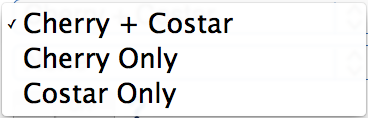

I have three different stabilizer drawings integrated:
Screen Shot 2015-03-18 at 10.54.45 AM.png (17.93 KiB) Viewed 6568 times
Cherry + Costar will support all types of Cherry stabilizers as well as Costar stabilizers. Cherry Only is basically the same cutout, but without the little cutouts at the top to fit the Costar stab. This will make the Cherry plate mounted stabilizers fit a little more snuggly. The Costar Only support is ideal if you know you will only be using Costar stabilizers or if you are trying to keep the cost of manufacturing down.

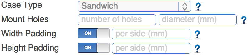

The most common case type for hand wired projects will be the Sandwich Case:
Screen Shot 2015-03-18 at 11.05.56 AM.png (40.58 KiB) Viewed 6568 times
This case type allows you to specify how much space you want around the edge of your keyboard and how many mount holes you want to secure the layers together. The tool will produce all the different layers you would need to build the sandwich case.

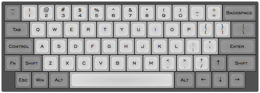

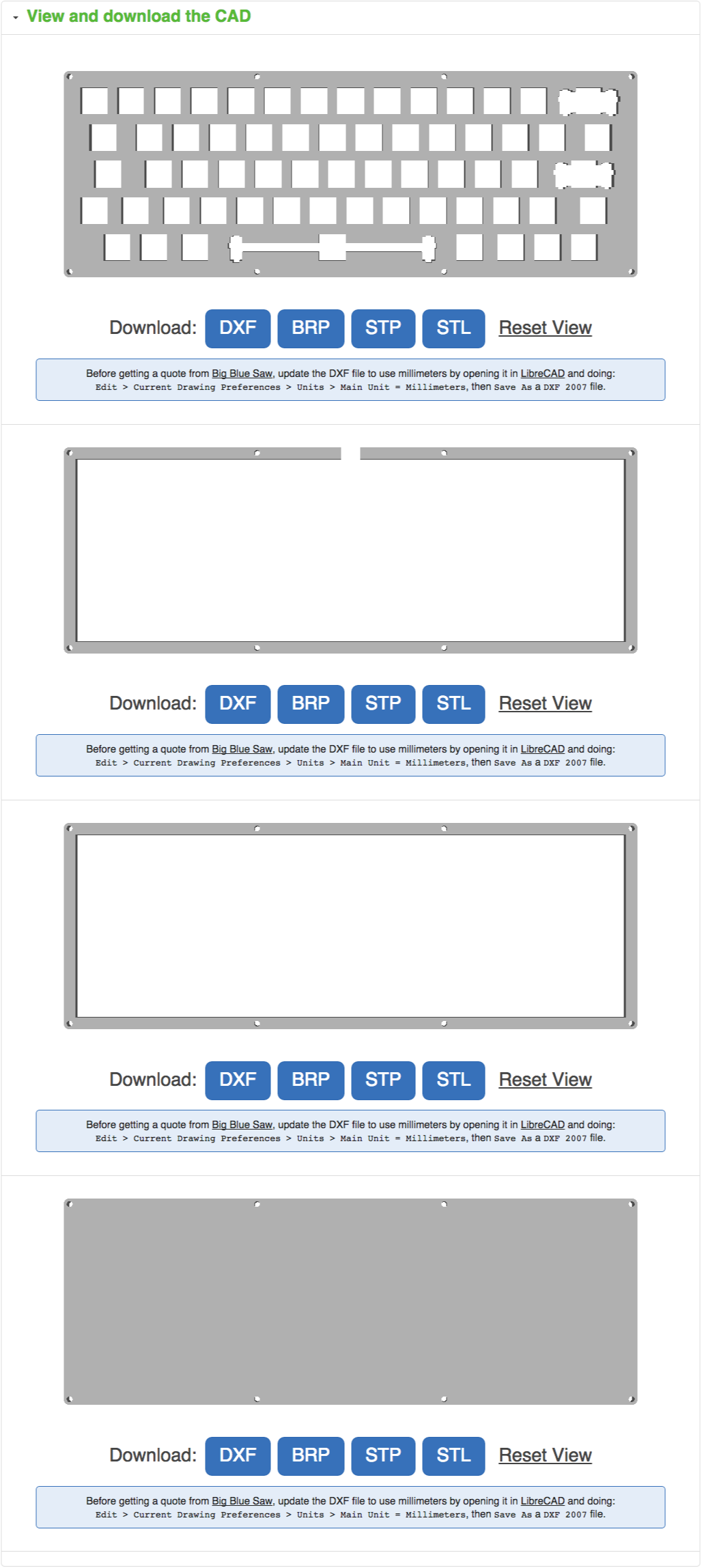

So if you wanted to make a keyboard with my swill60 layout:
It would produce the following files:

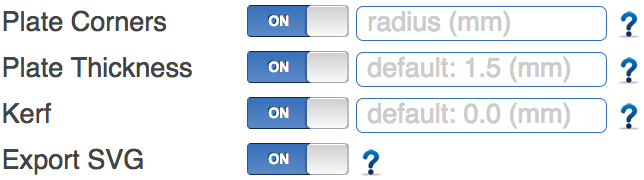

As you have probably noticed, there are a lot of different options you can specify. If you have questions about any of them, just ask...
