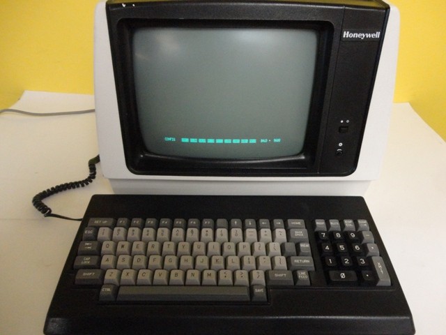

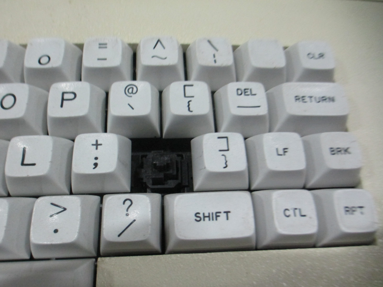

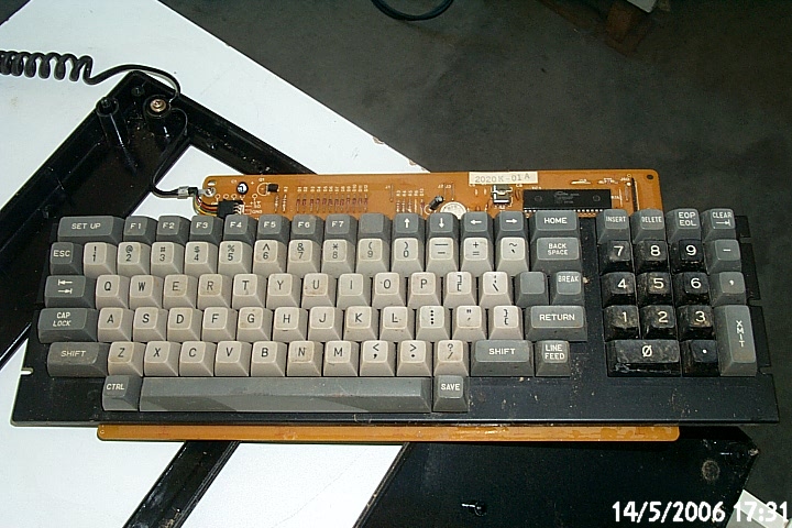

I picked up a Honeywell VIP 7201 terminal. Most of the photos I've seen online of this terminal have a black keyboard with some unknown switch - any ideas what it might be?
http://www.ebay.com/itm/200914469940
I believe this is the same type of keyboard as http://www.museodelcomputer.org/index.p ... Fotografie but there are no photos of a particular switch.
(from museodelcomputer.org)

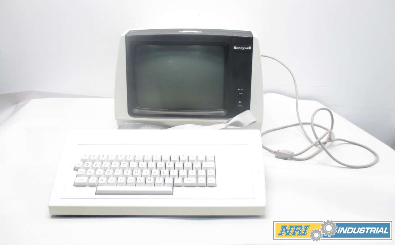

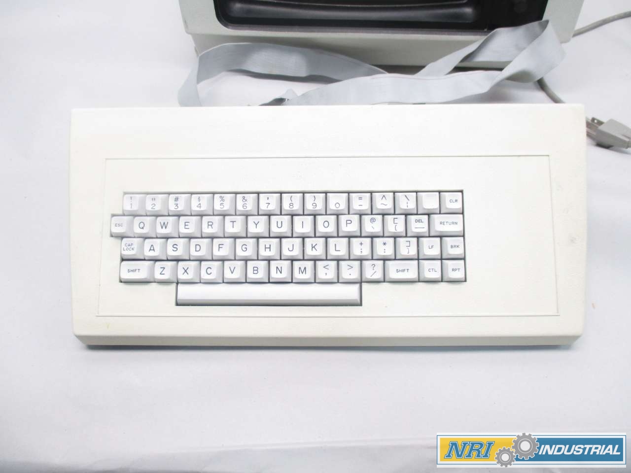

It also looks like there is another variant of this same terminal with a different keyboard - a white keyboard. I *think* this one is Hall Effect. I hope so since I bought it. We'll see in about a week. If nothing else I'm hoping to get a nice terminal out of it.
https://www.nriparts.com/miscellaneous/ ... wkeyboard/
Nuum
19 Mar 2015, 15:31

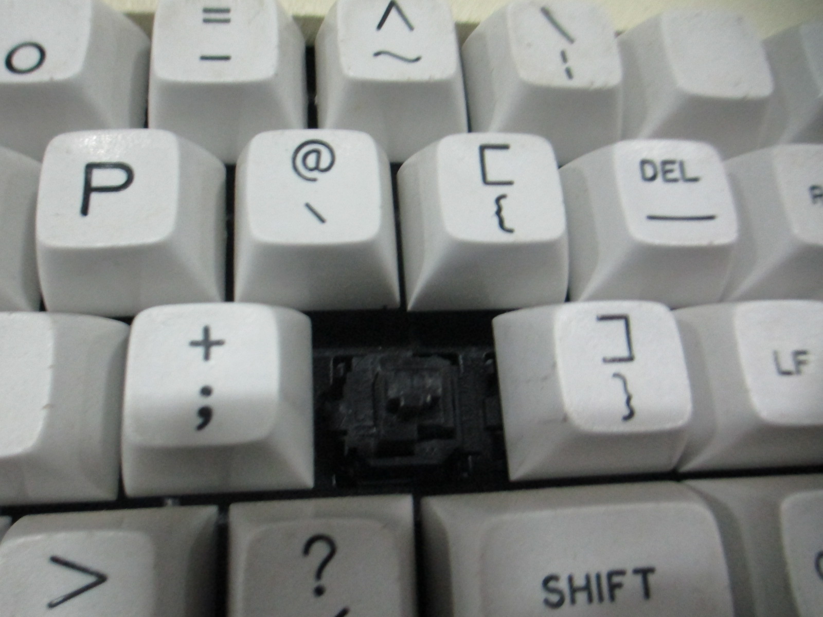

Don't Hall effect switches have four contacts? I ca only see two contacts per switch.
[ XMIT ]
19 Mar 2015, 15:56
Correct. The top black keyboard is almost certainly *not* hall effect. The bottom white keyboard almost certainly appears to be hall effect. The switches look identical to some others on http://deskthority.net/wiki/Honeywell_Hall_Effect, for example:
[ XMIT ]
24 Mar 2015, 23:11
Keyboard and terminal arrived today. The keyboard is definitely Hall Effect. It is also the wrong keyboard for a Honeywell VIP 7201! Maybe Cindy has one that works.
The keyboard connector is an RJ10. That could be anything! Anything at all! Power ground clock and data for sure, but in any order, and 5V or 12V!

Of course I am! But I was really hoping to get a working terminal out of it. The keyboard is the white one in the bottom four pictures of the original post.

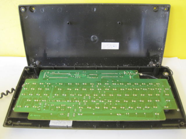

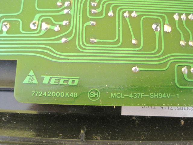

Sorry for digging up this thread but I just recently found a Honeywell VIP 7201 on eBay and just bought it. This one has the original keyboard so, XMIT, if you need any info, I can try to help. Your pictures of the black keyboard look similar to my Lear Siegler ADM22 keyboard but it has a different interface. That keyboard is also made by Teco and has cream AKCC Alps key switches. I'll see what this comes with when it arrives but I'm fairly certain Honey cloned the Lear Siegler or someone OEMed it to the other. It is a fantastic keyboard but it was not hall effect. You can see the ADM22 here: photos-f62/lear-siegler-adm22-terminal-t12190.html

You can tell it’s Alps from the keycap legends (and from the pin locations on the PCB).
