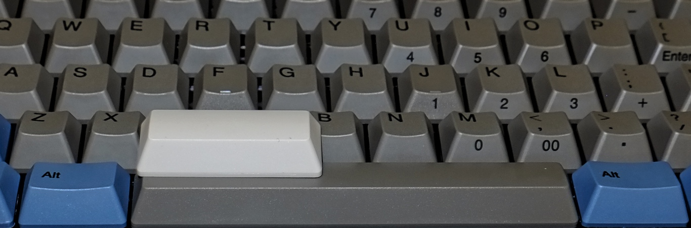

EDIT: like Khers also mentioned the ... short spacebar -- it's not just a touch shorter -- here you can see the difference in size; RF JIS spacebar (white) on the top of the ANSI version of RF87 spacebar:

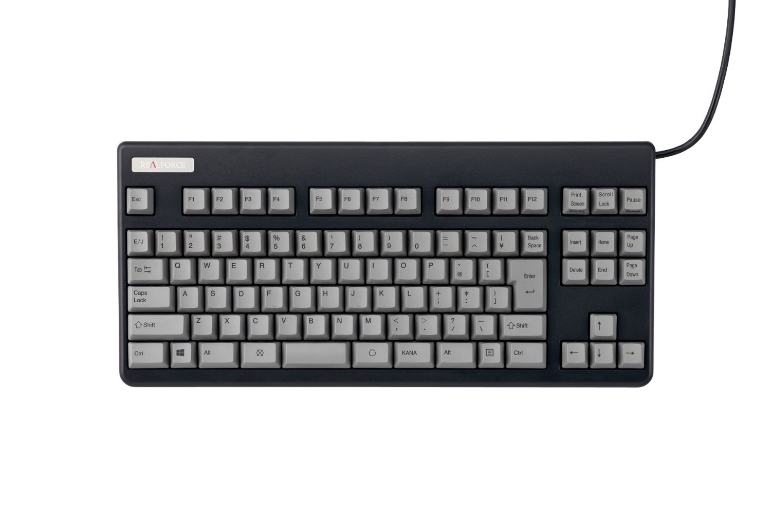

Necro here, because I have about the same question. I am thinking of purchasing a JIS Realforce keyboard, because the certain types of Realforce and Topre only seem available in JIS. For example, this TKL all 30g Realforce.
So I am wondering if any ANSI or ISO users have purchased a JIS layout keyboard and got along well enough. Also want the JIS keyboard outputs with certain keys. I am sure that this topic has been covered before, but this is the first thread that popped when I searched around.
